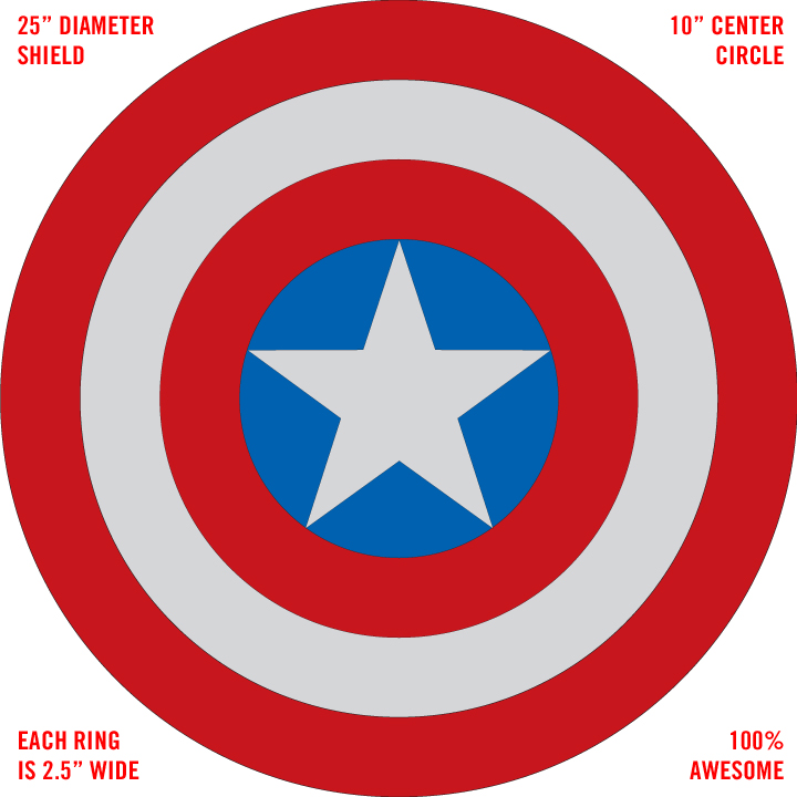

There really is a fair amount of wiggle room in the measurements that will still result in a "movie accurate" proportions. Remember, there were several diamter shields used in the films, at least 24", 25", and 26" ... so it really is about getting the proportion of center circle to ring area. As you'll see in the beginning of this thread I did a bunch of photo analysis. Not saying I nailed it, but what I have found is a 25" or 26" shield with a 9.5" or 10" circle seems to look real close. And yes, then equally dividing the remaining "ring area" into three equal rings. My favorite dimension set, because it looks spot on and is easy to remember is this: 25" shield – 10" center circle – each ring 2.5". It's what I've based every shield I've made on. Your mileage may vary :)

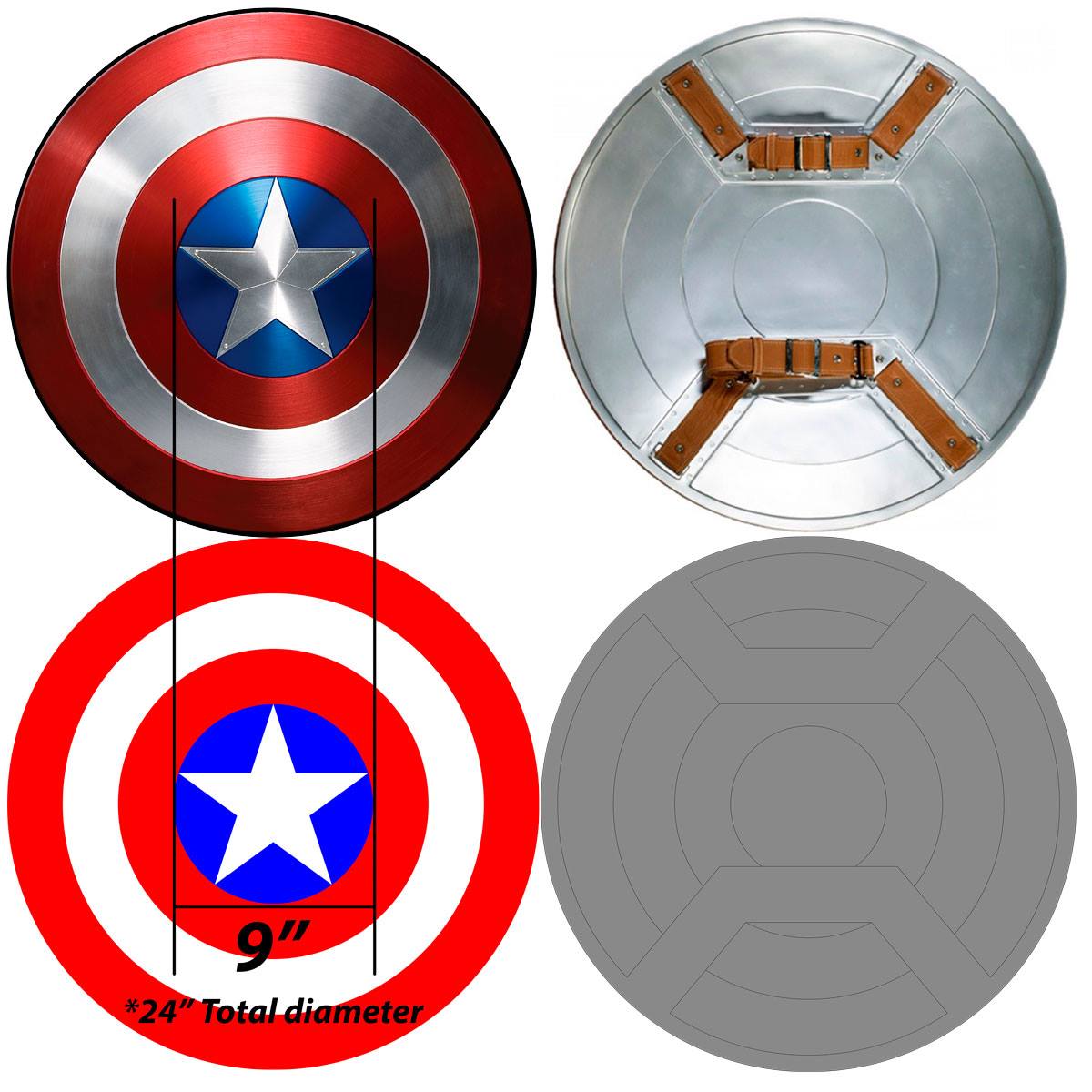

I've found that the dimensions work out nicely with a center star/circle diameter of 9" given a total shield diameter of 24".
