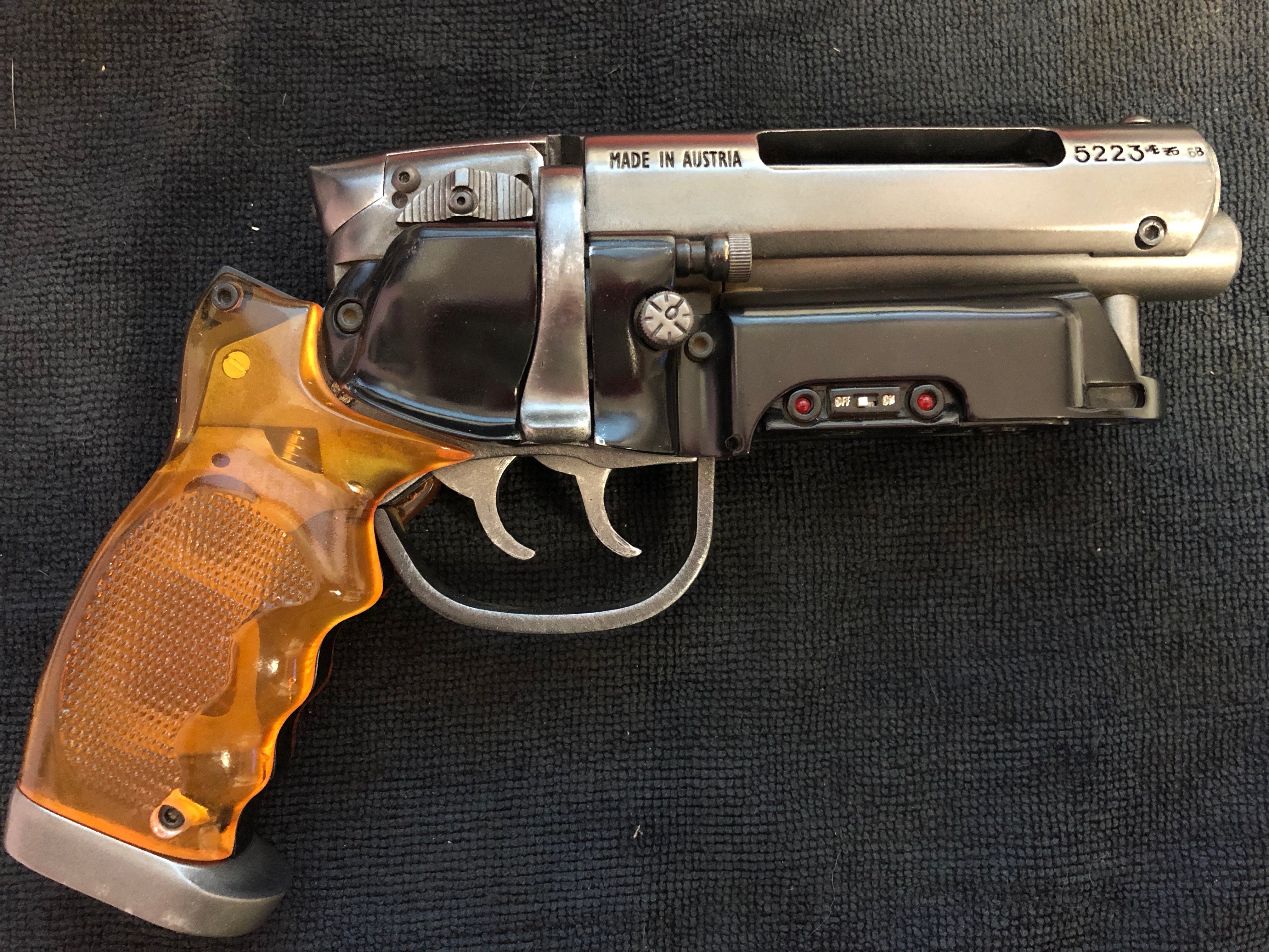

I recently bought one of these too.
The grips on mine seem clearer, so perhaps the maker has changed how he is doing them. They are a bit out from the original grips though I think.

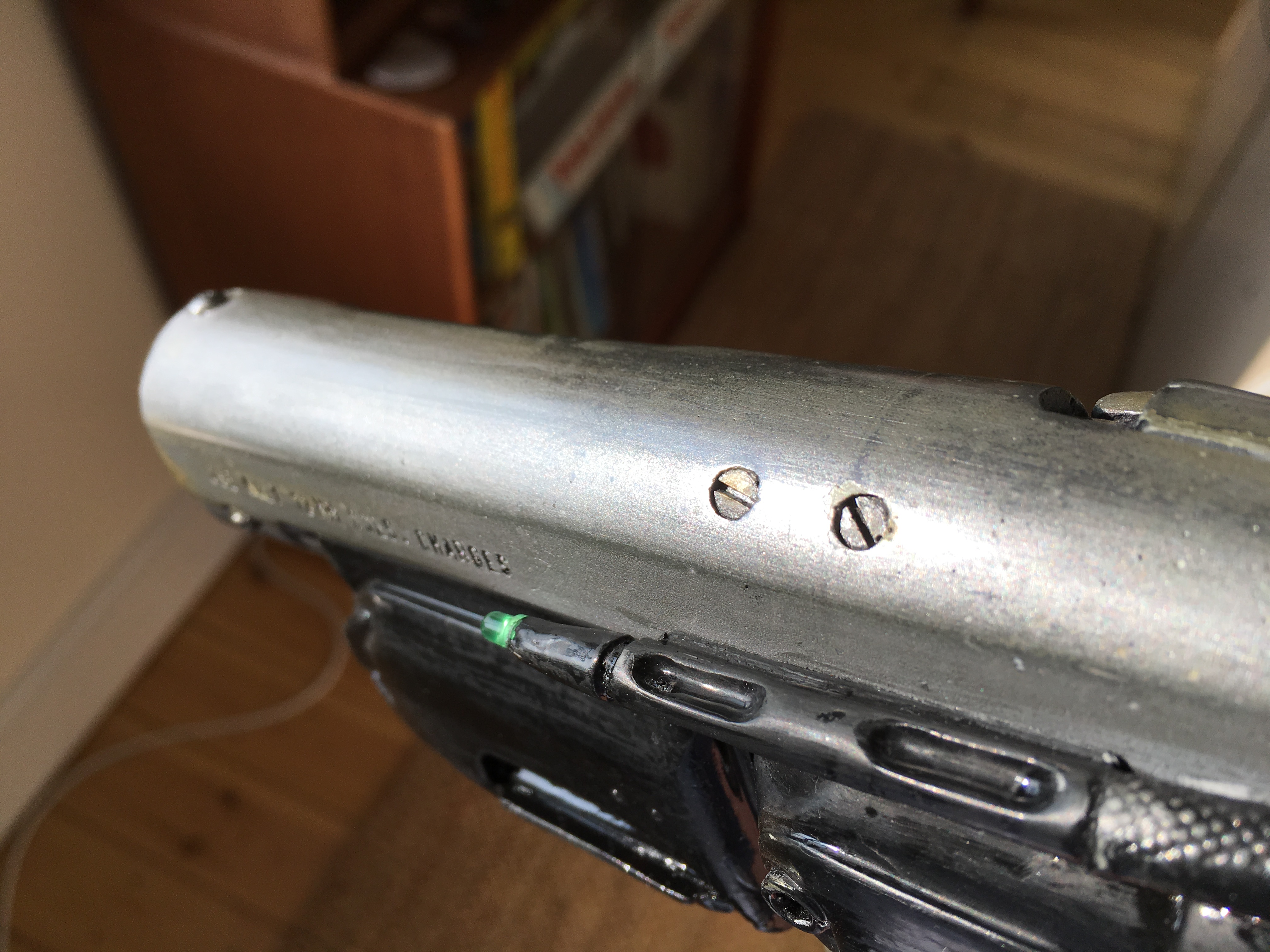

I didn't redo the paint on mine, but I have done some dry brushing with flat aluminium to add some wear and tear. T achieve a more metal look to the Steyer receiver and some other parts by rubbing in some graphite powder. I have also added some pigments to add a little bit of dust and rust. As ever I don't think the weathering or paint are done justice in photos.
I have also added some self adhesive lead weights in the magazine space to bring the weight up a little.
I also added some .44 special inert rounds, which have also had the cases filled with lead shot to again add a bit more weight.
The weight of mine is now around 650g, nowhere near a full metal version I know, but heavier than this blaster was when it arrived from the maker. It feels heavier in the hand now which is what I wanted to achieve.
Thanks for reading and any feedback would be great.
Thanks
Paul

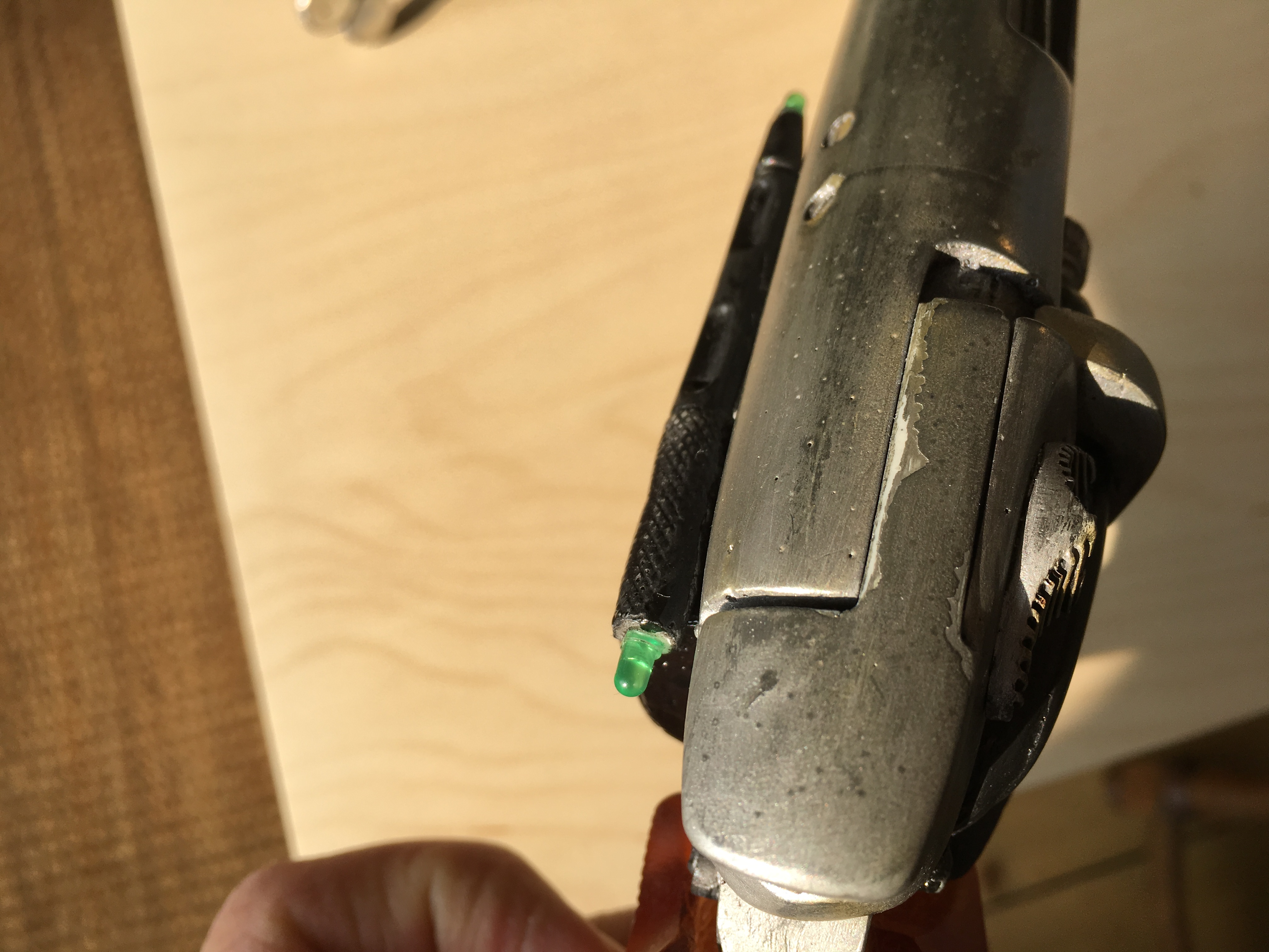

Also Paul, by the way, the maker has changed his design - it's much crisper detail now on things like text characters and smoothness. Must have a new 3d printer. I notice you also now get wiring included for the green lights to turn on. Can I ask, does the new version have both triggers able to be pulled? My furthest trigger is frozen.

Yes mine does have the green lights that work too, and both the triggers move and have return springs.

The green LEDs are on a separate switch which is inside the magazine (small black switch above the batteries in my image), so they can be turned on and off independently of the red LEDs which use the small white switch on the side of the magazine as you would expect.

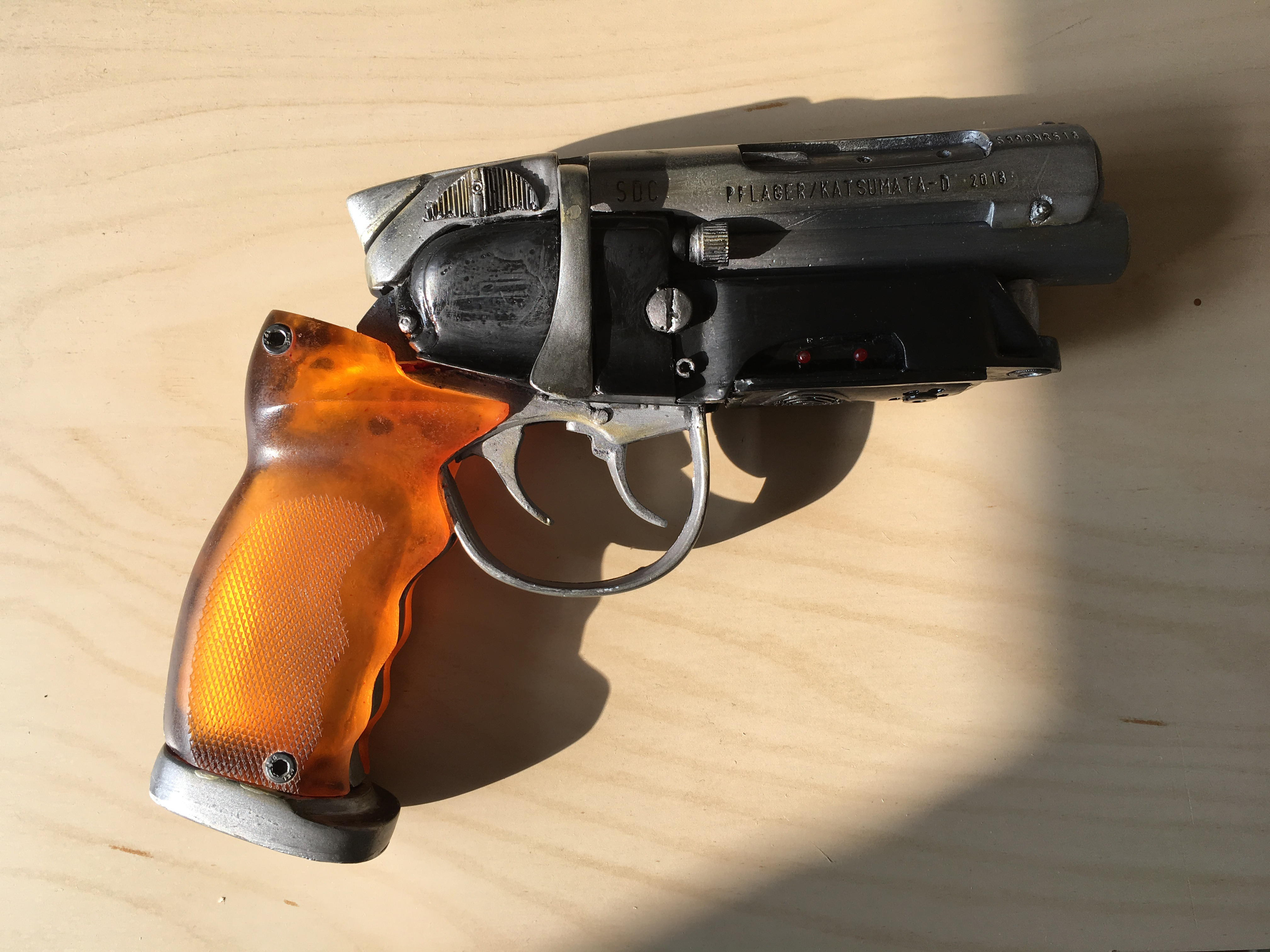

Ok guys
I have finally finished my PKD blaster. Now, bearing in mind (and don't judge) A) it was my first timw at doing this and b) this is a non-authorised resin kit and so not slavish to the original prop with regards to the embossed type on the barrel.
I had a few issues with getting the metallic acrylic aluminium spray to look metallic. Thanks 00fil00 for the tips and the tutorial link (I think it was you - had a lot of pm's) which said to rub teh barrel with the back of a spoon. I tried this and yes it worked but it left a few sheen lines. It occured to me that if a spoon would work then why not try kitchen foil (aluminium food wrap) and VOILA! Revalation!! It worked. So I literally got a sheet of foil, scrunched it up then flattened it to the shape of the barrel and rubbed at it until it got hot and it really did create a very high sheen to teh paintwork and with a subsequent layer of paint in a slightly darker hue and a final few rubbings I had created mottled "used" steel material.
After all of this, I use the Tamya weathering kit 'C' set (Tamiya Weathering Master & Stick) and concentrated on the screw heads and the edges of the gun, whilst being incredibly slavish to the various images I had downloaded from the new of the actual prop. And here are the results. Be glad of any and all feedback guys... And thanks for all your help.
Nick

Sweeeet! Can someone point me towards the tin foil paint trick. Never heard of it before now. thanks and great job!
Hey Sean, cheers for the comment. The tin foil trick is something that I came up with. Couldn't find anything on the net about it anywhere.
So basically get yourself a small sheet of tin foil, about 12 inches square. Then fold it and fold it again until you have about 3 or 4 inches then simply rub it over the area you want to "metalicise". I rubbed at the barrel until it got hot. Your fingers will go black too - think this is just teh paint though. But the more you rub, the shineir the paint work will be. I wish I video'd it for YT. I was really surprised just how metallic the acrylic paint looked when I had finished. The only tip I would say is that the flatter the surface of the foil the better as I noticed that a few folds of foil that were prominent actually scratched the paint a little. Great if you want a weathering affect but not so good if you don't.
Hope that helps...
I think you guys missed the original purpose. Rubbing with the back of a spoon was shown in that video for bringing a shine to that model. That model was cold cast - which means there is real iron filings in the resin cast. You sand away the top layer of resin revealing the particles of iron to the air, and then pressing with the spoon will smoosh them flatter and wider, rub off the dull oxidation, and generally grind them to a shine. This was because you asked about rust and I said you could do this if you get a paint that has real shavings of metal in it - sanding away the top layer, revealing the metal and then spooning or rusting the newly revealed metal. This won't do anything to just paint, except put streaky lines and compression damage to your paint - unless you like that look as some sort of weathering?
Yes that's very true. But I did try the back of the spoon method on the metallic paint out of interest and it actually worked. It really did bring up a sheen to the paint work. The only problem was the area it was covering. That is why I made the connection between the convex metallic spoon and the versatile surface area of the kitchen foil. But it really did work on the metallic acrylic paint. I did very much appreciate the instructional video though.
I'm really pleased it worked for you! Hope you display it proudly to remind yourself of your hard work.
