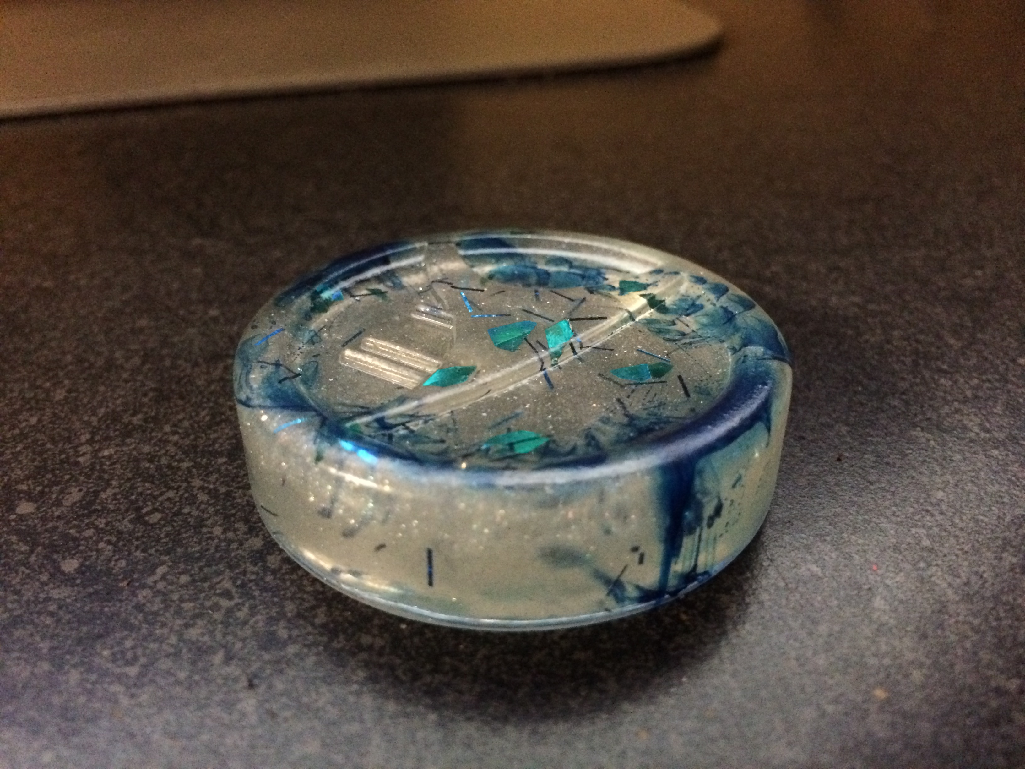

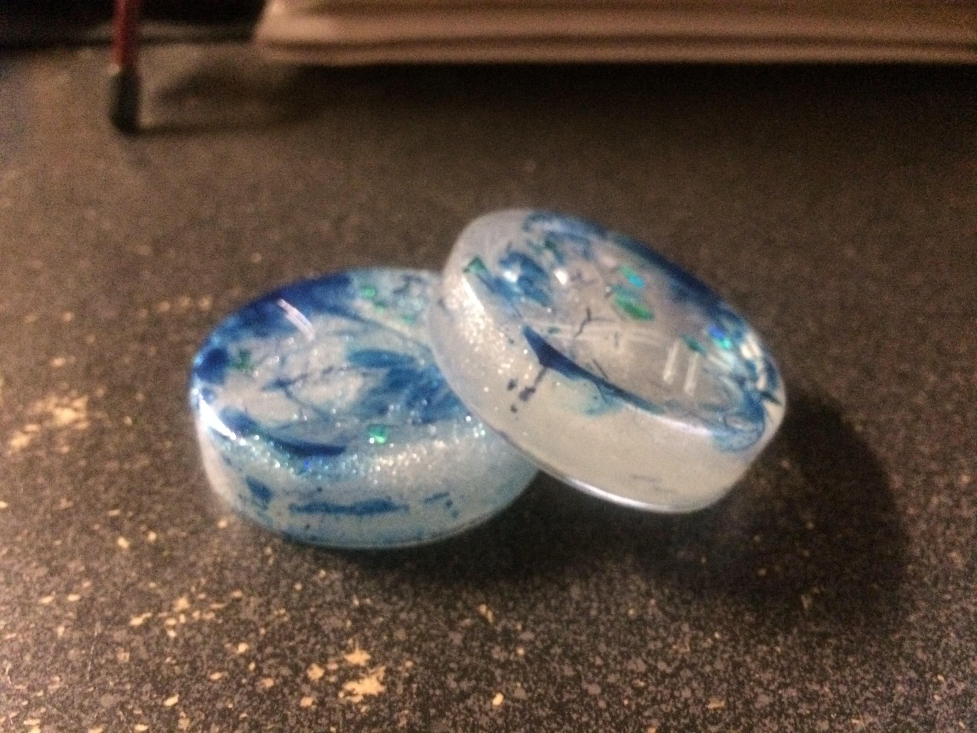

Ok here’s the first pressure cast test. I think it came out too transparent with the glossy finish. But a dull finish to make it less transparent didn’t make sense to me either because in some shots they do look very closely, so I tried adding pearl powder to make it a little more opaque. I think the blue flakes are a bit much, but the thin strands work well. The iridescent flakes I had reacted with the resin and turned white in castings so that wont work.
I’m going to try one in the rubber which comes out a little more cloudy yellow color and one without pressure casting and compare.
I think the swirl of blue dye on the front face got the right look from the shots as well.
Let me know what you think!
I think that the color swirl worked well. Not so sure about the flakes. Now I am wondering if the props were multiple pours so that the flakes could be more directly centered in the middle and not sink to the outer surface?
That could be, I’m also not entirely sure there are flakes, there could just be some kind of iridescent paint mixed in or something and we’re jus seeing light hit the edges of the shape and change color, it’s hard to tell without better reference.

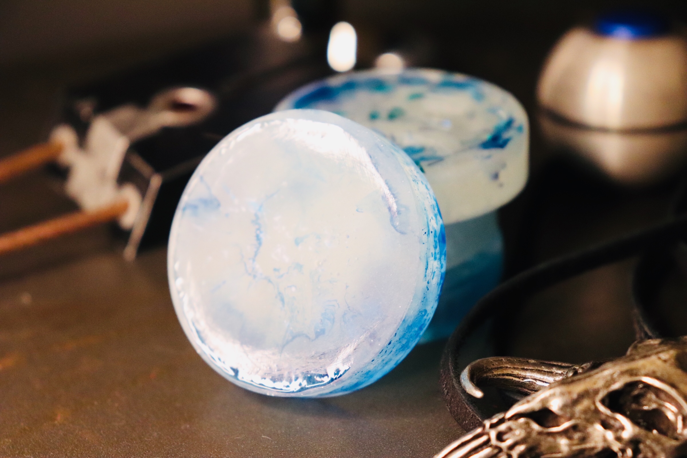

This second one I did without pressure casting came out a bit closer I think. On the right.

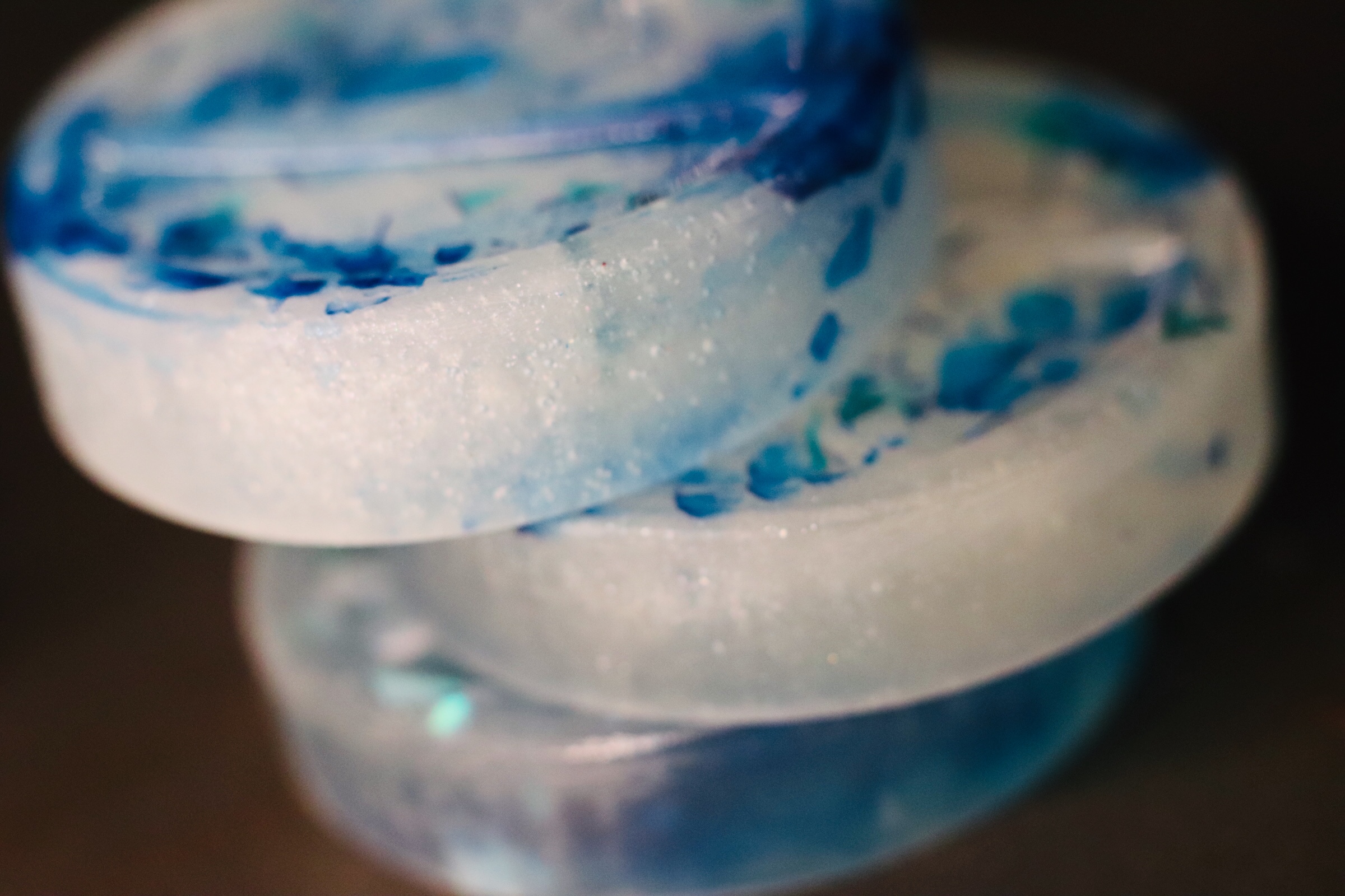

So Ive found that scuffing them up a bit gives the desired cloudy look i want. As you can see from the examples, the amount and the pattern of blue coloring will vary piece to piece, as it appears to be the case on the originals.

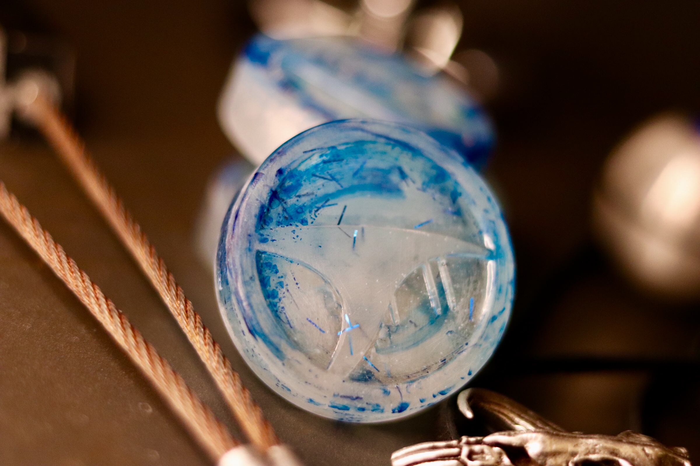

Got some beauty shots taken and preorder link setup! I have listed that these preorders will take 2-3 weeks but most orders will go out much sooner then that unless I’ve greatly underestimated demand.
