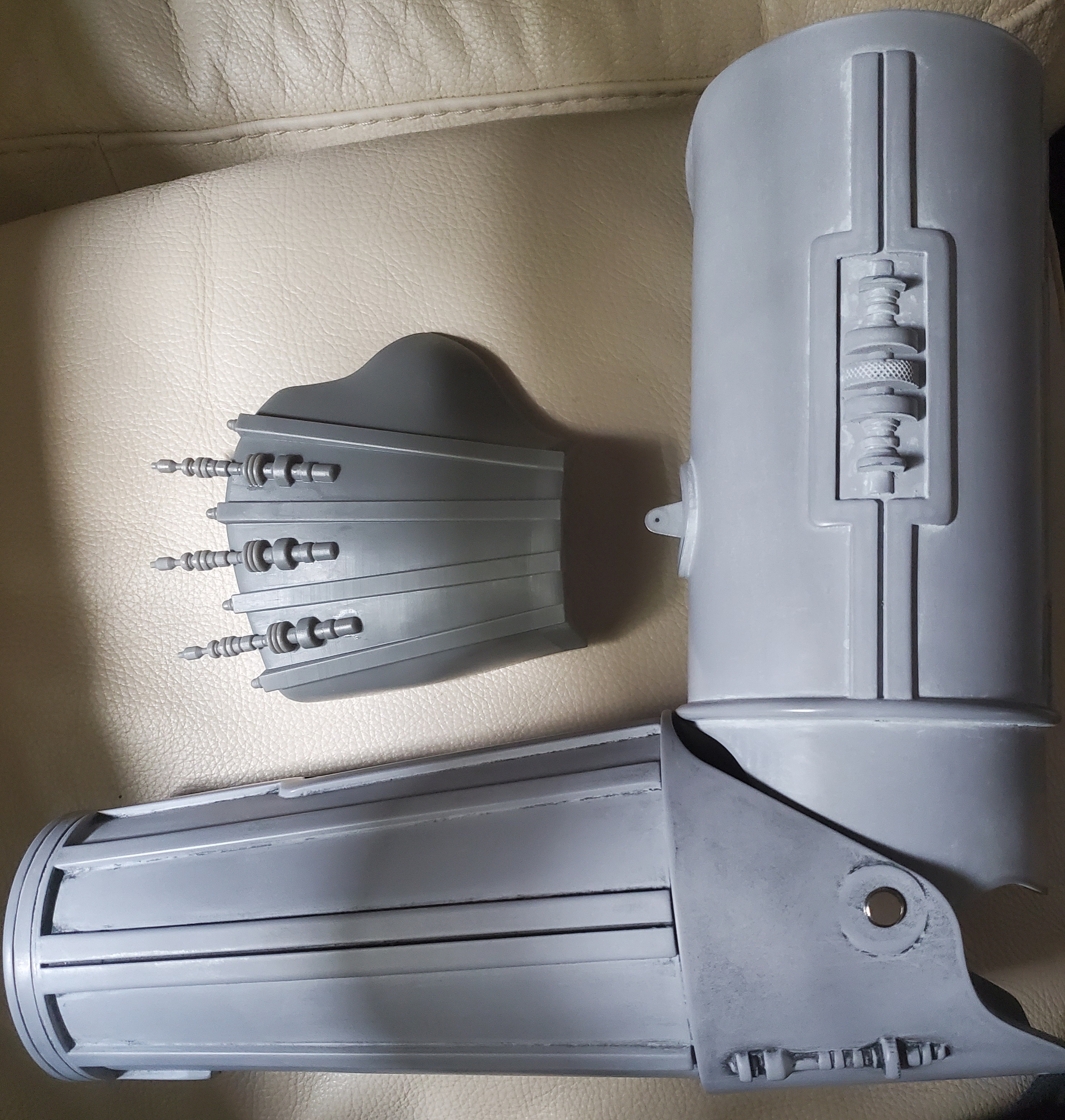

I switched to resin for 99% of my build. Remaking everything, as I've learned what techniques work best for post processing. Wasnt happy with my old attempts. Got a resin printer big enough to fit almost everything without having to split the parts.
Resin prints are way easier to sand, and the prints come out way cleaner than plastic fdm prints.
Here's a resin arm almost finished with filler primer. Just need to do a few touch ups to make sure there are no print lines left. Also a hand plate, not yet sanded.
Bicep was a file I made myself, to resemble the sequels version. Forearm was from the Jesse m files, but slightly modified.
There are some black areas faded on the arm, thats because I put black acrylic paint on it, but I ended up removing it, and there is some left over residue

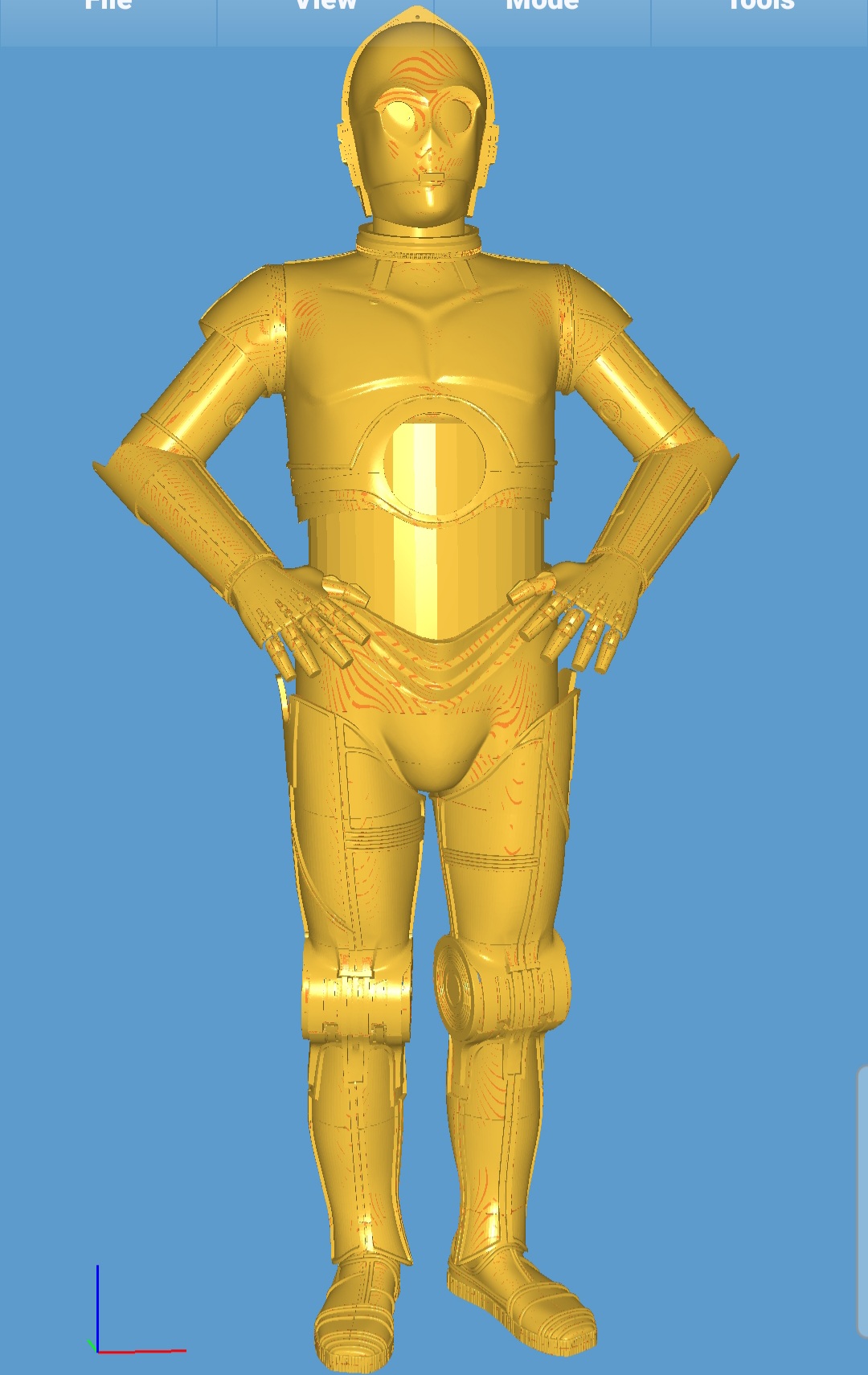

I put most of the files together, scaled in this mock up. So I could see how it all would look together with the shortened legs. So supposedly this is what I'll look like
