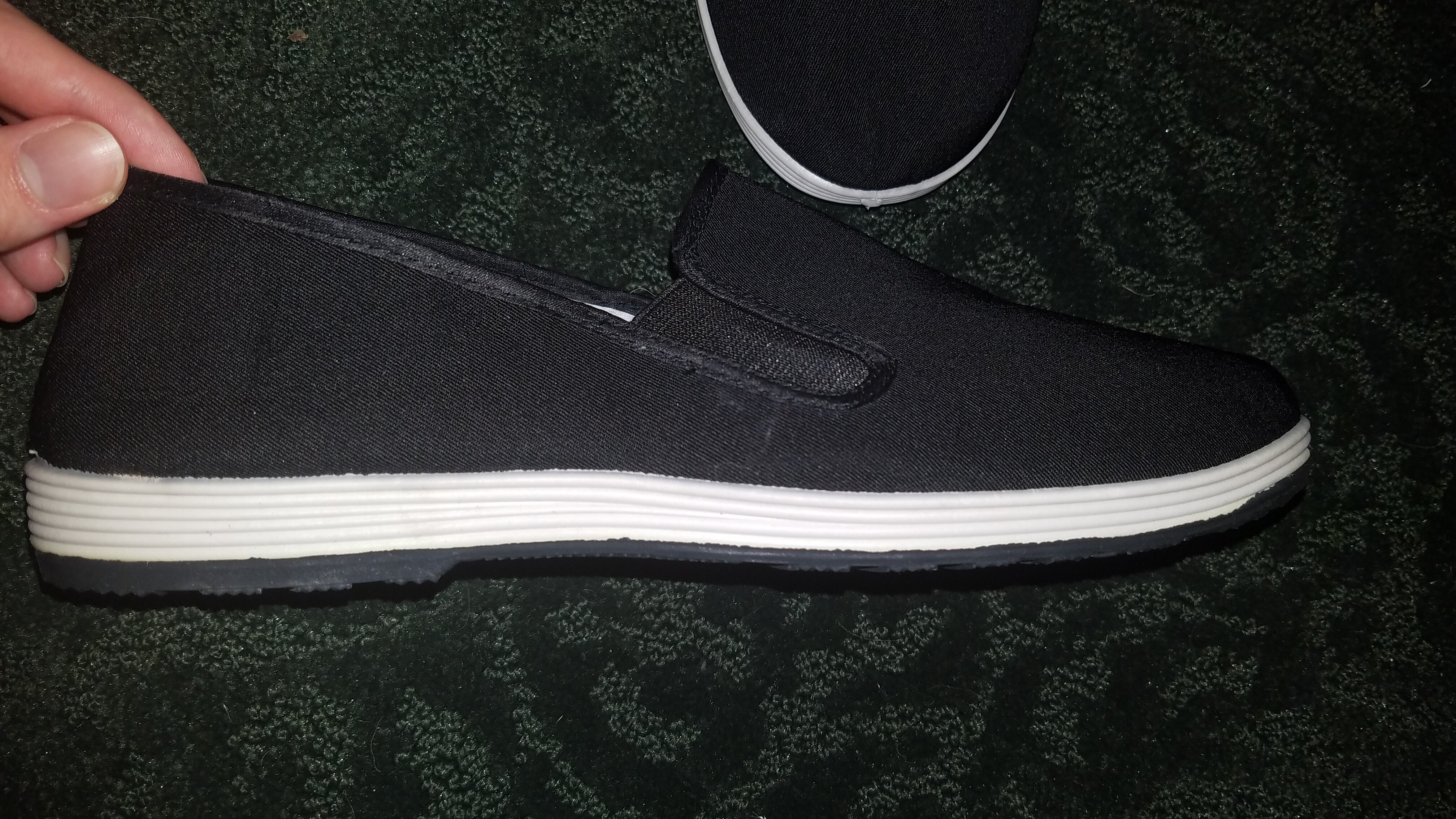

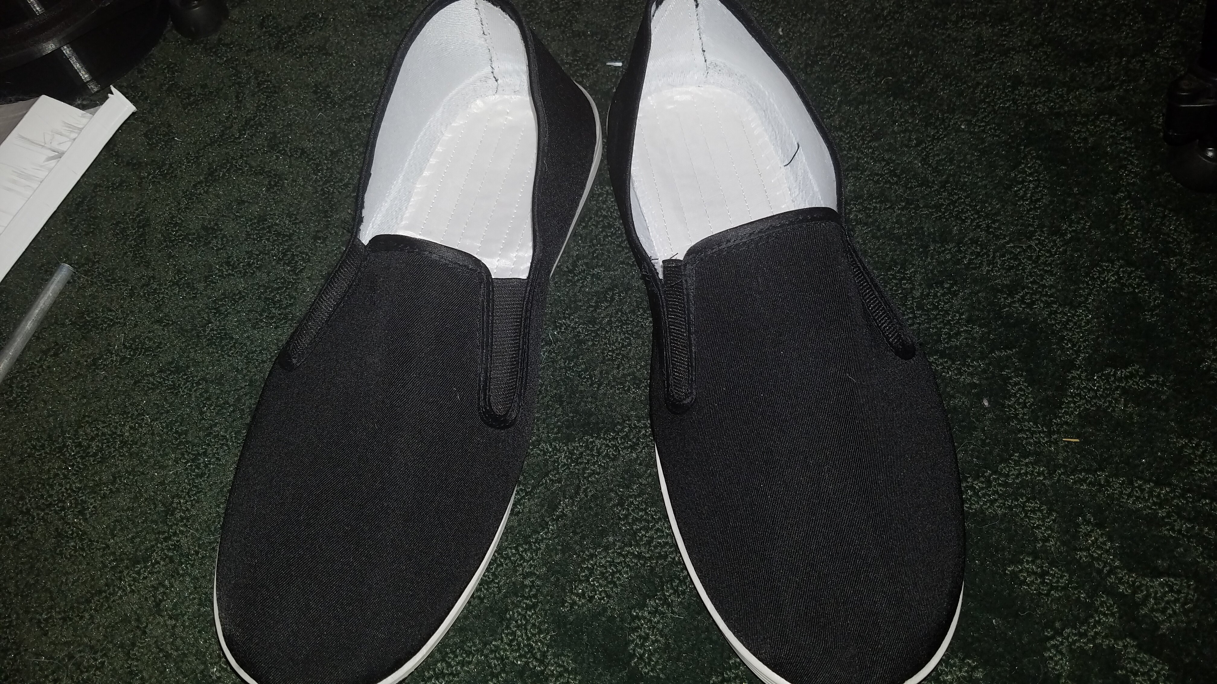

For the feet, I bought a pair of Kung Fu shoes from Amazon to wear underneath. The 3po feet will fit on top, without a sole.

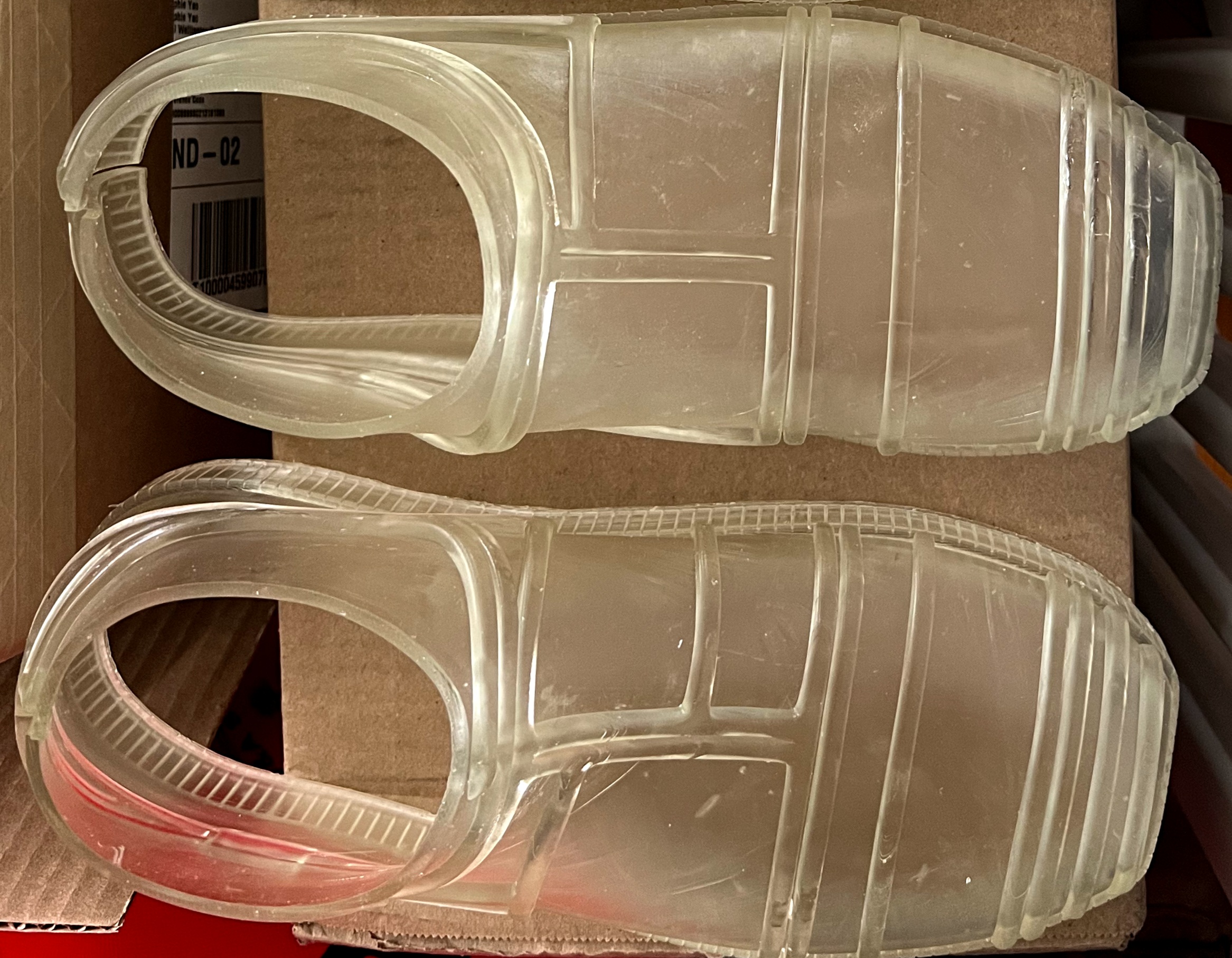

in order to be able to wear 3po shoes, I got rubber resin printed shoe covers!
