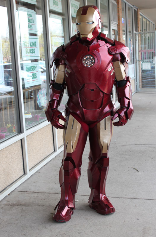

Here are some better lit shots of the suit. Yes, I know, the shoulders are on backwards! :lol

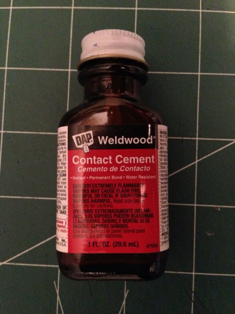

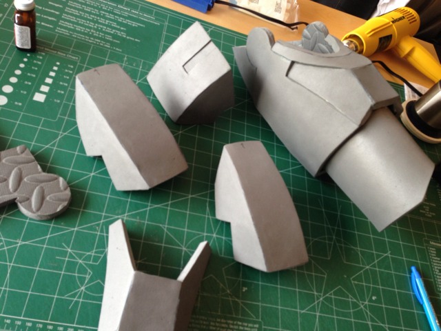

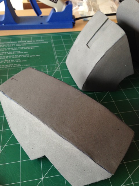

So, in the past, I've used the usual hot glue method to put the foam together. While this method results in a good strong bond, you have to develop the technique of thinning out the glue layer and compressing the seam when glueing for a nice tight seam when the glue dries. Even then, the seam doesn't always end up as tight as I would like and of course when you paint the suit, the seams stand out when painted.
In conversation with a friend who used to work in an industry that included attaching foam to wood. He directed my attention to a glue that not only works, but is nothing short of amazing.
It's called Weldwood and it's made by DAP. I got mine at Menard's here in the states. See the photos below of the glue and the resulting pieces I've used it on. The resulting seams are virtually invisible.
Very simple to use. Spread on both surfaces, wait 15 minutes and then place them together. Be careful when you do, once joined, they don't come apart. Ever.
Let me know what you think.
