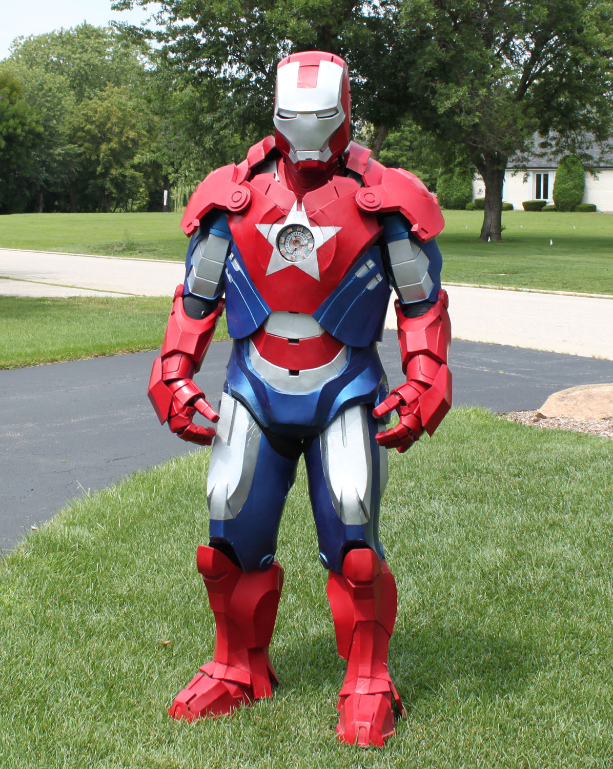

I used to use hot glue for everything, but discovered contact cement and never looked back. I use Weldwood by DAP and it's amazing. Best thing about it is that once the pieces are joined, the seams almost disappear. I'll then reinforce the seam on the backside with a bead of hot-glue. Look back through the thread at my MK4 Patriot suit. That suit has seen almost a dozen outings at this point and not a single seam has failed.

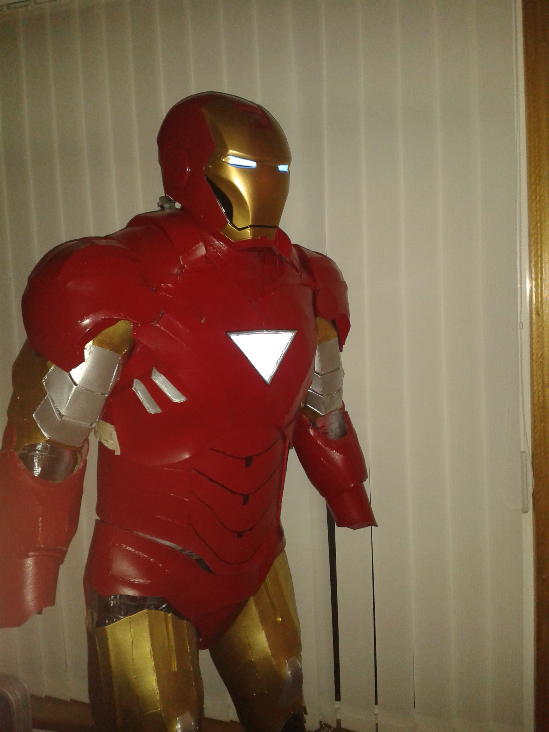

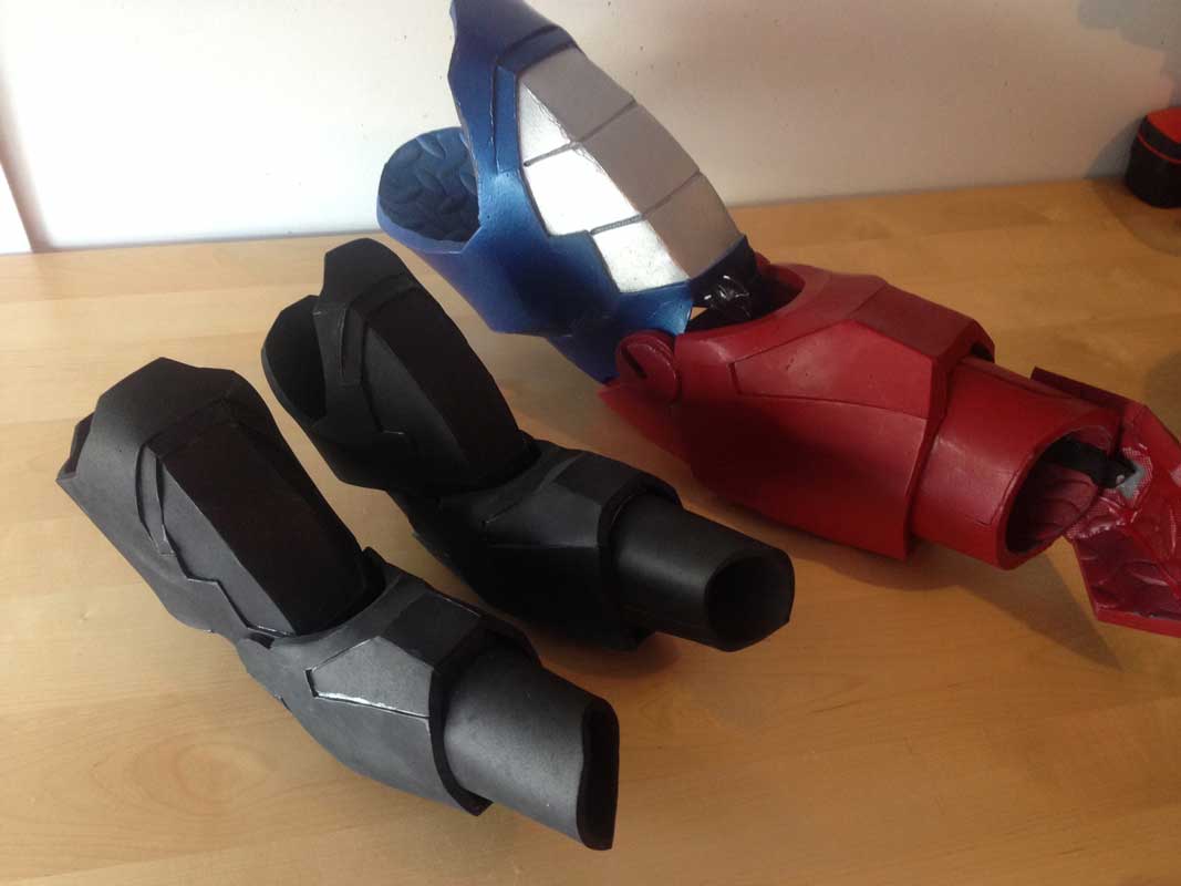

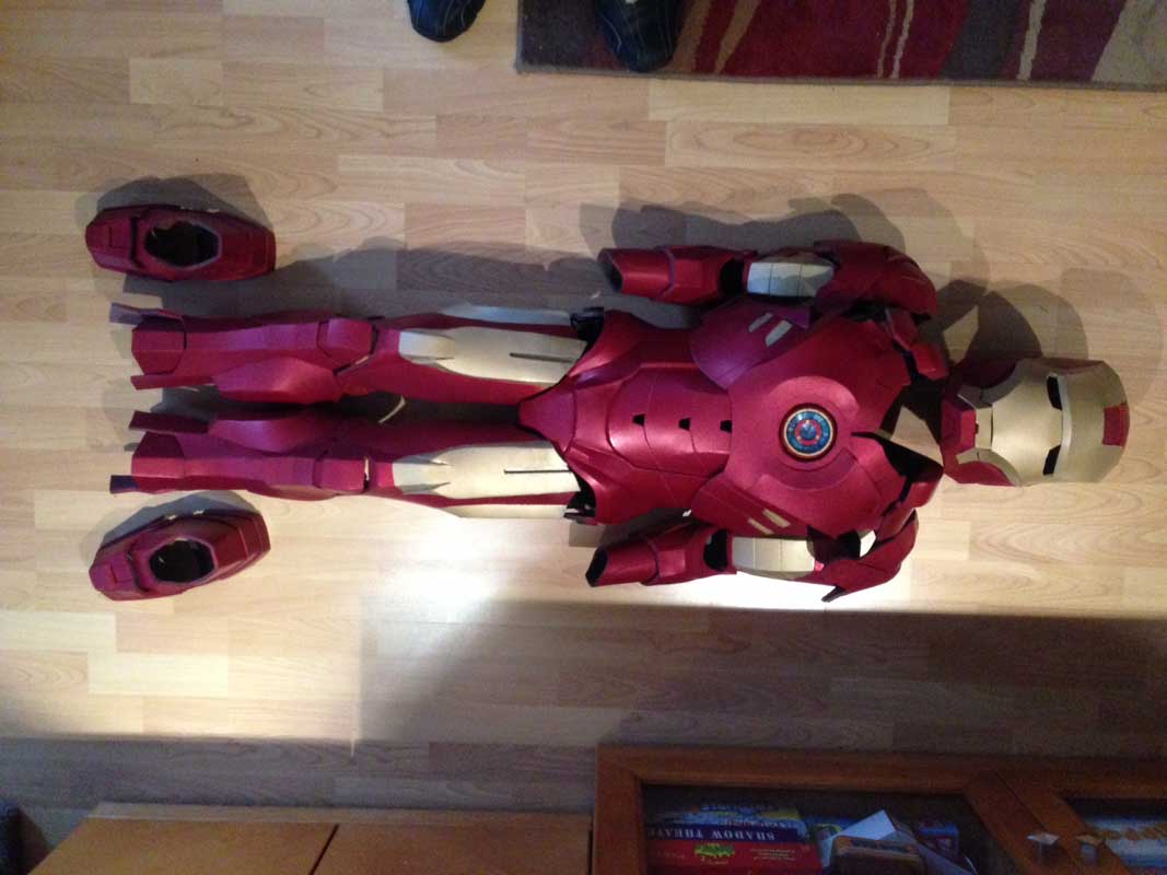

Here are some pix of my son's armor taking shape. A quick reference shot next to my Patriot arm for reference in size. Lol, a bit smaller, eh? Also, couldn't resist throwing in a pic of my two suits. Going up on Ebay shortly to make room for the new ones!

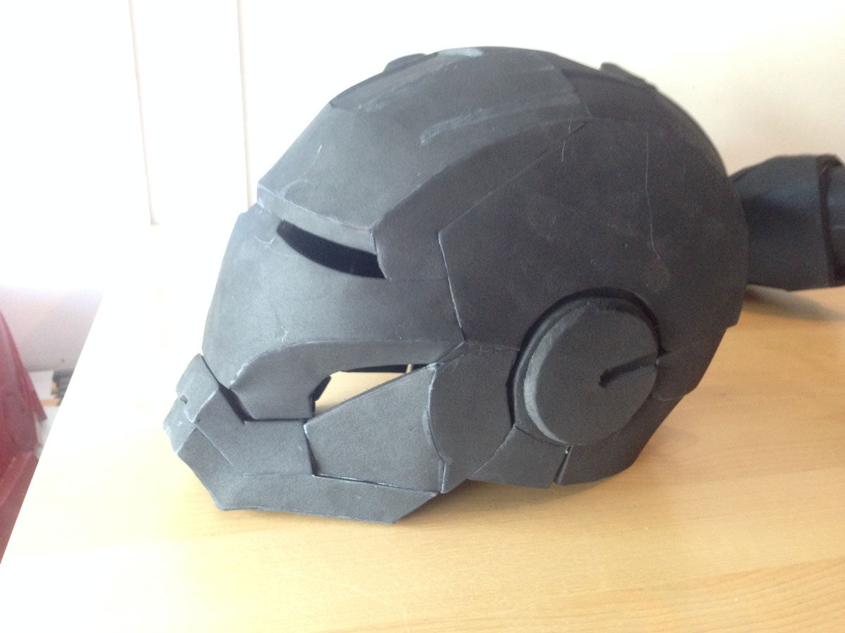

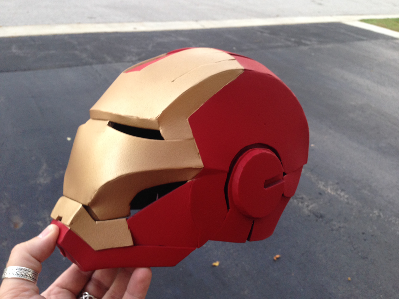

Paint test on the mini-helmet. Humidity sucks in Chicago! Going to redo the helm since it's a bit small anyway.

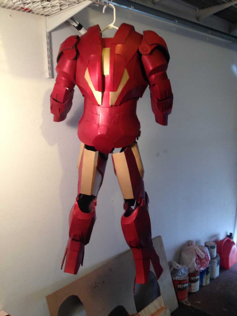

Ok, updates from the weekend:
By the way, that chest plate center was made with one piece of foam and some strategic cuts. :)

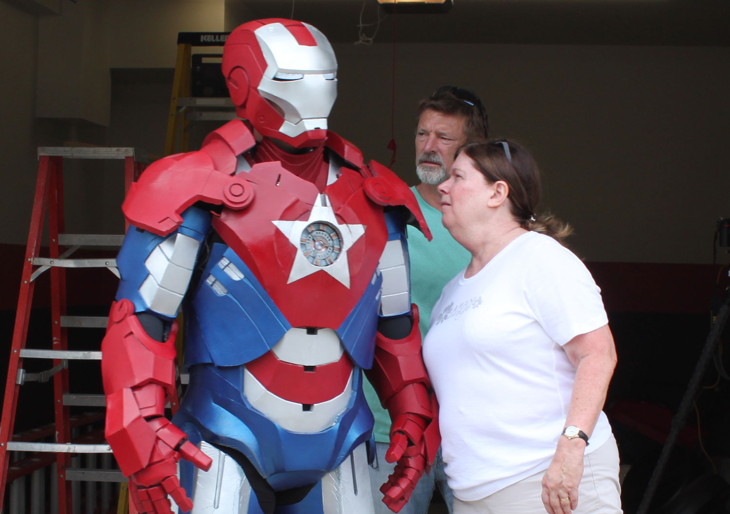

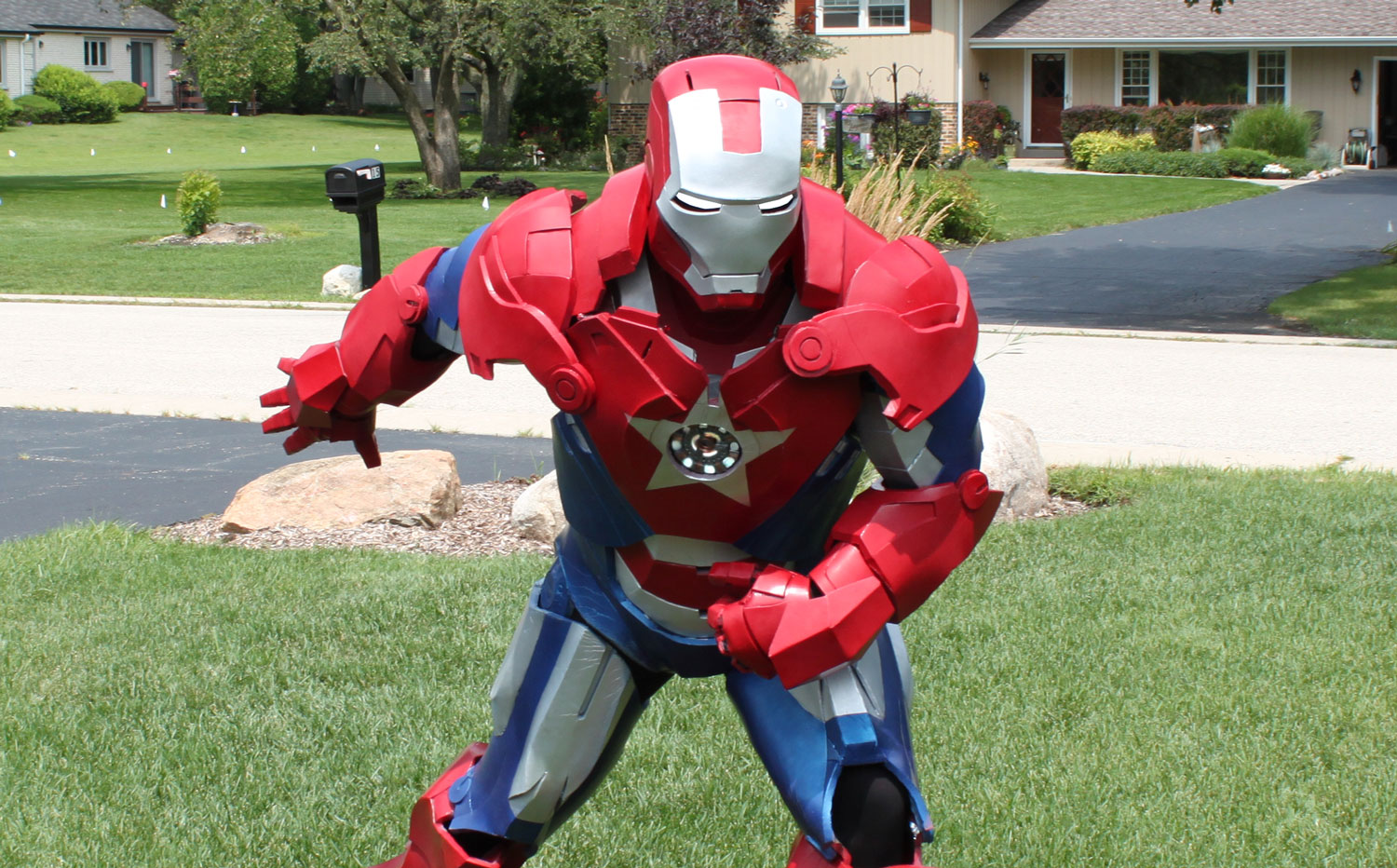

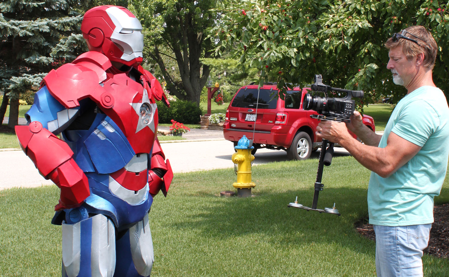

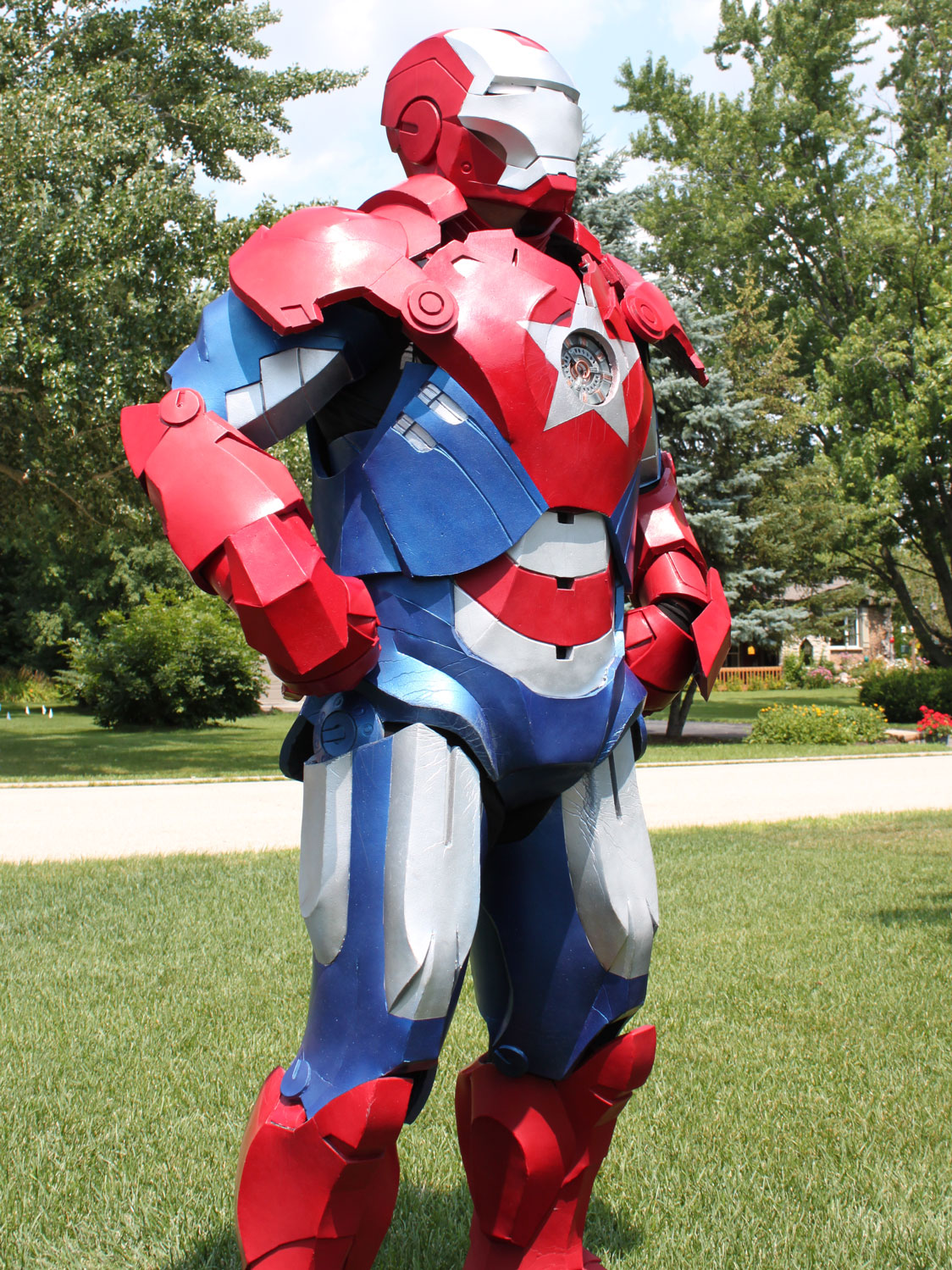

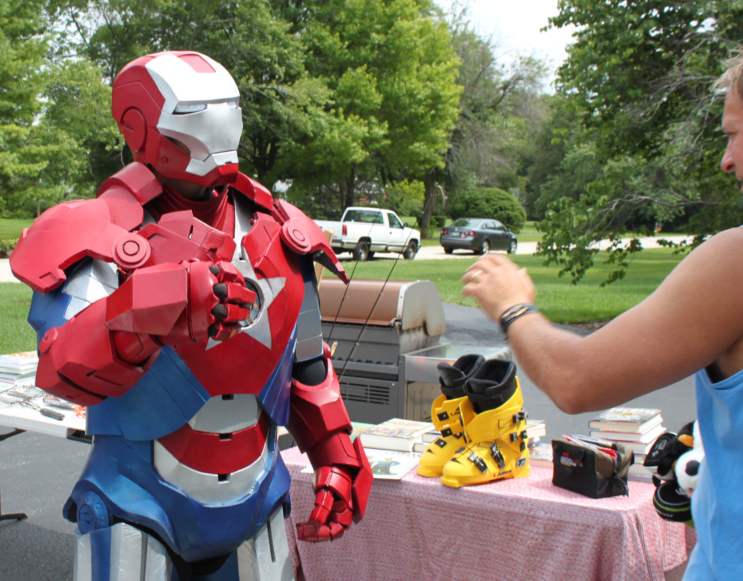

So, the MK 4 Patriot had a starring role in a video promoting a client's business. We'll post a link to it when it's complete. In the meantime, here are some stills from the shoot.
View attachment 215835View attachment 215836View attachment 215838View attachment 215839View attachment 215840View attachment 215841View attachment 215842
Wow....that is one mean looking suit....bravo and congratulations on the shoot. You've done a good job and have provided some very useful advice for those who are still beginning or mid-way through.

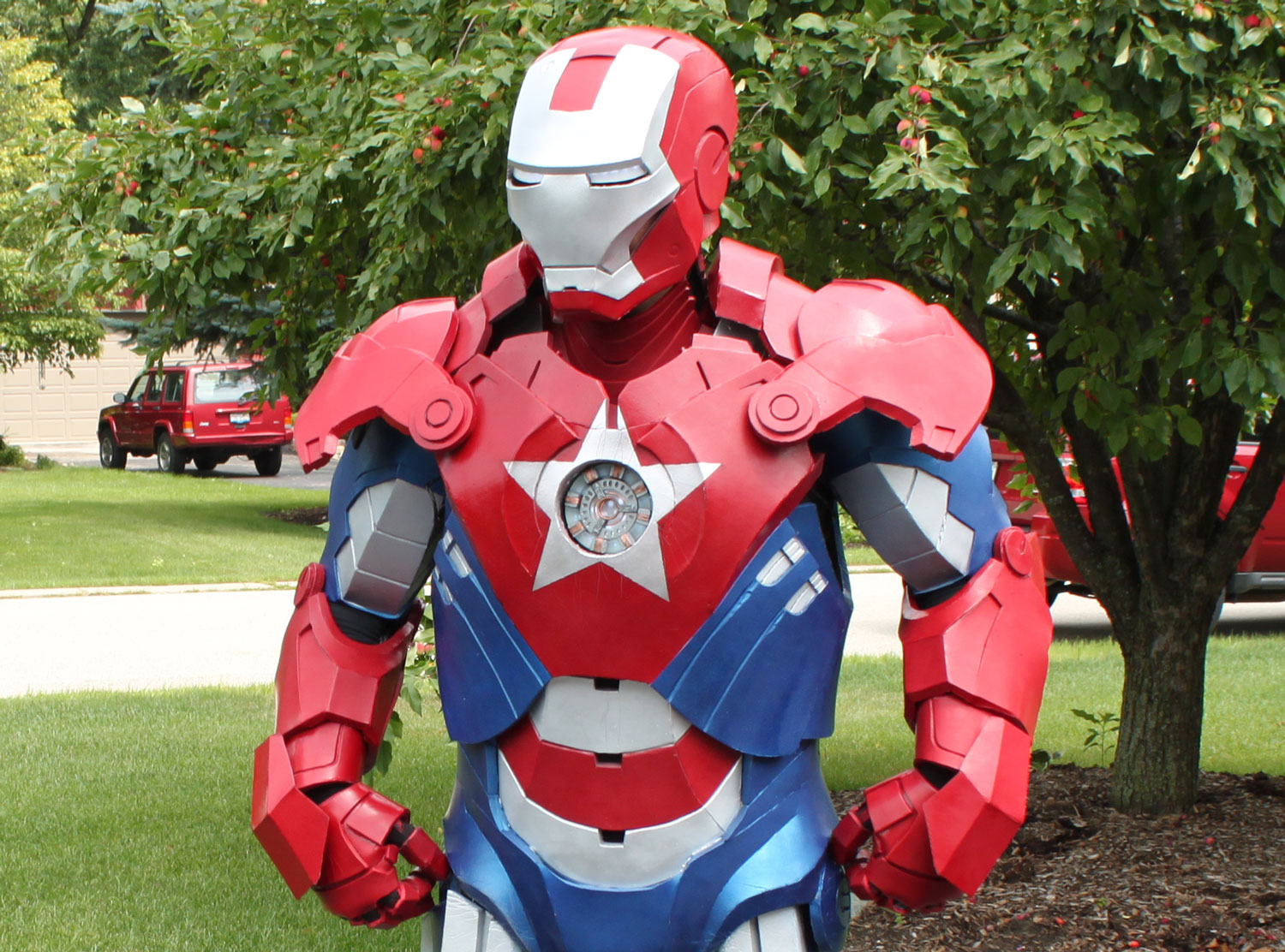

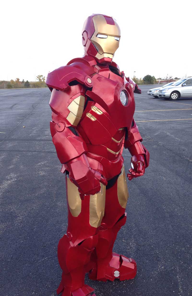

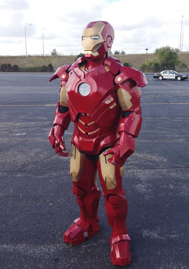

Thanks! And now for some pics of my most recent "contest-winning" suit. Worked a shot of my wife as Black Widow in there as well!
IM-2013-001.jpgIM-2013-003.jpgIM-2013-Angels-001.jpgIM-2013-Beetlejuice-001.jpgIM-2013-Joker-001.jpgWidow-2013-001.jpgWidow-2013-002.jpg

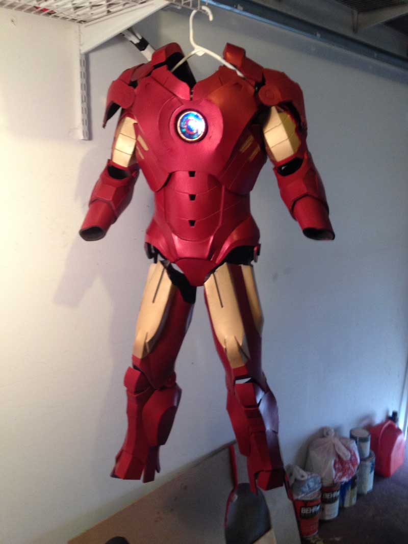

Now, here is my son's suit. He's 12 and stoked about being IM for Halloween.
For size reference, here is his arms with one of mine:
By the way, this suit was speed-painted (a little behind on time). I went with 6 coats of Mod Podge, 2 light coats of SEM primer, 2 light coats of paint, and 2 light coats of SEM clear. Other than some blushing in the paint due to high humidity (again, no time to wait) the finish came out quite well all things considered. And no cracking!
