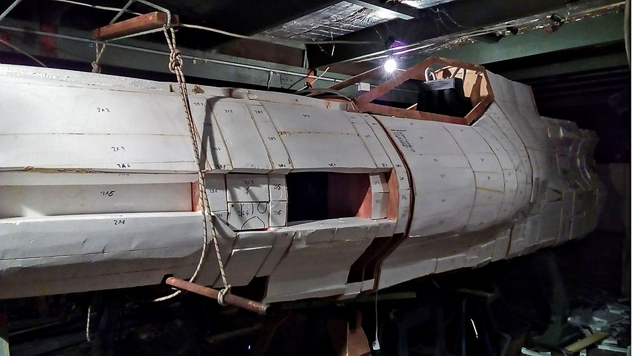

Tonight I managed to get module two into position at full height with some creative rope-work and careful chocking. Made a sturdy frame under it that bolts to the saw-horse so it shouldn't drop on my finger again.

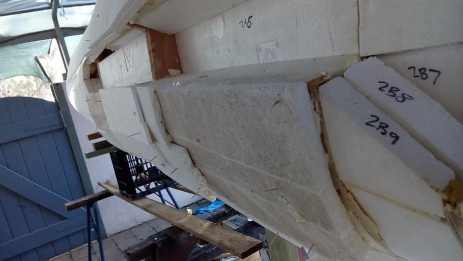

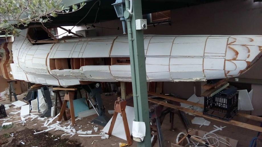

I spent most of today and well into the night working on skinning the Viper fuselage. Got most of it done too. Polystyrene everywhere! Big job that I've been putting off, but it's been a day well spent.
I also stuck on some layers over an erroneous contour between modules one and two, caused by an undersized former at the end. Not sure how it happened, but I've build it up and will sand it back to correct the line later. Toothpicks proved very handy to hold the layers in place while the glue went tacky.

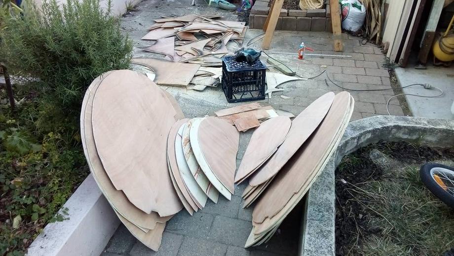

This morning I got two sets of engine formers printed, stencilled and cut.
Thanks to my friends Patrick for the CAD drawings and David for the packaging ply. I had just enough to get them all done.
