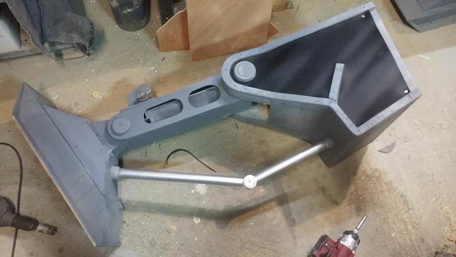

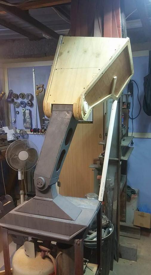

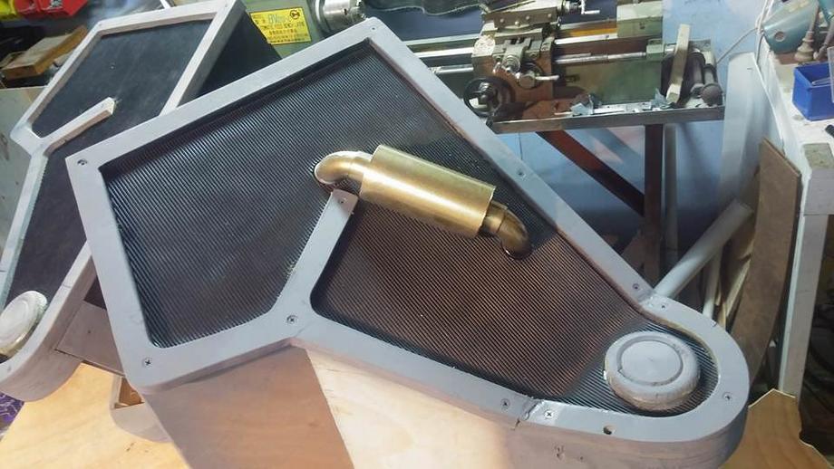

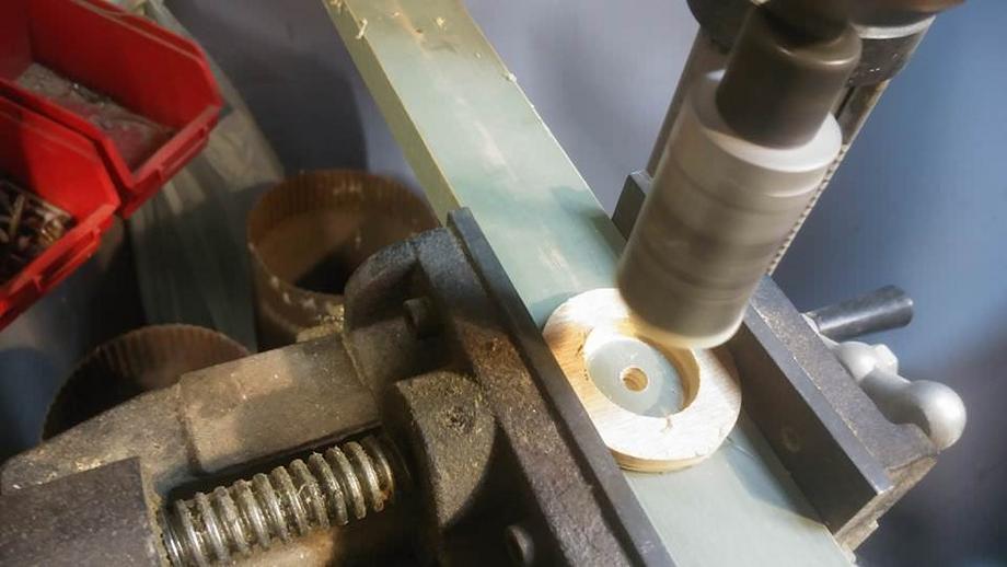

Adding details.

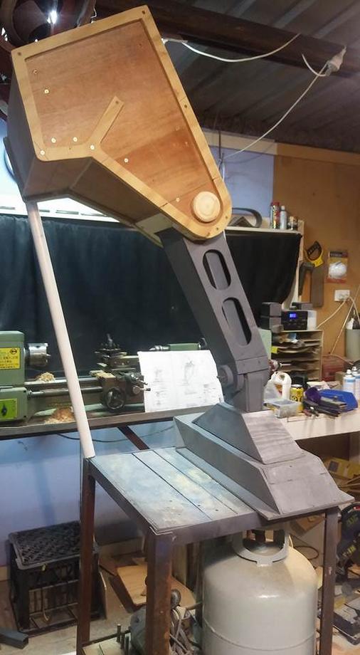

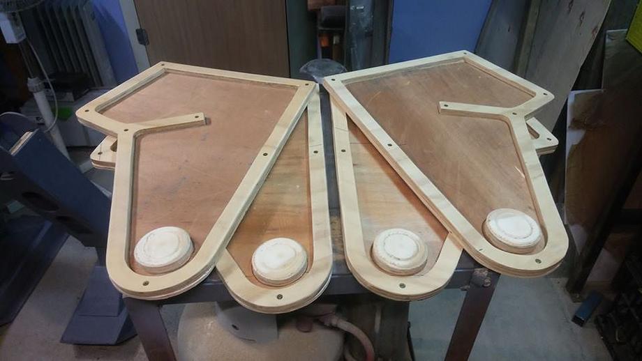

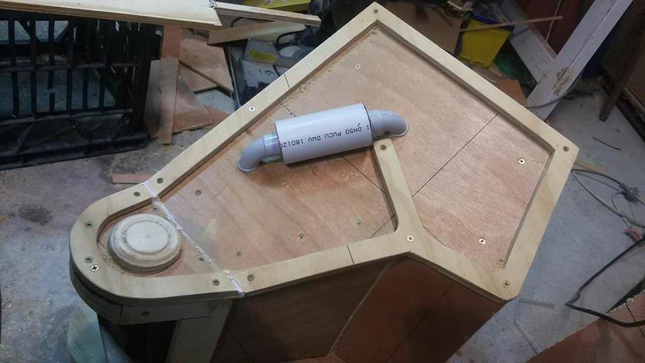

A little neater this time, cutting the edge trims from a single piece, rather than using strips.

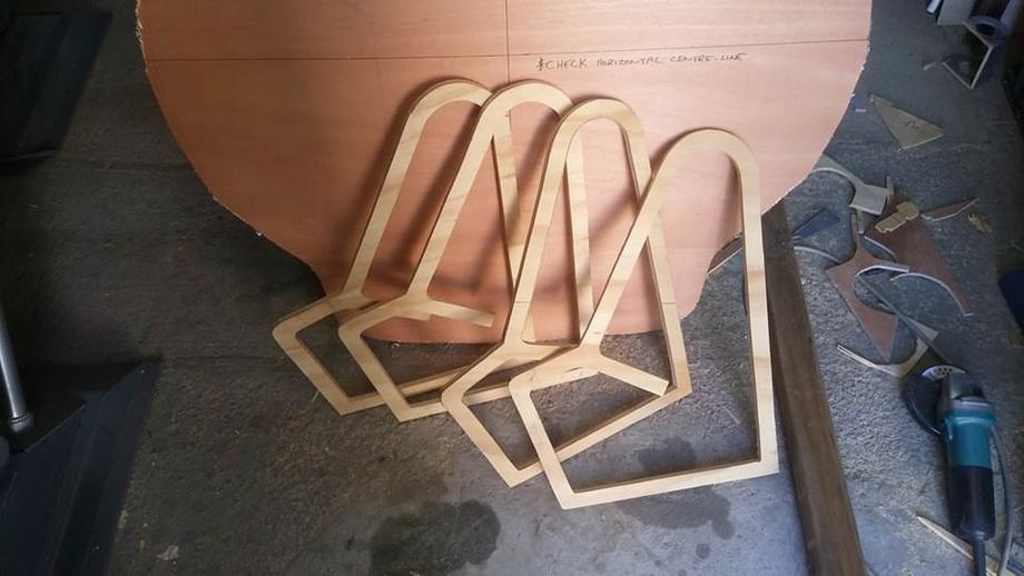

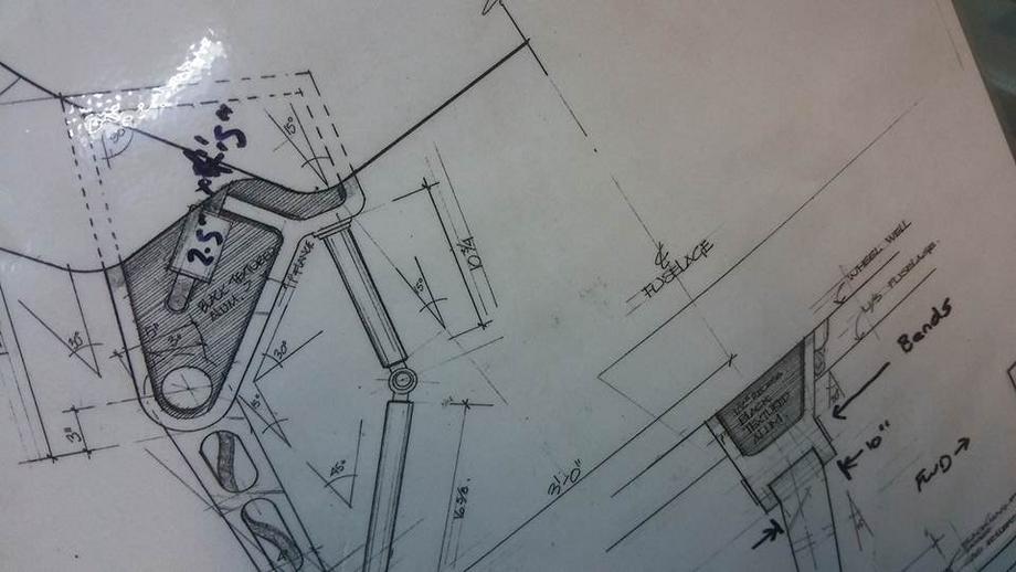

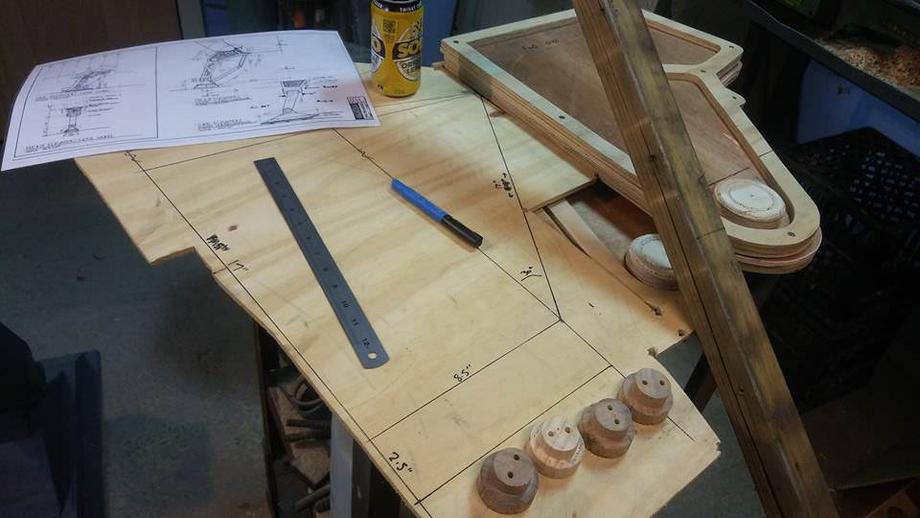

The back legs are confusing to translate from the technical drawings to reality, but I'm getting there. The difficulty is that there are so many weird angles to get right. Hardly a plumb aspect to it and few 90 degree angles. At one stage, idiot stupid me made both cowlings the same instead of mirror image! GAAAHH!!!!
I would have a much easier time of it if I could afford decent quality wood and a big variety of thicknesses to choose from. Unfortunately, a lot of the wood is second hand, poor quality and I have to do it in layers. Lots of layers means lots of cleaning up to get them all the same. Freehand with a jigsaw is hard to keep accurate to the drawn lines, so finishing off with a flap disk then hand-sanding to make it all look like one piece once it's painted. A little bit of putty goes a long way, but paint hides all manner of sin.

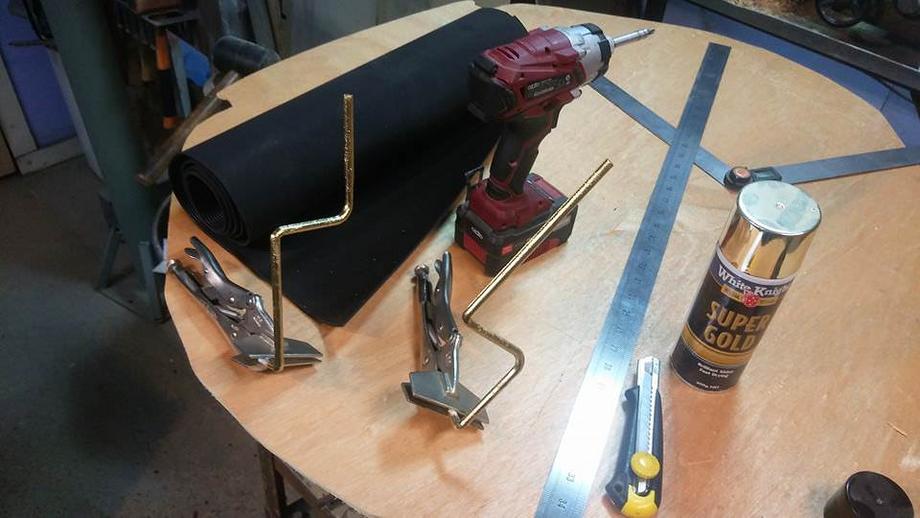

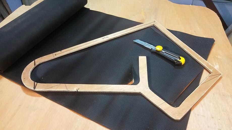

Thanks to a new social media friend named Sean, who kindly provided a long off-cut of rubber mat to simulate the texture of the technical drawings. Preliminary fit shows it is easy to cut and trim using a knife, but will need some contact adhesive to lock it down flat.

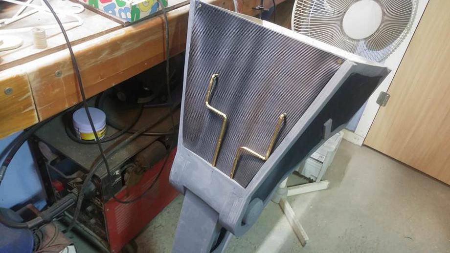

After contact adhesive. Lovely and flat.

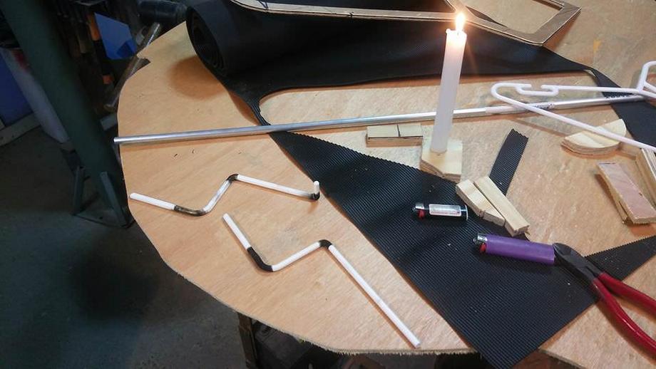

Adding hydraulic lines using plastic coat-hangers. (Still gotta glue down the rubber mat.)

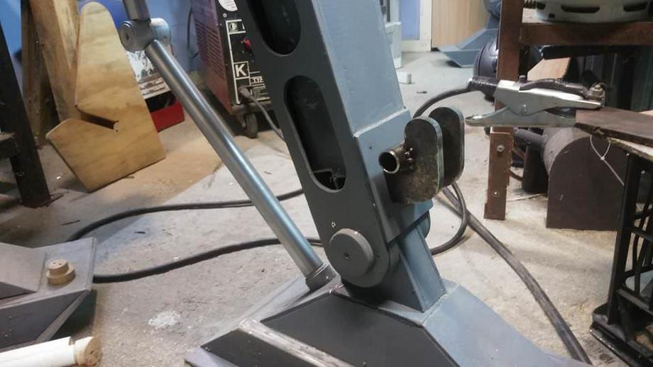

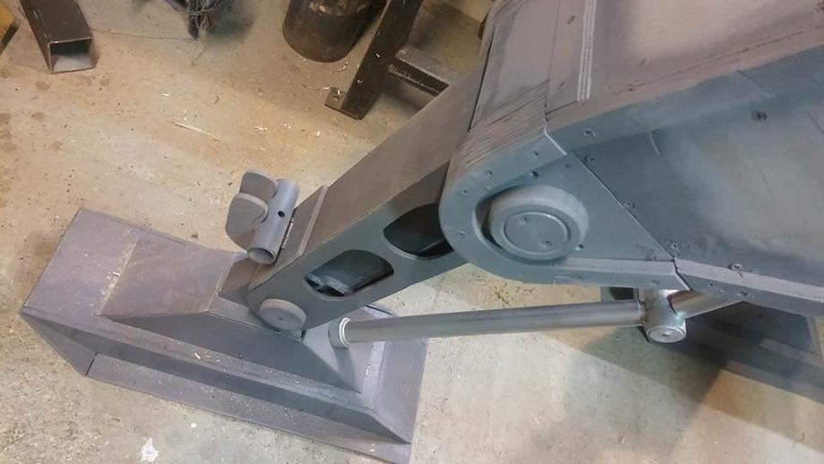

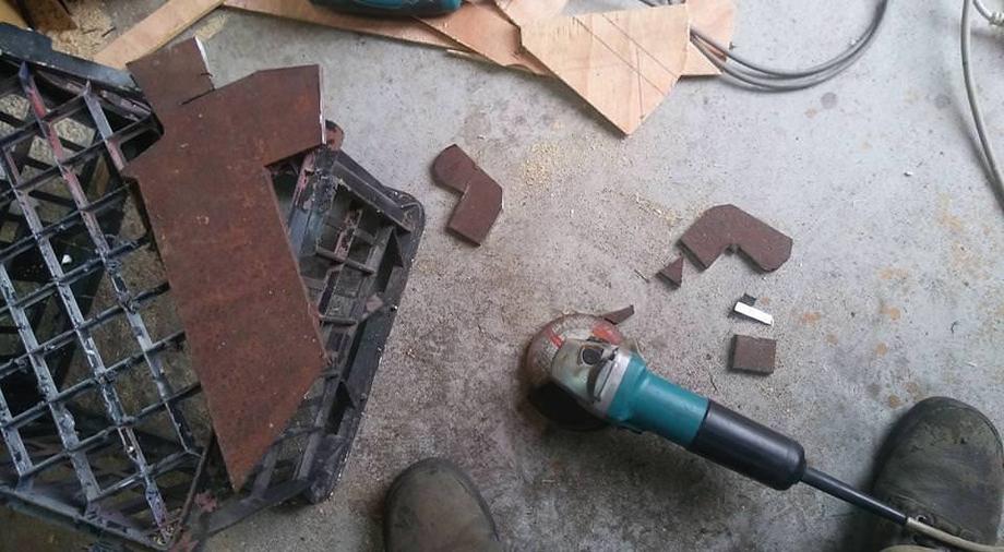

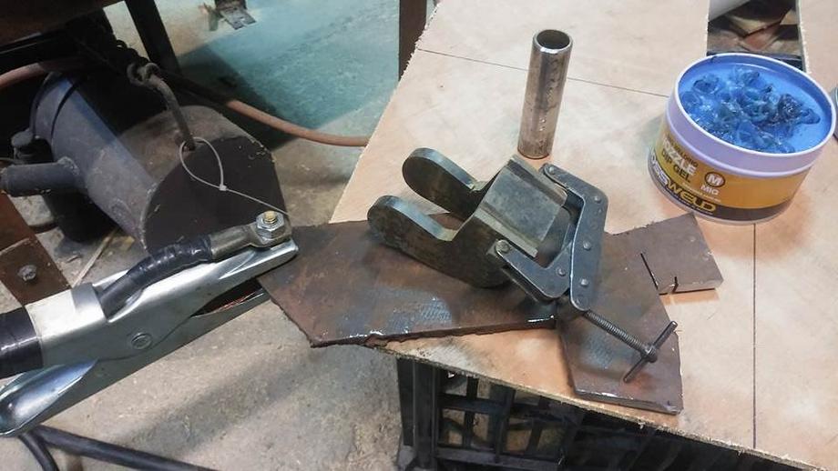

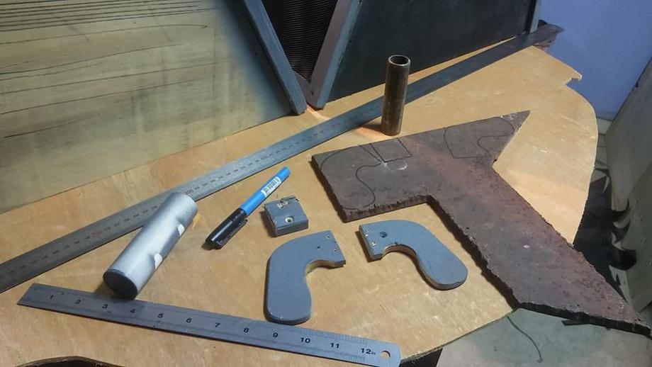

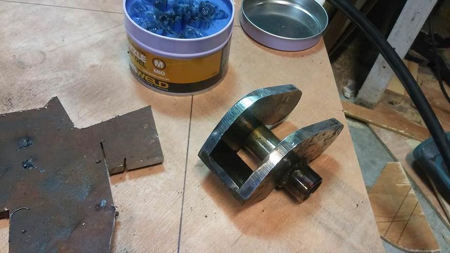

Replacing the catapult linkage. I’ve kicked and broken the plywood/plastic one twice now, so it’s time to replace it with 10mm plate steel and steel tube. Strong enough to sling-shot a Viper out of a launch tube!
