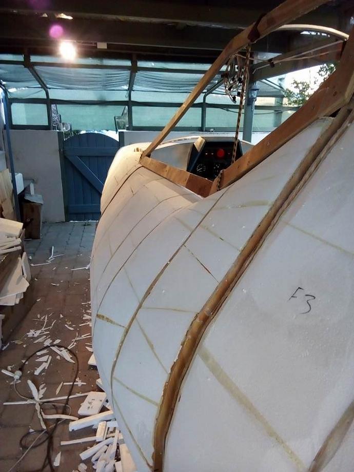

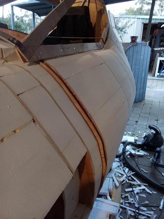

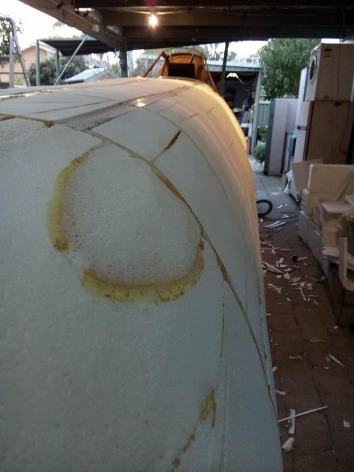

OOOoohhh that sleek, sexy shape! A couple of hours of sanding has produced spectacular results.

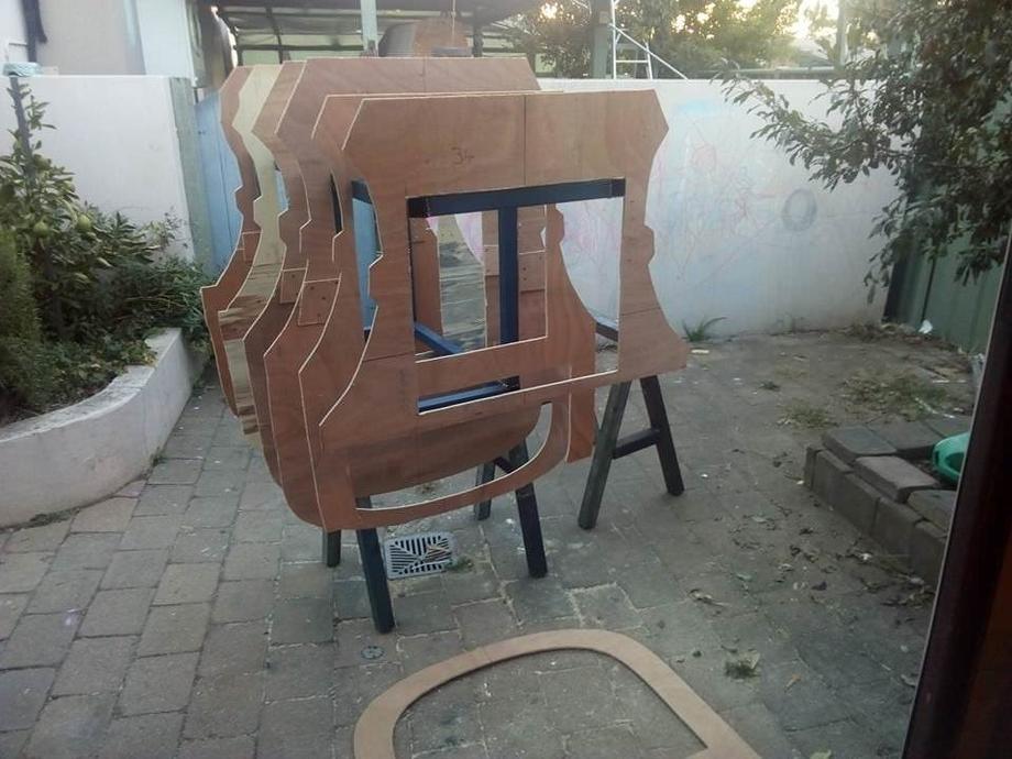

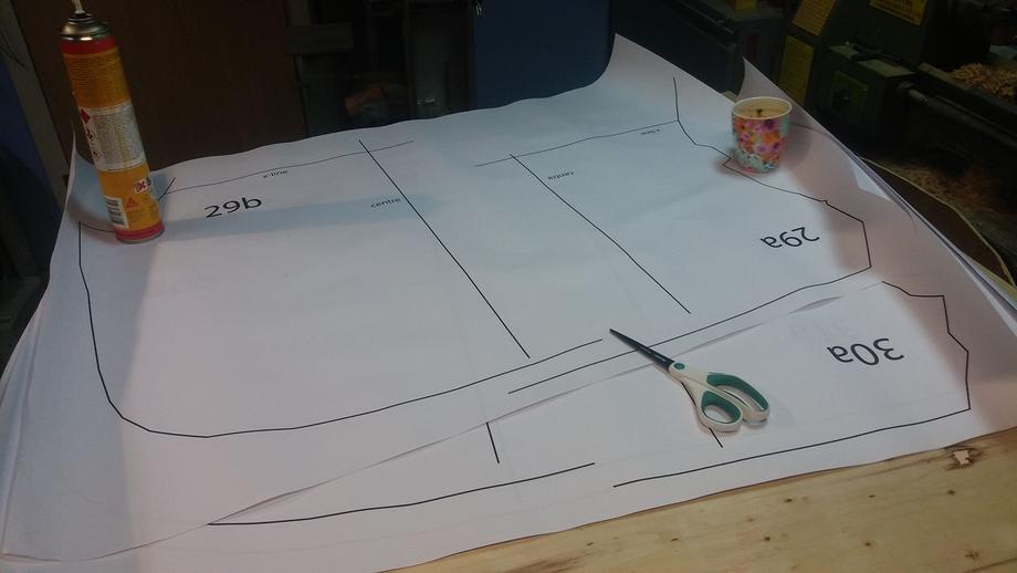

Also got the template plans for the last set of fuselage formers. Engines next!

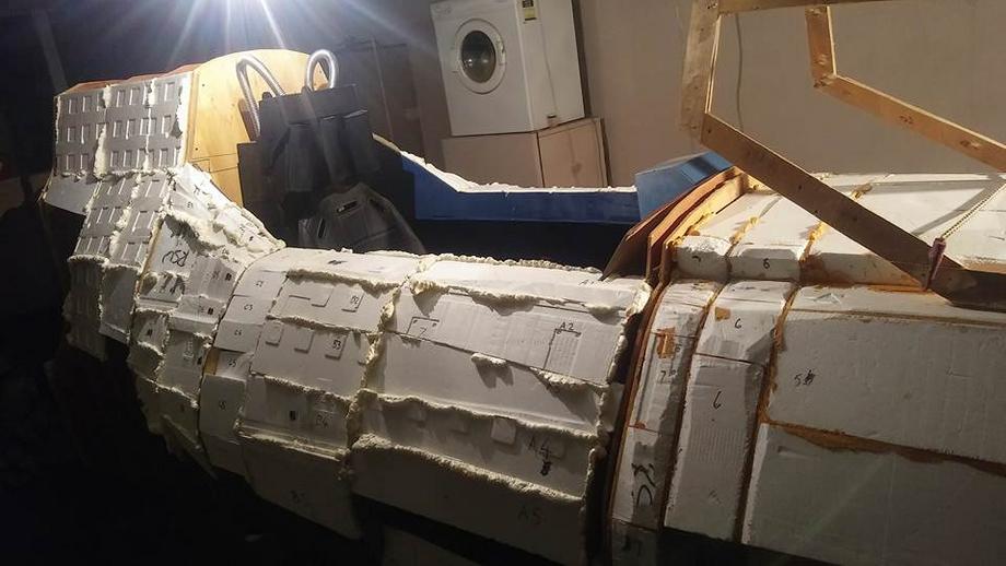

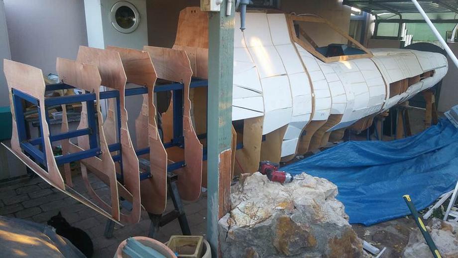

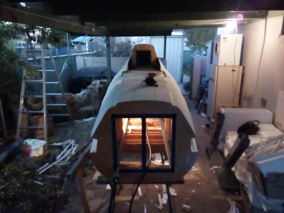

The last fuselage module, (5) is now assembled, attached and ready for bracing and skinning.

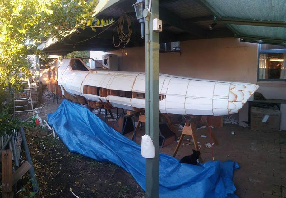

This is really fantastic. Is this always going to be outdoor, or do you have another location for it when it's done?
As this is the internet, I also have to notice the cat. Yours?
Great build mate:cool!! Now, my question: do you have enough space, between ship and ceiling, to put that top engine?
It's modular so I can break it up, tip each piece on it's end and store away. Yes, cat is mine.
Thanks mate. No, I don't have room for that, but the ship will be relocated before I get to that.

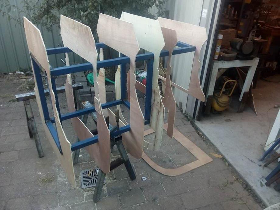

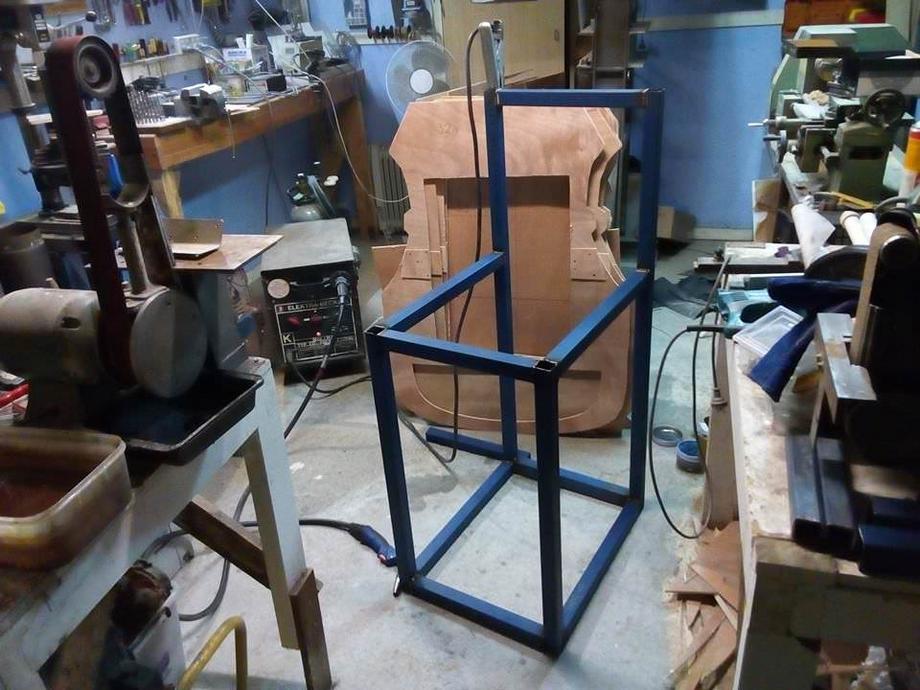

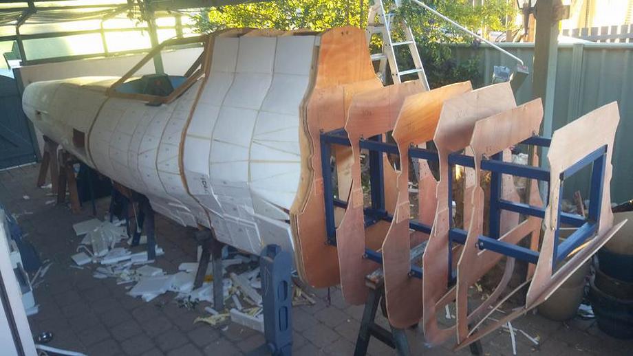

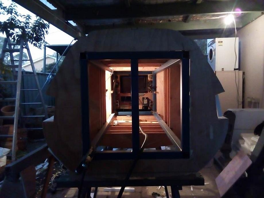

I have a bit of welding to do inside, that I've been putting off.
Some alignment lugs at each opposing end of the modules where they meet.
Feet under the cockpit that come all the way to the skin, so I can rest it on a pallet and frame without breaking it.
Frames at the bottom of the first and last former of each module, so that if they are dropped during assembly, they don't break on the ends.
Finally, some rings welded under the frames that I can slide poles under. through the sides of each module, for manual handling and positioning of the modules during assembly and disassembly of the ship.

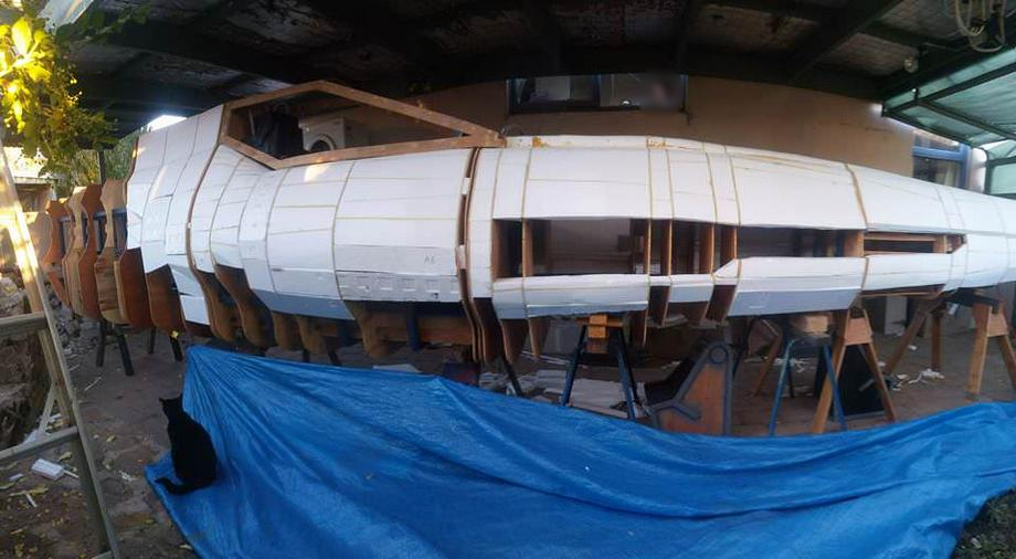

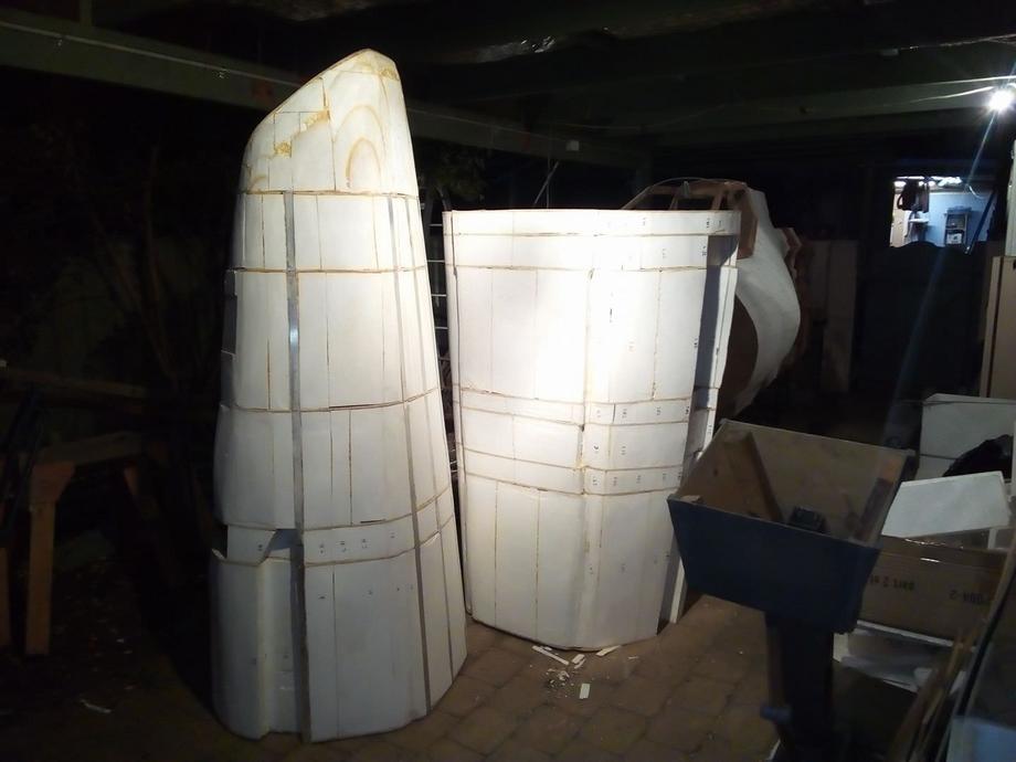

Photo showing modular sections on end for transport and storage.

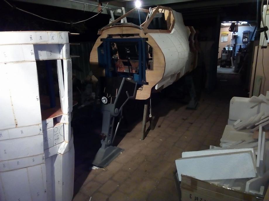

Tonight I welded support rails under the chassis frame and raised the fuselage to correct height. Now I can work out the landing gear attachment points. I've been putting this off for a while but it has got to the point now that I have to do it because the build is progressing way faster than I thought it would. Having the fuselage higher will also make it easier to finish skinning the underside.

Do you know the methods used to build the real prop? I feel like I read they carved the whole thing out of monolithic blocks of foam and then skinned it and added the framework and structure later. Sort of the reverse of your method?
I had a friend whose Dad built boats for a living, they built it with a wood frame and then used foam.When they had the shape they wanted they fiberglassed the over the foam to make the shell. When the Fiberglass was done they stripped the foam out. Then they built the inside.
@Lt Washburn, they used formers like I am, but once the solid blocks of foam were carved using the formers as guides, they were removed and the blocks glued together. The skin was a spray-on polyurea that formed a hard coat on the outside of the foam. Struts were drilled/forced through to reinforce parts of the ship and to provide attachment points.
@13doctorwho, My formers will stay in as my foam is only a thick skin, rather than a solid block. Once the fibreglass is on, the foam could be pulled out, but there is really no point. It will stay in as well.
Did they compensate for the missing formers, or did it get glued together smaller?
Well, the foam could make it sea-worthy!
