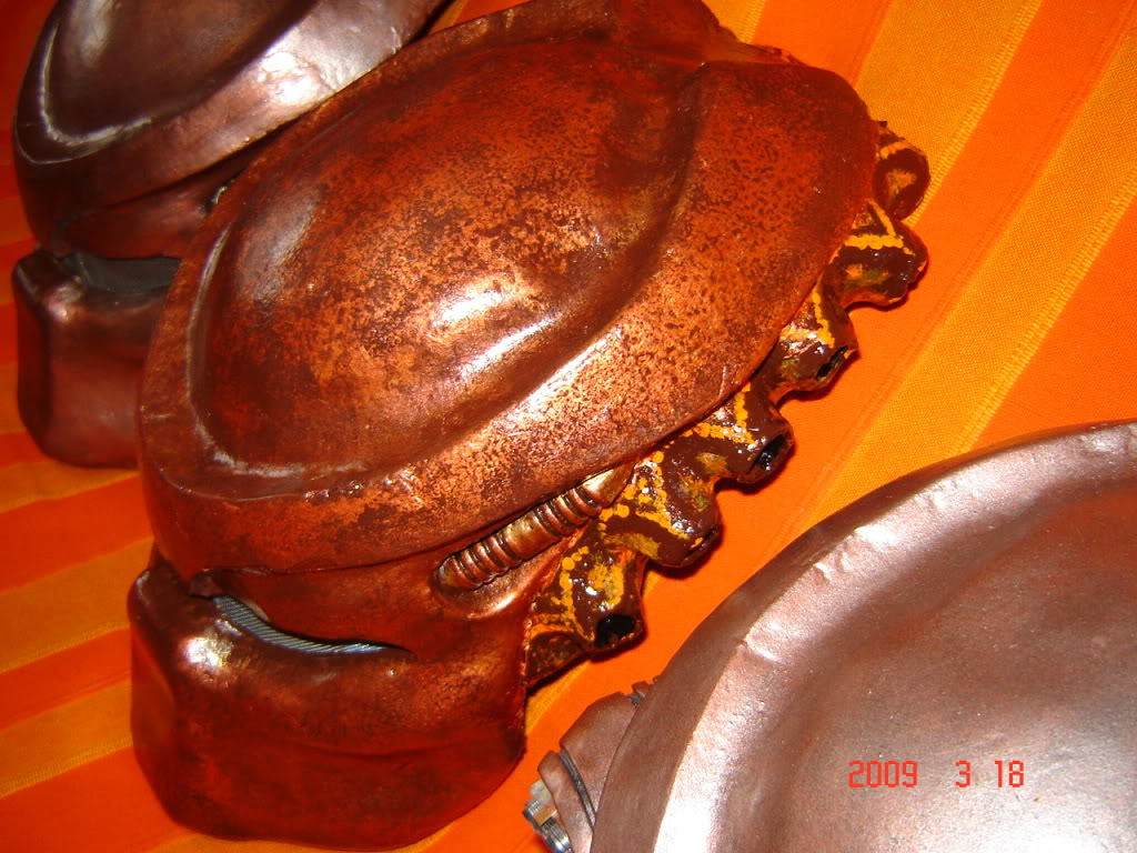

you got that , after all this story you remove the cardboard , the first layers of plaster , the plasteline ,all! this way you obtain a shell of plaster bandages but like I said you better give it strenght with a layer of resin!
about the way you put dreads on it ;I made something like that but it's quiet complicated and I don't know if your biu will sustain entire construction!
here is the way I made it ! I sculpted in clay directly on the bio, I made a shell of plaster and after that I removed the clay and obtain a mold ,in that mold I casted a special very sticky silicon!
maybe you can try to apply some expanding foam around and after is cured sculpt in it and paint it with acrilic colors!
bit first do the bio and we think together about that ,maybe somebody comes with ideeas?!
