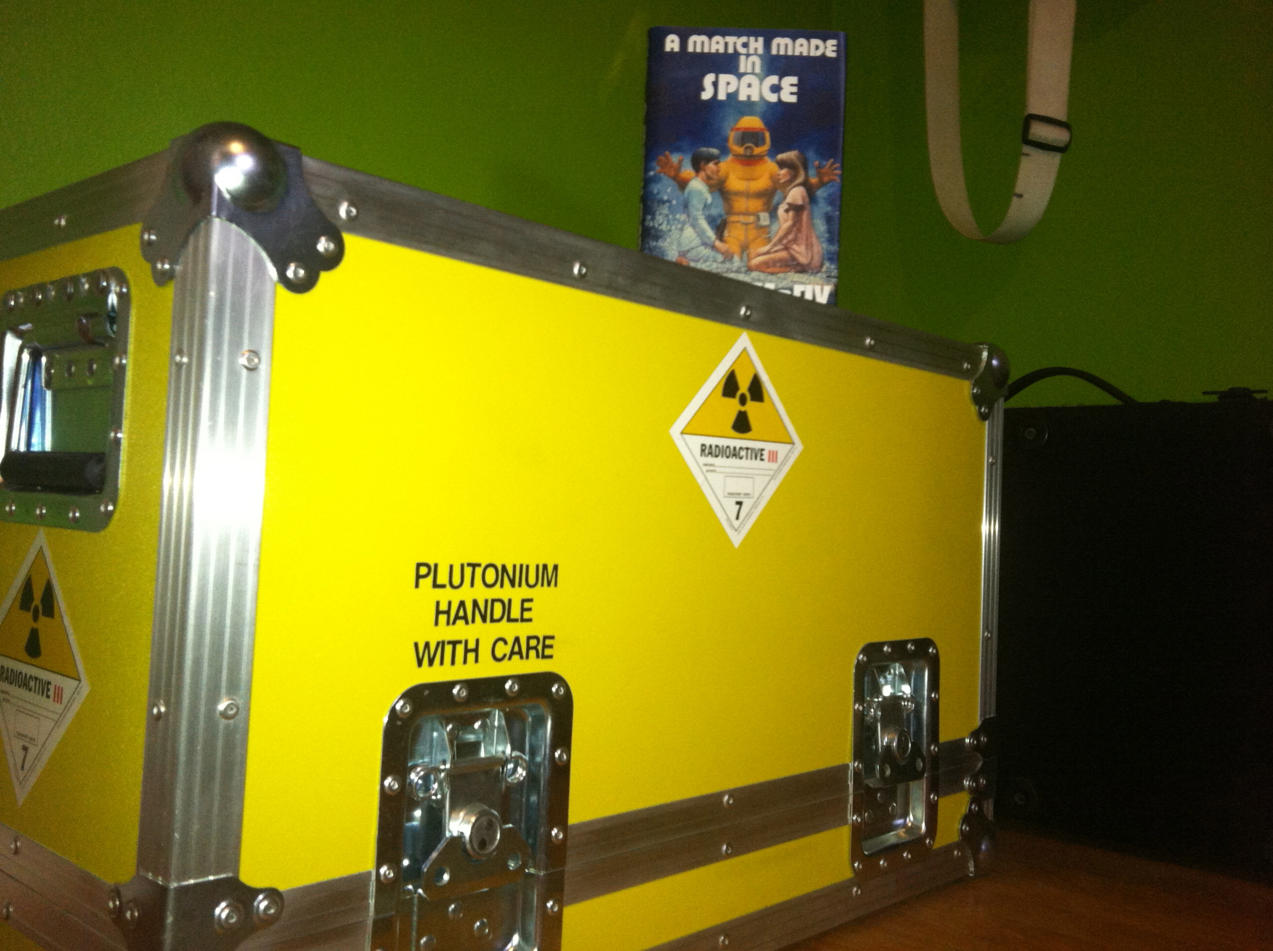

Here is my Plutonium Amp Case. It isn't screen accurate as it actually houses an old Fender Dual Showman Reverb. So it is more of a tribute case.
The lettering isn't perfect but they are just the vinyl letters you get at an office supply place. 1/2 inch vinyl letters. The lettering tip came from Brandomack.
Thanks to everyone for tips and inspiration. Now I just need to order a plutonium cannister and find a remote control or camcorder.

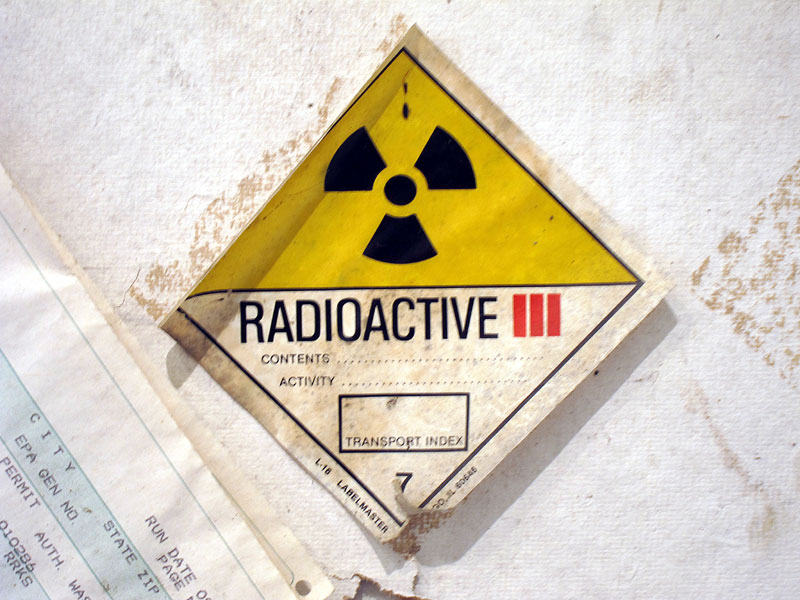

Hi all. I want to try and recreate my own plutonium stickers like the ones on the side of the case. I've got some pretty good examples off this forum but the screen version appears to have some fine text at the bottom underneath the 7. I can't read it no matter how much I zoom in on the film screenshot! I'm probably being a bit over fussy but I like to get things right.
Any help appreciated.
Thanks.

You're right. You can't read that small text, even on very good HD screen caps. The new stickers you can buy, have not the accurate text, but here is a picture of an original 1980's sticker. The text is "L-16 LABELMASTER" on the left side and "CHICAGO, IL 60646" on the right side.

Hi, thanks for replying and the info! Much appreciated...
