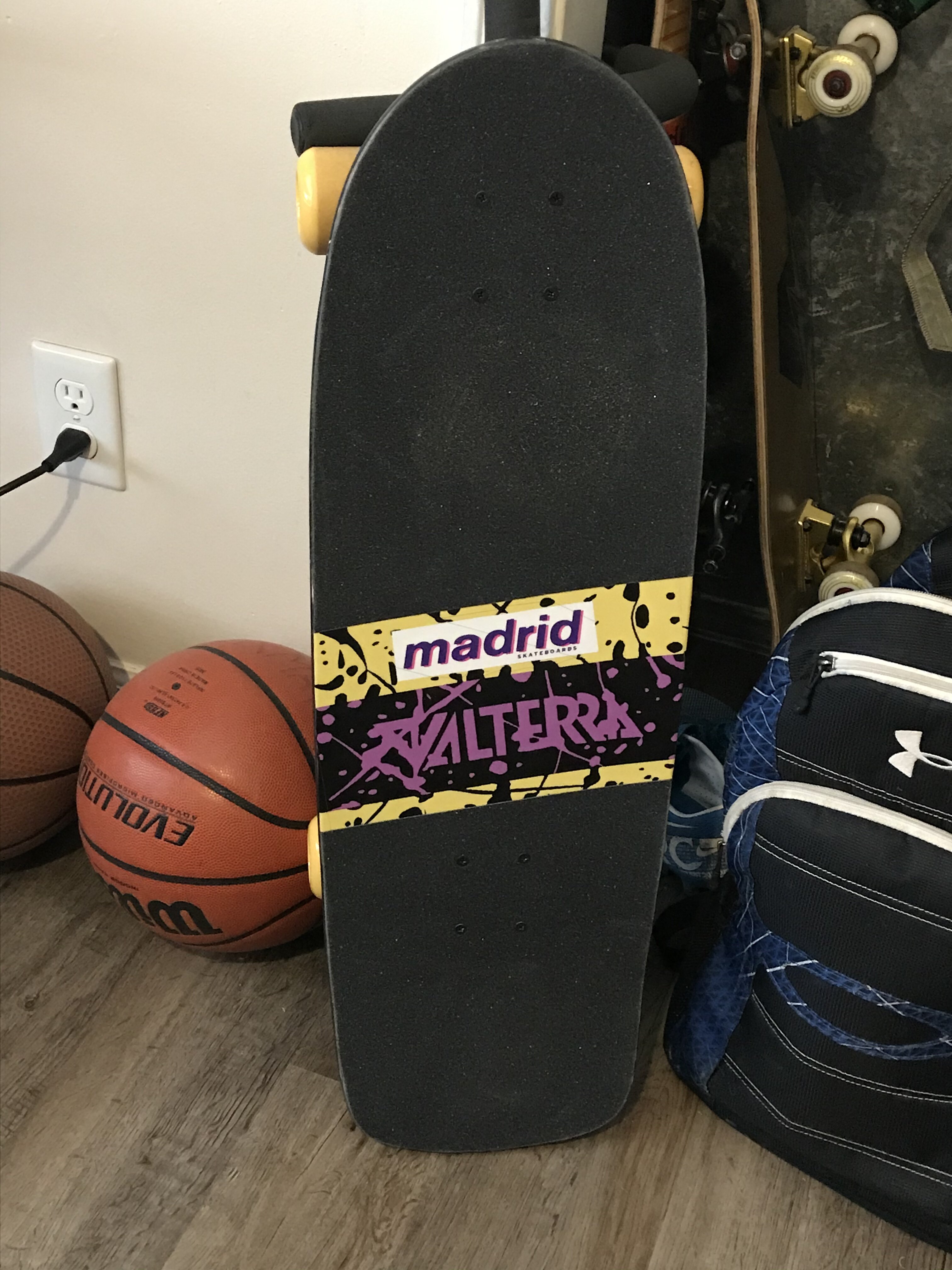

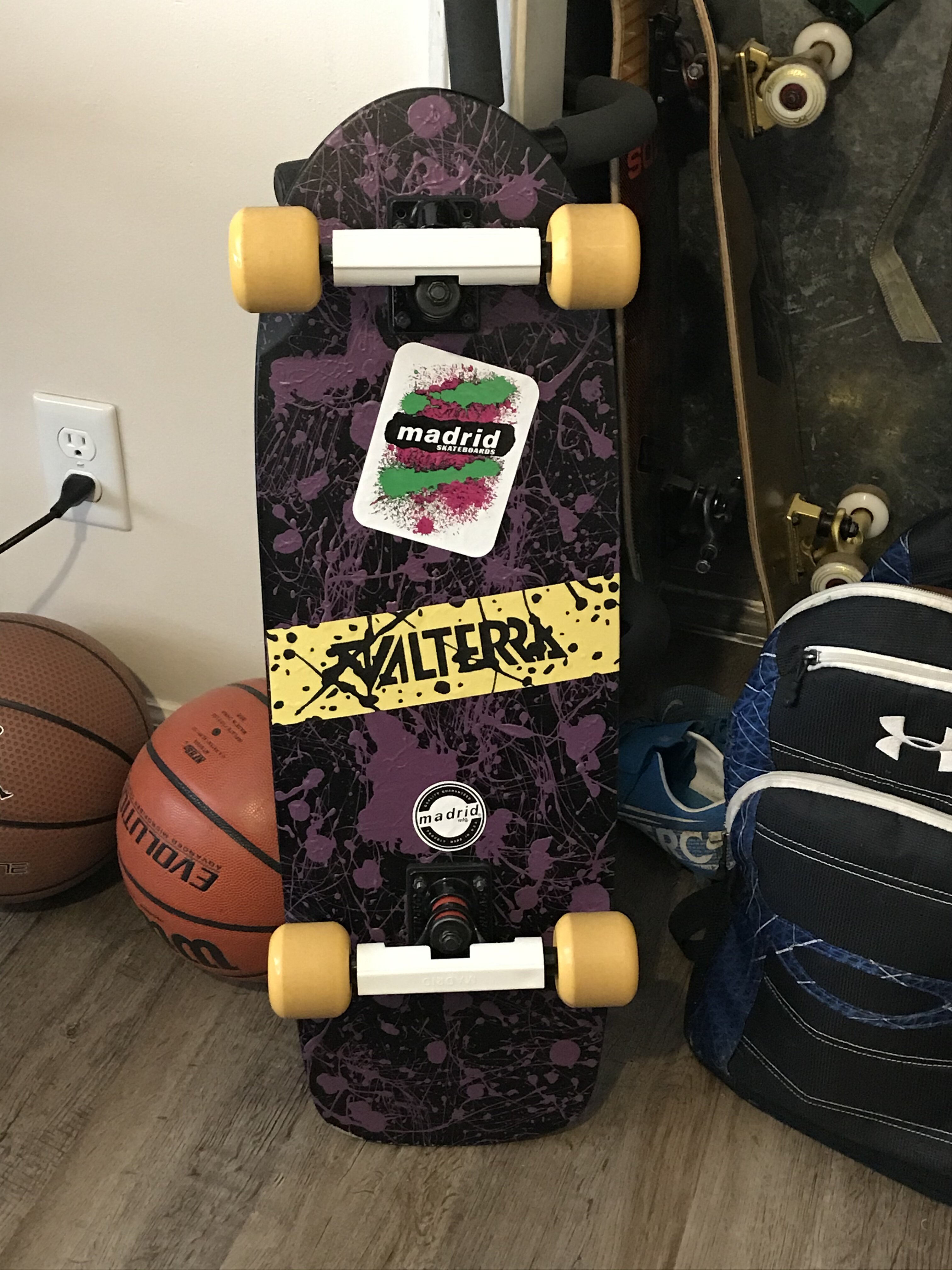

Decided to post on this thread because you inspired me to go make my own replica board, here’s my take on it!
Used pretty much every method you discussed except building the board from scratch; I just repainted one of the Madrid OG cruisers.
Looks great ! How did you get the stickers printed?
The splatter sticker came with the board I bought, and the circle Madrid sticker I found on eBay. For the top and bottom valterra graphics, I used the files that the OP provided, converted them to vector files and tweaked them a bit, then got them custom printed from a car sticker company.

Do you apply grip tape to the FULL top part of the board and then apply sticker, or do you apply sticker and then do the grip tape on the non-stickered bit?
This thread still 'active'?
Been inspired, but need help
First the sticker, then the grip;)

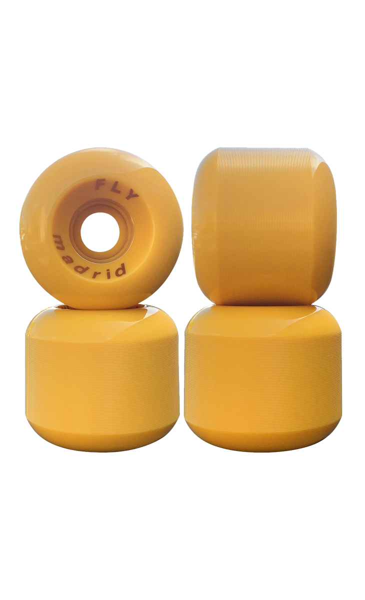

  • Wheels
    • Yellow 2nd Generation Madrid Fly wheels with inset letters and _________ offset (need measurement). I can measure my 2010 wheels as used on the first 2015 boards when I have access to my board to get that offset, which TheRealMcFly said should be very close to the vintage offset. Silver/zinc-plated wheel bolts. Flat washers used for wheels as well (as opposed to speed rings)?
    • Re-issues: Screened letters as opposed to inset. Further differences are as follows:
      • 2010 Re-issues: The 2010 re-issues were used on the 2010 25th Anniversary replica boards, and leftover stock was also used on initial wave of the 2015 30th anniversary boards. They have similar internal construction as vintage. They also have a similar offset as vintage, meaning their use with Extrack trucks will result in the film-correct wheelbase of about 4.625" (4 5/8") between the wheels.
      • 2015 Re-issues (also sold separately on Madrid's website in 2016 while stock remained): The 2015 re-issues were installed on the second wave of 2015 30th anniversary replica boards. Lighter in color, harder, plastic core. Higher offset, which results in them tucking further in towards the center of the board. To restore the film-correct wheelbase of 4.625" (4 5/8") between the wheels, the slightly wider SixTracks trucks by Tracker must be used.

£283.90 for a set of wheels? :oops:
Yep, I'm afraid that the market for this type of vintage wheels is always fairly high. You understand that those are in very good shape, from the early '80s and Kryptonite to boot. Those are in a semi-soft polyurethane used for street carving and skatepark bowl riding.
I've been skateboarding since the early '70s and had my fill of different skateboards, wheels, trucks and the likes. Kryptonite wheels were my fav for a mix of street/skateparks surfaces.
Last time I checked for vintage Sims wheels (in their original package) they were going for more than $240 (example)o_O
You could try to contact Valterra Skateboard to see if they still have the re-issued wheels.
Longboarderlabs.com might have a re-issued Kryptonite yellow original softness for less $$
