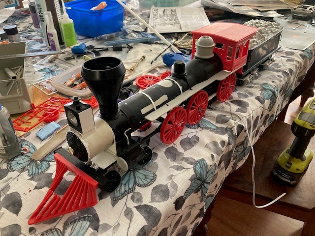

This is what I am staring with 2 x General train kit in 1/25 and 1 x BTTF3 DeLorean kit.

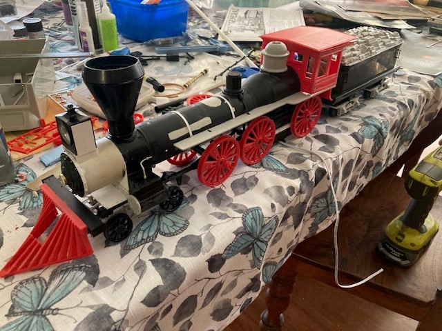

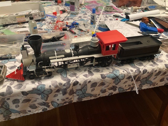

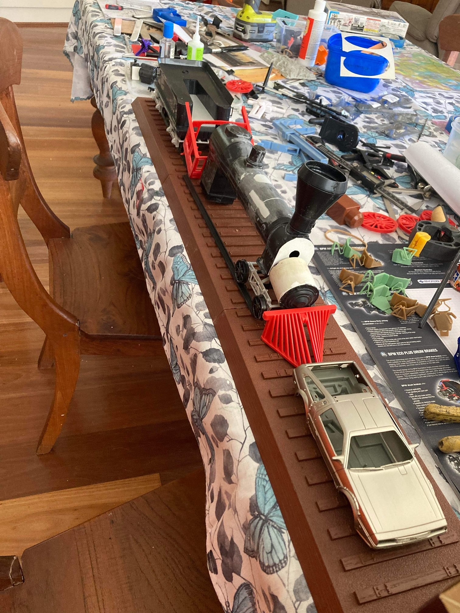

Here is a mock up of the train so I could cut the plastic track to length. I have already started to build the train so there will be some build photo's missing that I should have taken to share.

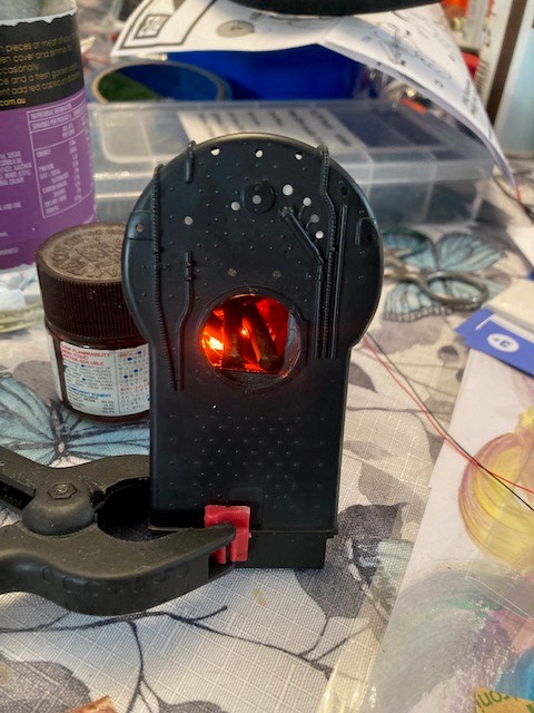

I have also added a few lights, one in the main lantern in the front the smoke stack and the fir box I have added the fire affect from Evens design.

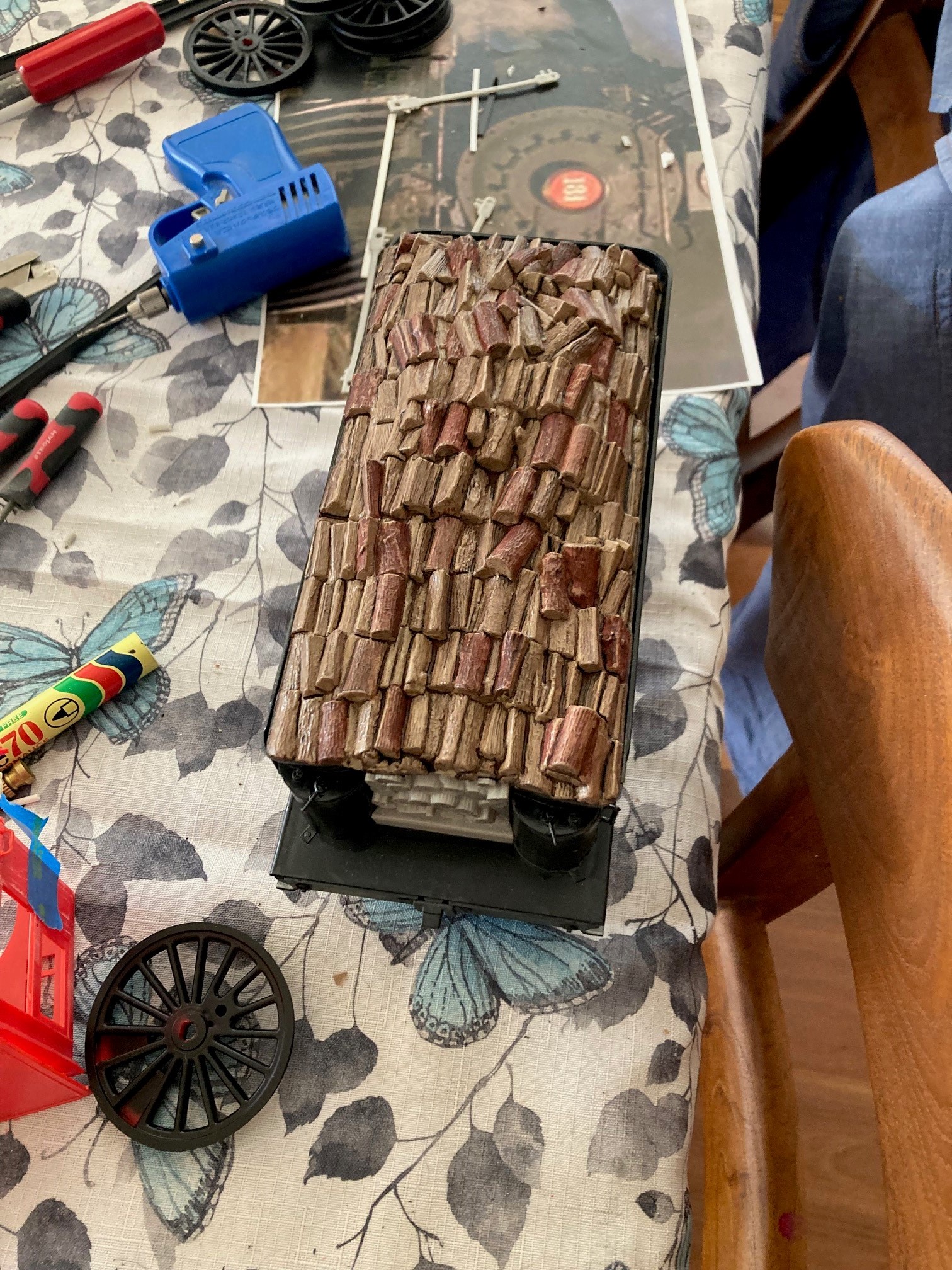

I also added into the fire box some timber logs made from Apoxi sculpt and some red cellophane crinkled up to add to the affect.

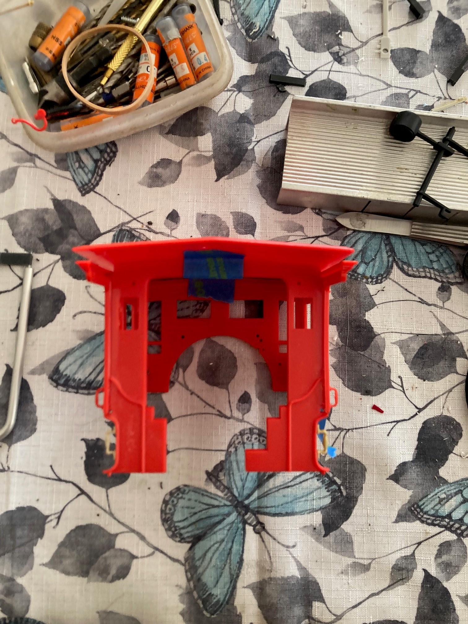

One of the next steps is to have a look at creating a rounded roof for the cabin as the ones supplied in the kit are flat. I will have a look at forming it out of of a piece of stock plastic card.

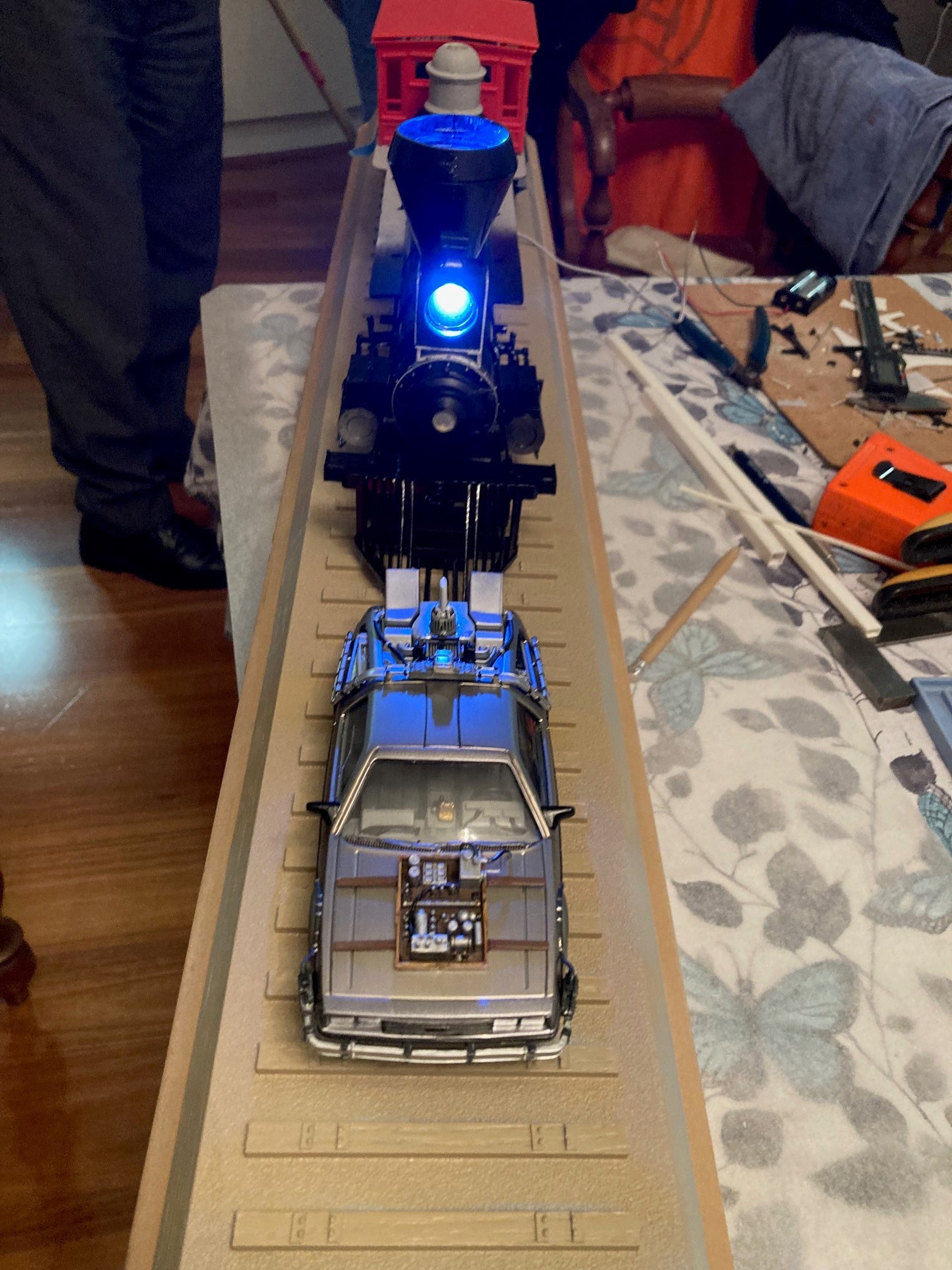

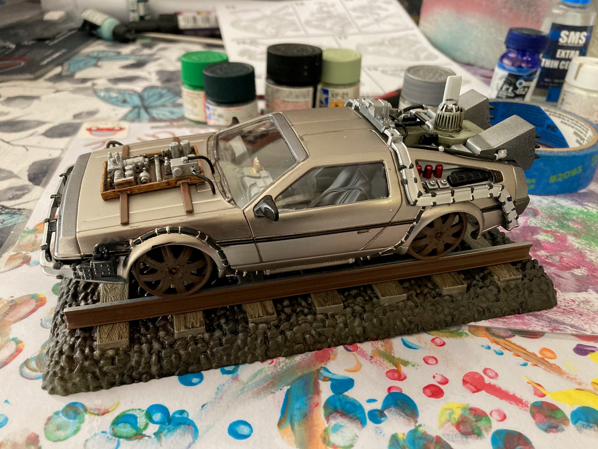

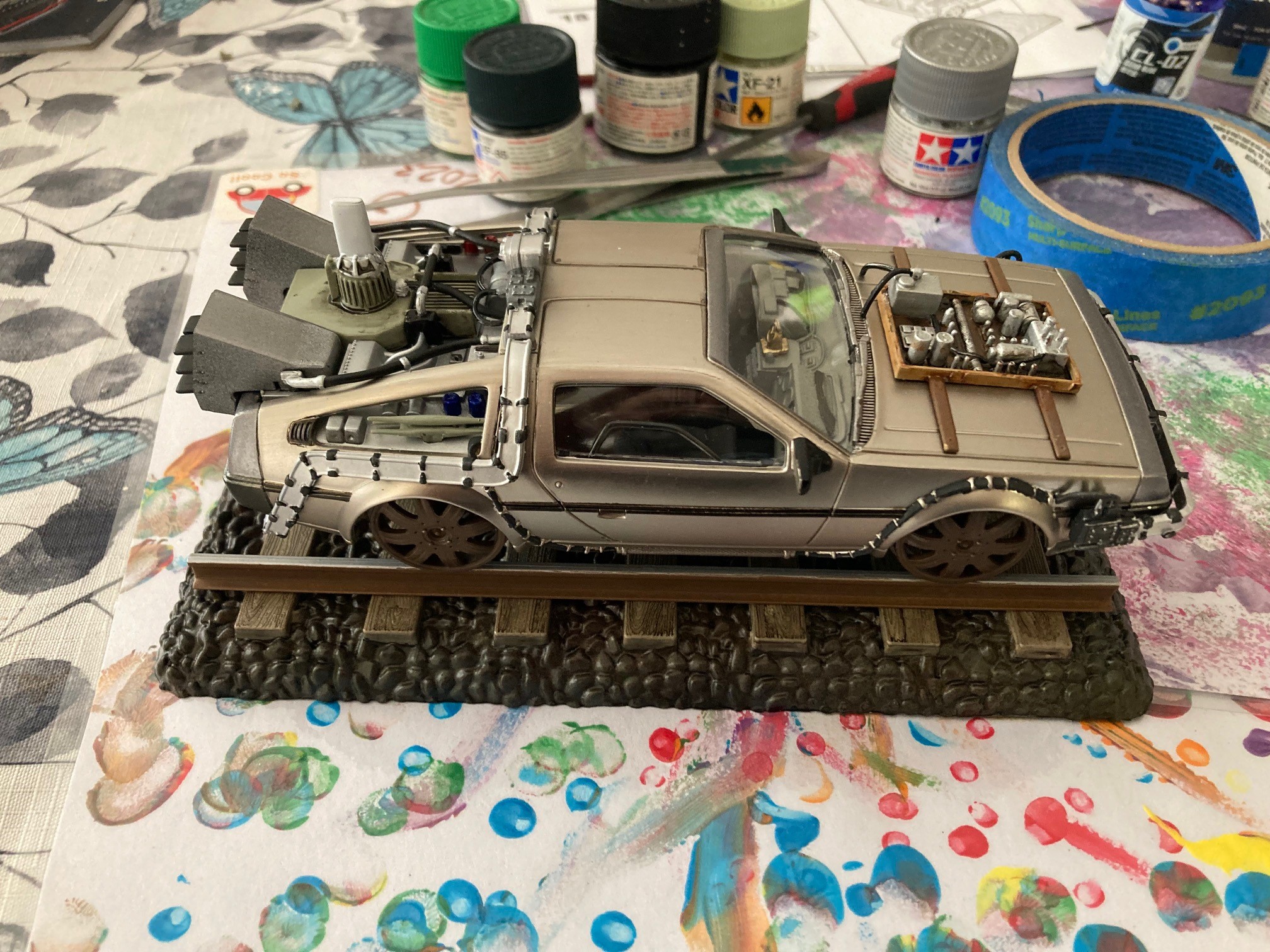

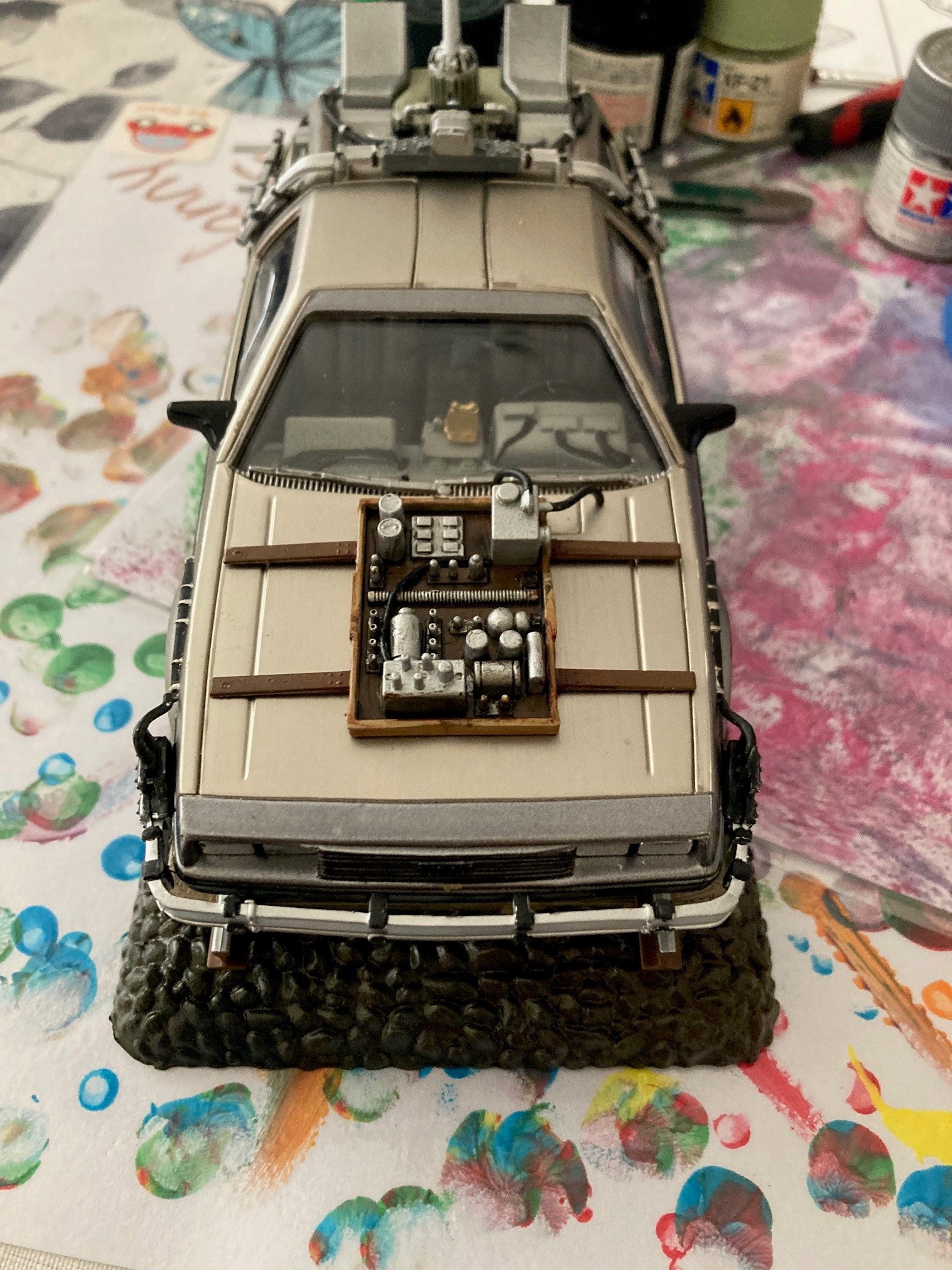

The DeLorean was next on the list to complete for this build. I used the Polar Lights snap kit as it was 1/25 and in scale with the train. The wheels fitted the rails for the train perfectly, I will weather the car once I have it lined up with the train on the tracks.
Please don't look too closely as there was still some panel line clean up to do after I took the photos.;)
Here is the first mockup with the boiler extended, and I have found a piece of reticulation pipe the right size for the extension needed in front of the smoke stack.
I used the second trains boiler to extend the middle of the engine, plus the second trains smoke stack was add to give the tapper cone look just like the filming train.

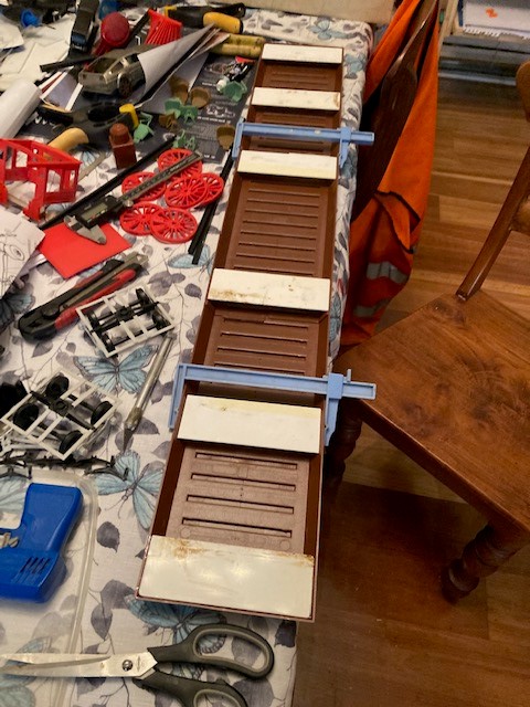

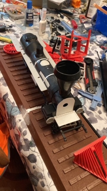

The base for the track to sit on.
When gluing the track section together I have added some scrap styrene across the base of the plastic to give me somewhere to glut it down to the wooden base I just made. Plus I can hide my wiring under the tracks and have my battery pack in the wooden base.
It pays when adding so many sections together to have them gluing together against a straight edge.
Wooden base completed. Tracks Primed and ready for painting I am looking to switch the colour to a gray for the sleepers with a wash and add some fine stones.

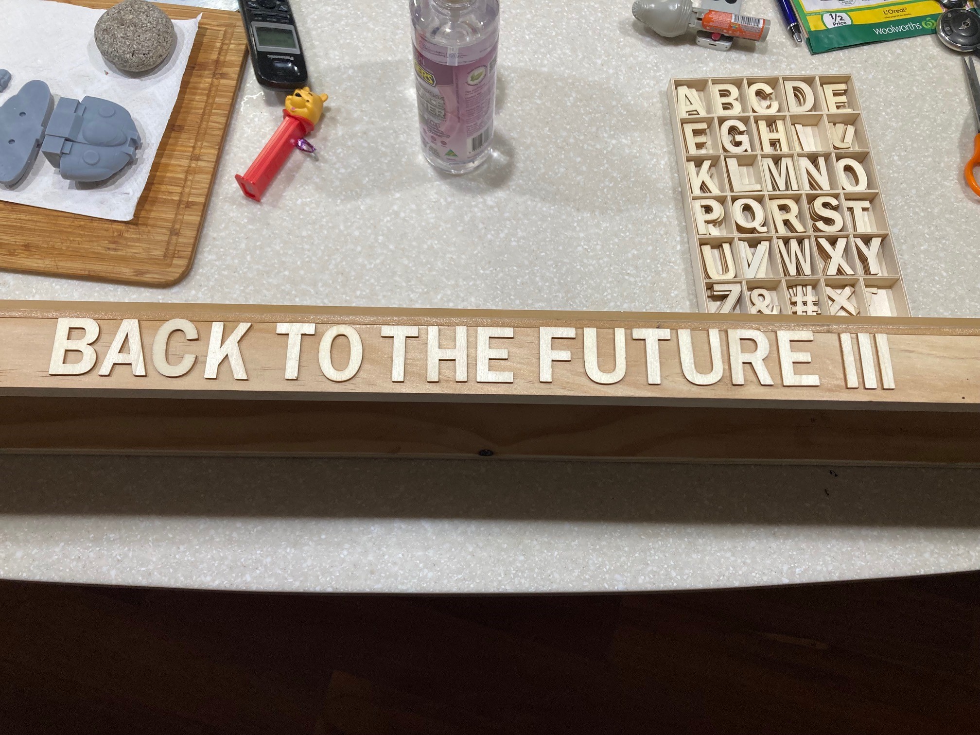

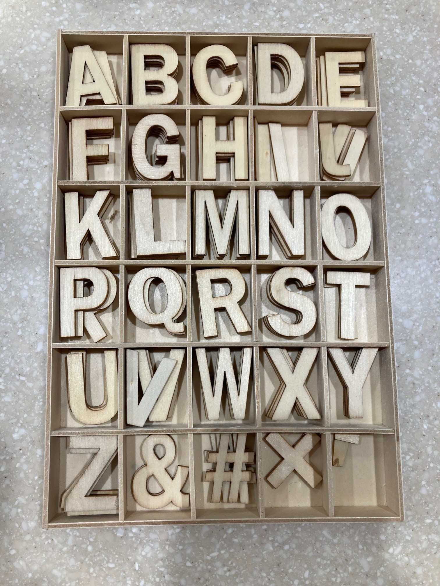

Letters added

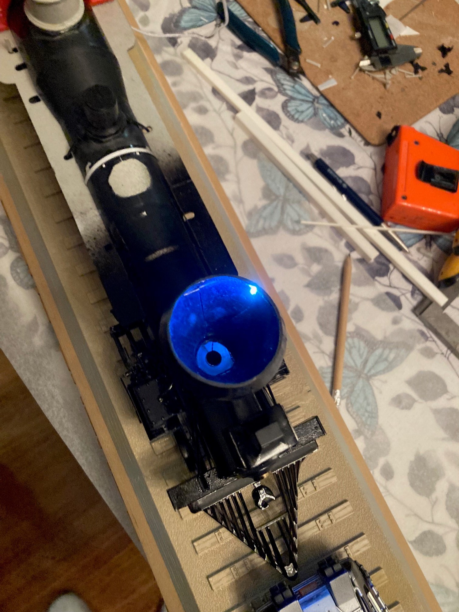

I have added a small light to the funnel just to give it a small glow under the dacryon filling that I will use for the smoke.
Fire box is alive.

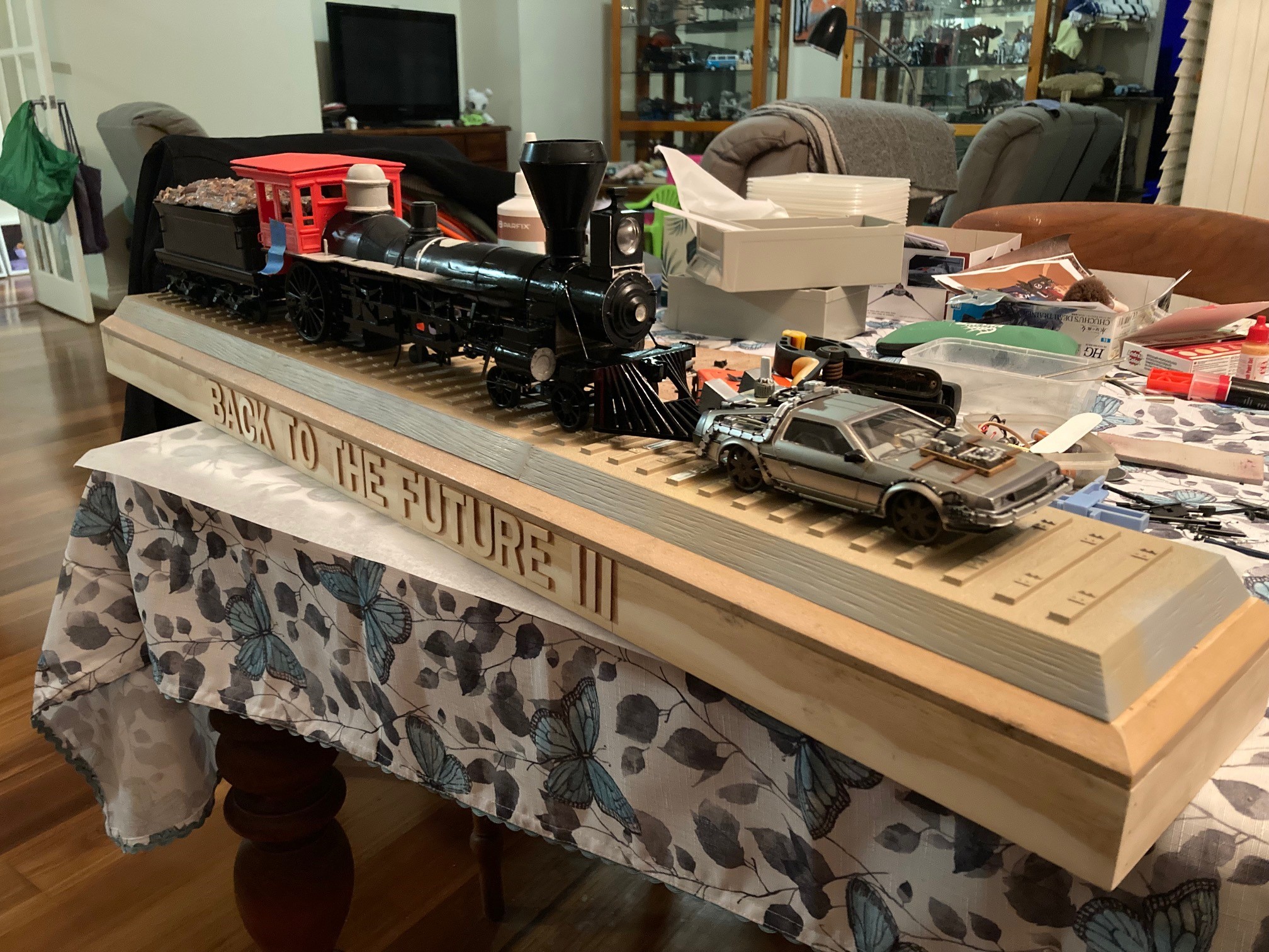

Working on the base, so I have a place to put the train when I am not working on it.

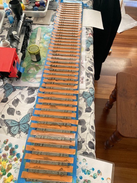

Rail sleepers have been primed painted a light grey.
Track1.jpg also added a wash to the sleepers.
Adding more tape and painted the track cleats Brown/red.

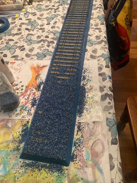

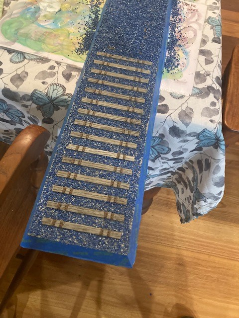

Some stones have been added
track3.jpg Adding some blue paint giving them that Granet look.
track4.jpg track5.jpg Add a little wash to the stones plus a light dry brush of grey.
