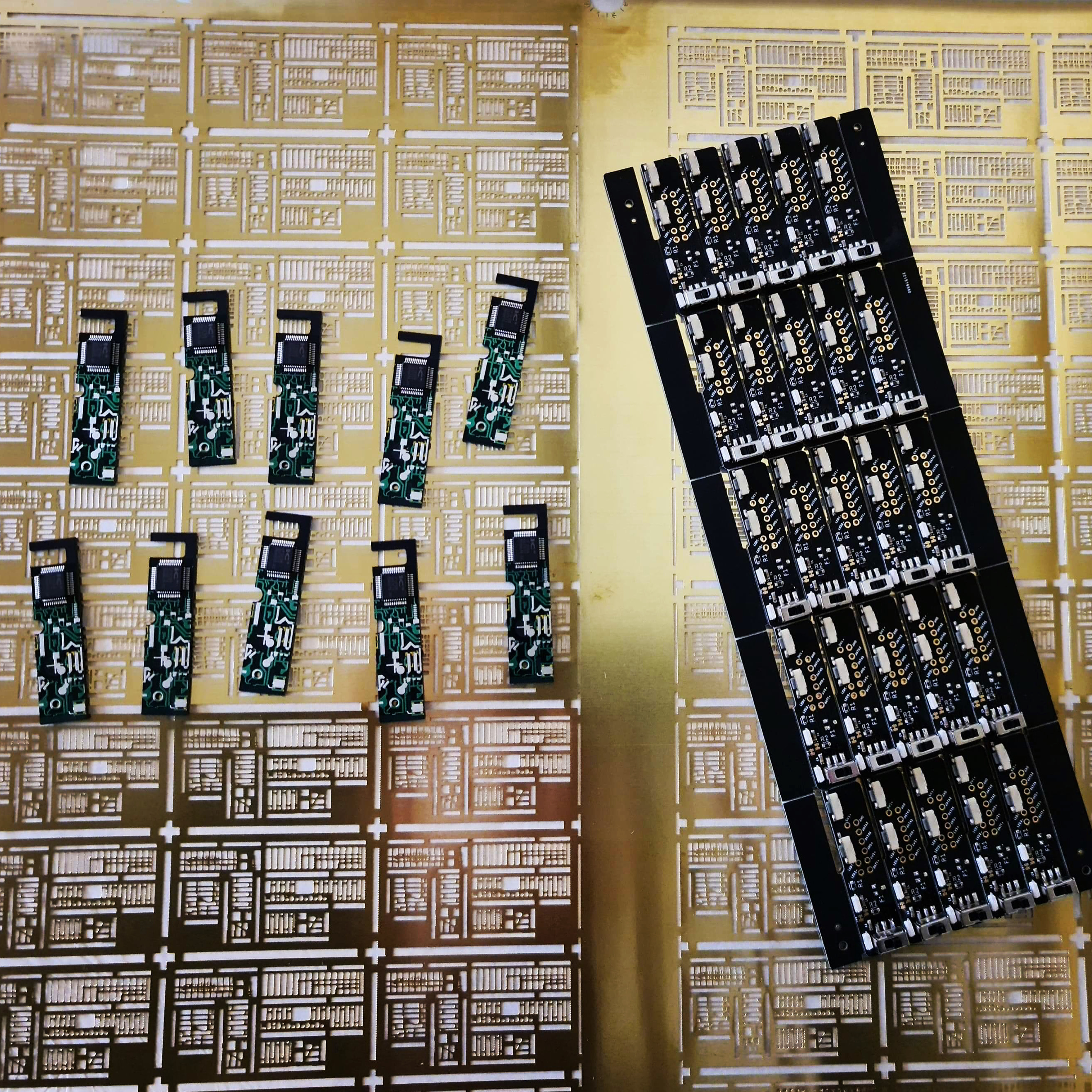

I finally got the brass and helper so customers should start seeing them trickle in soon as Lewis has begun sending them out. I intend to do a little tutorial to make it clear what to do but my time has been quite tight; so hopefully sooner than later on that front.
I’m not sure if everyone is getting DHL tracking or not? I believe he mentioned just keeping an eye out... the parcel is likely quite small
I'm still eagerly awaiting more news on those crystal chambers
In production! 7chambers is not doing pre orders for that offering. But we’re making a lot expecting to use them for multiple thin neck offerings :)
Still haven’t even gotten the MOM, yet, so I presume it’ll be sent out with the new parts included.
Yes batch 2 parts that were remade and batch 3 orders will have everything necessary to call it a complete hilt. We’re expecting those to get to Lewis around the 24th if I recall his newsletter update for email.
how do I sign up for the newsletter?
I received the missing parts (helper board, reveal & brass). Thank you so much! Now to wait for the tutorial....
