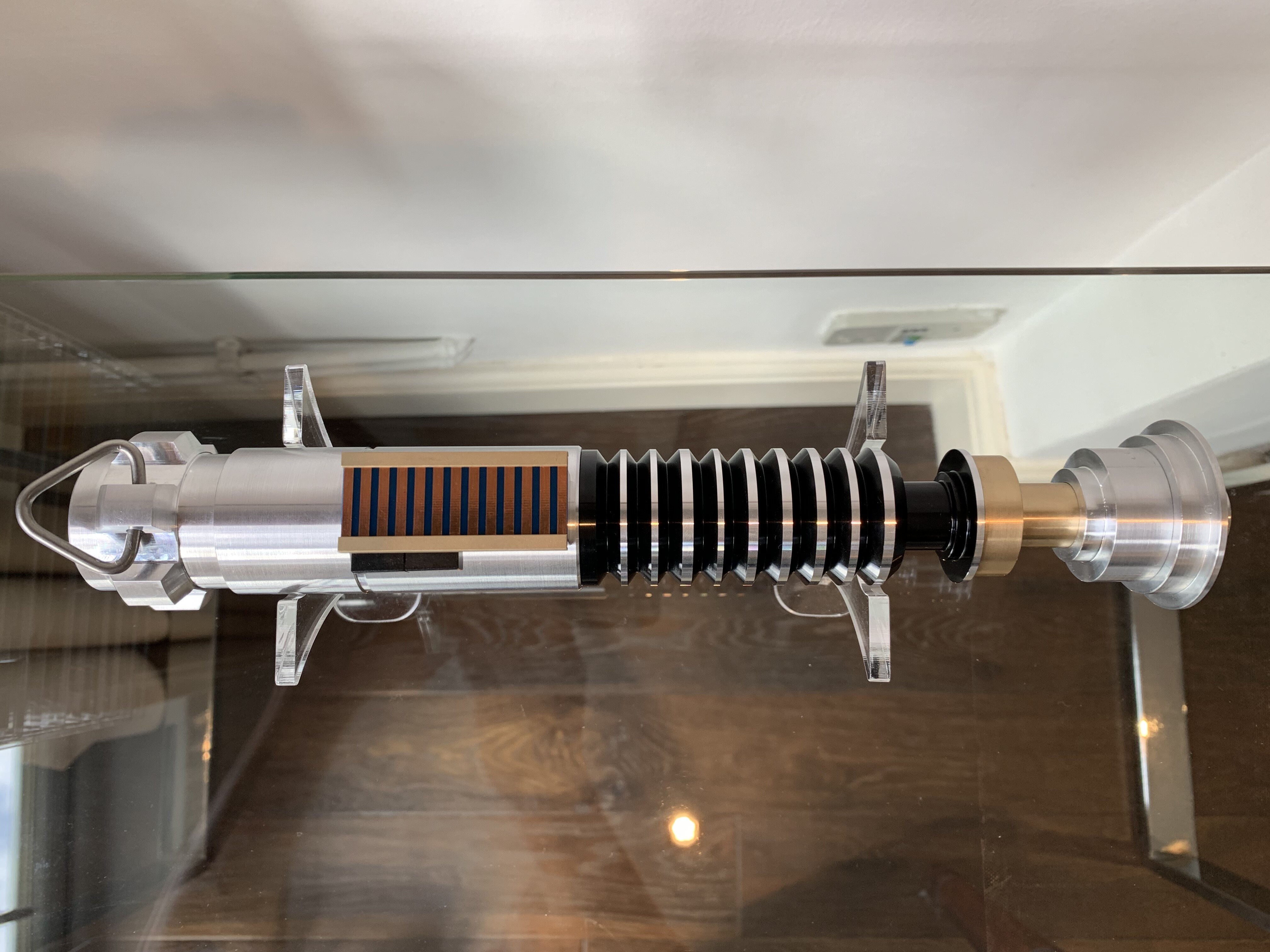

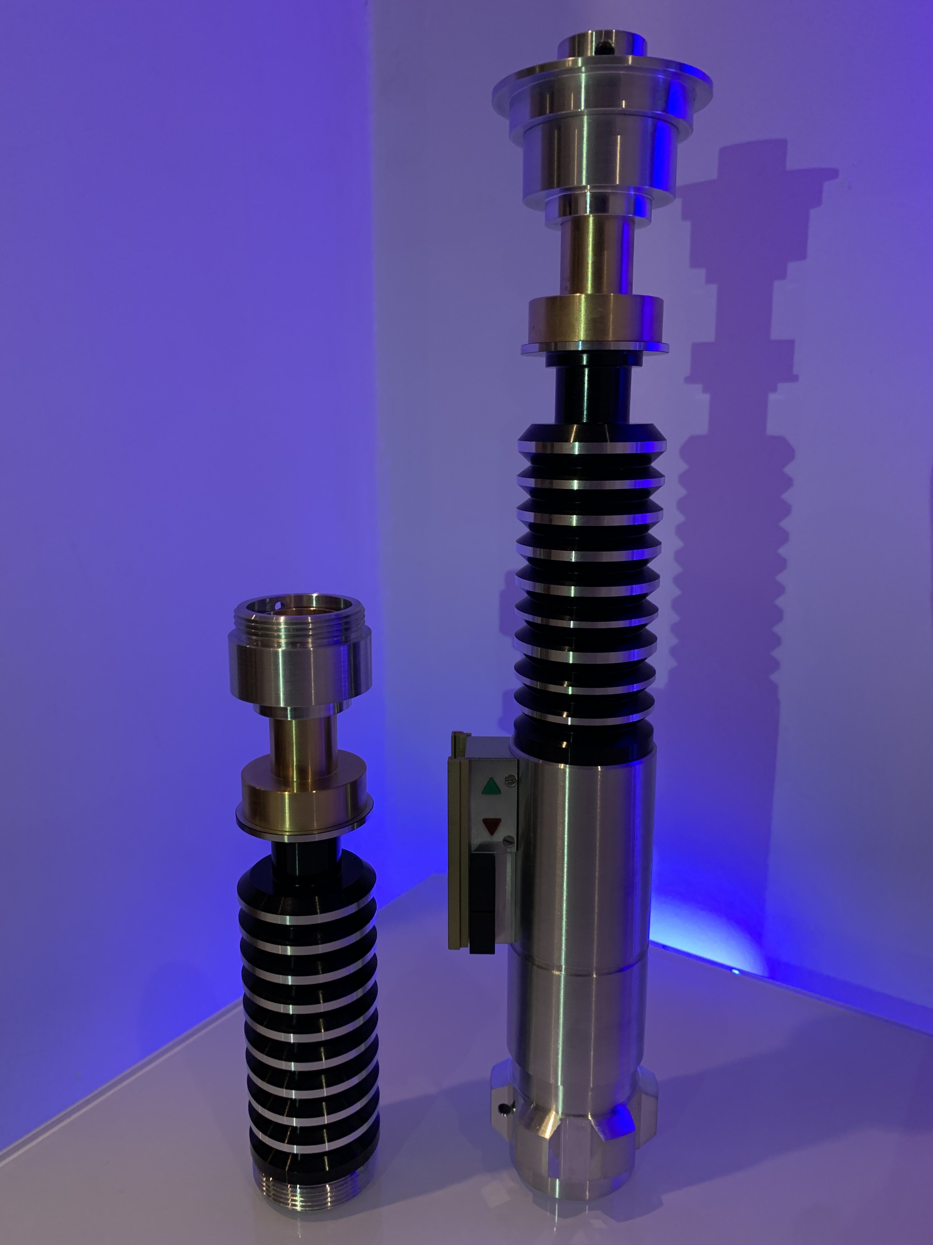

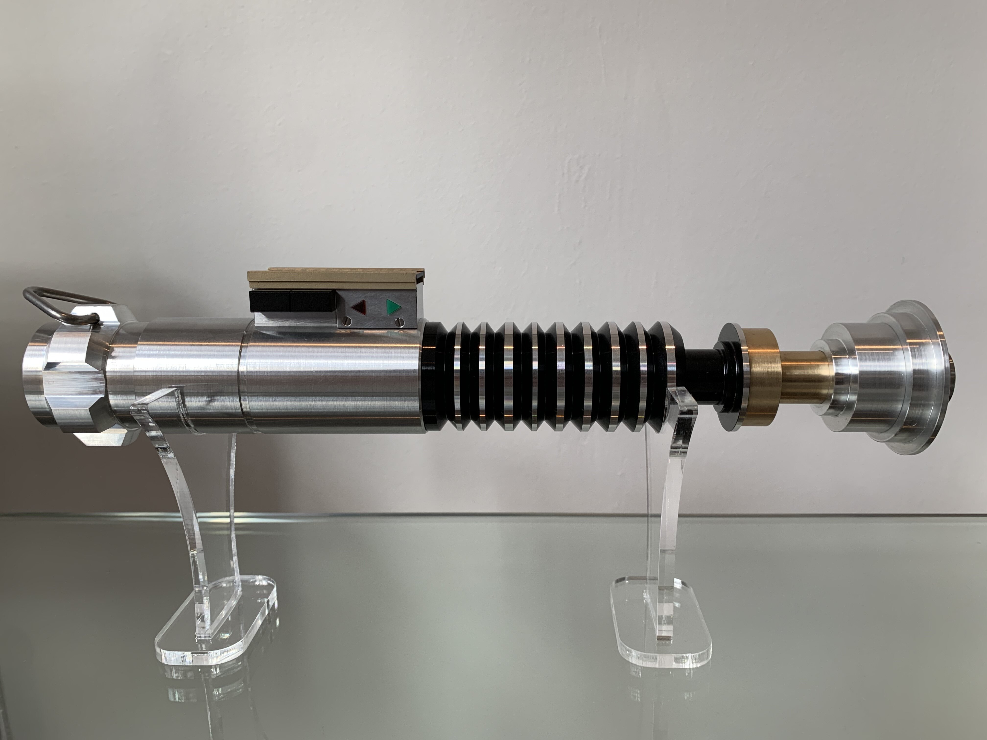

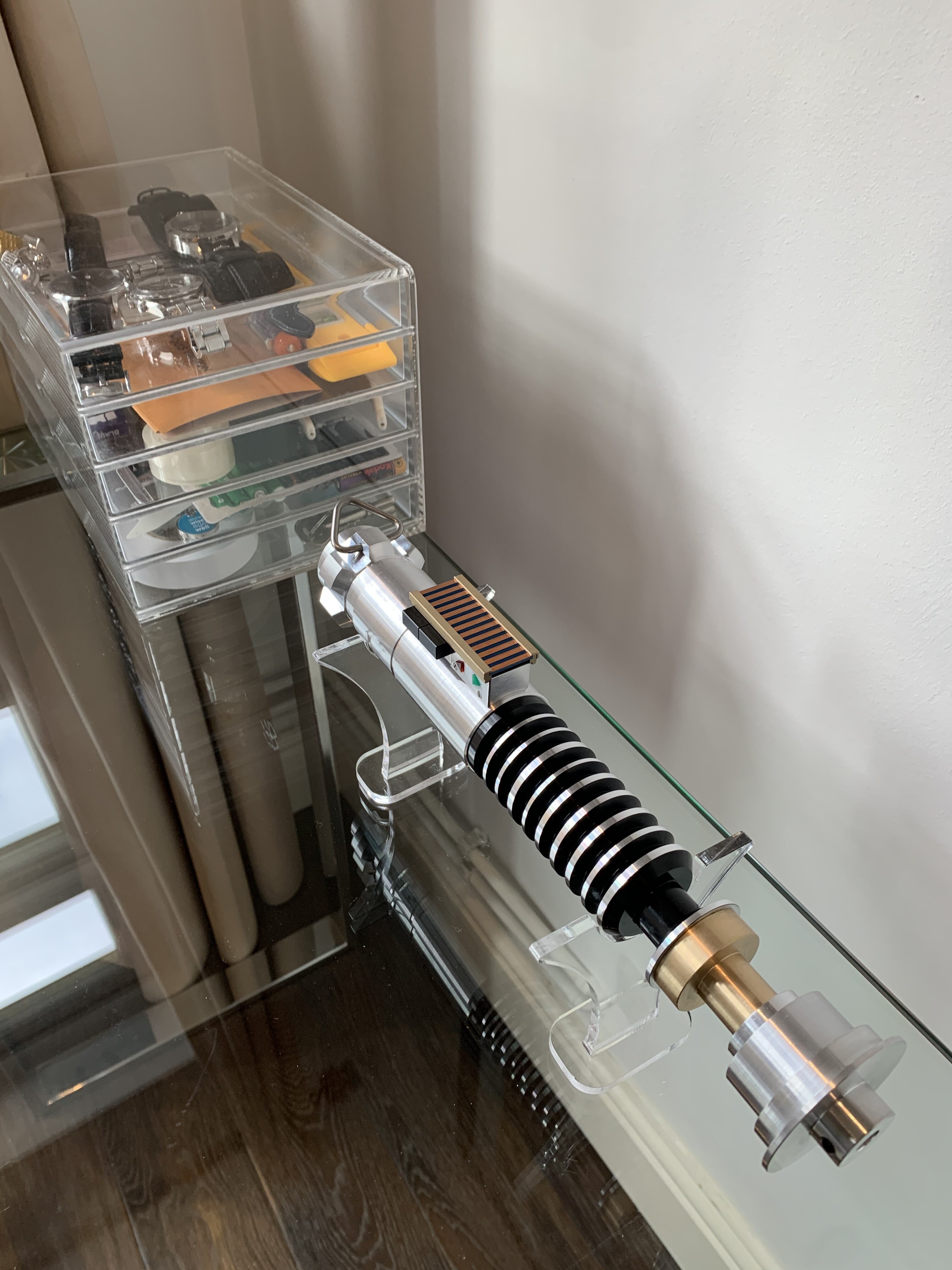

Stuck with work, can't wait to find some time to open this beauty!!
The clamp card needs it's own display case, it's gorgeous and feels quality!
Have to say the saber has more heft than I thought it would, solid.

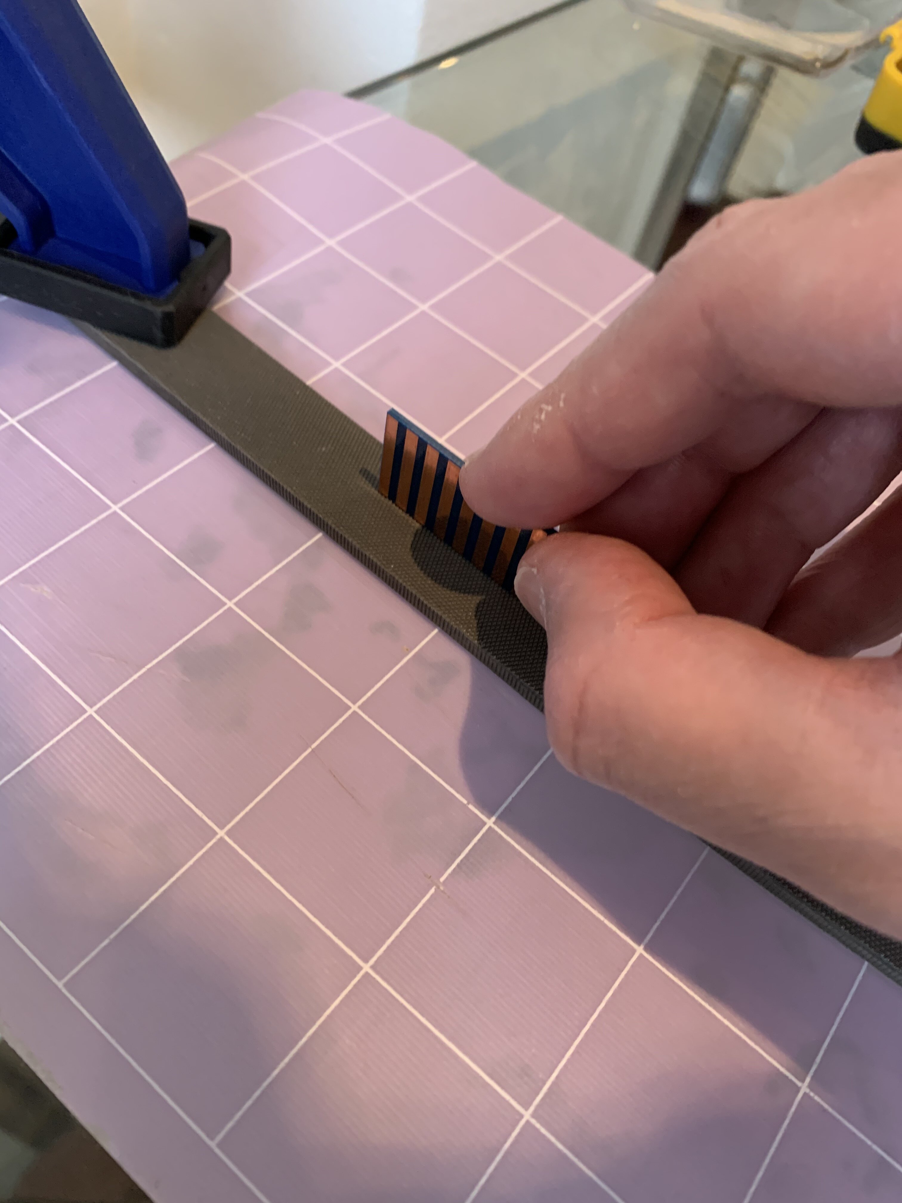

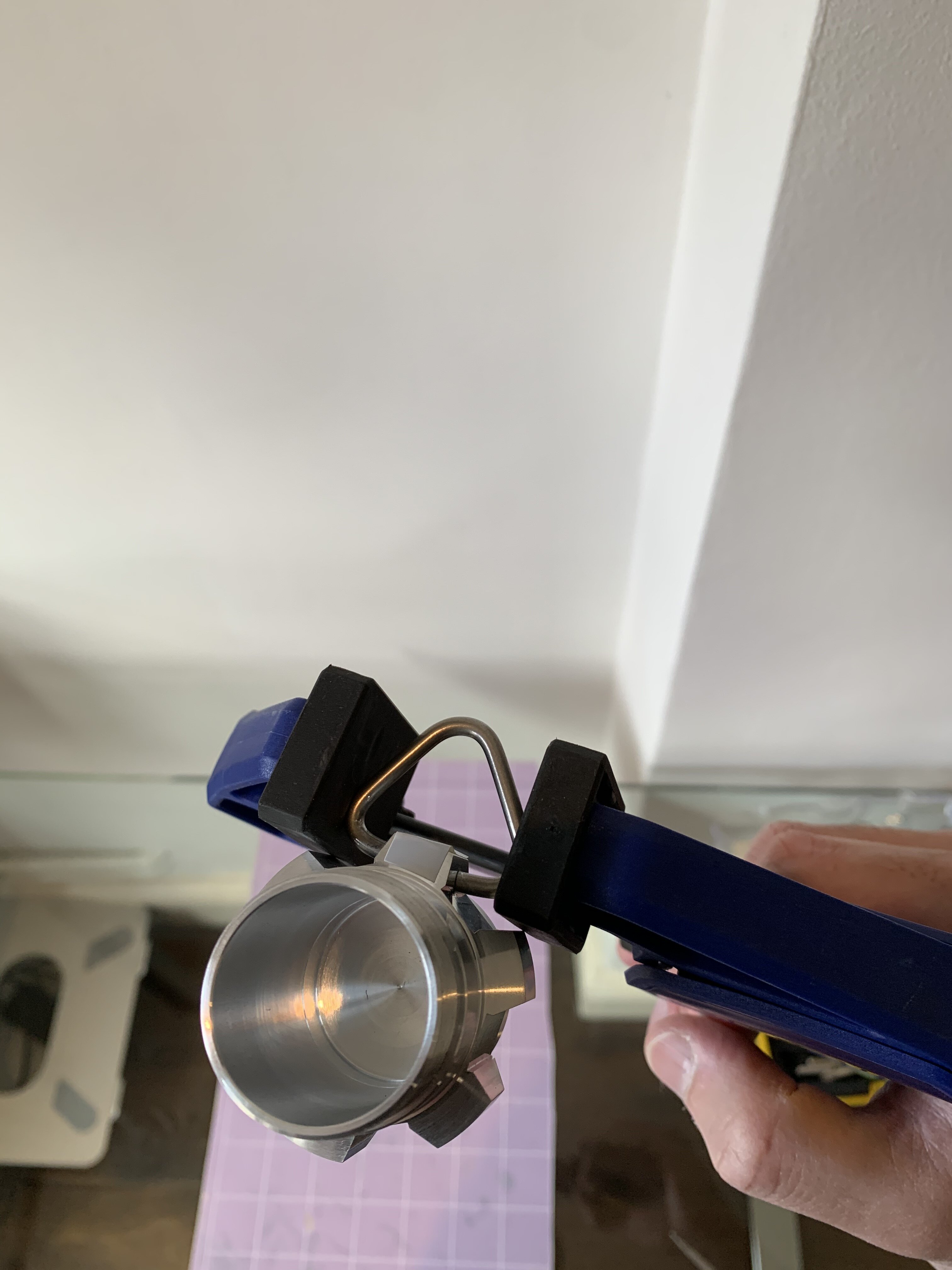

I posted on FB but will leave this here in case anyone needs the info.
Hi all,

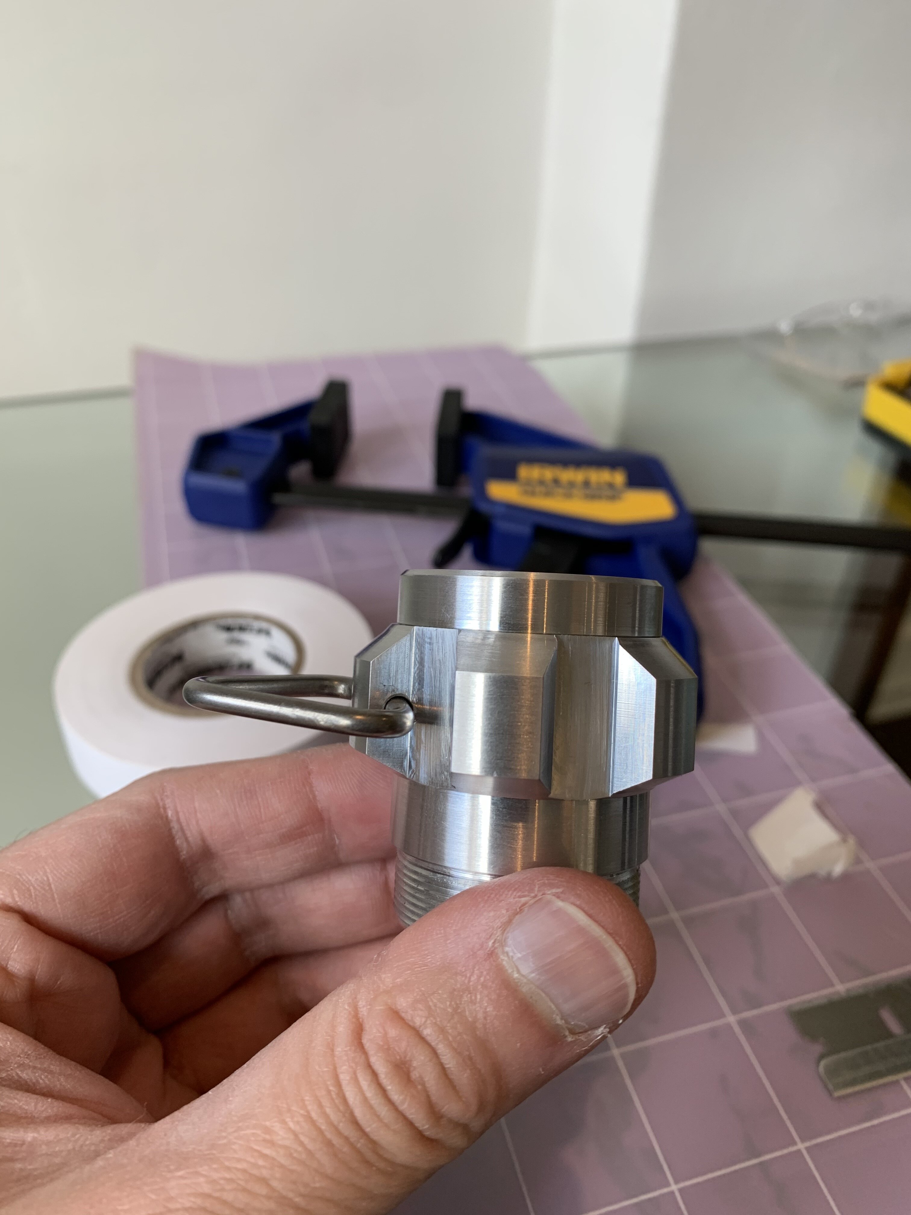

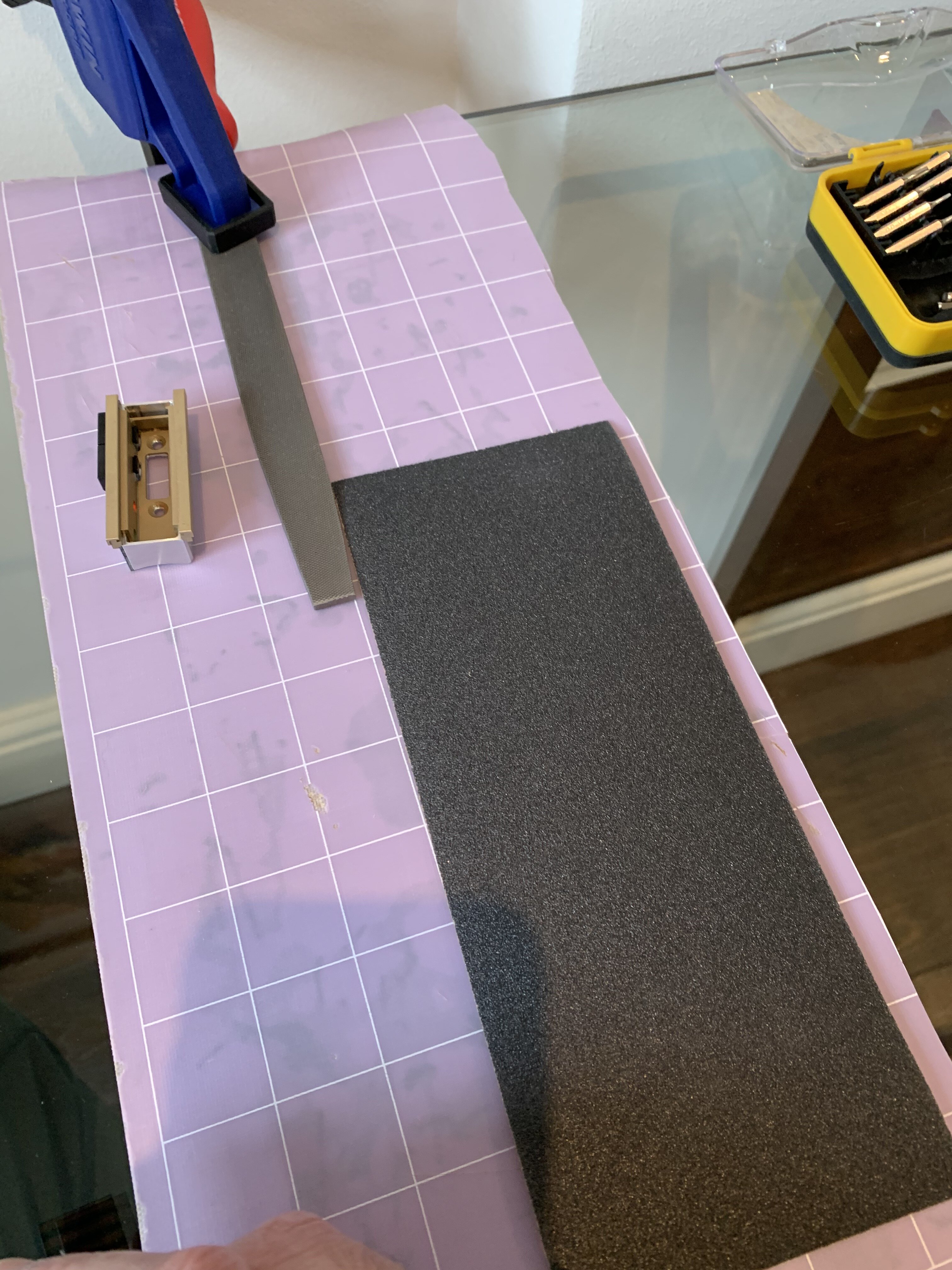

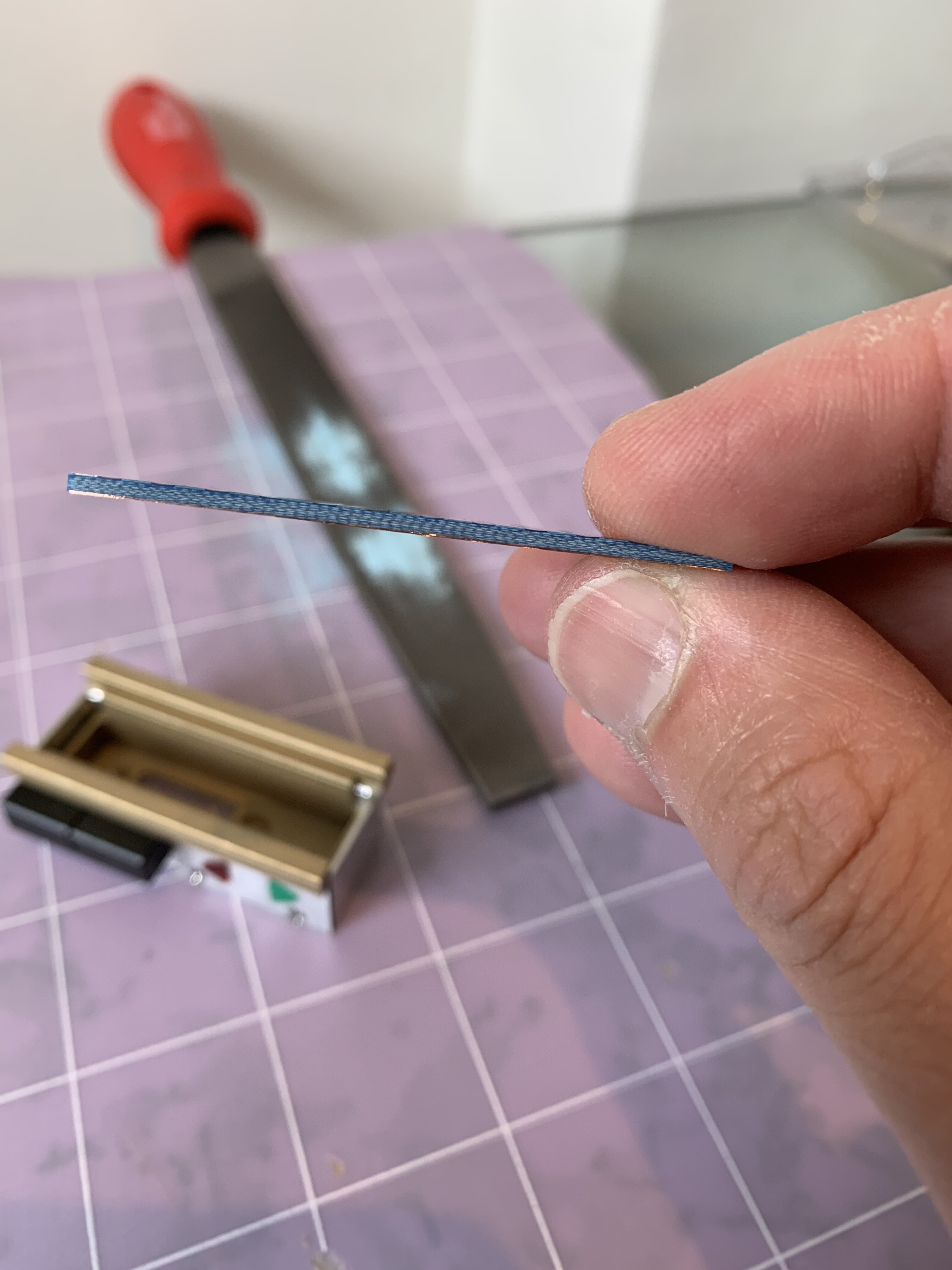

I know a few people have had questions around how to reduce the edges and thickness of these amazing clamp cards, so thought I'd share a few pics of my approach.

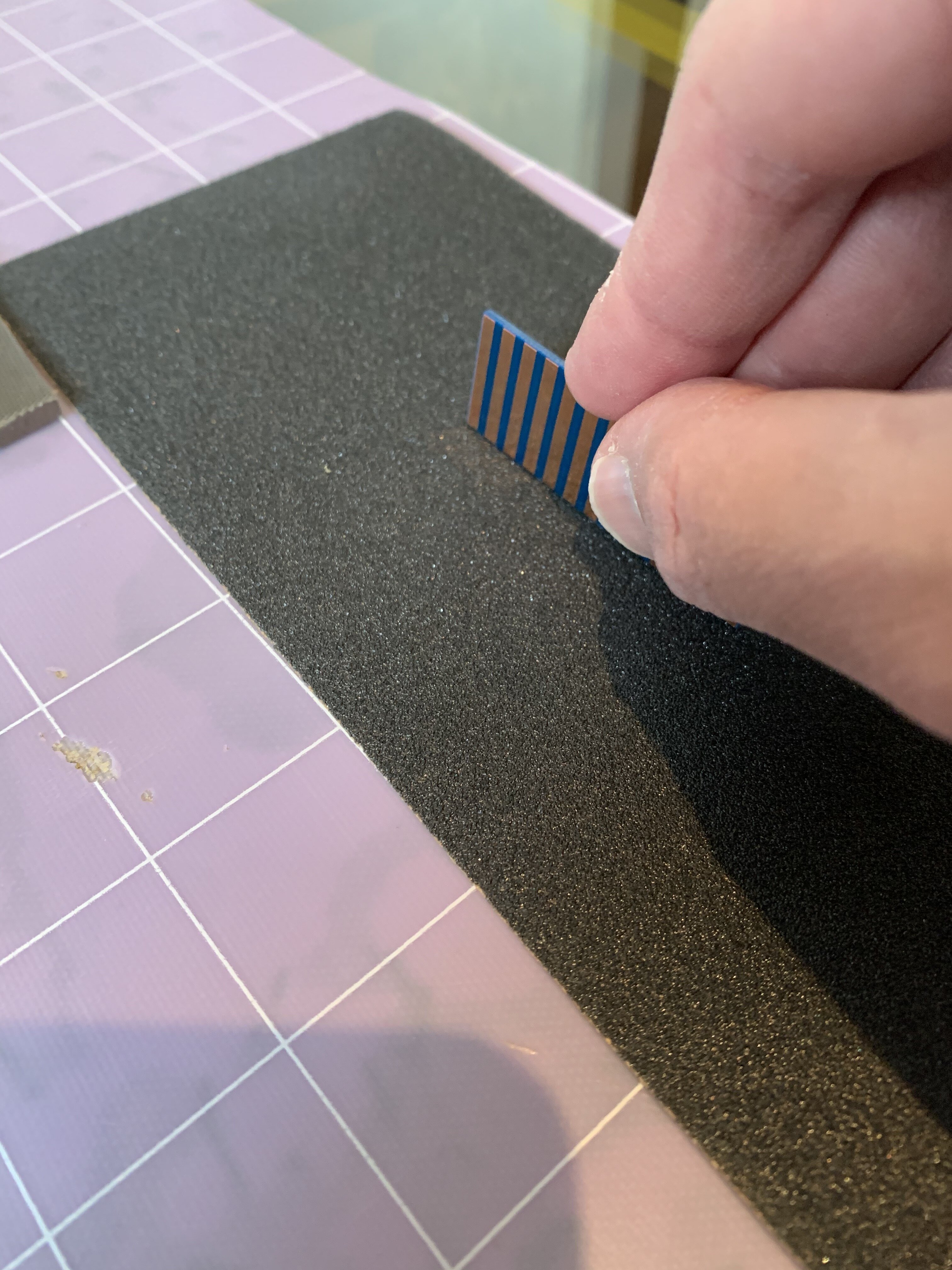

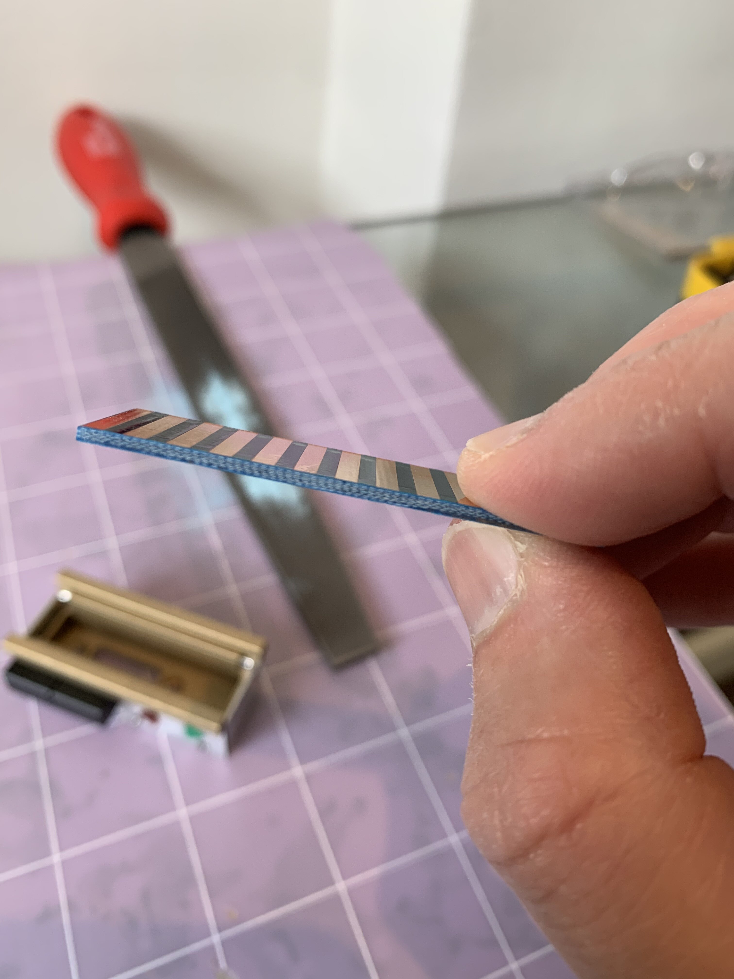

Clamping a file down worked best for me. Make sure it's a decent file, some files can come slightly bowed. Hold card on one side with even pressure and begin to file. Swap sides every few strokes (depending on file grade), wipe off residue and check fitting. Took me 10 mins max for the whole process. If you don't have or don't want to use a file, I'd go with placing a piece of sandpaper on a flat surface (glass if possible) and then carry on same as above. Key is patience (i usually have none lol) check and re-check every few strokes.
Taken a few pics of the filed finish for reference, worked out perfectly for me.

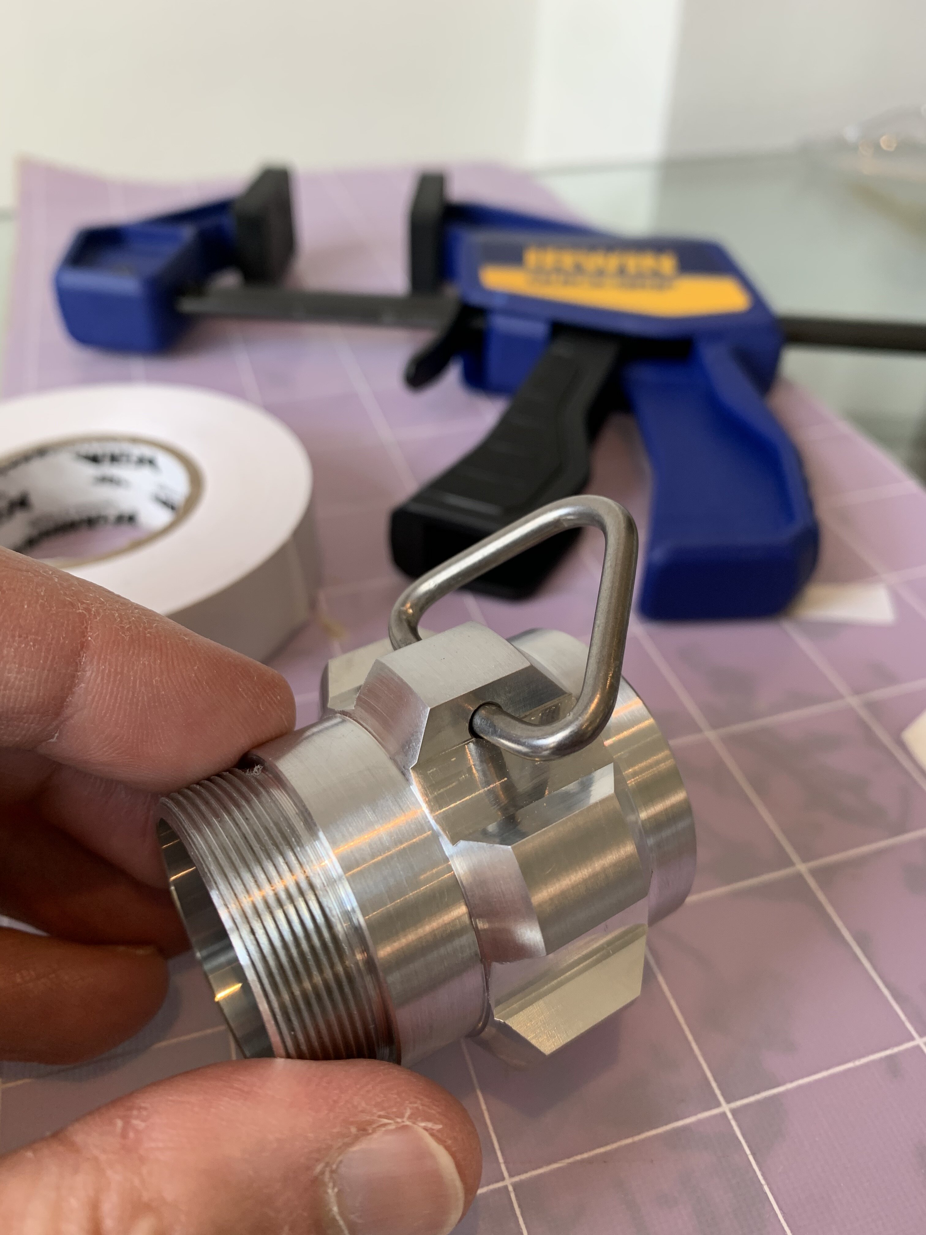

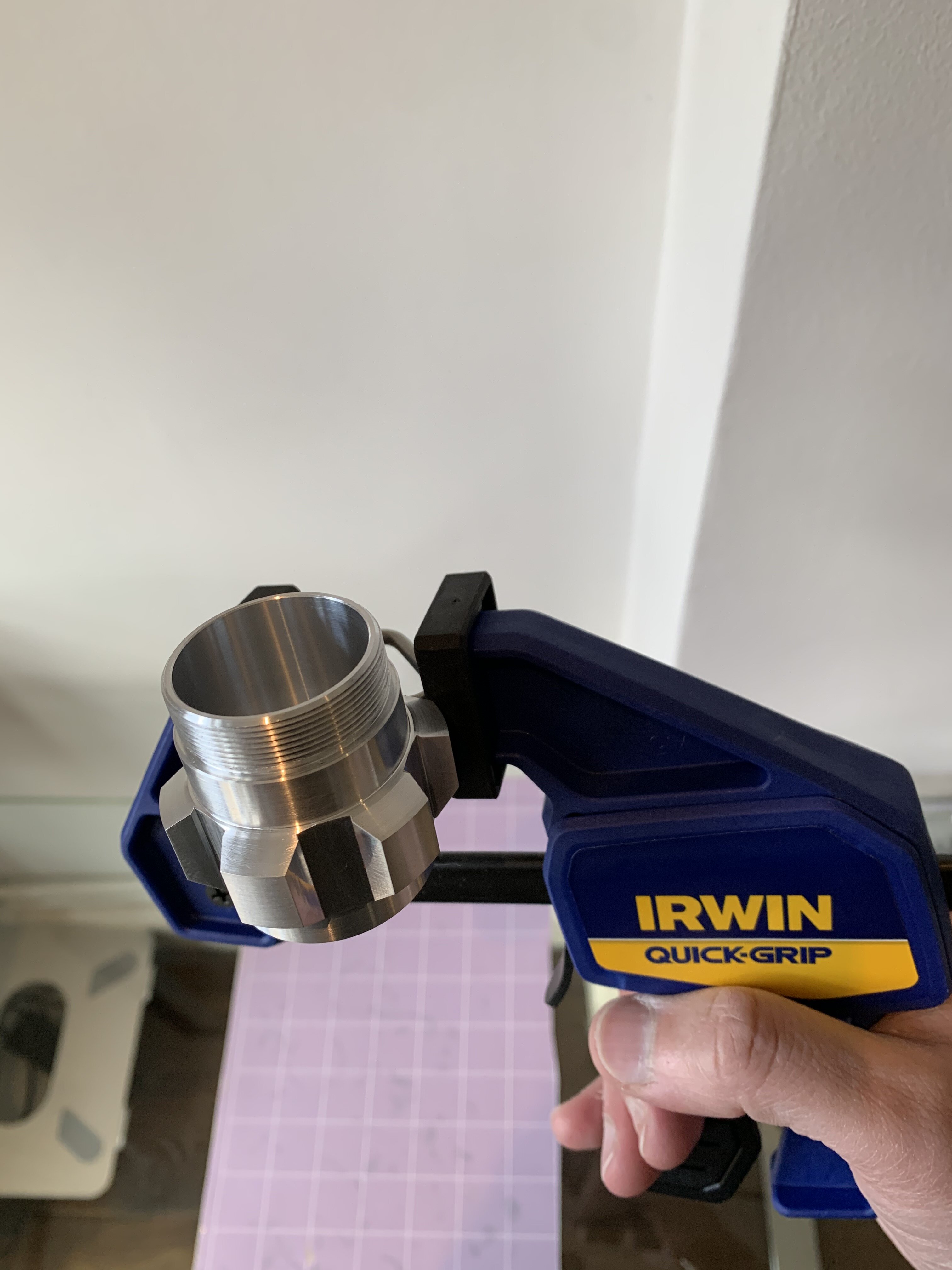

Also, for those who may not have a vice/hobby vice at home (which will ultimately give you the most control) I've shown an example of how to use quick grip hand clamps to squeeze the tri-ring into place, has the added security of the clamp surfaces being of a plastic material, hard enough to do the job, soft enough not to damage the surface and/or the pommel itself. I recommend some tape on the pommel face when doing this.
Just sharing some of my newbie thoughts, and hope it helps!
P.s I did not need to adjust the thickness of my card.

Just wanted to say thank you! Went out and got a file and it worked like a charm :D

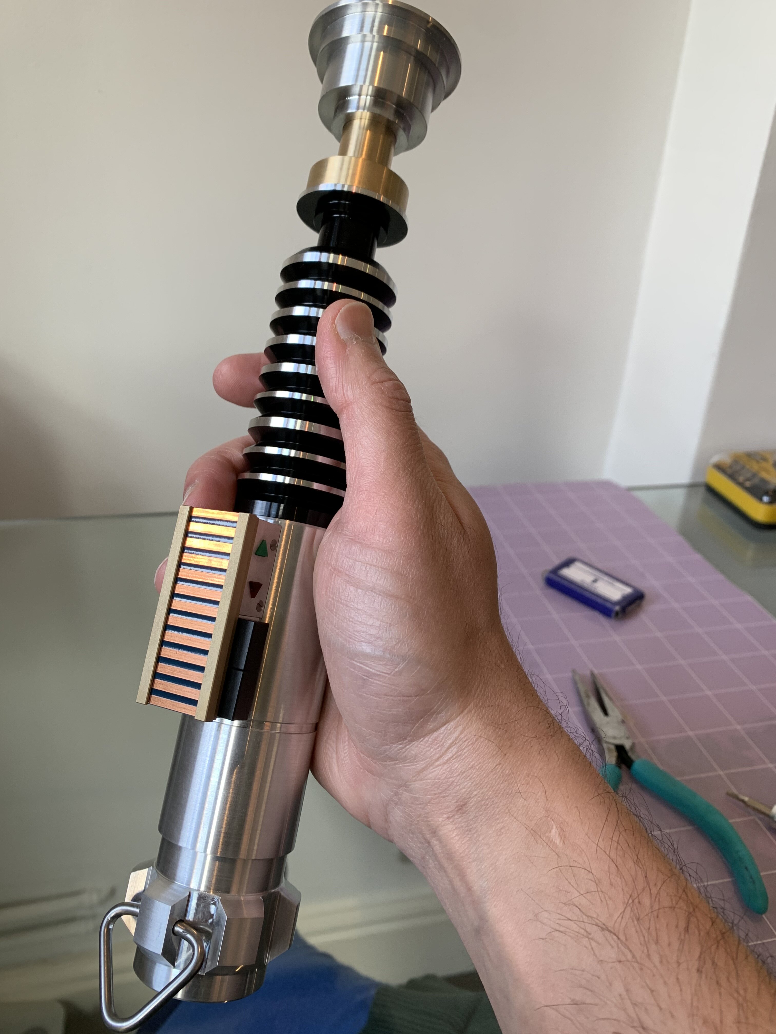

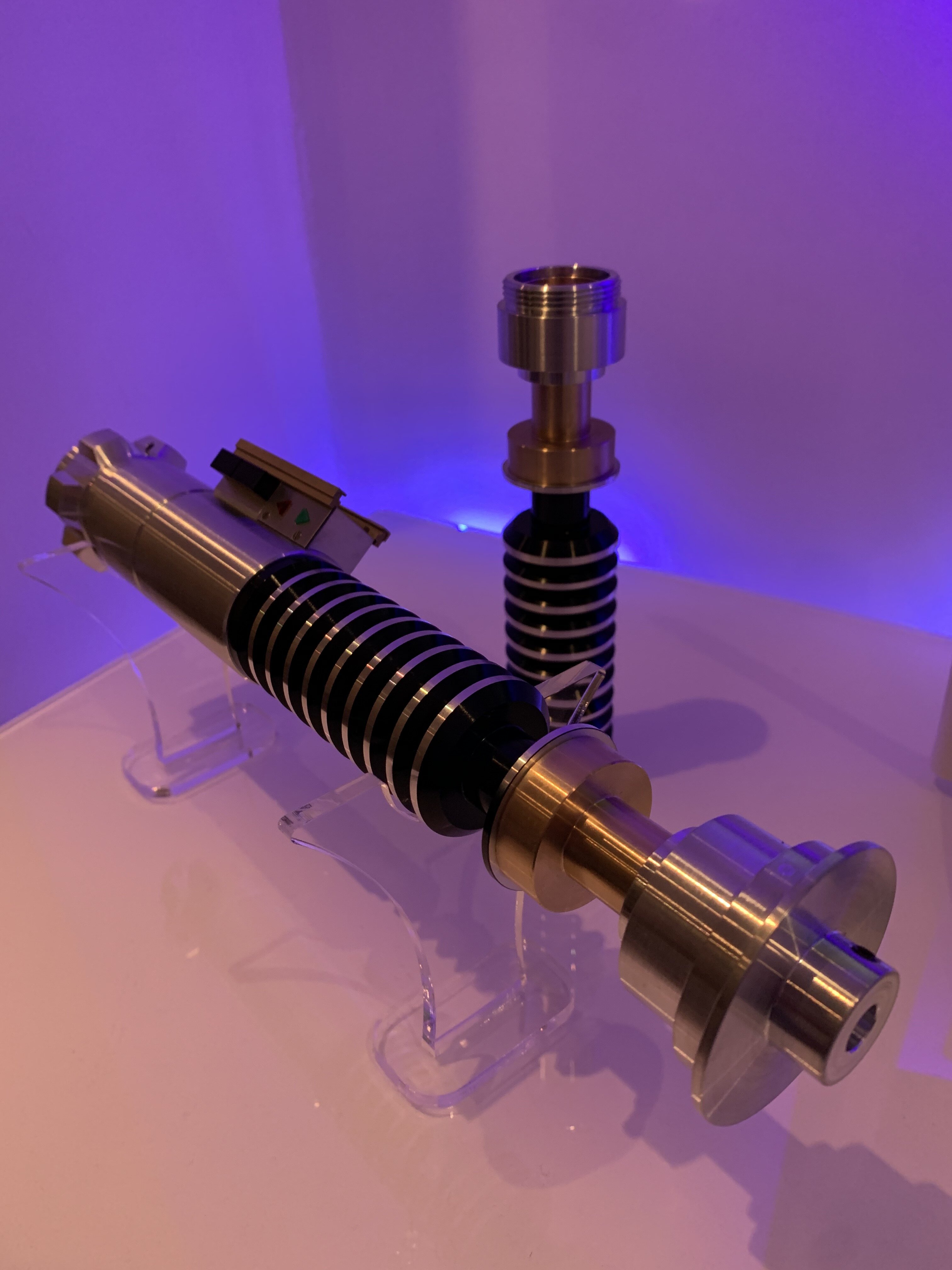

I think I missed something, what is the gold colored piece? Or is that just your surface?

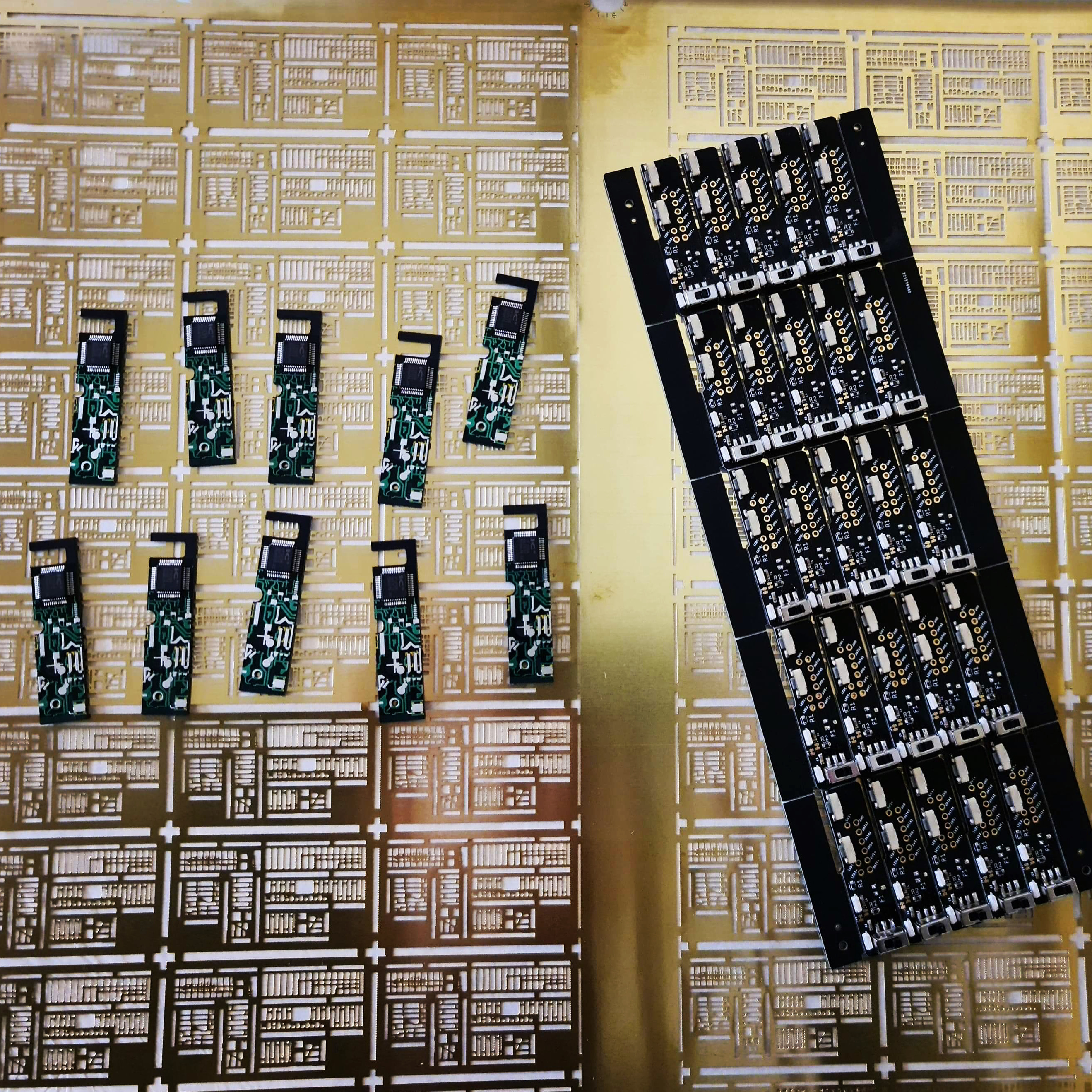

Death Star brass, confirmed and re-captured from images of the Death Star 2 production model as well as unused sheets from production.

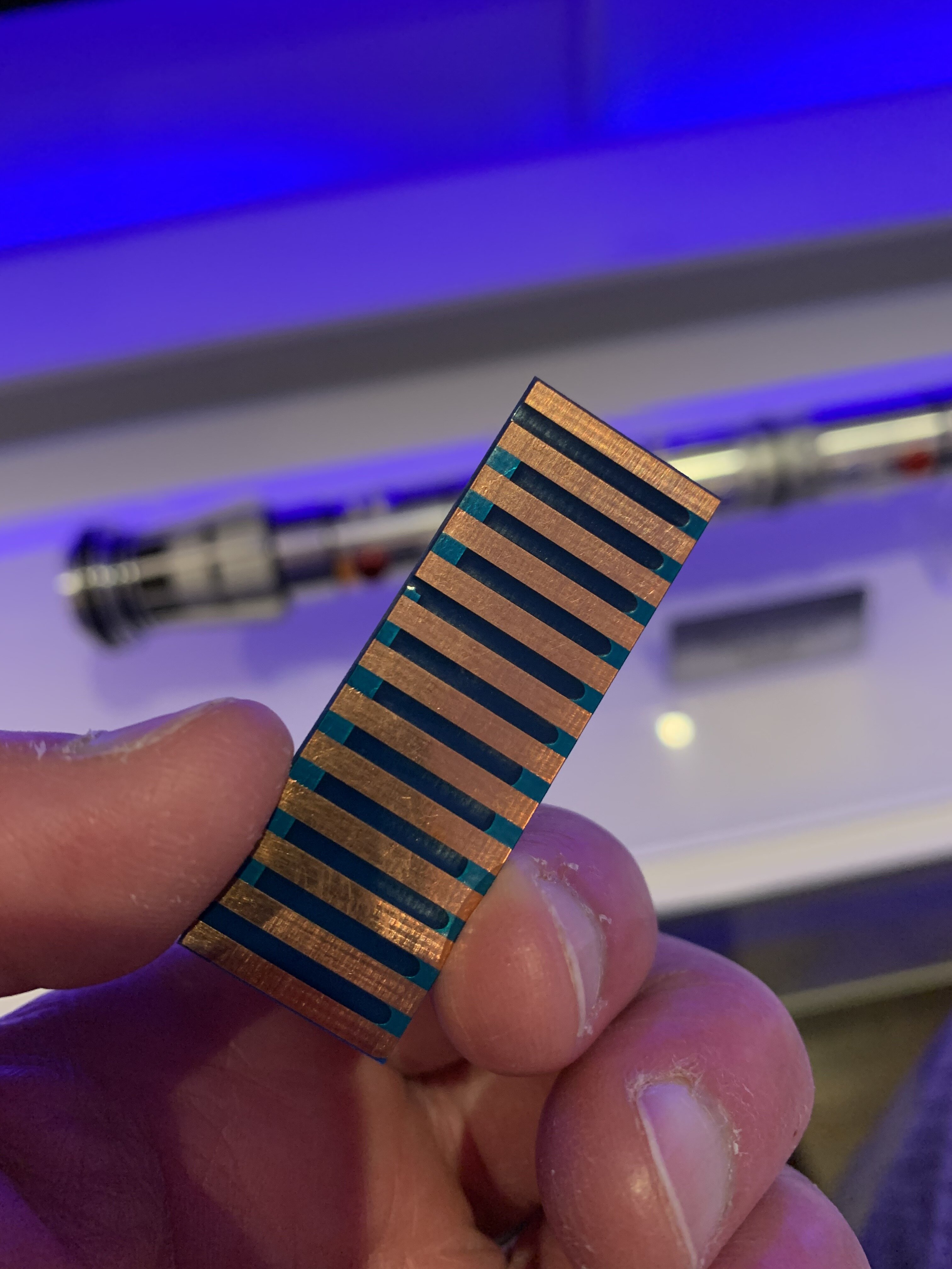

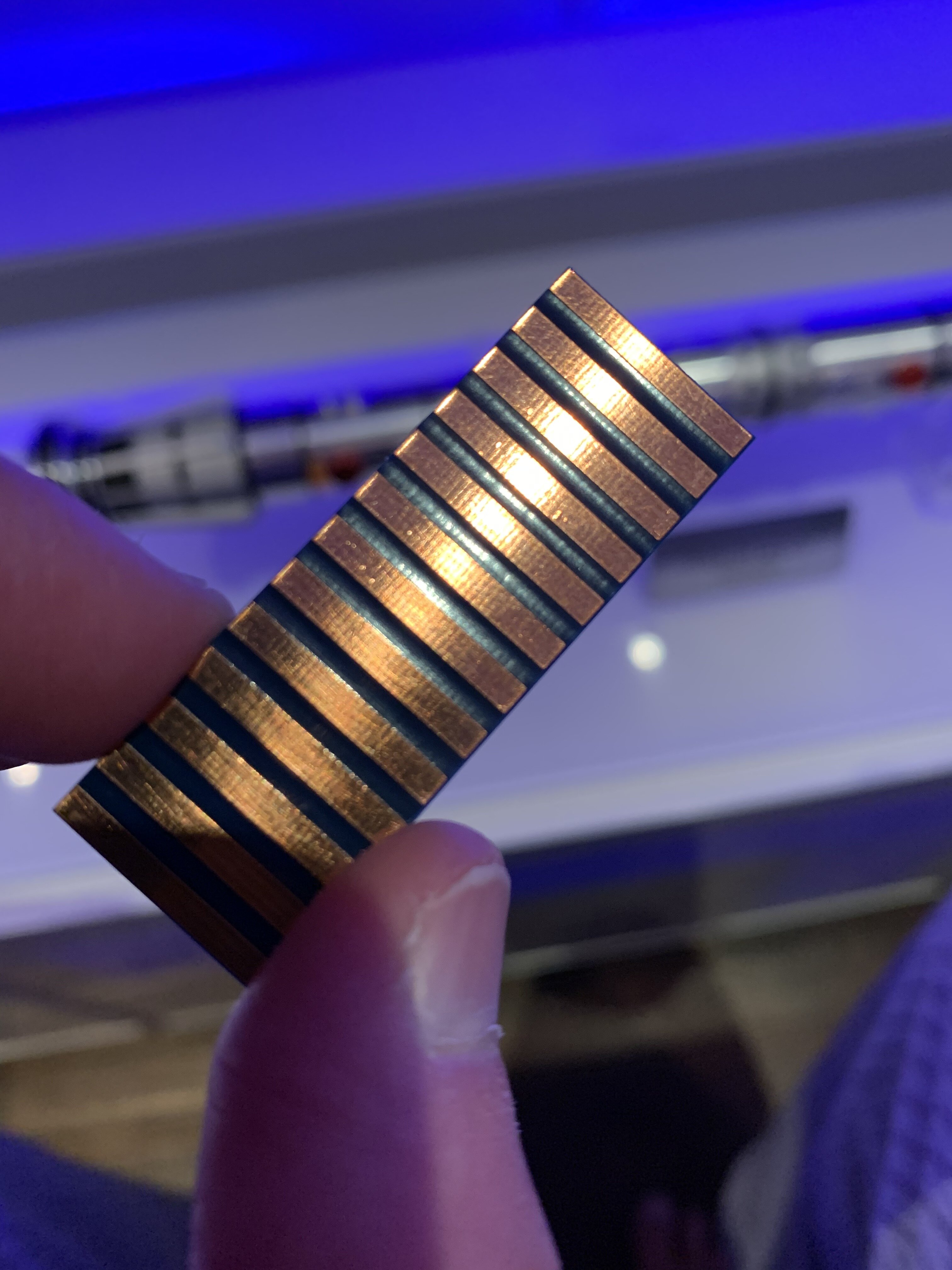

Each kit gets a little sheet with all the bits necessary to replicate the original reveal board and I included a couple extra to fiddle with.
