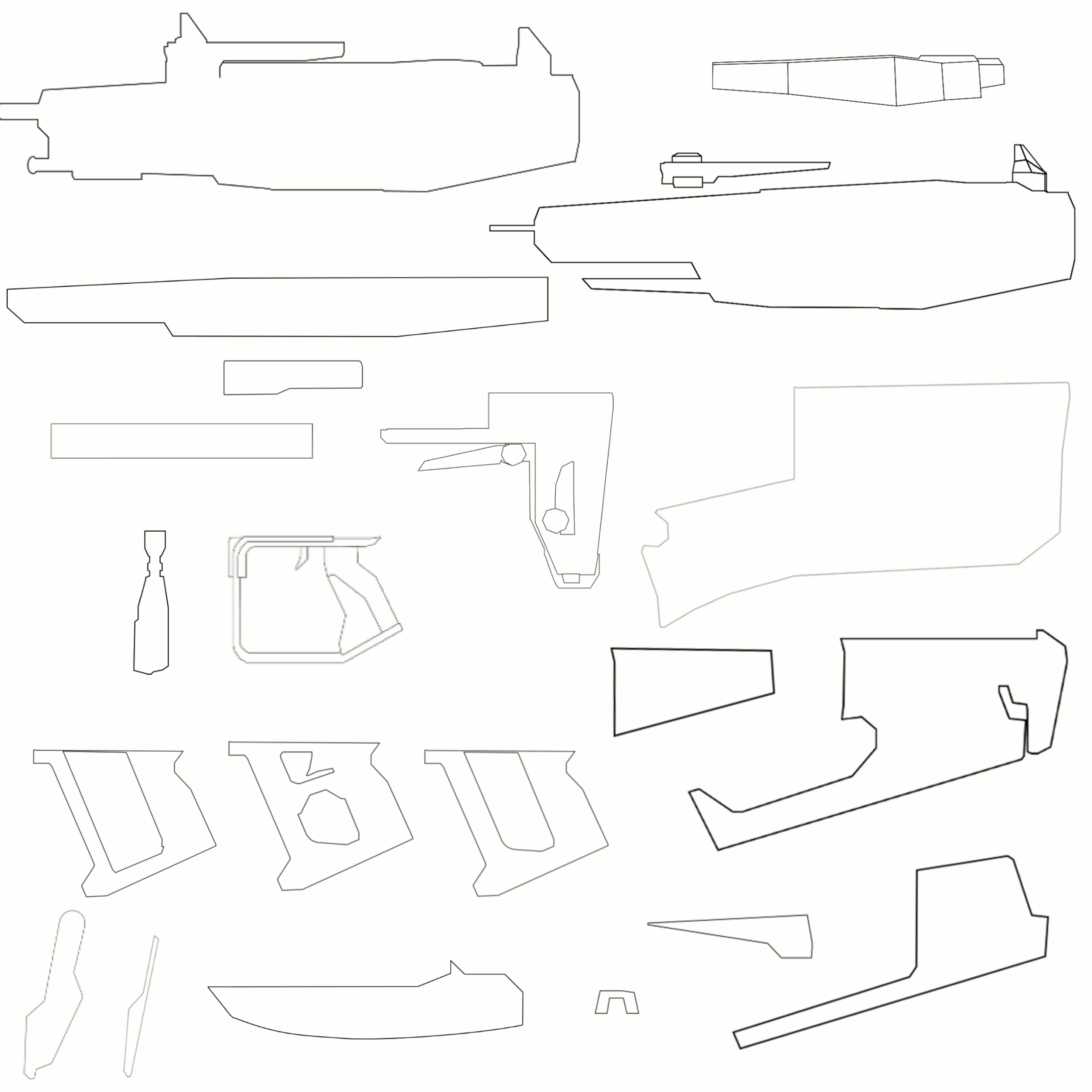

My plan is to split the blueprints into the body that each gun uses and each piece. These will include about 2 to 3 blueprints for each piece depending on the piece.
The next step to this will be carving MDF into each layer, then joining each layer together to make what I'll call "blanks" for now. I want to use MDF pieces instead of clay so I can reuse them for mold for however long I need to if I ever need to make more. hint hint hint

These are around 20 blueprints of layer all scaled and set to match, now time to go to Staples....
Had to put it in JIF form for you guys.
