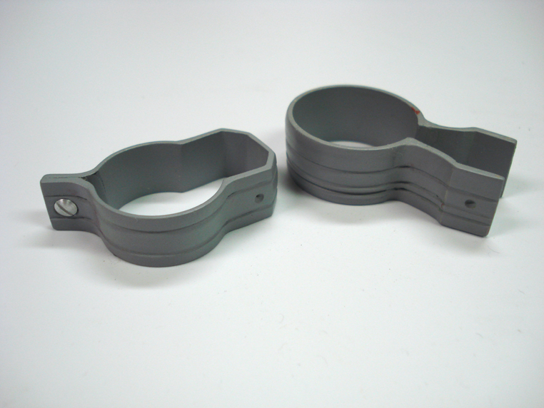

Almost finished with all of the parts! These two little parts are the front and rear rings for the sight/scope. I think that these two little parts may have been the most difficult parts of the whole build! The rings are turned from acrylic on the lathe, and the straight parts are all built up of styrene and epoxy putty. Keeping all of the grooves all even was tricky, and they had to perfectly fit around the sight base. There is also a tiny screw that I turned and slotted. Whew!

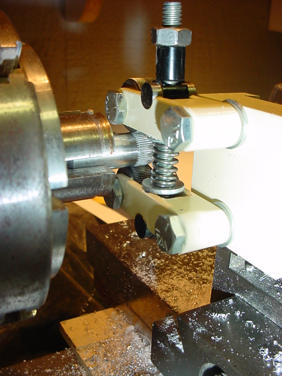

Here’s a close-up of my knurling tool on the lathe, putting the knurling (that ridged pattern), on a blank for one of the little knobs on the sight/scope.

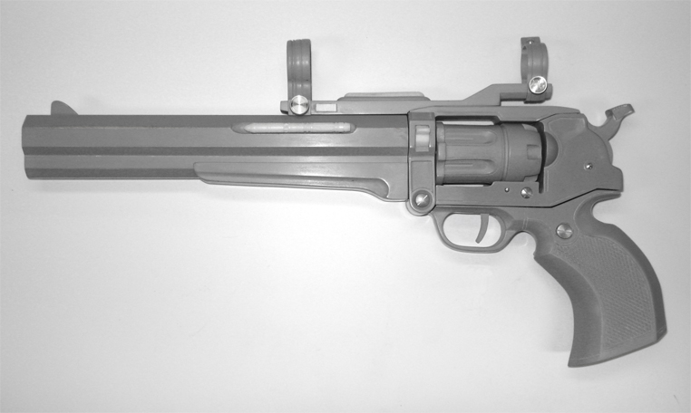

Finally, I am all finished with all of the parts for the master!
With the additional parts for the sight/scope, and the other cylinder swapped in, you can now see the Jakobs pistol in it’s Rex form, as in Sir Hammerlock’s gun. The only thing that is left is to model the larger hemisphere on the receiver/frame, with the loading gate built in. I will model this as an added overlay part for both sides on one of the first cast receiver frames out of my mold, and make it separate cast add on parts. I also need to make the superfluous rear sight that mounts in front of the hammer.

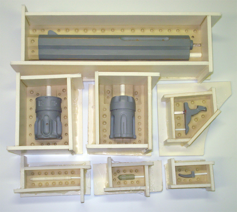

Finally! It’s been quite a while, but I have finally got some of the Jakobs pistol parts clayed up for silicone!

oooooh baby the schmexiness!!! Get better soon, I was hit with the same thing this week.
I'm working on it. This flu takes forever to get over.
