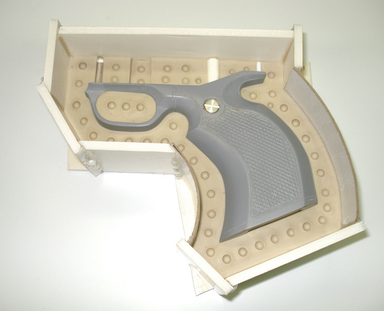

This Jakobs pistol part took hours to finish the clay-ing. You may notice that I prefer to build sprue and vent formers into my molds instead of cutting them afterward. Nice round sprues and vents unmold easily and cleanly.

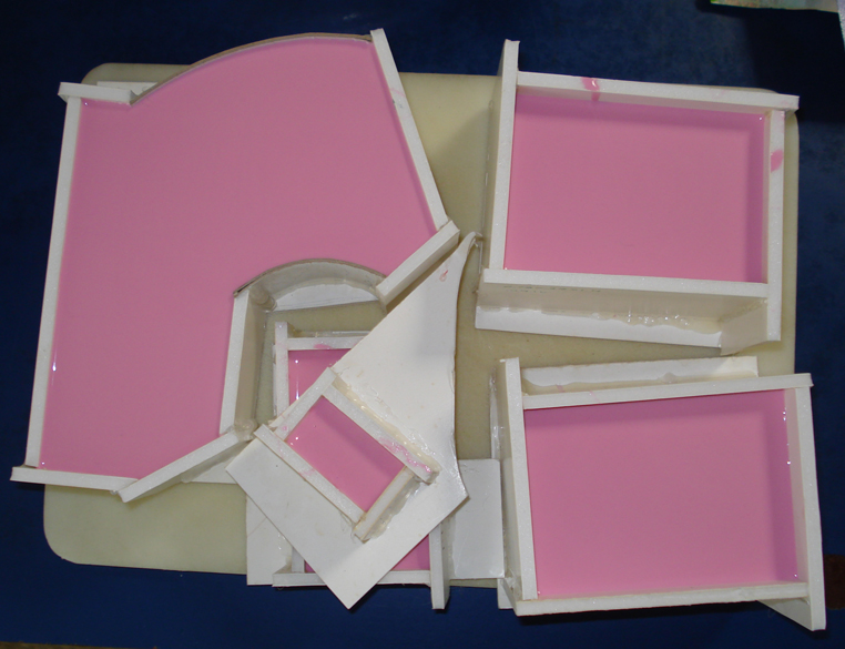

Yea! I finally got started on pouring the molds for the Jakobs pistol yesterday!

What flavor of silicone do you like? I've played around with a couple but I'm not set.
I'm using Smooth-On MoldMax 30. This is the first time I've used a pourable silicone, all of my past molds have been pourable urethane or silicone putty (for small molds). I'm really liking the MoldMax. I have had no curing problems, and it degasses nicely leaving no bubbles. Several of my old urethane molds have turned back into sticky goo, that stuff can be unstable in the long run.

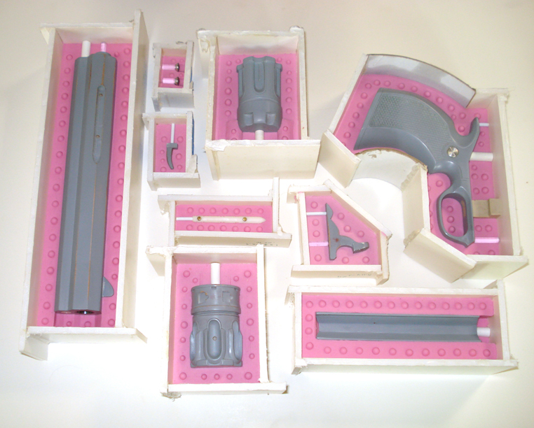

OK, I’ve got a bunch of the molds all de-clayed (un-clayed?, dis-clayed?), and ready for the second pour today.
Disclayed. As in, "I'm completely disclayed at the disclay of your prowess in working with dis clay."
Eight years of higher education, folks. :p

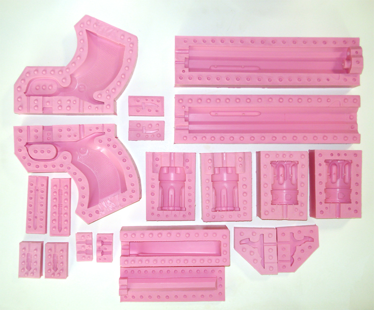

I finally finished up the two Jakobs Pistol frame part molds. These took a bit more work, as they are a little more complicated than the other two part molds. For parts with severe undercuts or odd shapes, multi part molds are often required. These two parts each required a three part mold, with a separate block that inserts into the mold to create a cavity, in one case, or allows the part to release on the other part.
Now I am almost ready to start casting parts. All I need to do is bite the bullet (no pun intended), and part with a big chunk of change to have some resin shipped over here. Because I live in the middle of the ocean (Hawaii), it costs nearly as much for shipping on supplies like resins as the materials cost in the first place. Ouch.

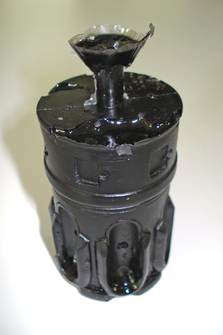

My casting resin has arrived, and I have begun casting. My first casts have been partially successful, which means, of course, that they were a failure. I’ve got issues with uncured sections, bubbles and voids. After a late night online, I think I’ve got most of the problems figured out. Now it’s raining like crazy, and humidity turns out to be part of the problem, so I will be waiting for the weather to clear before I try again.
