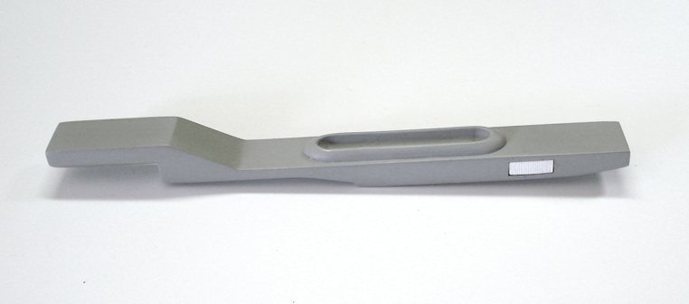

Do you remember from the pictures way back at the beginning what this part is? It’s the base of the Jakobs pistol sight/scope.
