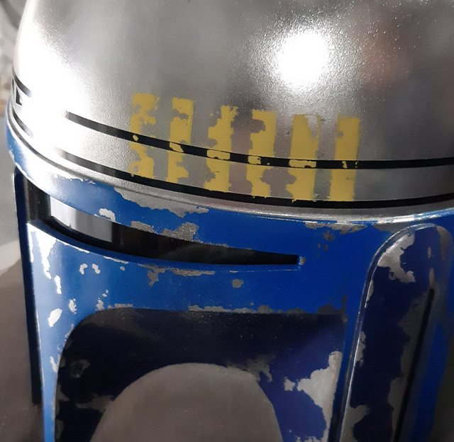

I decided on six kill stripes. Here it is masked up:
I used petroleum jelly again for the paint chipping effect, making sure to get on the edges of the piping... then spray paint on top:
The final result:
I started the distressing process by applying dark brown (raw umber) acrylic with a brush to all the recessed edges:
I also started building up layers of acrylic black along the bottom edges of the "metal" with a sponge as well as on some of the blue parts. I kept working shades of brown and black along the dome with sponge and brush, then wiping with a soft cloth to get different effects. Lastly, I added some lighter tan spots throughout the surface with a stiff brush, stippling for a more dirty look.
Here's the final beauty shot:
You can see the full resolution photo at imgur to see all the detail. This has quickly become one of my favorite helmets in my collection! Thanks to everyone for your input and encouragement.

Did you clear coat this after the final finish or is this without a clear topcoat.
Also, what color did you use for the dark blue please.
Thank you in advance. Great job as always
It looks identical to the day I did it. I haven't been handling it much (no one has actually worn it as a costume piece yet), but it has been handled a bit... so far so good!

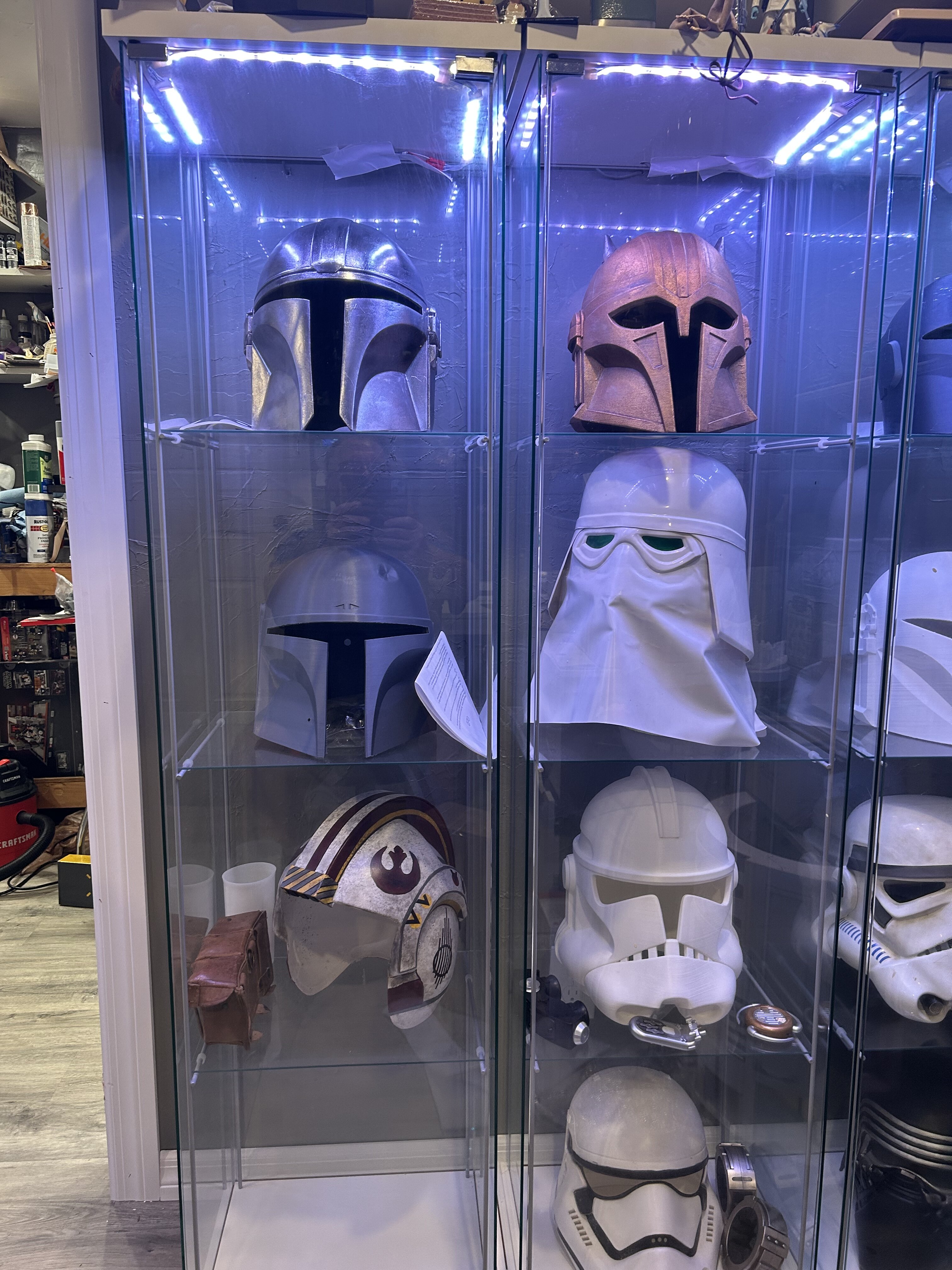

Thank you for bringing the powder to the table. Here's my Armorer and Mando helmets using powder and weathering with acrylics. I’m sold on this powder for sure and will use it on all my Mandalorian helmet builds

The chrome powder gets permanently fixed to the paint and no clearcoat is required (I find that only dulls the shine).
