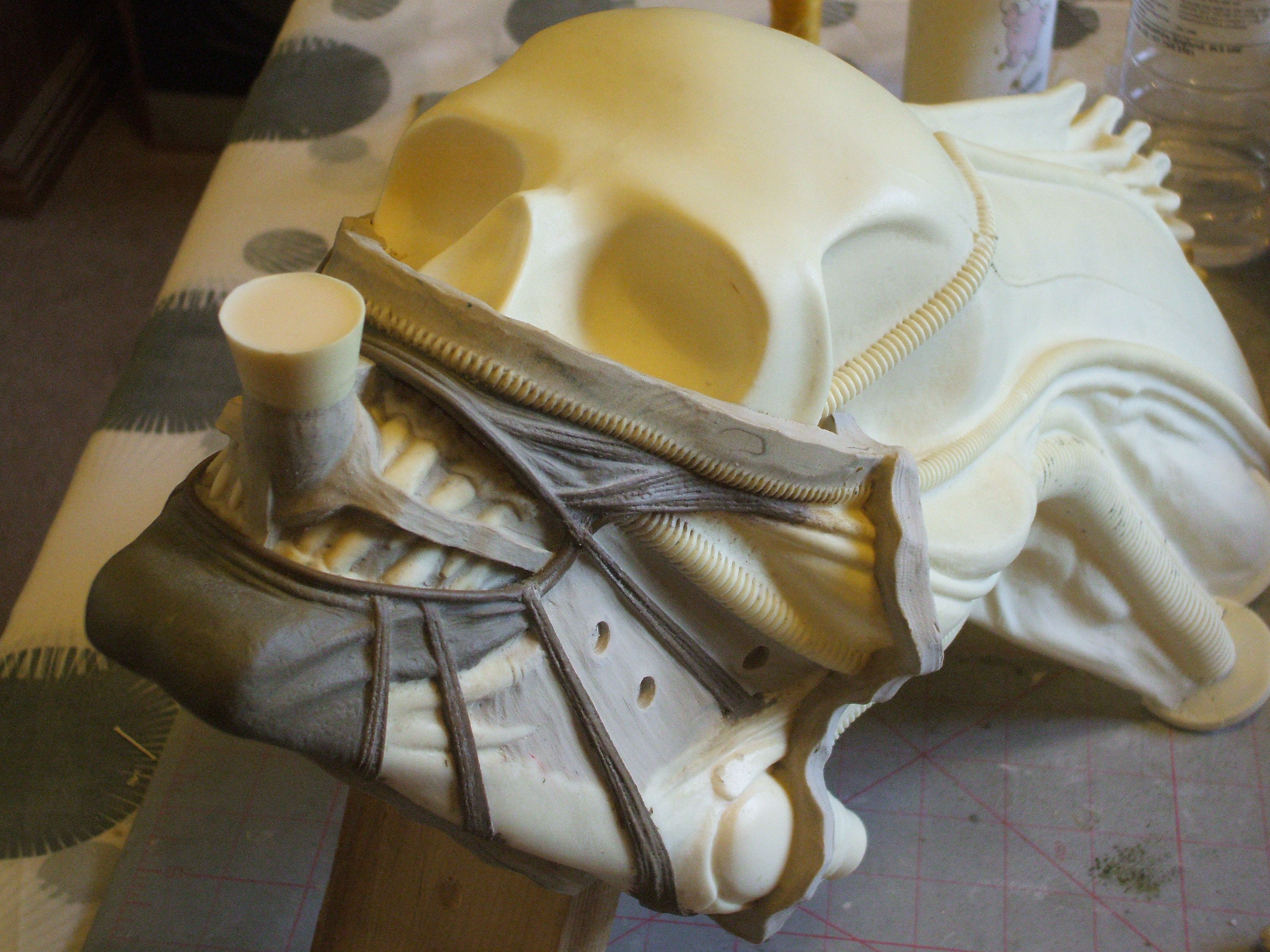

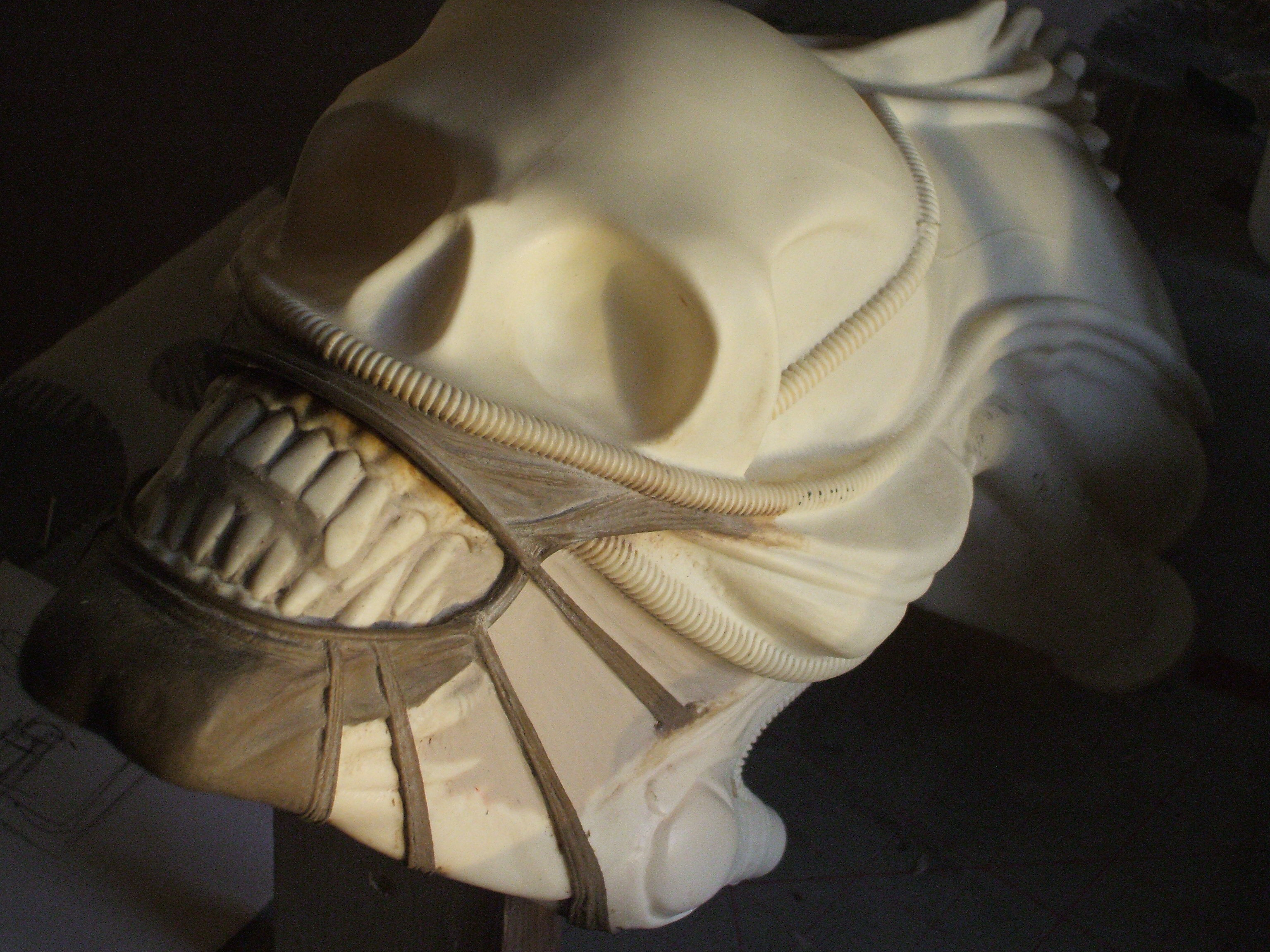

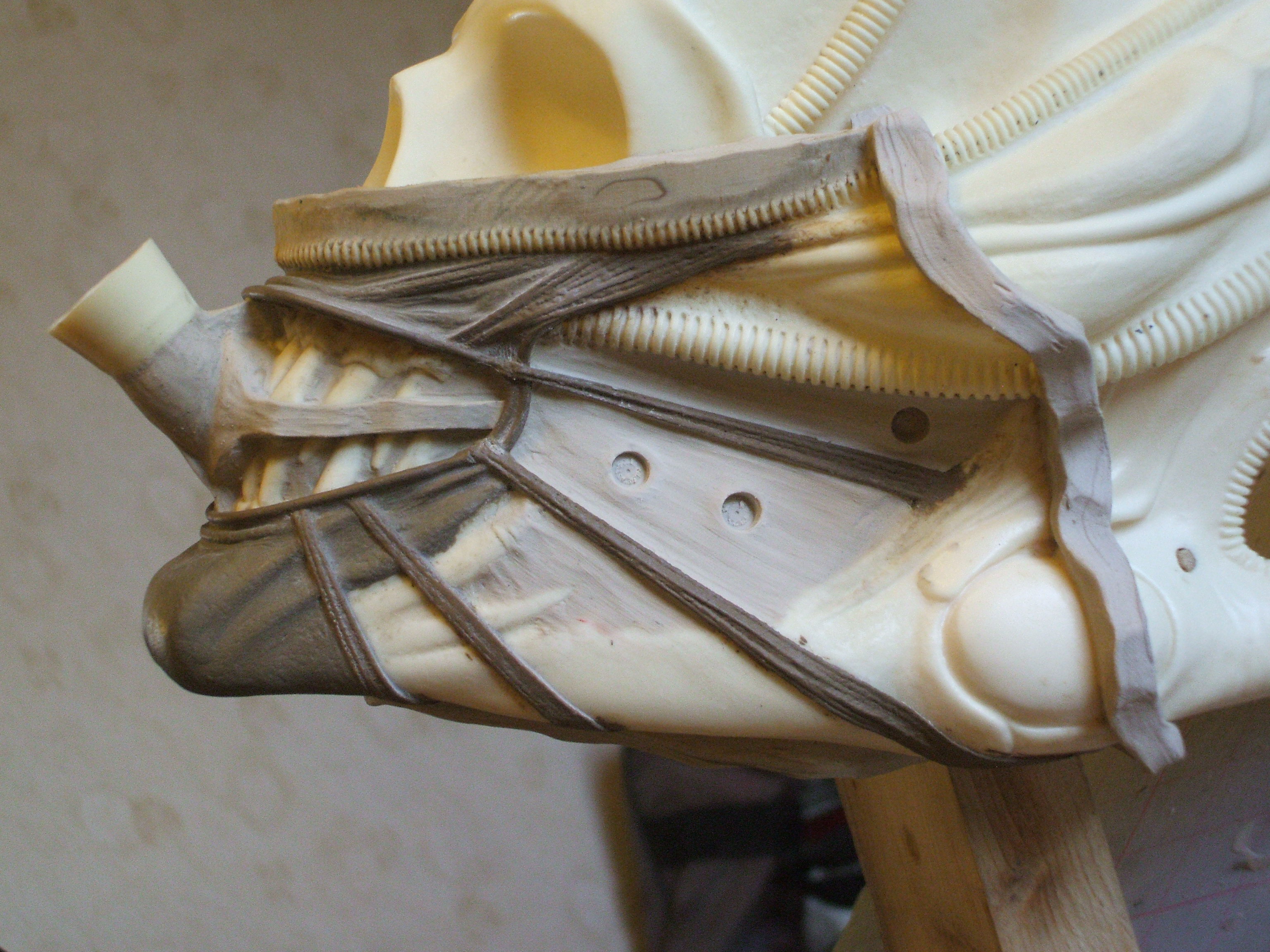

OK, I started experimenting with this, trying out different options & testing whether some things will work.
The Vertical tendons will have to be cast separately from the rest. If the mouth is to be able to open, the bit between the upper & lower lip should stretch. The top horizontal tendon comes from the back of the top lip & is anchored to the back of the jaw. When the jaw is opened this tendon will move down a bit. If its cast to the vertical tendon it'll stretch in a different way & wont look right when the mouth is open.
The other advantage to casting it separately is the personal choice when it come to assembly :)
As I said above, I've tried all the options I can with this & this is what I'm happy with:
The only bits I've not re-made, re-sculpted or altered are the chin, the bottom lip & the two chin tendons either side, everything else has received some attention. I'm really happy with the extra tendons on the top lip, these were inspired by the Rambaldi head & also the cover of the book Giger's Alien. The other tendons have been re-made thicker & I feel they look better, they'll also cast easier I expect :)
Overall I'm happy with how this looks now & I just need to knock up a mould :)
Thanks again for your thought on this :)

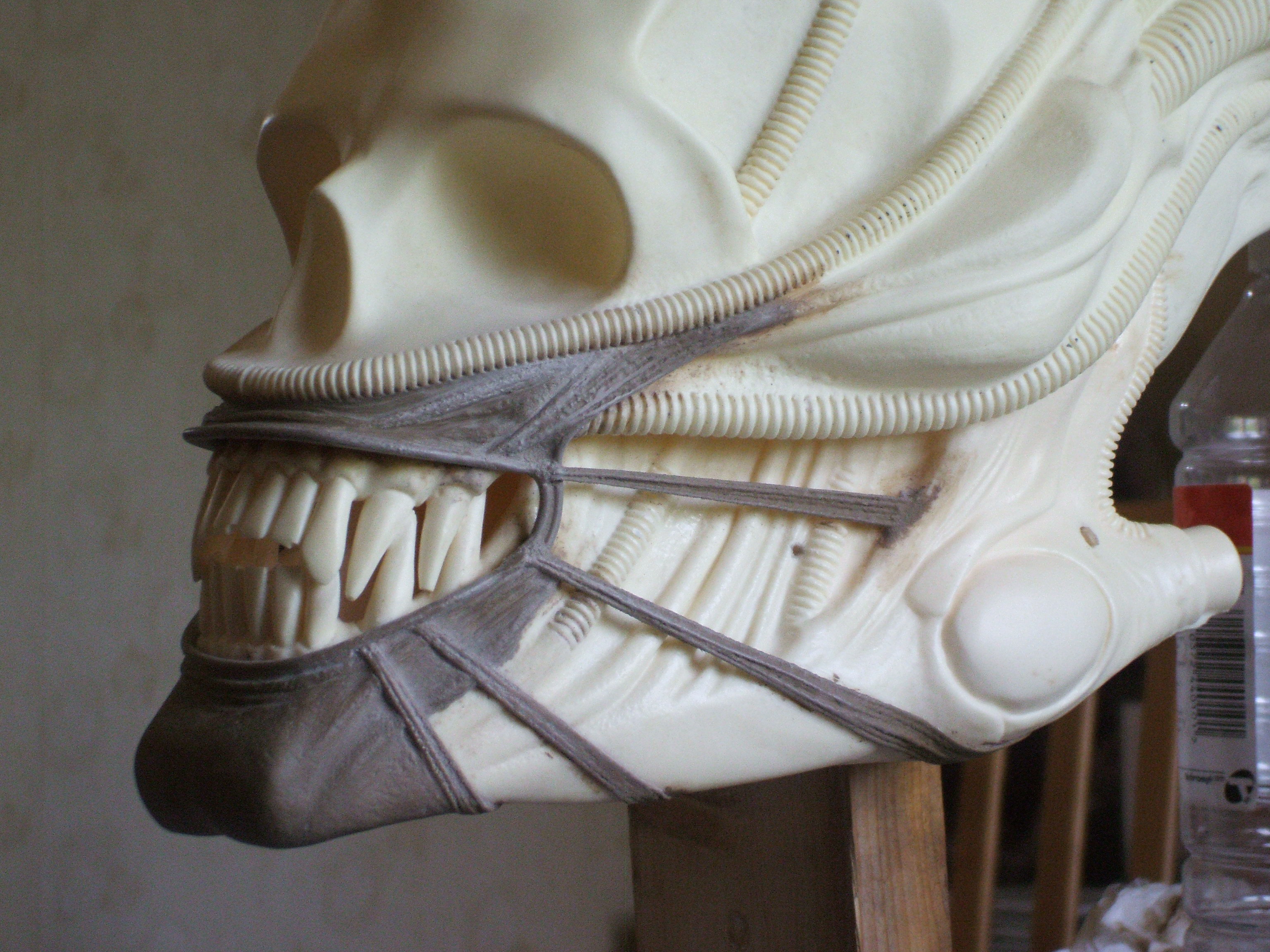

Re: Bob the Alien (Giger inspired Alien) Sculpting finished page 45
That's looking really nice. I think the separate vertical tendon is the way to go.
The builder can achieve either look that way and the movement will be cleaner as well.

Well, I'm hoping to make this set stretchy enough that the jaw can open mostly. At the very least this set should stretch enough to expose the teeth on the tongue as a static display.
I'm going to have to make one or two more sets at some point. There'll be a closed lip set at least, but I may have to (reluctantly) use Latex to get the full movement. For the closed lip set I want to try to make it so it can be wired for articulation but I probably wont start on that until the rest is finished :)

That's the plan almost exactly... however I'm not intending to use the face I'm making it on as the other half of the mould.
My intention is to do exactly as you say upto "top," then I'll make a mould of the face without the lips & tendons & then a rubber cast of the face which will become the other half of the mould.
I've done some research & I've decided I'd prefer to use a shore A30 polyurethane rubber to cast the lips & tendons. From what I can tell the urethane I want to use should be flexible & strong enough to do the job. It should be easy to bond it directly to the urethane plastic I'm casting Bob from & I should be able to use the same paints that can be used to paint the rest of Bob. The only problem with this idea is that I can only find one supplier online that offer's this urethane rubber in clear & that's Smooth-on.
As far as the actual casting goes My plan is to drill small holes through the mould at the inside ends of the tendons to allow any trapped air out. The urethane rubber is apparently very low viscosity just like the plastic, so in theory should cast in a similar way.
I'm intending to add two metal loops, one either side of the mould jacket. With these I'm going to add a length of rope & then if need be I can swing the mould in an effort to use some centrifugal force to help with getting the urethane all the way down those tendons.
The area I think I might have trouble with is the tip of the chin. I may have to drill a couple of tiny holes through the mould there as well.
This is all guesswork of course :lol I just hope it'll work :confused
