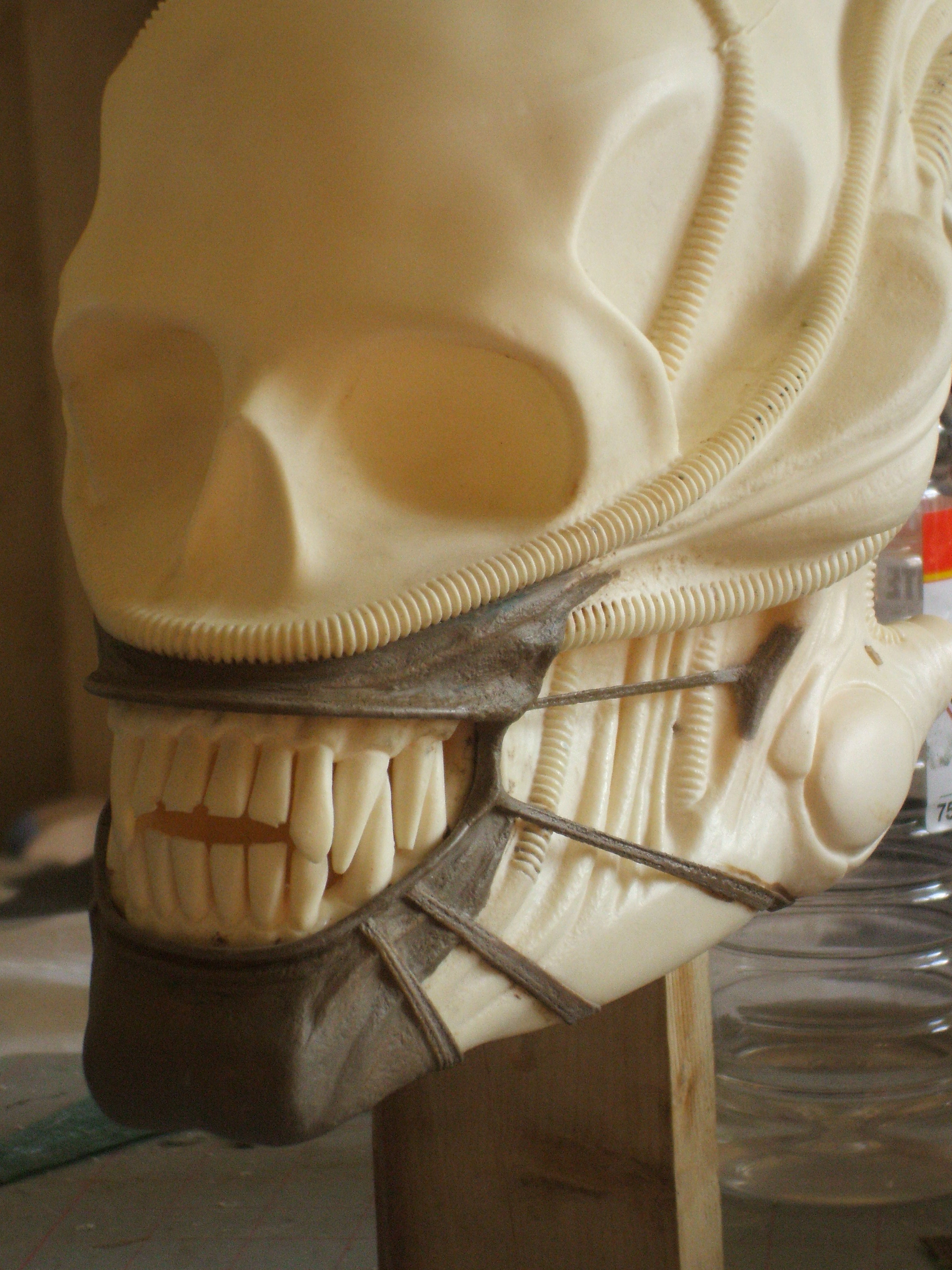

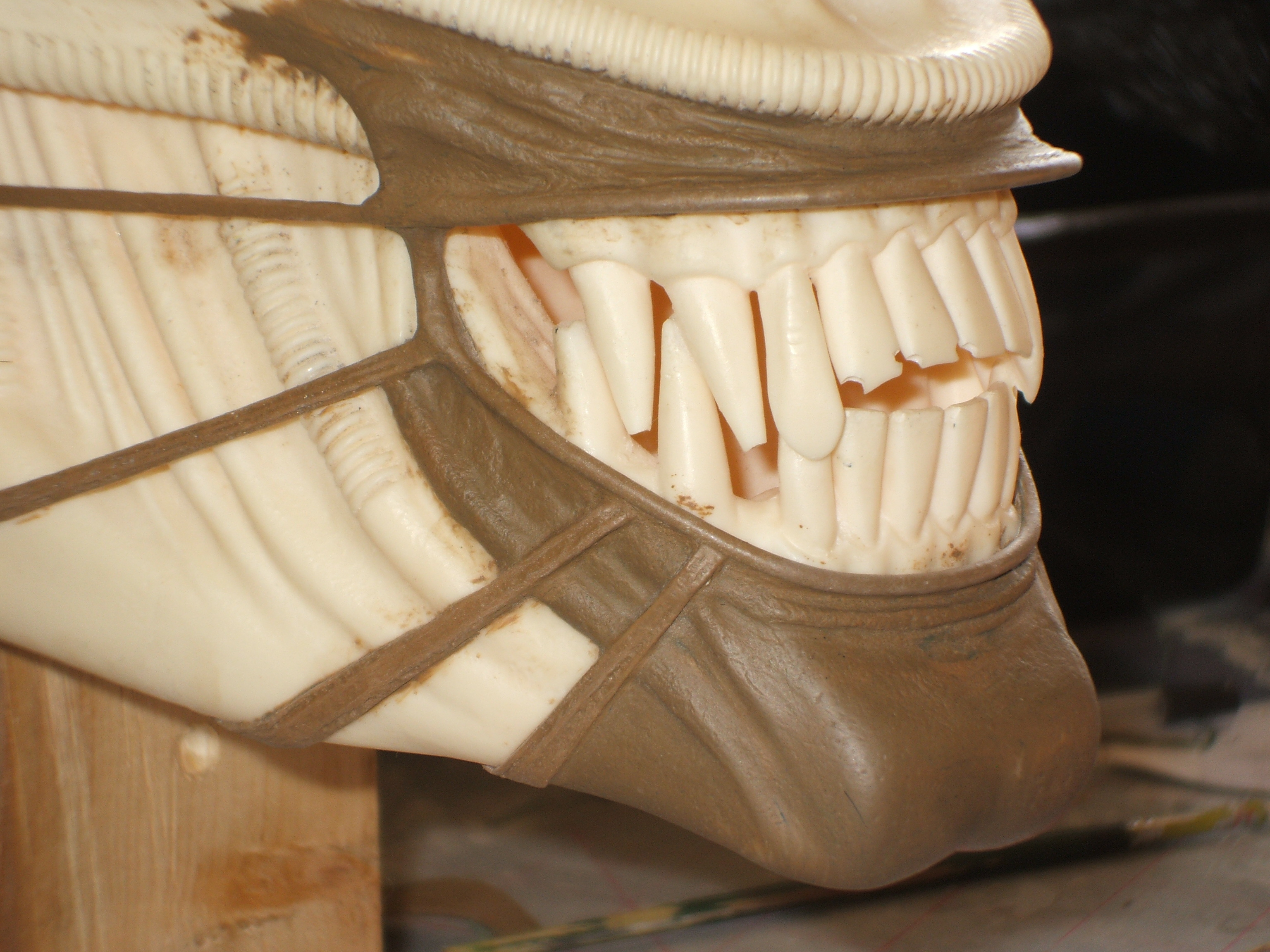

The metal parts of the lips are the overall thickness, they wont be covered with rubber. One version (the stunt version I believe) has thicker lips that look as though they're made from a small bore convoluted tube. I think the Rambaldi lips maybe a little thinner :unsure
I shaped & positioned the metal parts of the lips to fit over the teeth in a closed position, the upper lip actually sticks out 8mm from the gum, Here:
At the moment I'm creating these with the mouth closed but I want to make these from rubber. I'm kind of hoping that the small part that connects the upper & lower lips will stretch enough to (at the very least) pose the jaw open enough to see the tongue. I'm expecting to have to re-shape this a little for a mouth fully open pose while trying to keep the lips the same shape :)

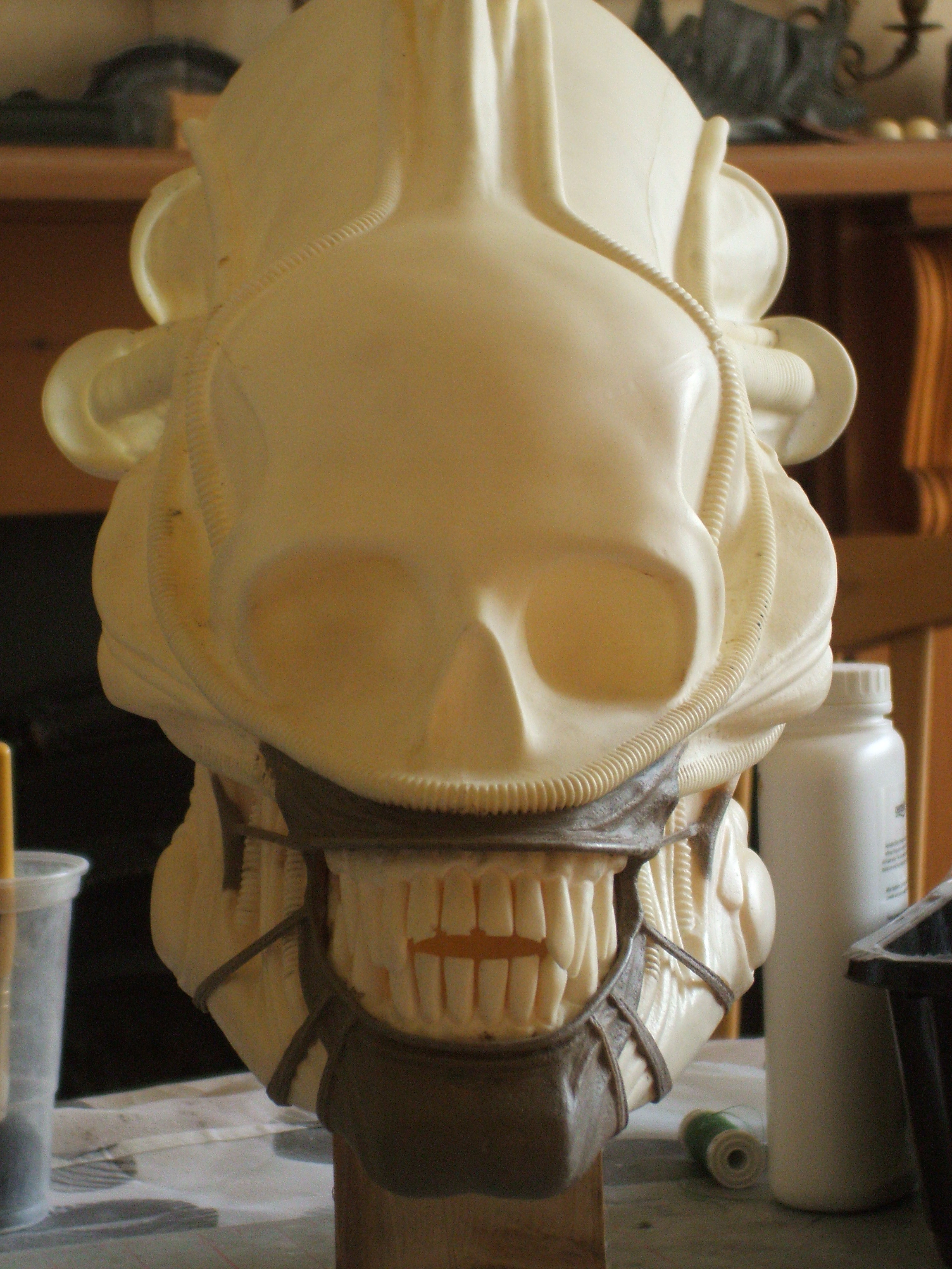

Looks great, Leigh. So you're going for two separate lip/tendon sculpts? You're a bloody hero. :)
Yeah the stunt version seems to have different teeth as well. Not sure what's with that?! And lips so fat, someone must have punched it in the mouth. I guess they'd have wanted a cheap, one piece soft rubber cast for that purpose. They probably did what you're doing - sculpted onto a hero casting, but a bit more crudely. :)

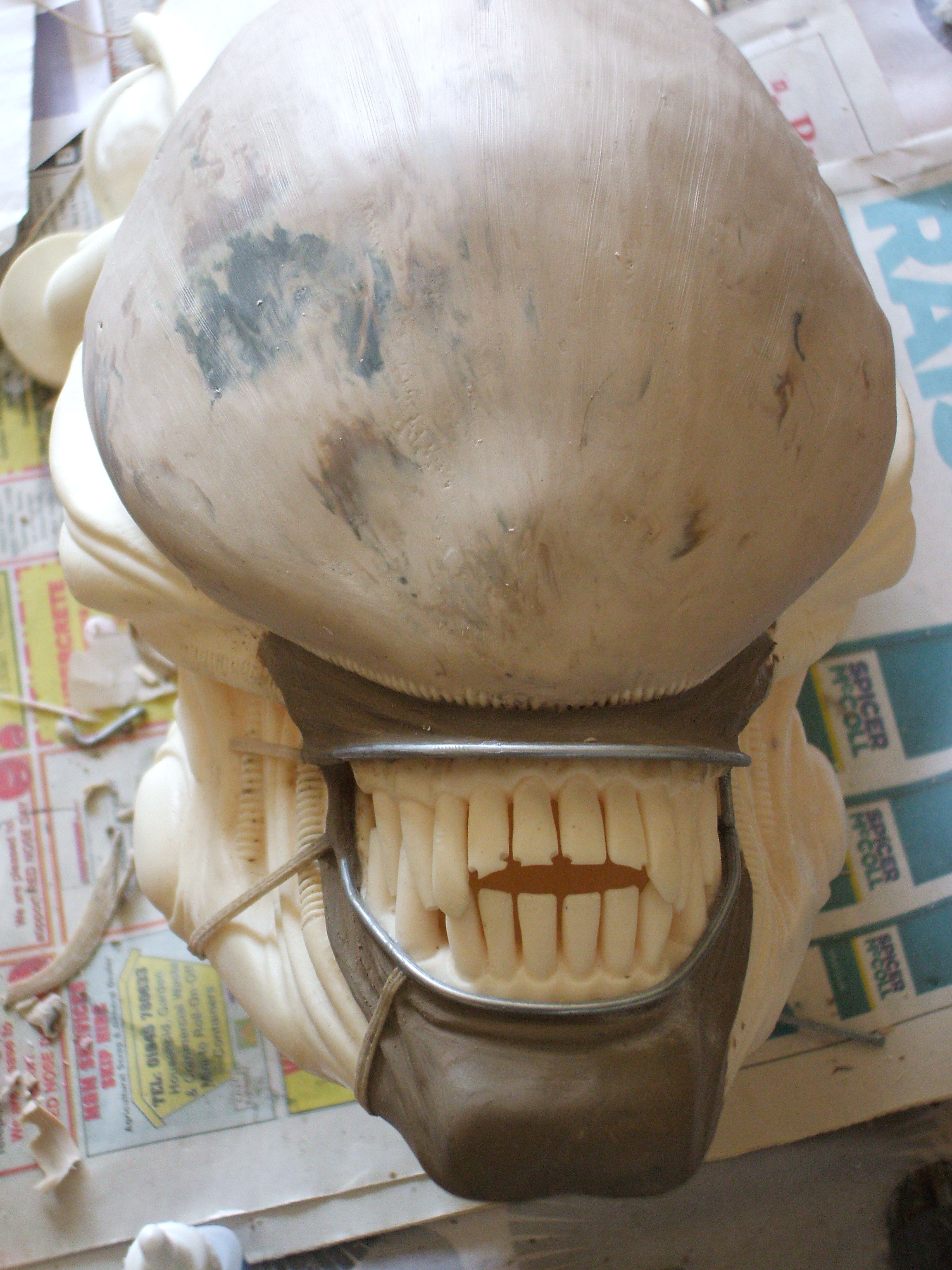

Leigh, wondering if it might be a good idea to start at least the front part of the dome while you're doing the face itself. Might help you balance things out more against the ref, if that makes sense?
This is just roughed out, I'll be making the dome on the other head & it'll be mostly polyester:

Wow, suddenly that looks weird. Gotten so used to the skull, haha!
Yeah, I'm thinking the same :unsure I'm quite liking the shape from the side but not from the front! I'm gonna have my work cut out getting the dome the right shape :unsure

Looks like you're getting some lens distortion with the camera because that head-on shot of the dome looks huge! Otherwise, everything else looks spot-on to me. Will you be doing the fully closed lips monkey face alien? Just kidding!

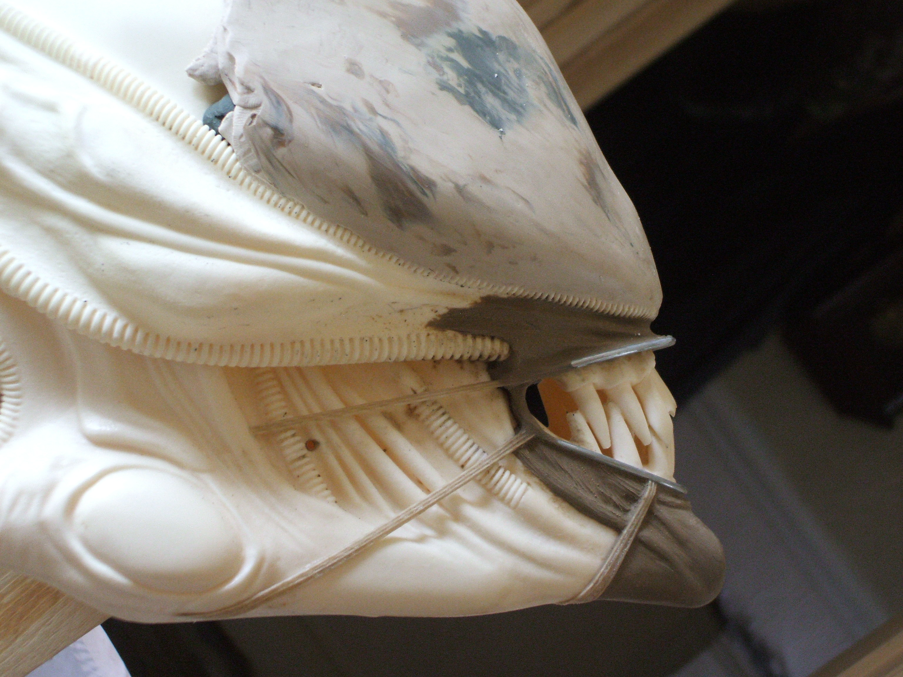

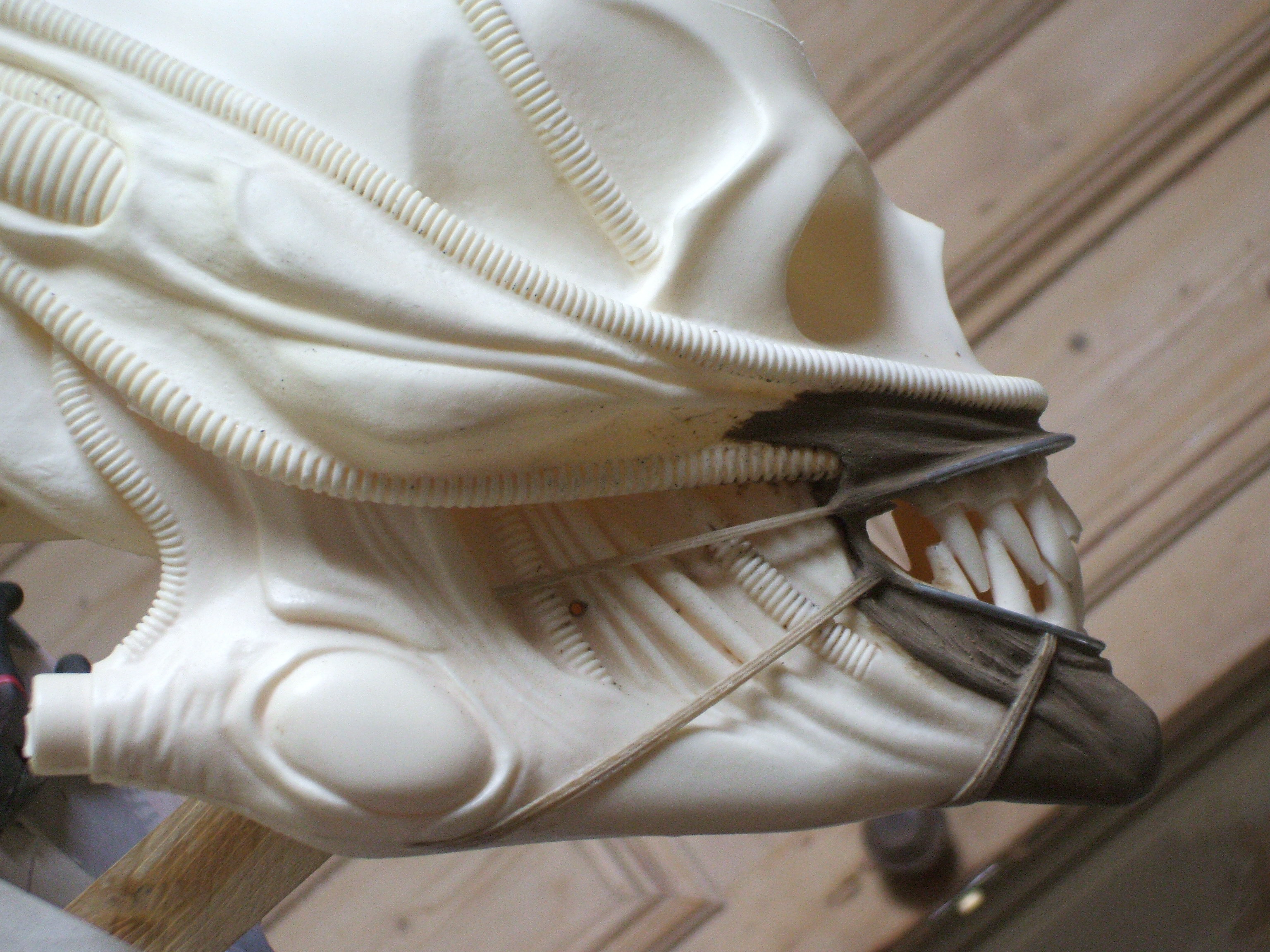

Here's those pic's:
Thing's have been a bit slow lately, I haven't had my head in gear :wacko
I'm liking how this looks now though.
I've tried to incorporate features from two of the three faces used in the first film, I've also tried not to go overboard & clutter things up to much. I'll be looking for criticism on this part :)

Its quite symetrical...a bit of an un-even snarl would for sure fit the face

I really like the folds under/over the lips. The texture looks nice too.
And this will all be one piece of rubber right?
Thanks :) I've been trying to avoid Symmetry from the start, my thinking being that nothing in nature is symmetrical. If you really look at the front view you'll see some subtle differences side to side. I didn't think a "snarl" would be appropriate for Bob. Only the later variants of the Alien were articulated enough to produce a realistic snarl. The original could tilt the sides of the lip wire up at the rear, I did try it out but it just didn't look quite right. I fear it would start to introduce the basis of a personality, the first Alien acted on pure instinct :)
Thank you :) Yes, that's the plan. To cast it in one piece clear rubber but I'm still not sure what rubber to use at this stage. I want to avoid Latex but it needs to be almost as stretchy & paintable. So I'll be sending off for some samples soon :)
