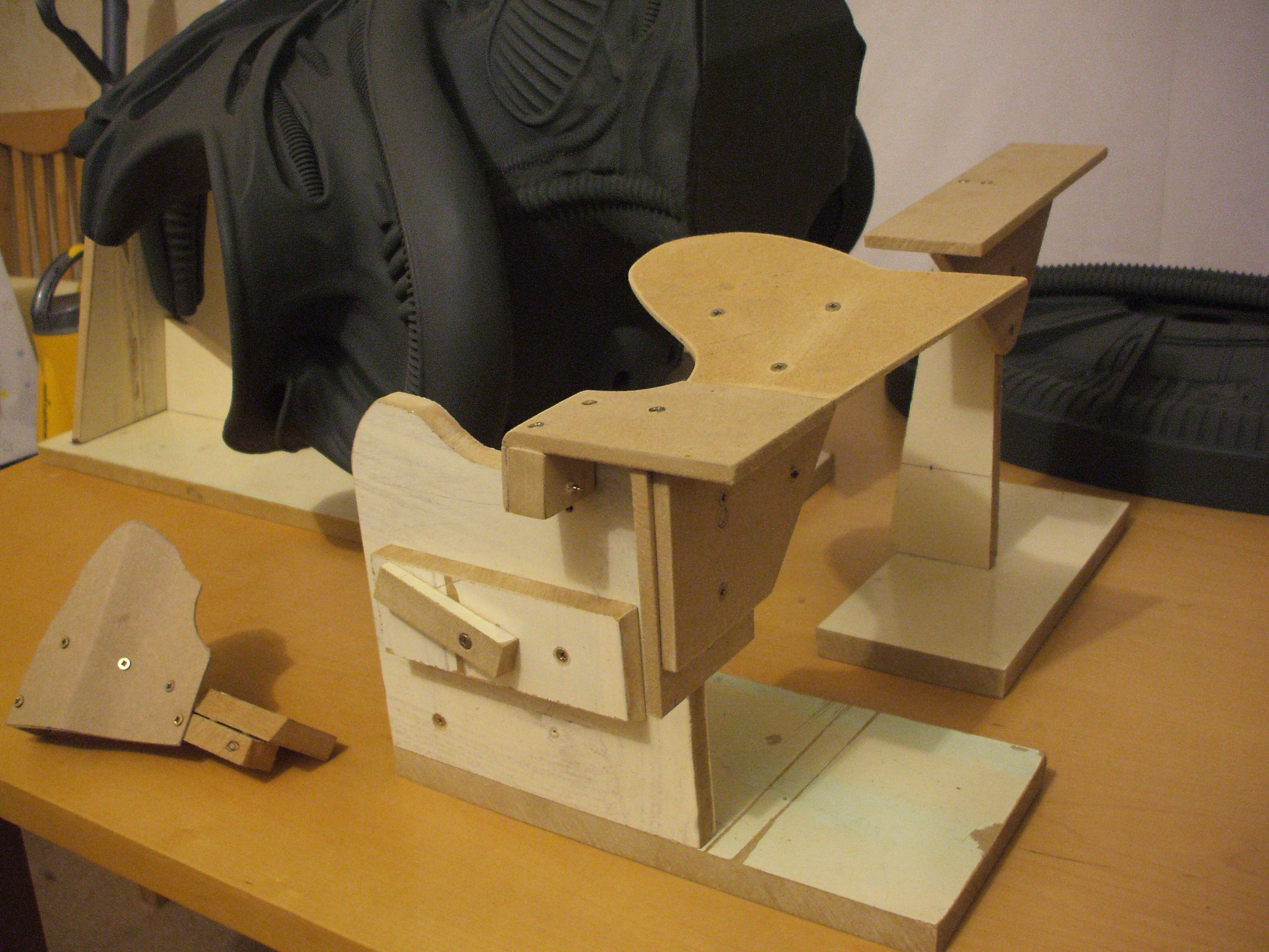

My next move will be to build a support structure for the main body section, then I can start building the structure's that will support the partition's for the mould (lots of woodwork).
I'll document as much as I can through the moulding/casting process but there may be pauses in the updates from time to time.

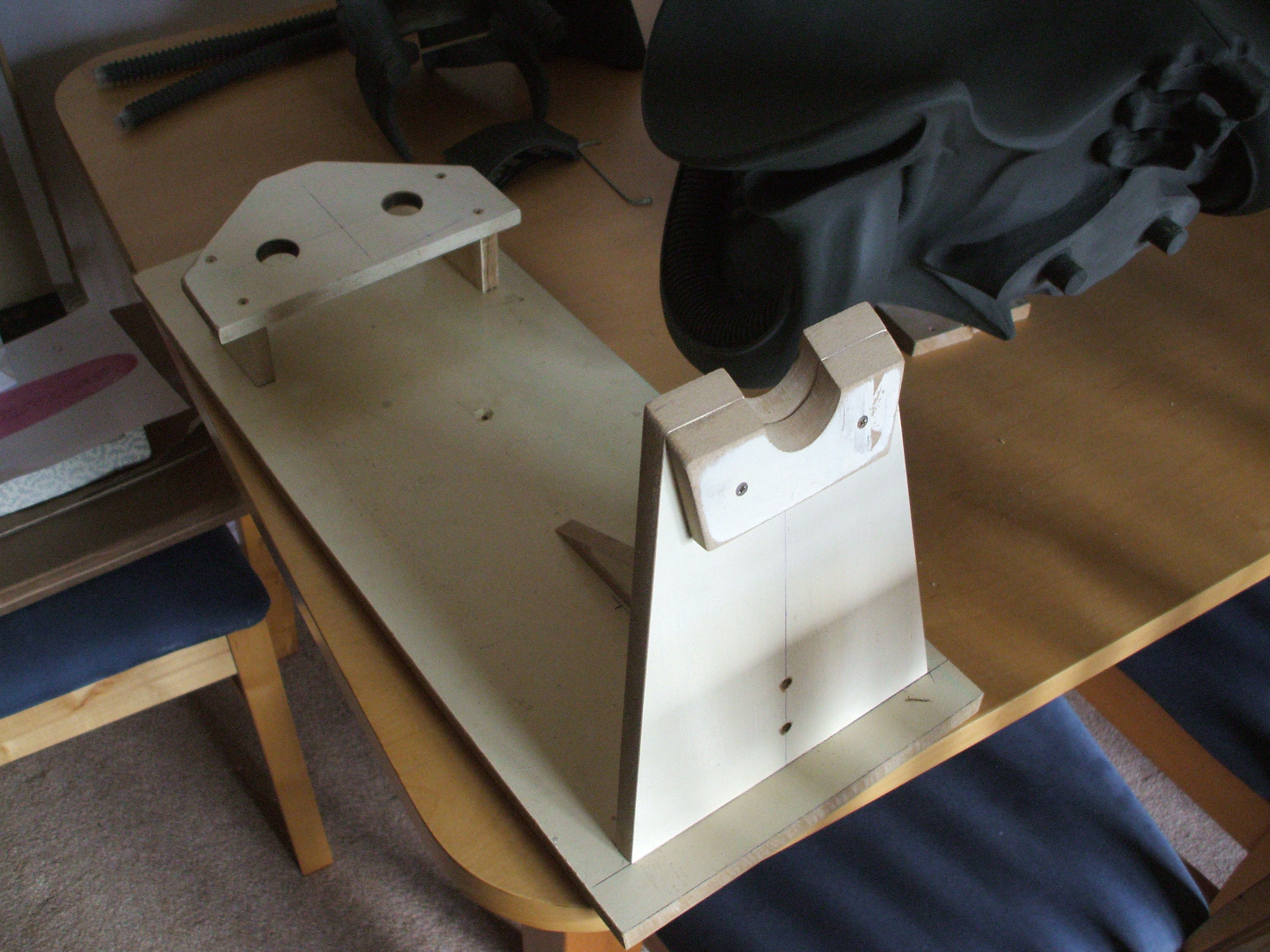

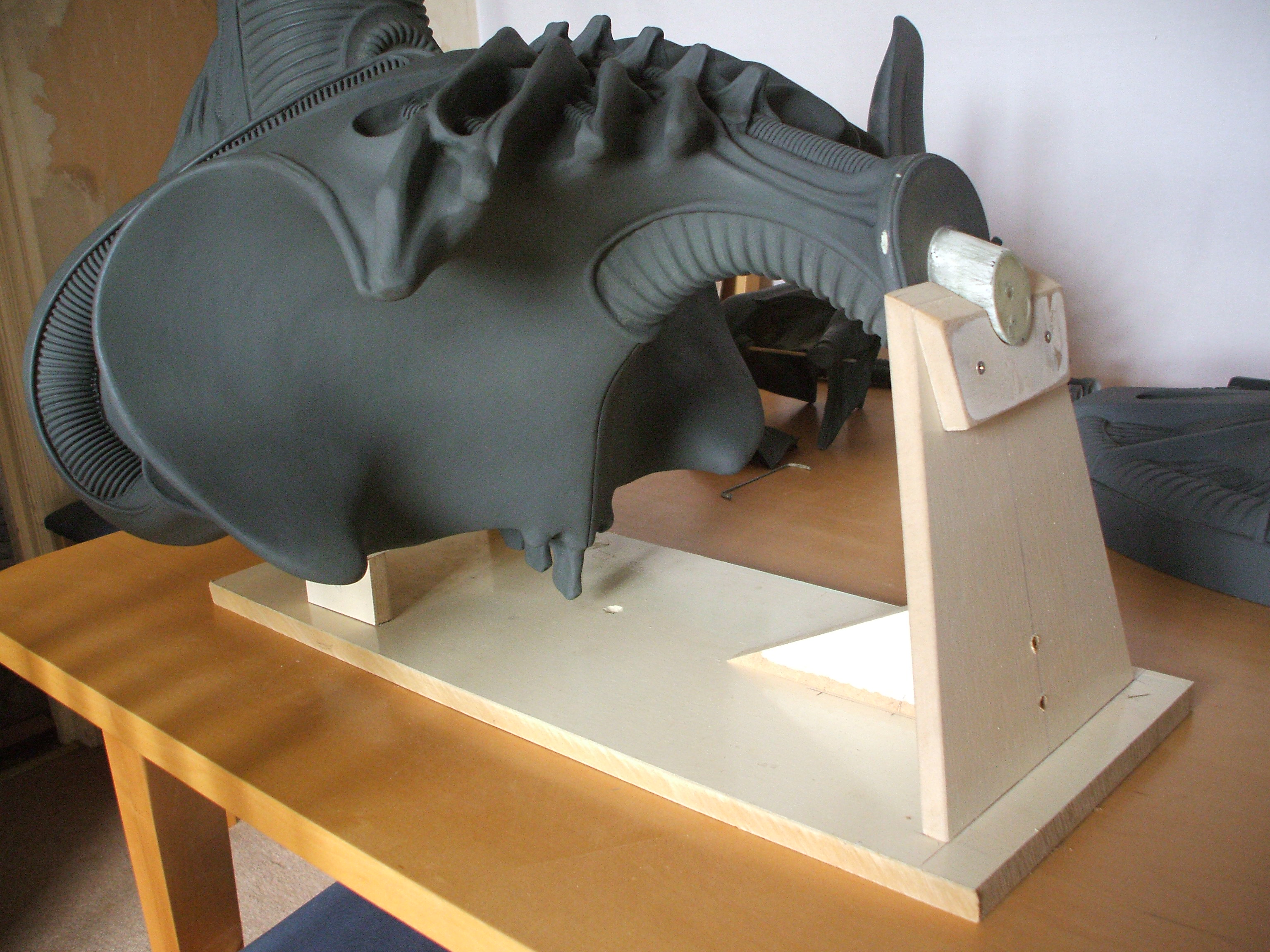

I've started making that support structure :)

This part really is awkward to support! It only has 4 hard area's that will take the weight & only one of those wont have any rubber going onto it for the first part mould. It also has to be fairly sturdy but I didn't want to over complicate it :)

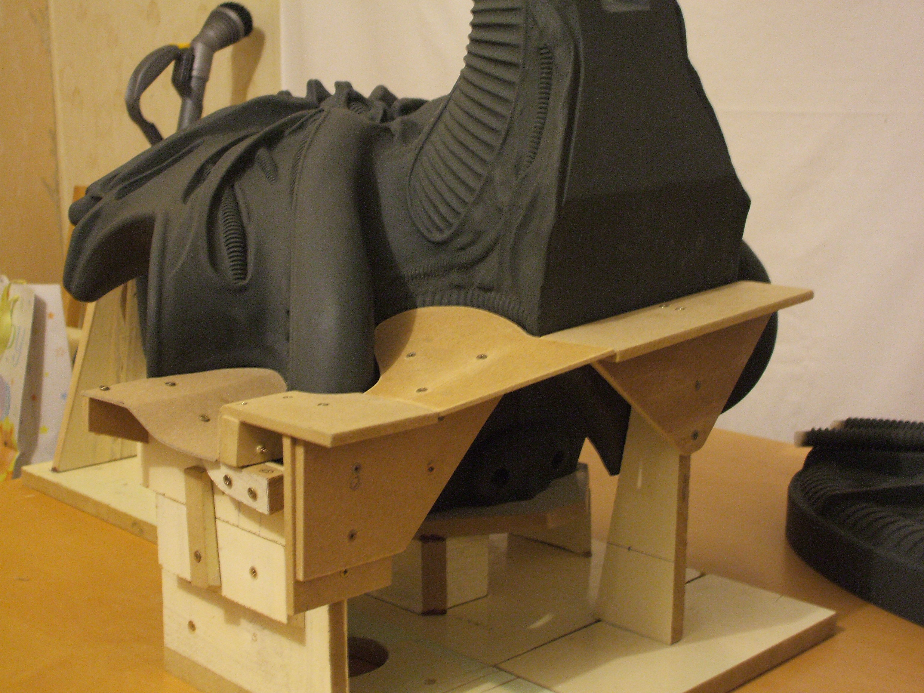

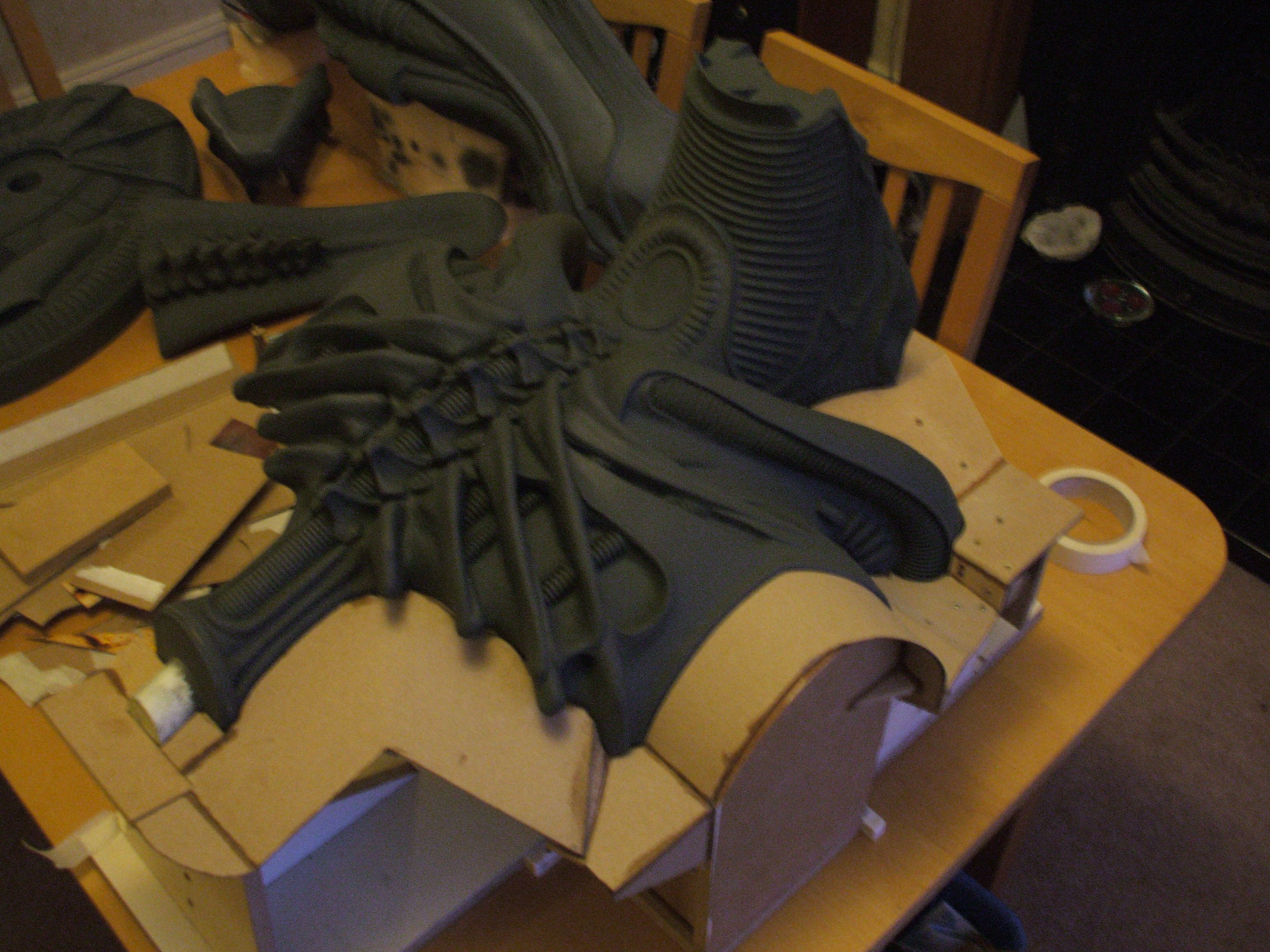

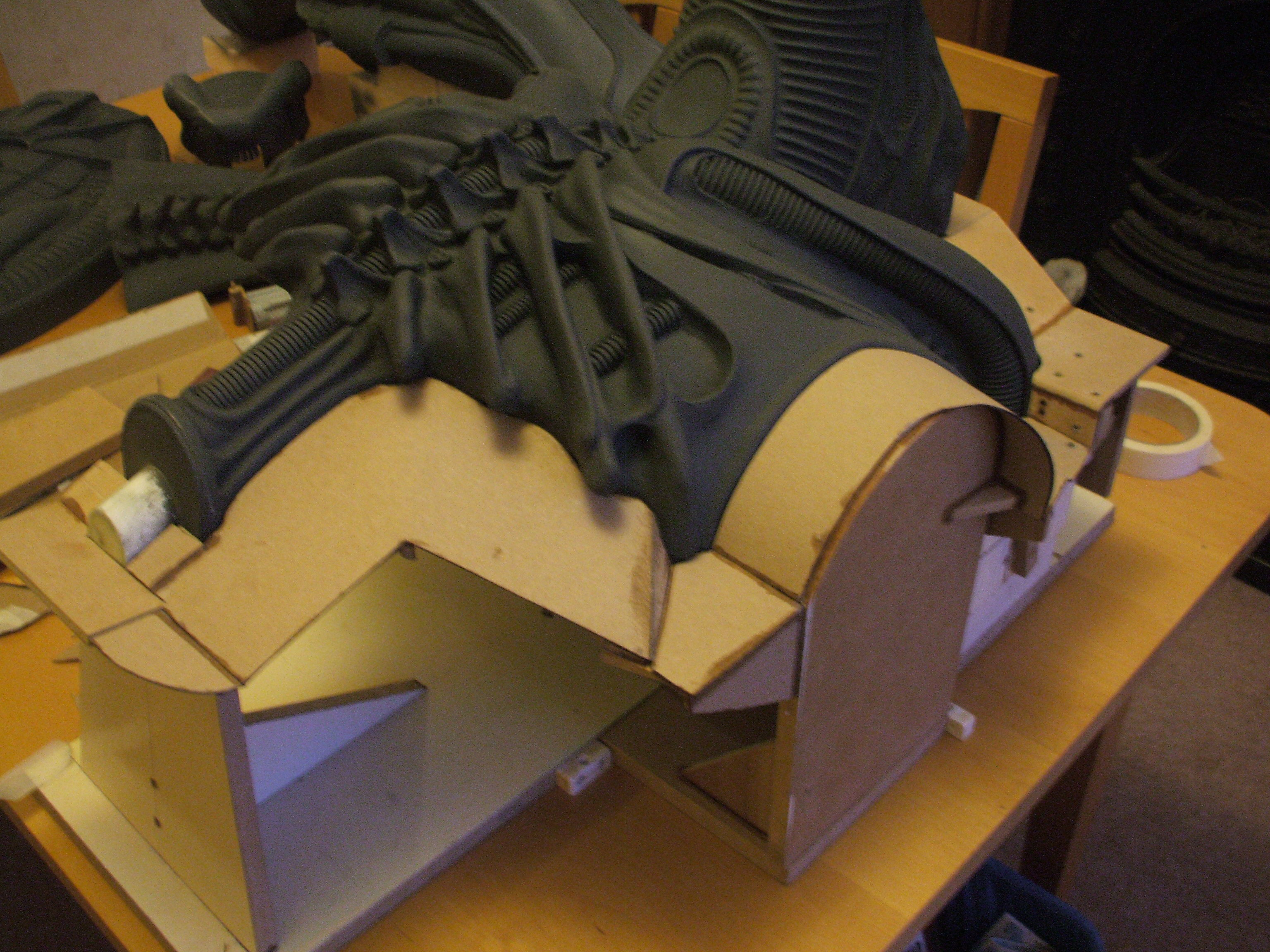

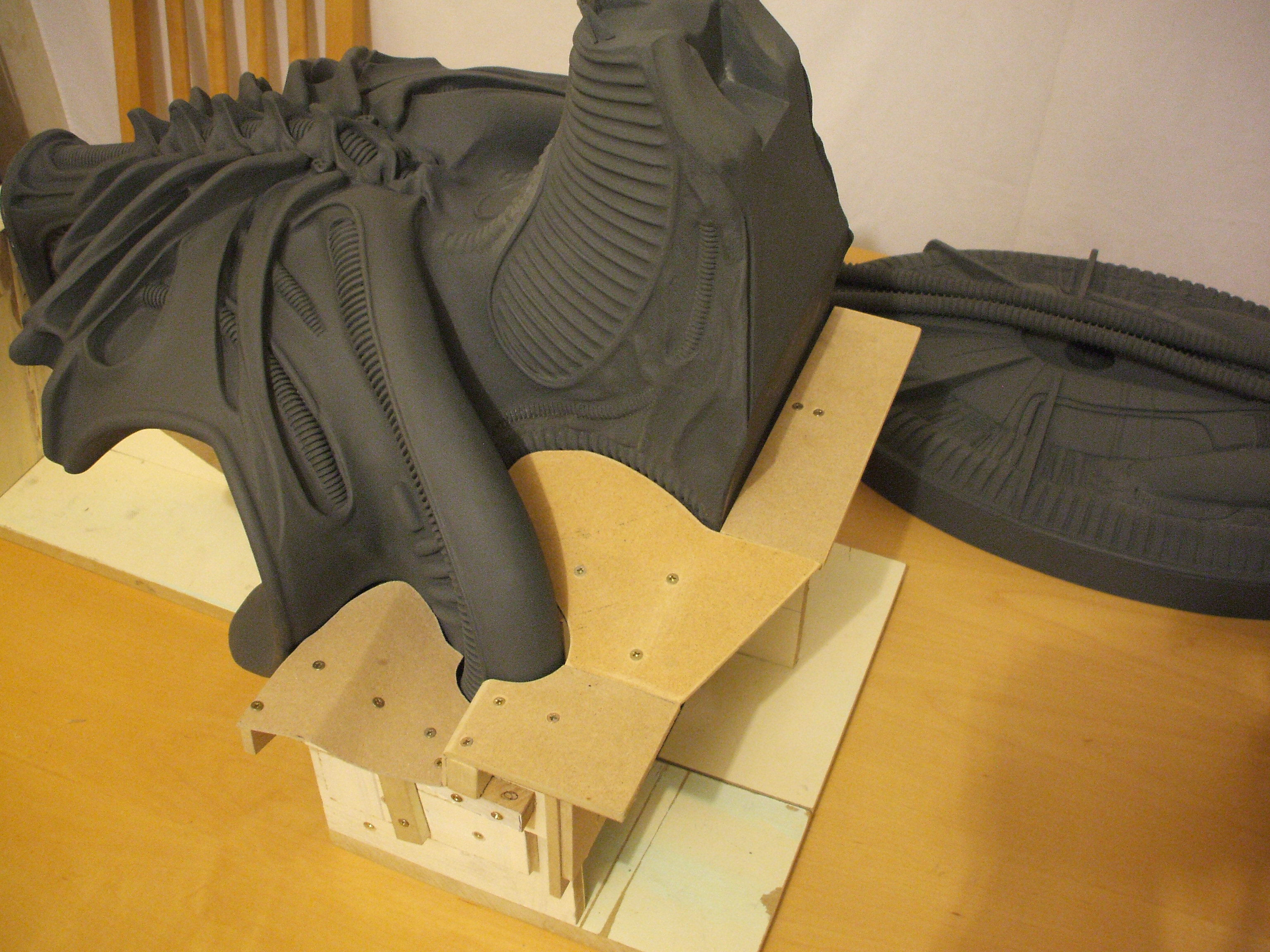

Here's where I'm going with the supporting structure for the partition, it's quite sturdy & all slot's together. Over this I can build the partition out of what ever is suitable adding key's etc :)
If you can see me going wrong here or forgetting something important please say so :)

Even your support structure is a work of art and an engineering masterpiece ... and here I thought you were just an amazing sculpter :lol

That's just too cool workmanship for the preparation of molding the piece. WOW.
And once done, you can use that structure for a diorama or a bust support shape.
