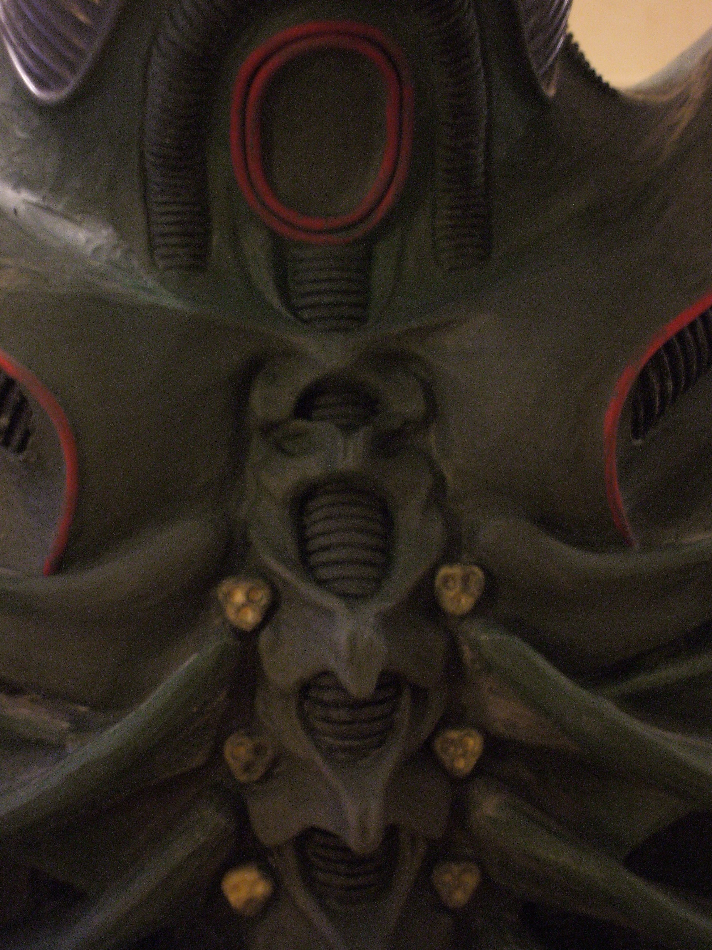

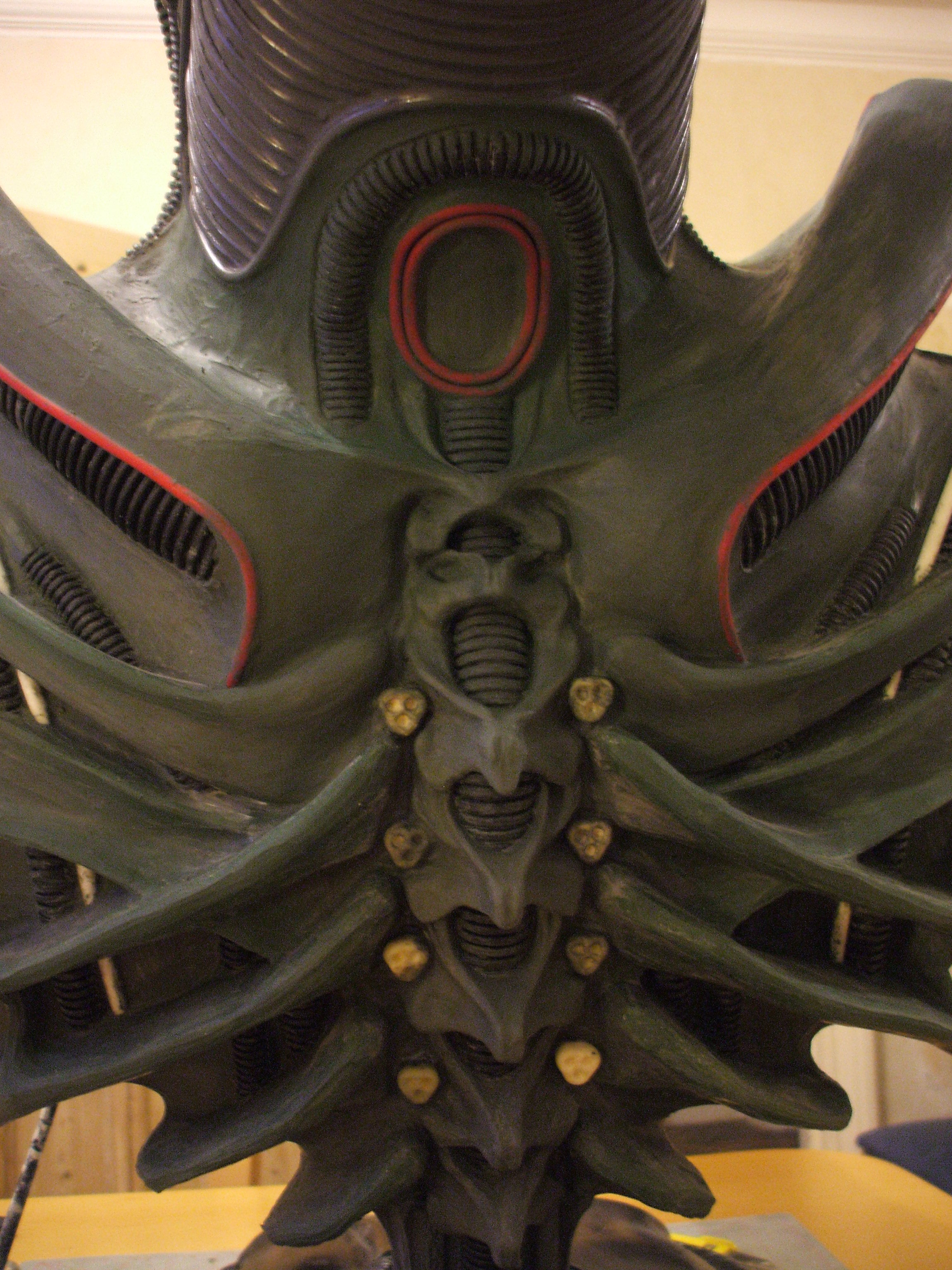

I've been busy here n there, I've changed a couple of bits & I need your opinion's if possible before I move on :)

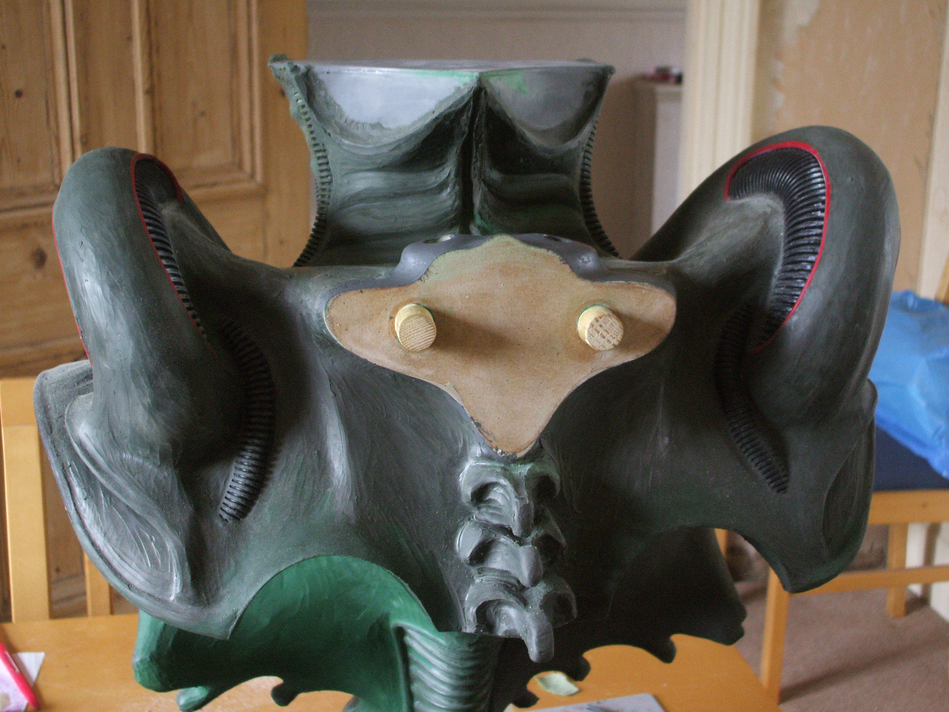

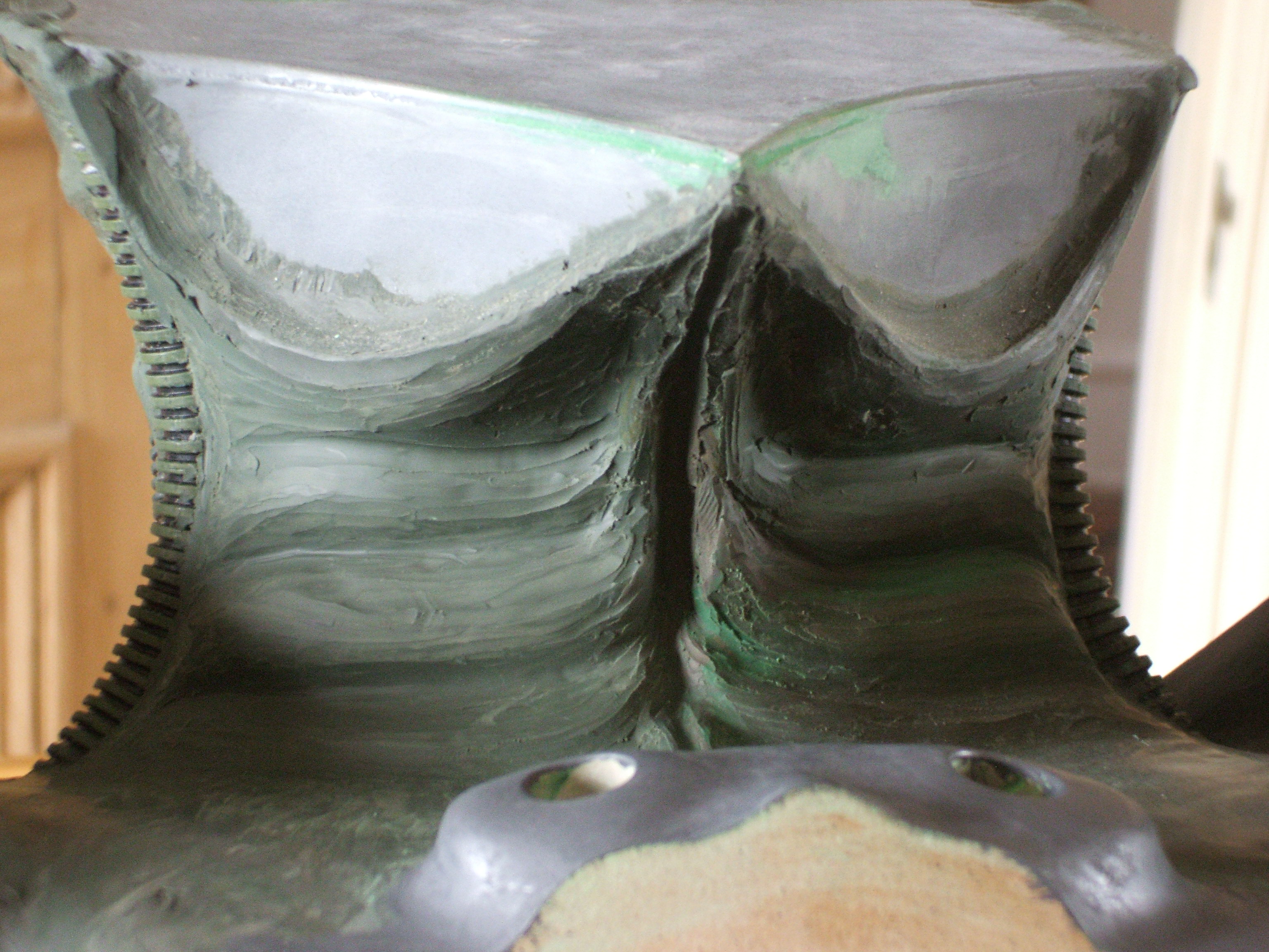

As I've dropped the height of the neck at the rear & to help the leaning forward pose I've added some wrinkles to his neck. I think they look OK but I'm not 100% sure on the shape of them :confused
What do you think:
I guess the bit I'm not too sure about would be the way the wrinkles turn downward at the ends near the tube?
& I've also remade his lower throat again to more resemble how Giger originally sculpted it rather than how it was towards the end of the film.
I would'nt mind your views on this aswell :)
Theres a couple of other MINOR :) mods I want to make & then I can start with the smoothing & texturing etc :)
Thanks again :)
Thanks Too Much Garlic :)

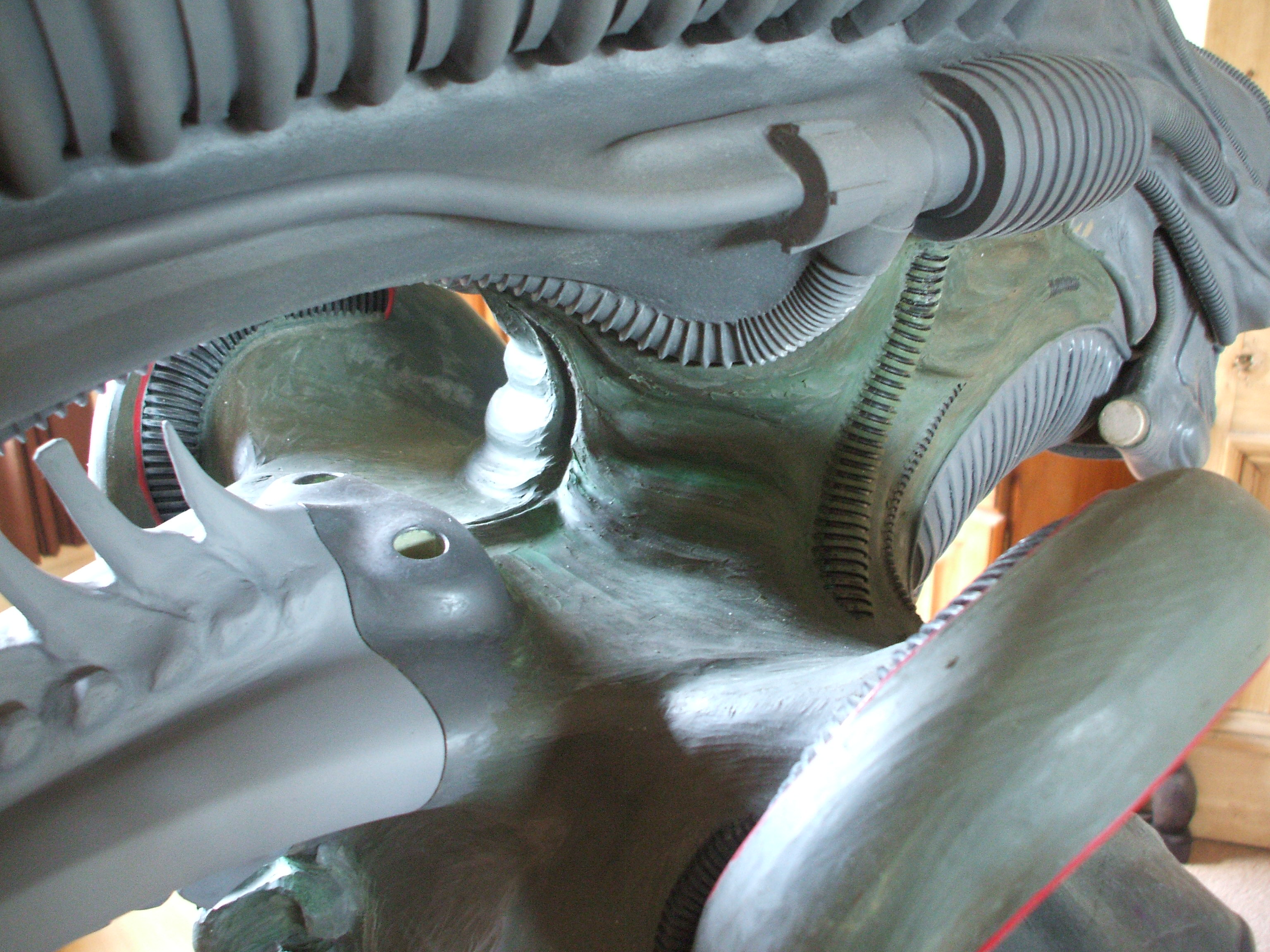

I thought I'd better post a couple more pics from a different angle before I commit to any changes :)

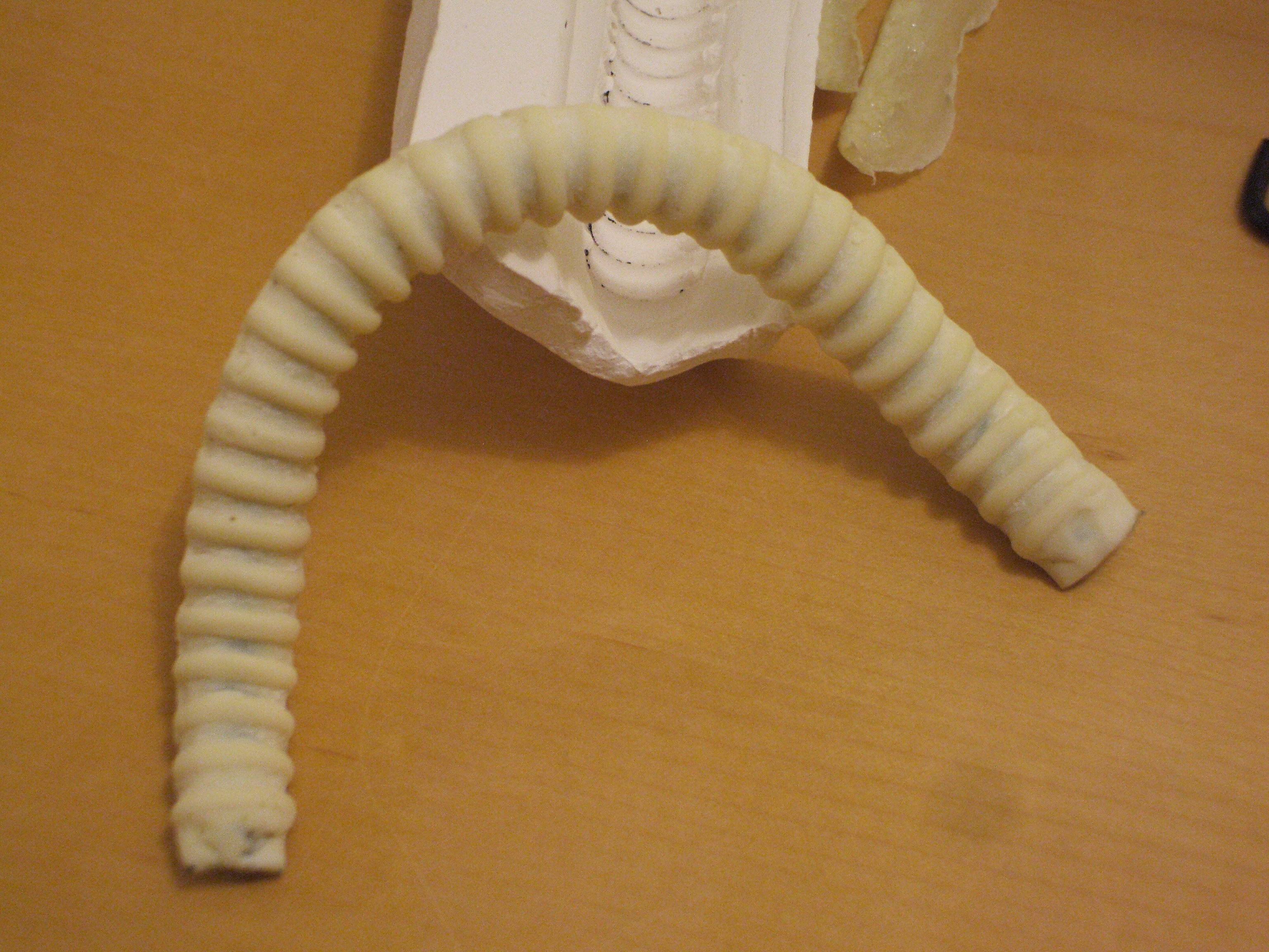

Ok, I'm quite pleased with myself today :D

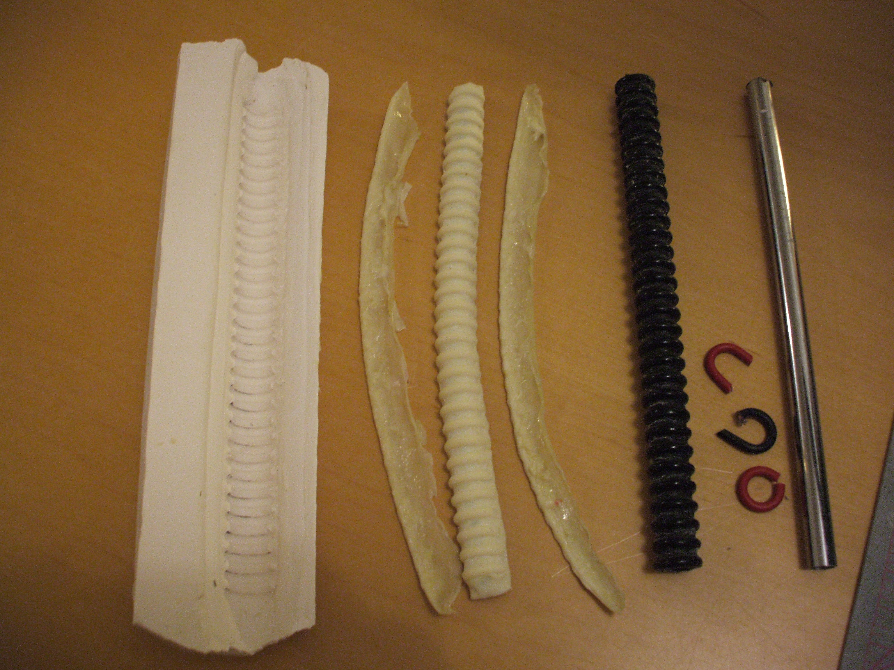

I wasn't happy with the horse shoe shaped pipe on his throat or the two pipes that run either side of his neck, they're not right.
So I set about making my own since I cant seem to find convoluted pipe with the right shaped ribs in the right sort of diameter.
I started with a chromed metal pipe (an offcut from an Ikea part :)), I then took some household electrical wire, cut it, shaped it & glued it in place.
A bit of air dry clay in the gaps & a coat of black paint to finish it off. I then made a plaster mould & cast it in Latex, I cast in some coaxial cable for support & I can pre-pose it a bit prior fitting :D
I'm pleased with the result :) it didn't take long & it should look alot more accurate :)

The only thing that bothers me is I'm pretty sure I read somewhere recently that silicone and latex do not get on (the latex prevents the silicone from curing I think). I just thought it might be an idea to check.
I'm in awe of your work Leigh, absolutely outstanding :eek
OOH good point! Thanks for pointing that out (y))
I had planned on painting it all with oil based paint prior to moulding in an effort to keep some consistency of finish.
Hopefully a couple of layers of acrylic over the Latex followed by a coat of oil based will isolate the Latex?? :confused
Opinions???
Yes, you are correct. You shouldn't even wear latex gloves when moulding in silicone.
