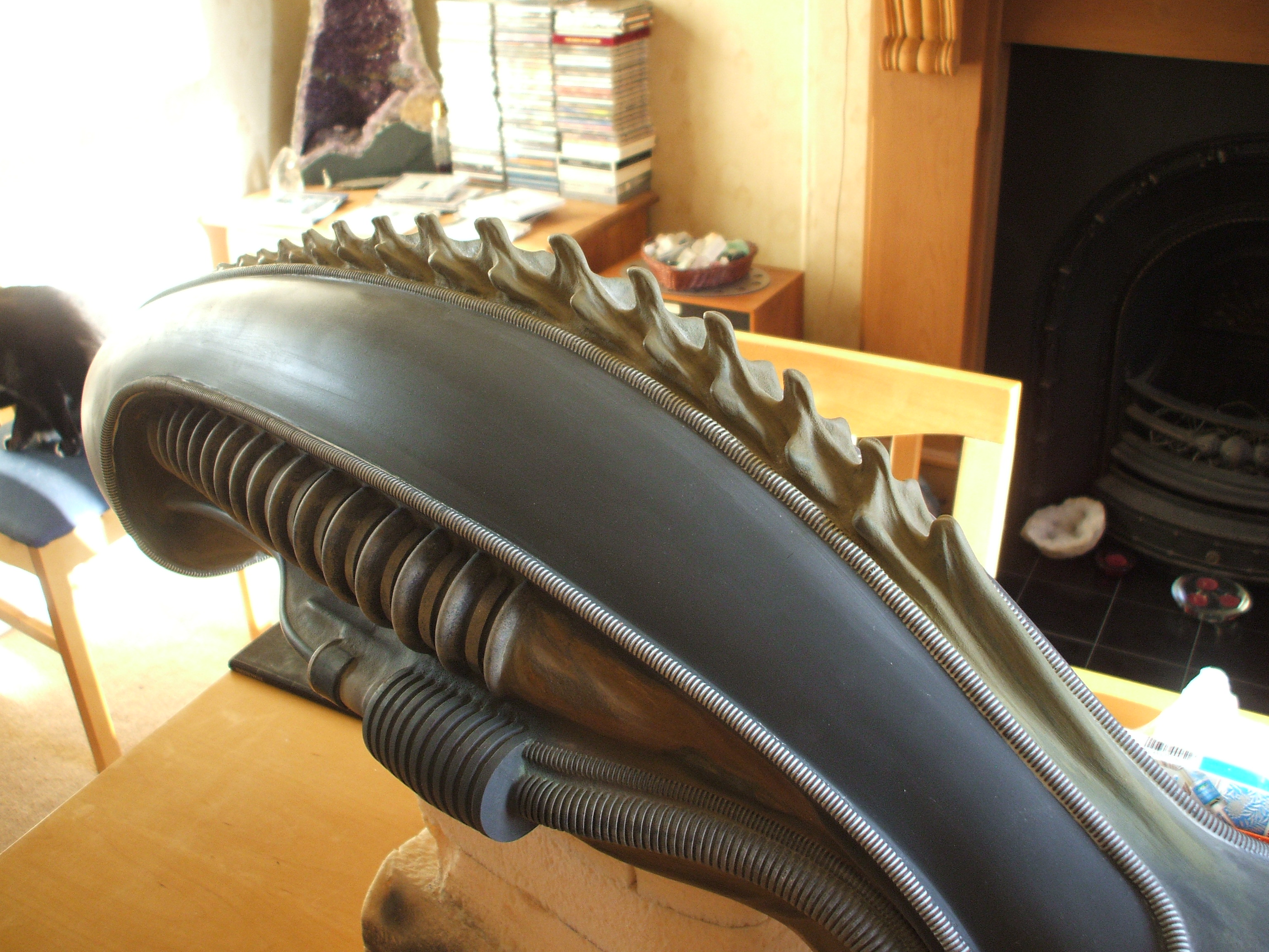

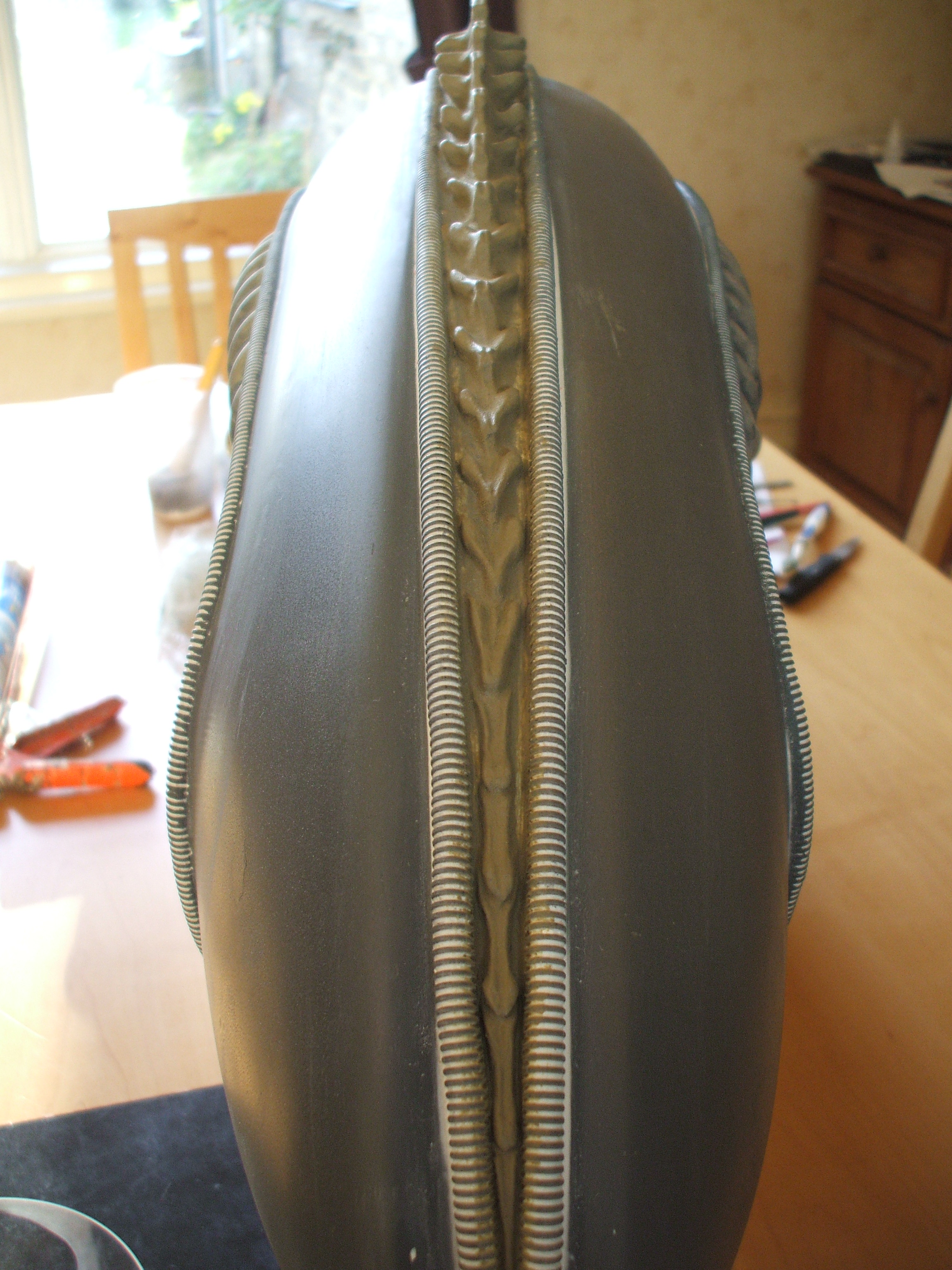

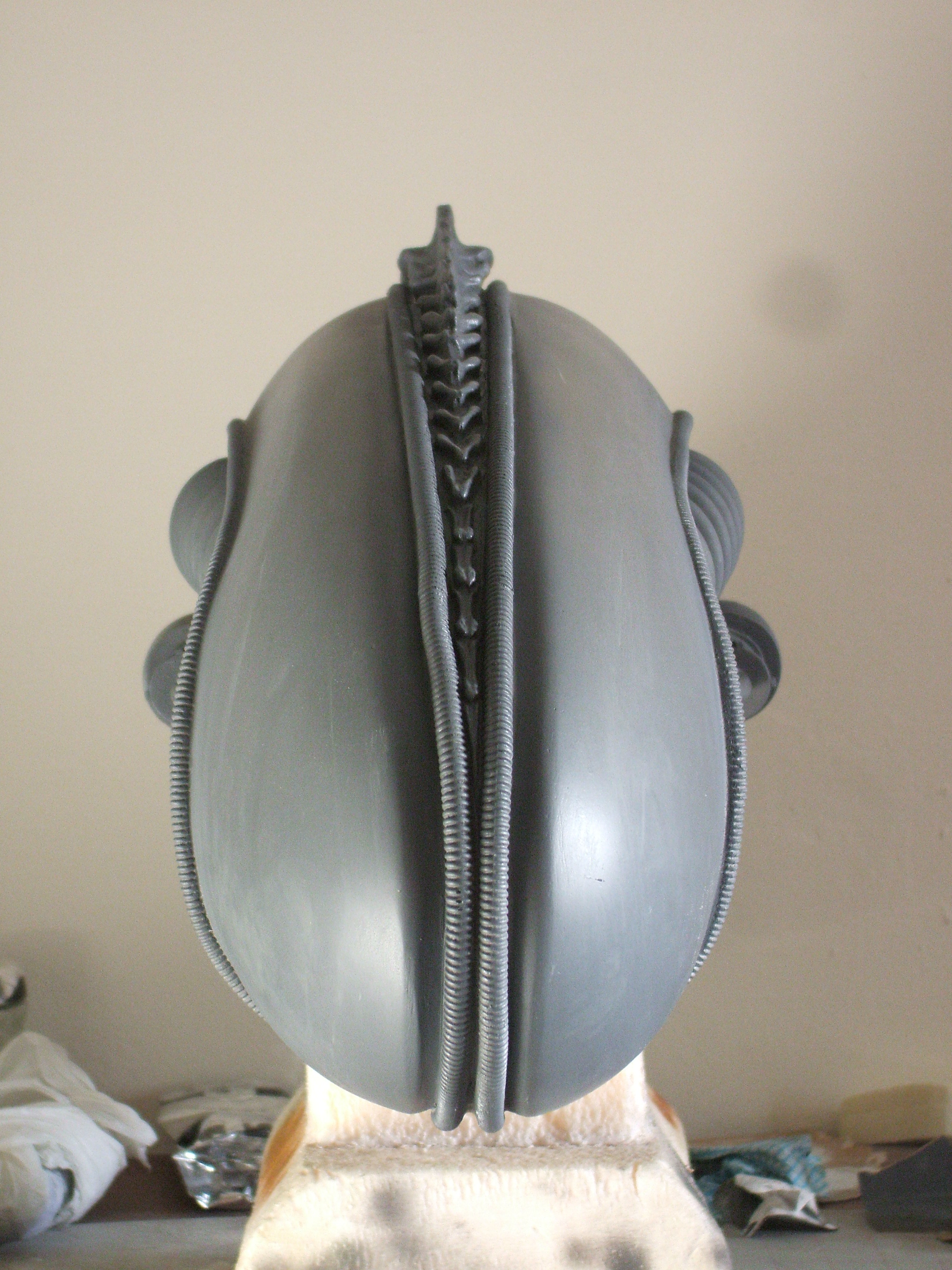

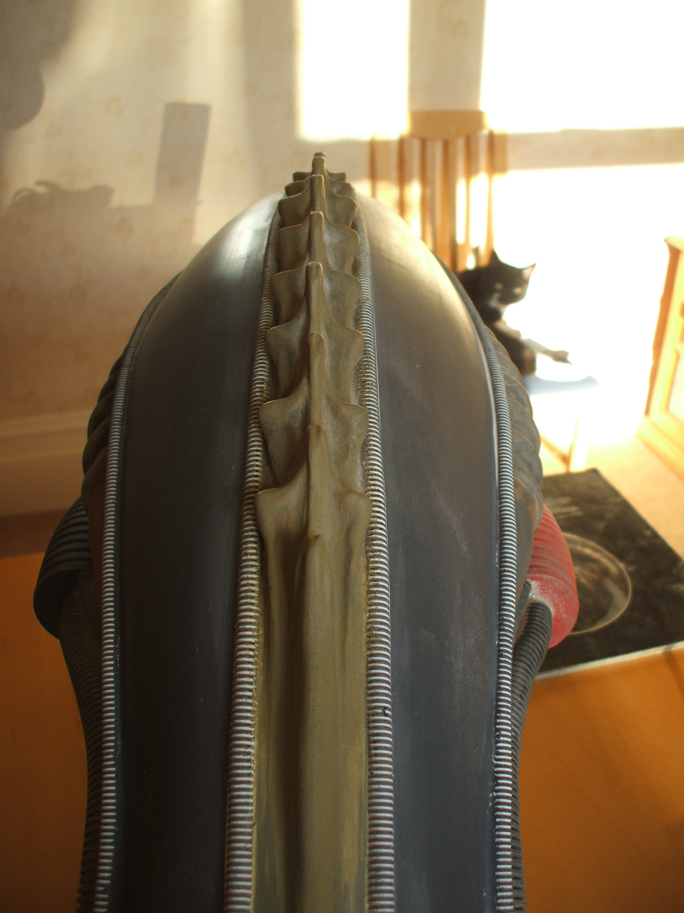

I've spent the last two days re-sculpting the spines. I had to bend them all up a bit to caulk the convoluted tubing & I wasn't happy with the shape of the side parts of the spines anyway. I also needed to extend them all the way to the back again after I removed them at the rear to re-shape the back of the head.
Heres the result:
I'm quite happy with them now :)
All I've got to do before moulding is a very light rub down on some of the hard area's & then one all over coat of paint :)

wow, Leigh those spines look perfect. I liked them before but you really nailed them this time around. :)
Thank you Dave :)

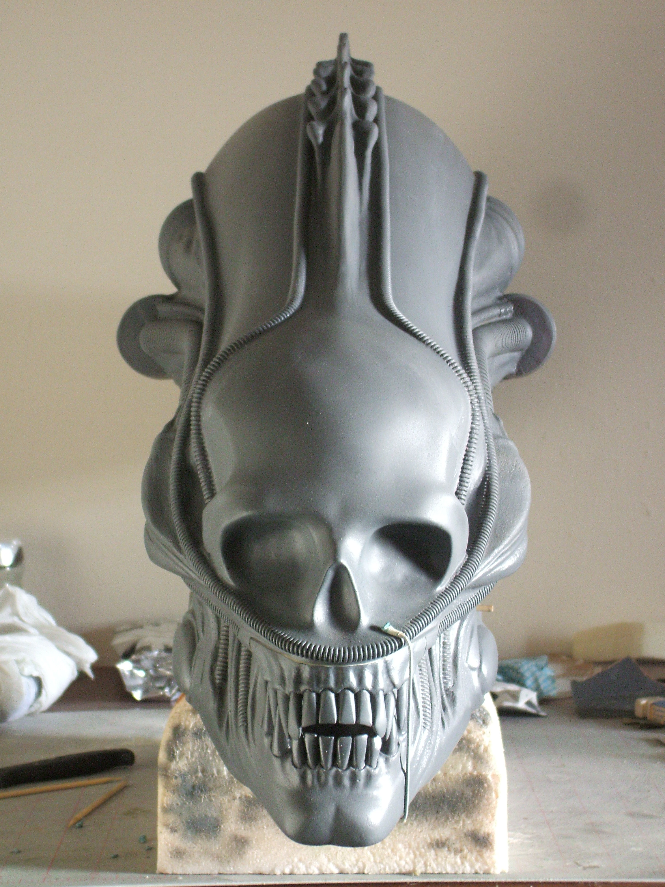

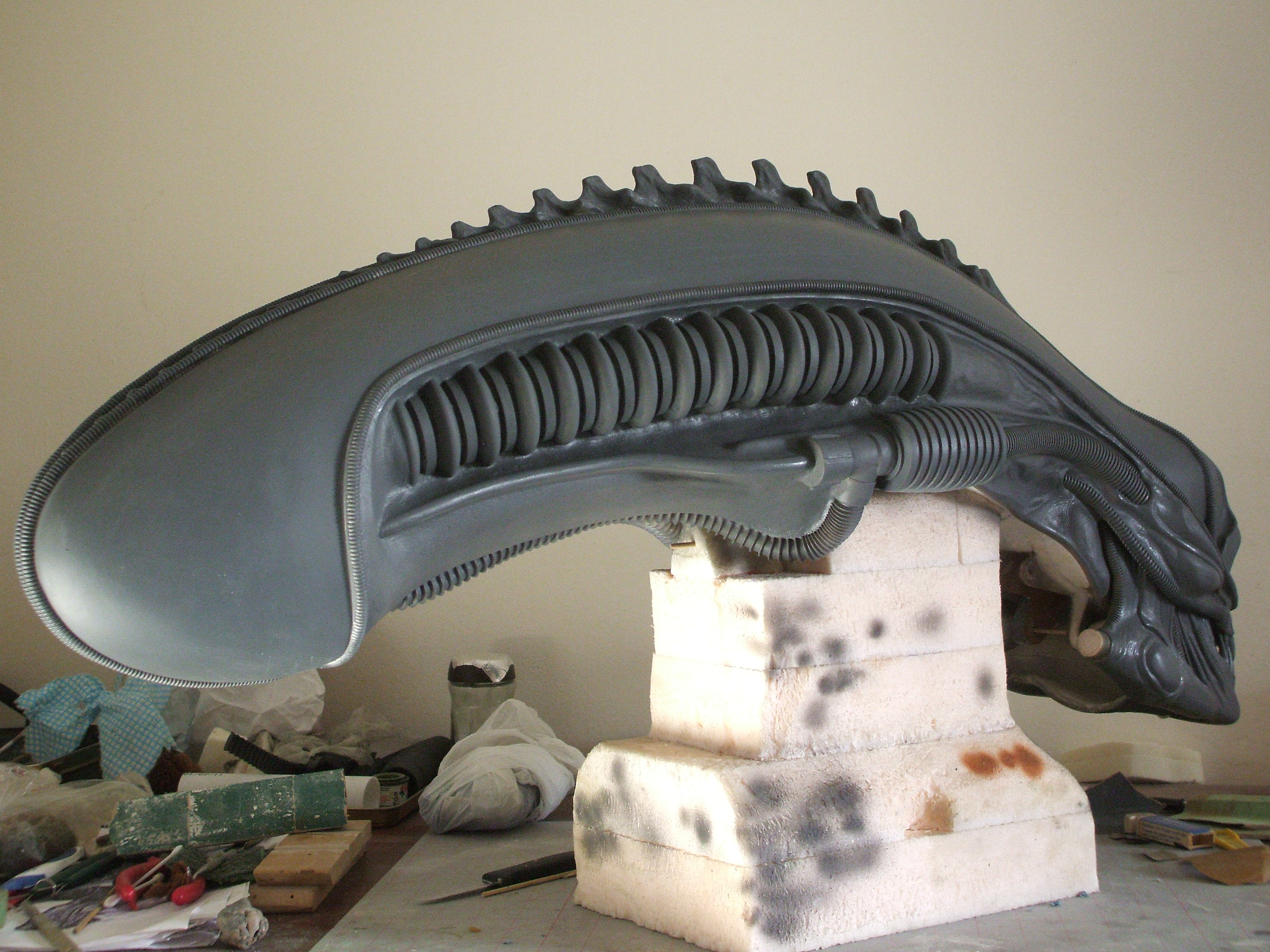

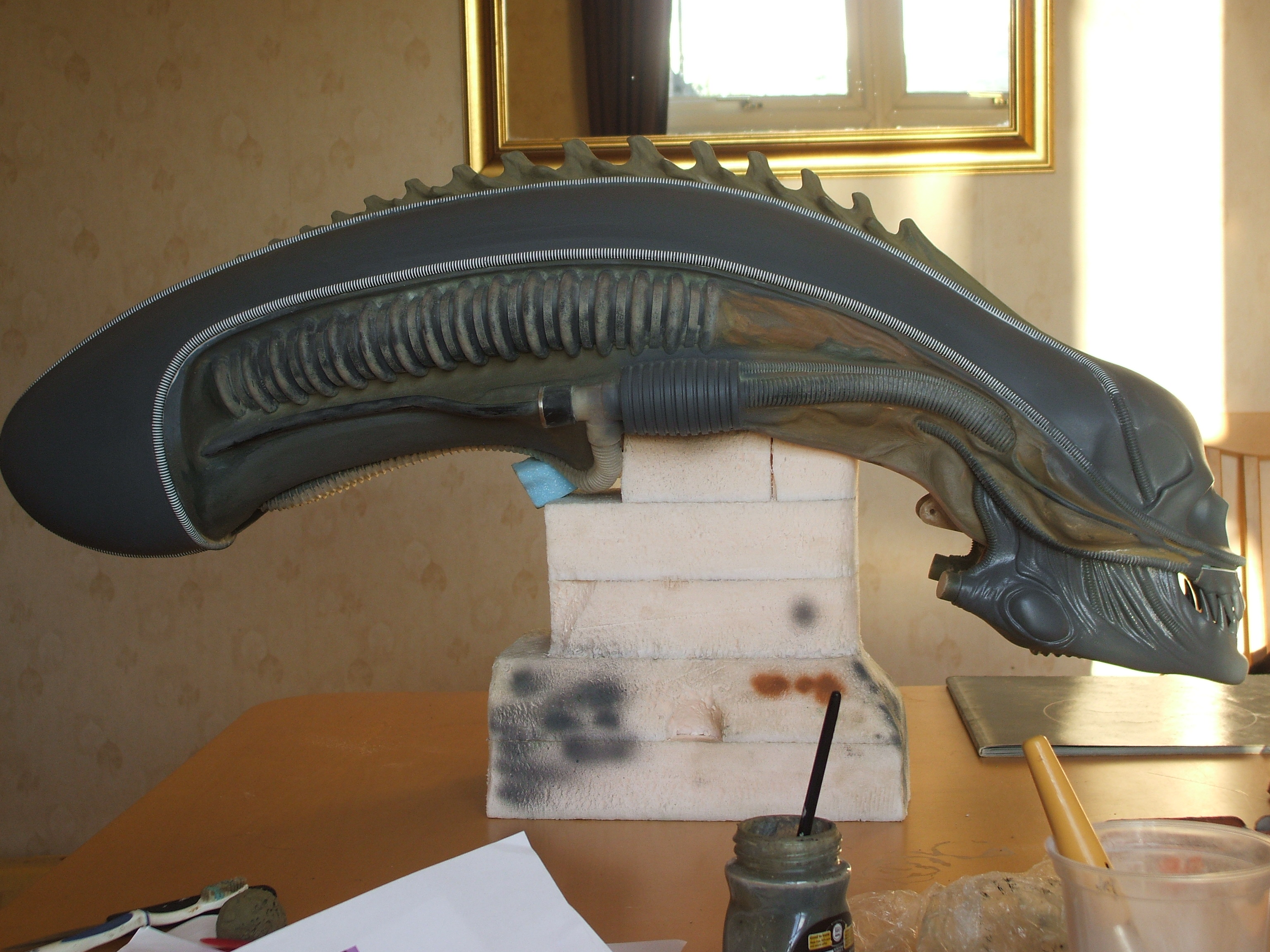

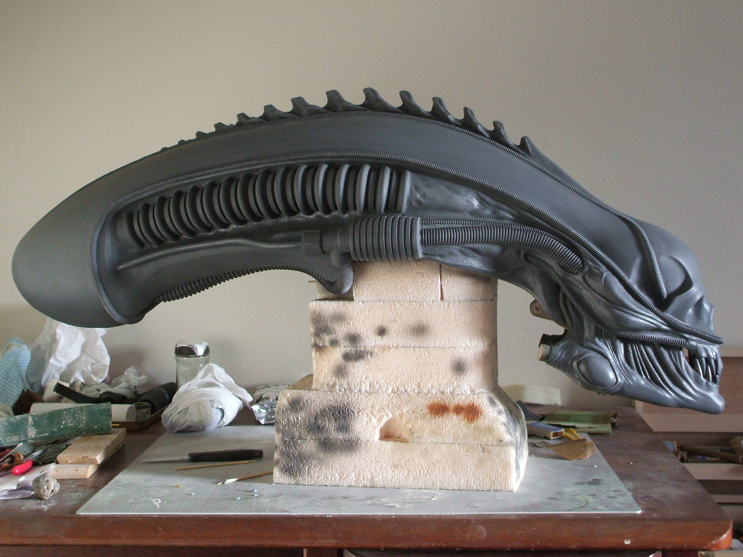

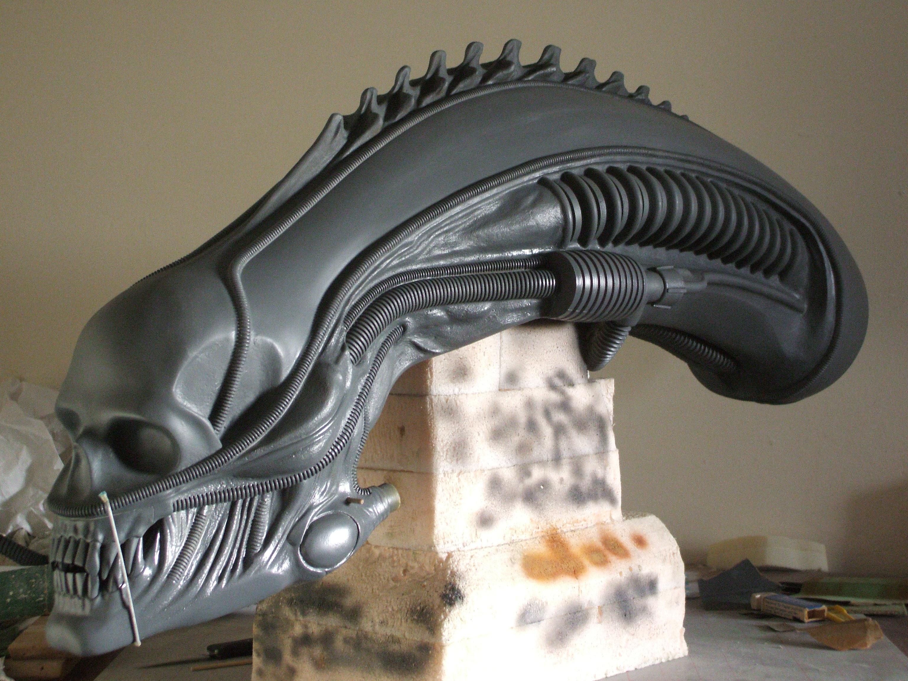

Well, he is now grey all over & I'm very happy with how he's come out :)
With a uniform colour & finish all over it's much easier to see all his features :)
Some pic's:

Just awesome leigh, so impressed with your skills.
Checking this thread for updates, and finding one, has become completely the highlight of my day. :D
Thank you guy's :)
