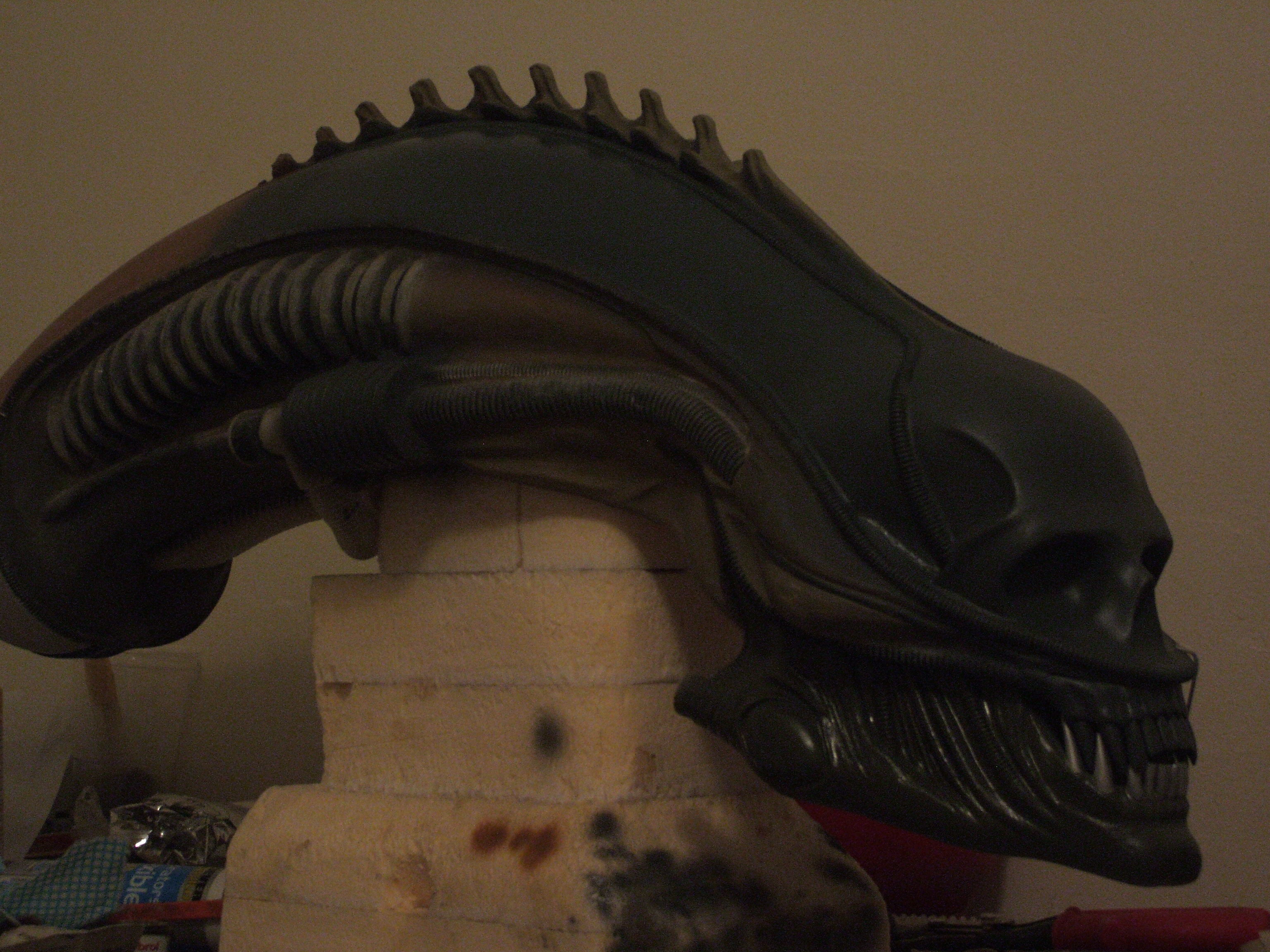

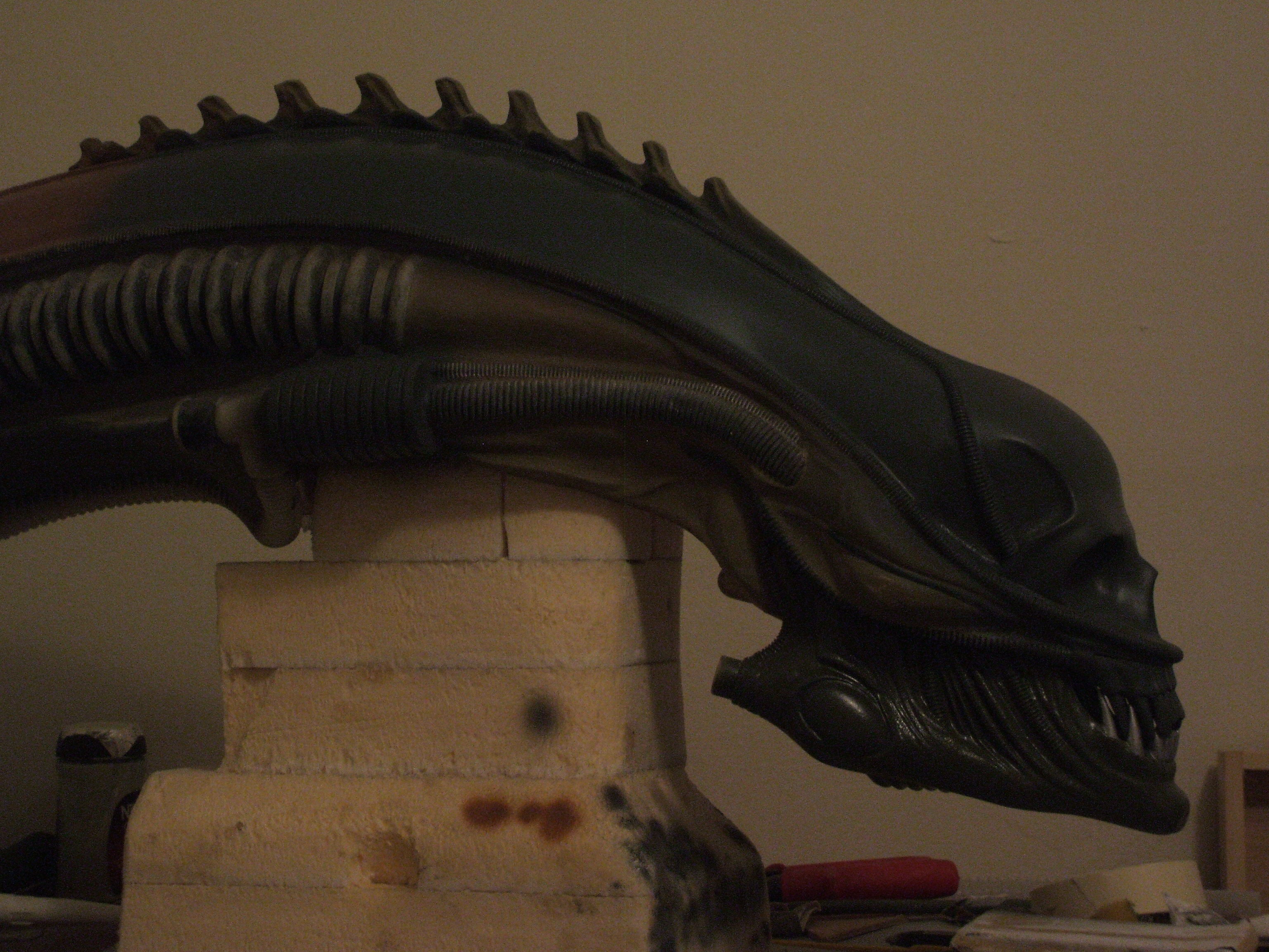

Another little update:
He now has a detachable upper gum & teeth :)

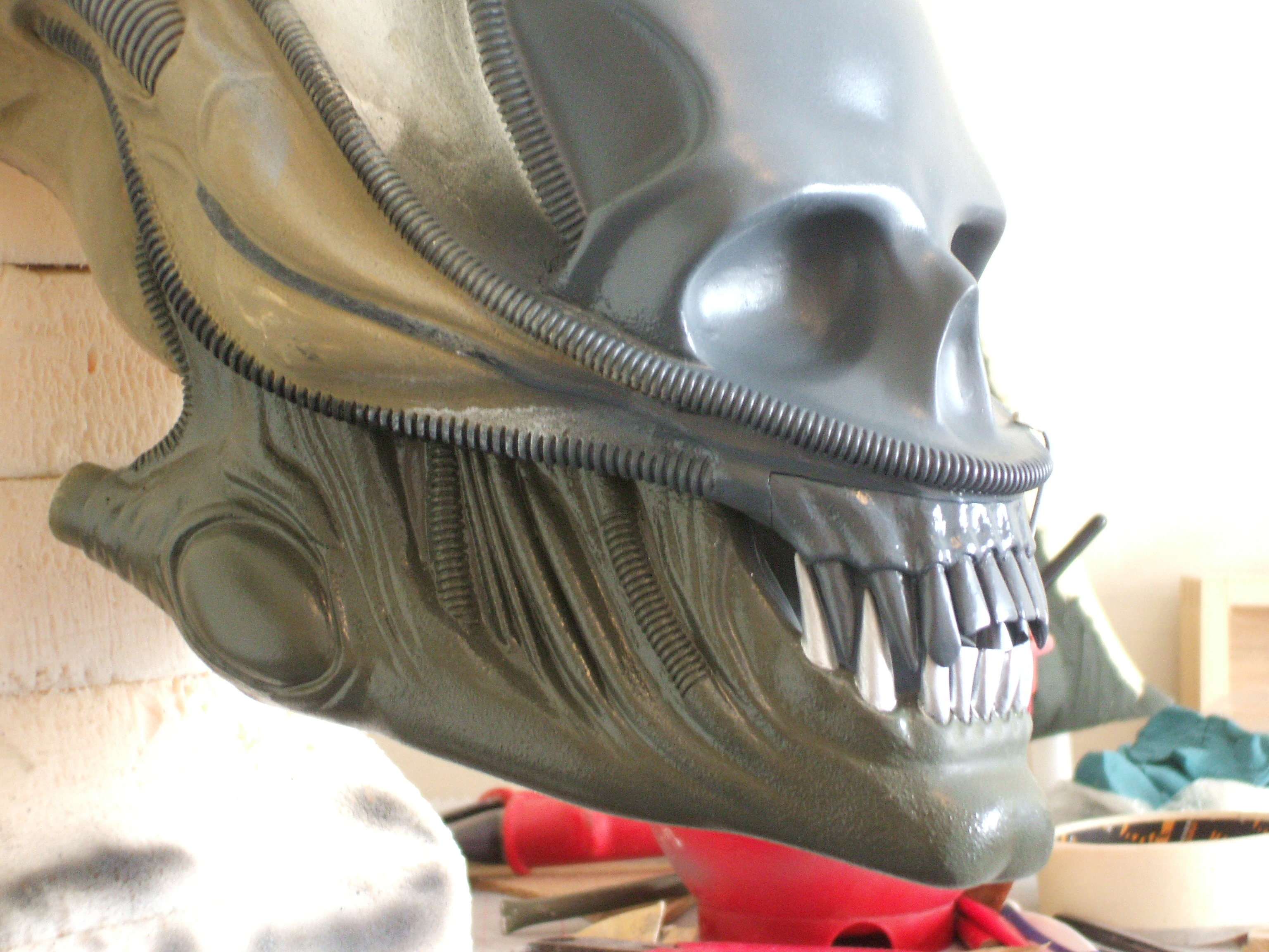

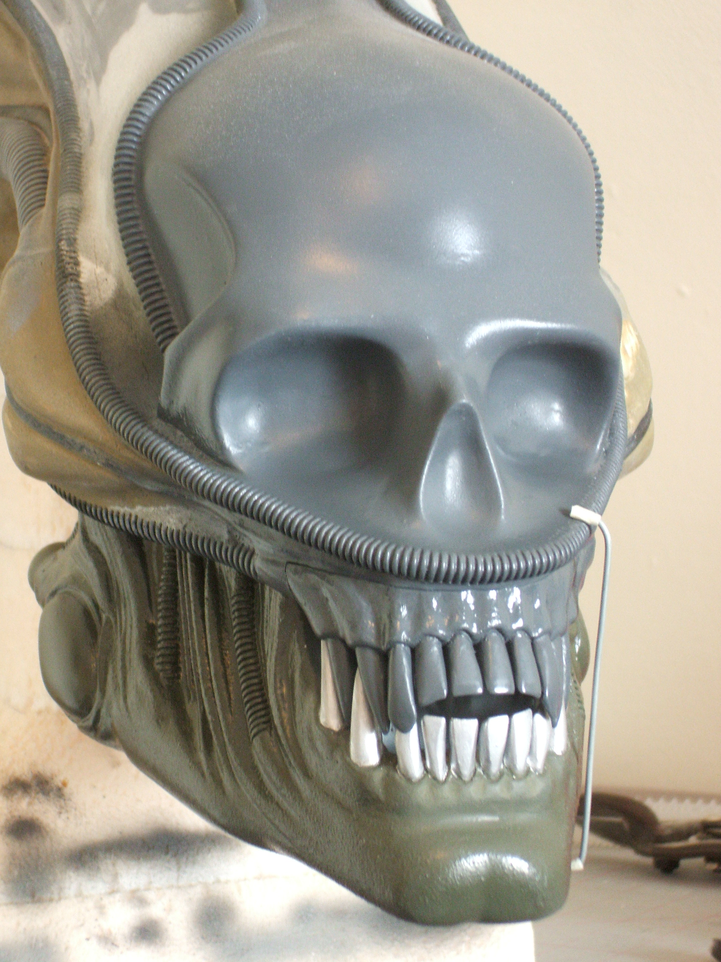

Some pic's:
I resulpted his front teeth & the gum, I'm much happier with them now :)
Every time you do this I think "wait, what? Surely that wasn't necessary!".
Then I think "but look how much better it looks!"

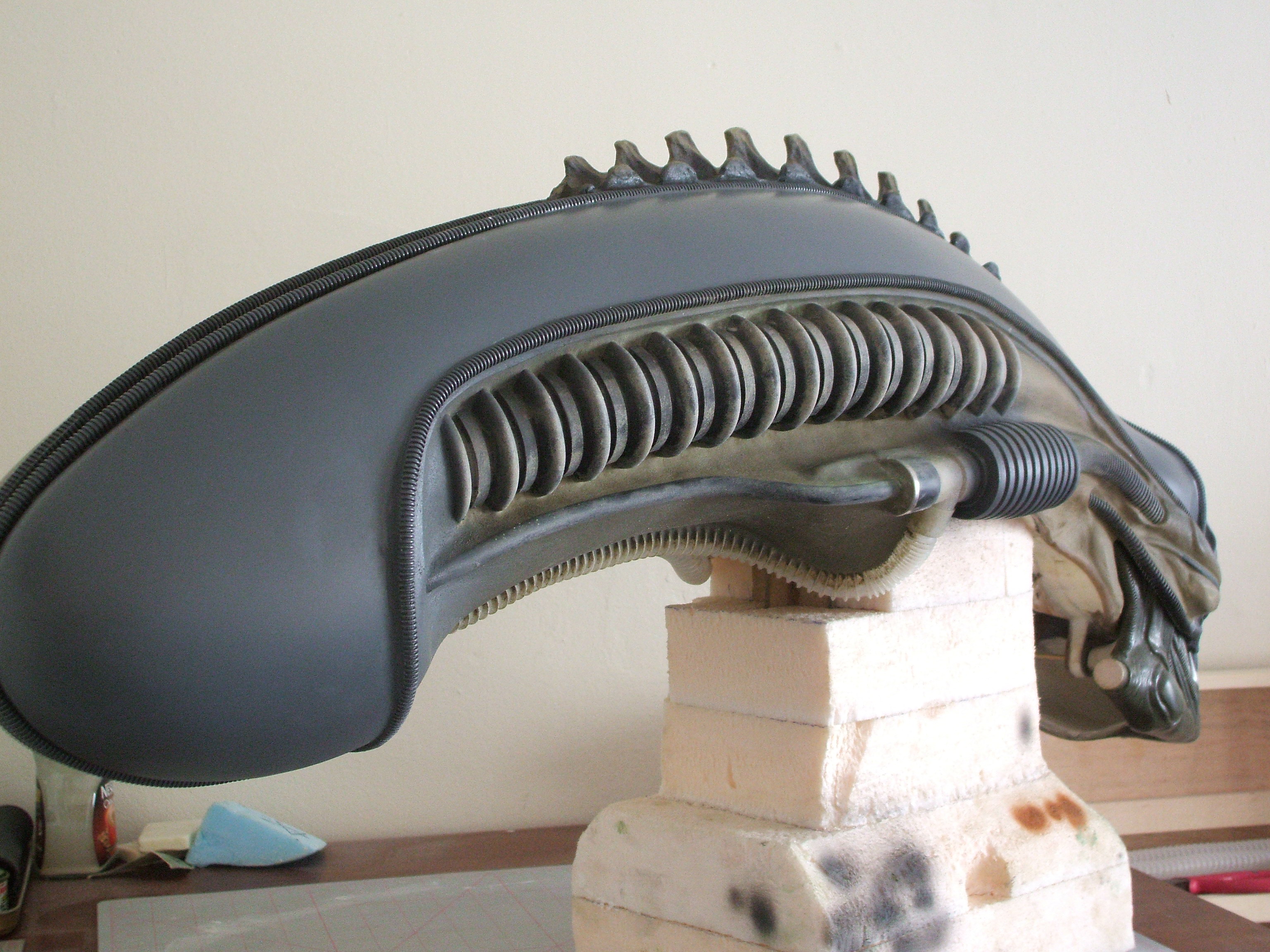

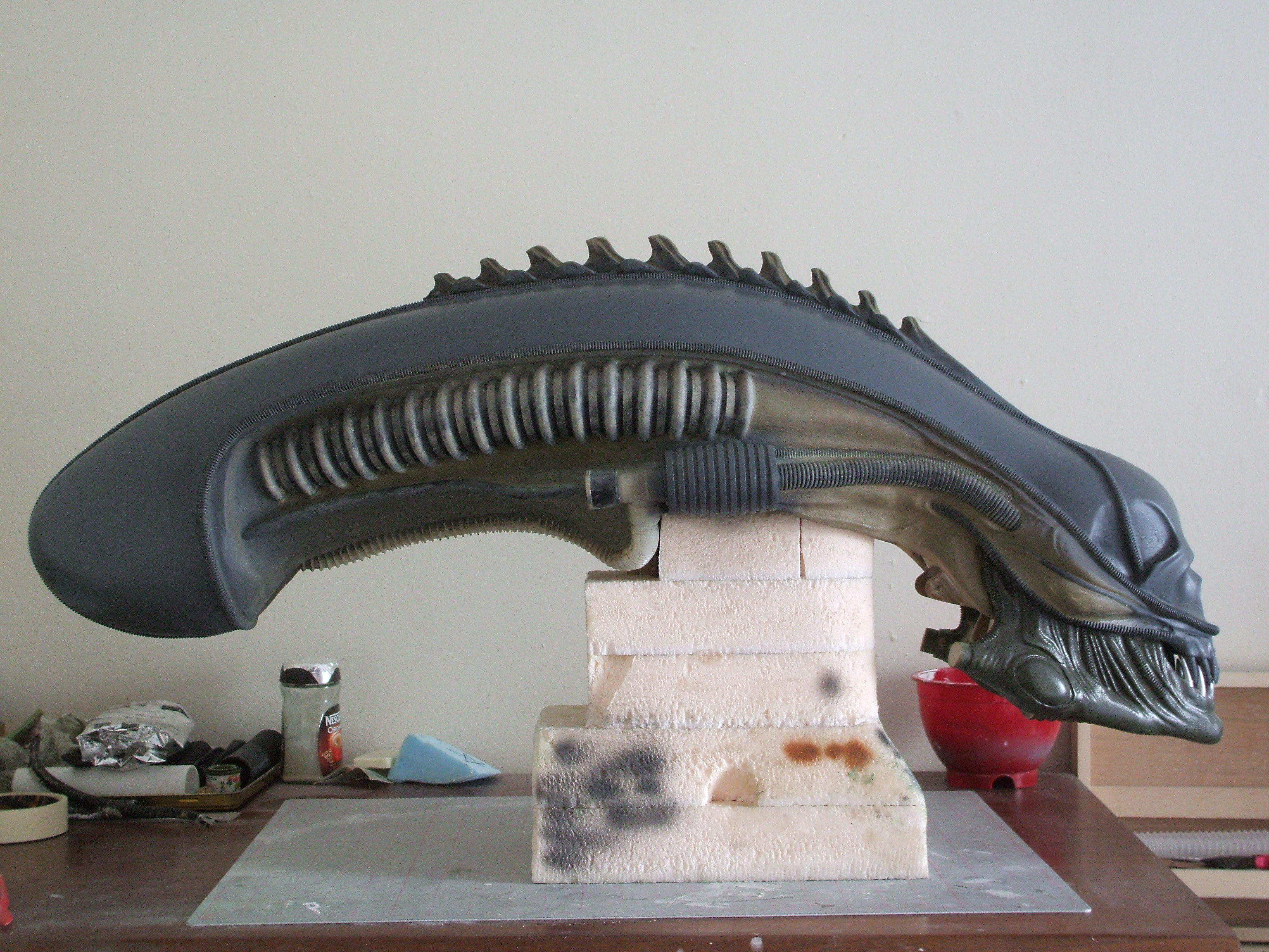

I'm still working on the hard bits of his head in an effort to get the head ready for moulding, Heres the latest:
Got one side of his head done :) When I've got the rest of the head to this stage I'll give it all (the hard area's) a light rub down & a final single coat of paint:
