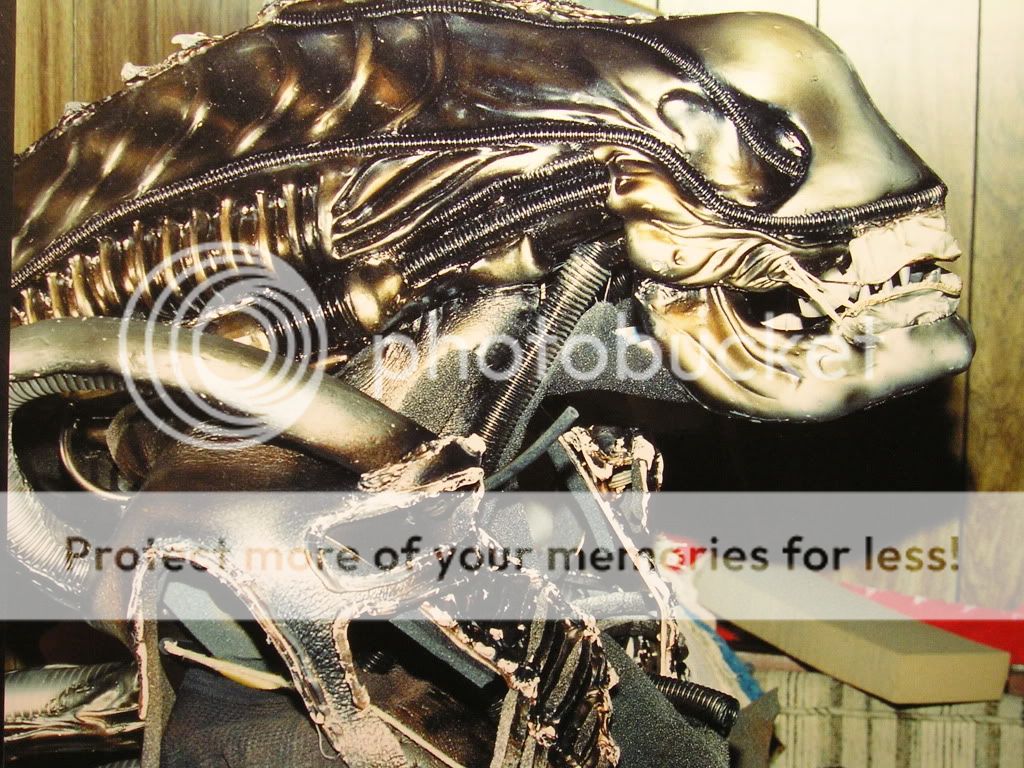

i started noticing some things in your version that didn't quite fit with what i remember, and i've been going back to check pictures and whatnot, and i'm finding inconsistencies in the actual costumes and heads, regarding those details. crazy, huh?
  1. someone already mentioned the fin -- they seemed to move it when convenient for the movement of the actor. it changes height rather drastically between photos.
  2. the sternum tube leading into the "adams apple" on your version seemed a bit too short. at first, i thought you'd added an extra vertbra to the sternum/spine. see, for instance this photo or this photo where the tube appears to go down much further uninterupted. it's a little hard to say, though, because there appears to be a vertebra on this which i believe to be the original model the costumes were cast from. fwiw, i like the vertebra there (but note that they flatten out near where the giant clavicles meet). it's on the spot where the neck piece joins the shoulder piece, and it seem to have been fudged a bit on the current state of the costume. it might been removed because it simply broke off due to frequent joining of that section.
  3. the jaw-tubes. note that in this famous still they don't even seem to be present at all, on this picture of the current status of the costume they attach to base of the skull behind the neck, and in most of your references, they seem to attach to the fin or the back. but that gives them too much support, i think. i'm really starting to believe they just kind of chucked them over the shoulders, or modified them based on the individual costume/head being used. check out this photo where they just dangle. the real costume is really kind of half-assed -- i meant it when i said yours looked way better.
  4. i knew there were several different versions of the head. the three articulated versions appears to have jaws that are bare-bones, tied together with springs and condoms, with barely anything solid where the cheeks would be on a human. see the above photo. the stunt head was solid cast. the other two "hero" heads seem to have solid cheeks, like yours (based on your reference photos). i assume you went the way you did to maintain accuracy and not have it look like ass. though there is potential for a good look there. the alien 3 design used the hollow cheeks thing quite effectively in my opinion, though the subsequent films did not. it was just strange to see in the first alien. (speaking of which, how do you plan on making the lips/tendons/etc?)
this stuff is all strange to notice. it's not quite as jarring as the "millennium falcon's insides don't match its outsides" problem. but it's definitely weird stuff you never notice watching the film.
i think you're doing a very good job of splitting the difference between the costumes, and taking some artistic license where necessary. it'll never quite match up, because the damned production still don't even match each other.
Thank you for that post. I knew there was something bugging me about the jaws. I've always drawn the jaw as being very open on the sides with just the tendons stretched across the spaces. However, we have Leigh's accurate sculpt that has the jaw mainly filled in. I have been wondering what it will look like with condoms stretched across the 'solid' jaws...
Hollow jaws?
During my research into this I spent alot of time reading articles online & in books, I've gathered lots of reference images etc. When going through the articles that people have writen I've tried to only keep & use the info that seems to be constant throughout all the different articles, whether they've been writen by Giger him self or just a knowledgeable fan.
The way I understand it there were a few heads made, 6 in total I believe & all were based on Giger's original sculpt. In the book Gigers Alien he suggests that one of the castings of the original sculpt was sent to Rambaldi to be mechanised, Rambaldi then set about recasting the head, chopping lots off of it & reinforcing it in various area's. If you look at the pic's of Rambaldi working on the head you can see the head looks nothing like the original. In an effort to bring the head back to how it was originaly sculpted, latex rubber castings were made & glued onto Rambaldi's modified, mechanised head. As a result the rubber peices didnt fit quite like the original & there are many differences in these two versions. Some of the more obviouse differences are the eye sockets, the cheeks & the jaw sides. The lip & tendon arrangements are completely different aswell & that seems to be due to the mechanisation of the Rambaldi head. I guess Rambaldi felt he couldn't get the mechanisms he intended to create to work with solid jaw sides at the time.
With regard to the tubes comming off the rear corners of the bottom jaw I used the HGC & Sano sculpts as reference to where they actually stop. From what I've found, it would seem the Sano bust is actually wrong in this area & the HGC version is accurate. My findings are based on trying to follow where the tubes end by closely scrutinising other original images & that HGC claim that their suit is taken from original moulds which I believe, though I dont feel that way about their head.
It would seem the tubes were permanently fitted to the jaw & slotted into the suit making it easy to remove the head.
All these differences in the original mean making a bust that can be displyed & scrutinised closely is a difficult task. What I'm aiming to achieve is a bust that captures the essence & overall look of the creature from the first film by trying to incorporate all of the distinguishing features, in the process I'm left having to use a little artistic licence. Unfortunatly I can only capture the features as I see them, others may pick up on different features as more prominent.
