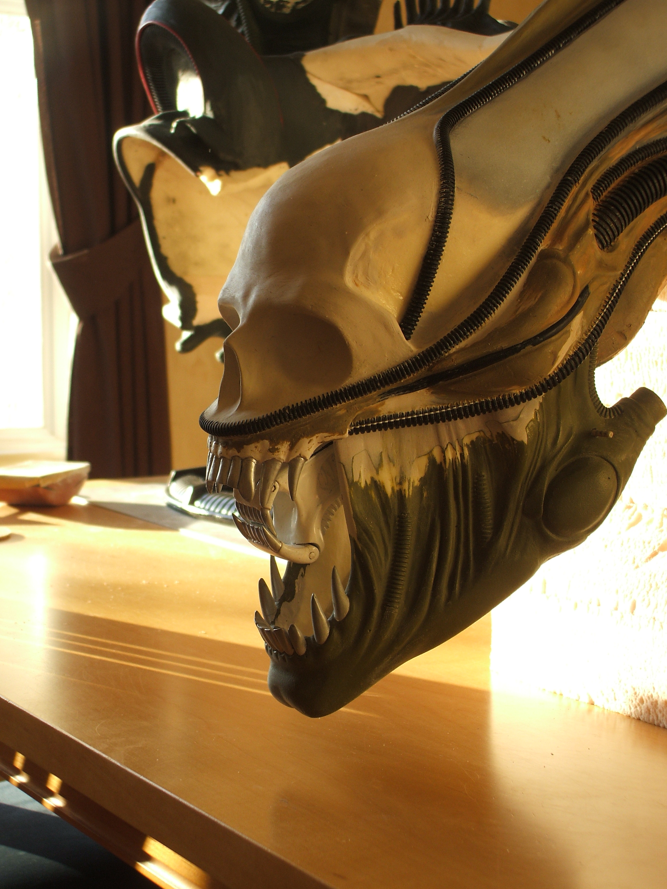

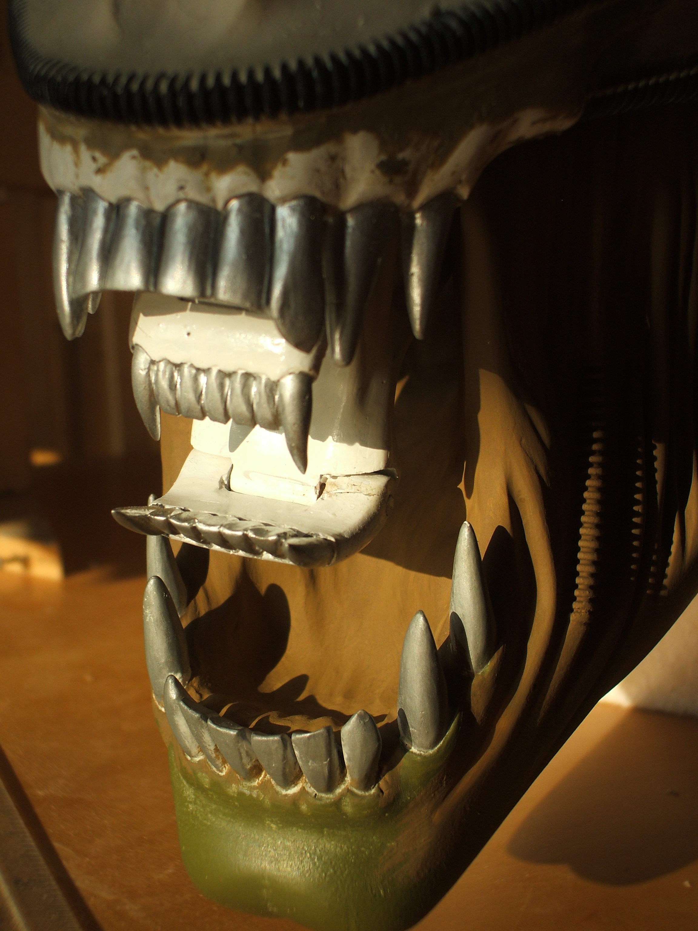

I've been busy on Bob today,
I made a sturdy stand for his head out of foam & I wasnt entirely happy with how far the jaw opened.
It didn't seem aggressive enough for my liking :D
I had to cut away a fair bit from the underside of the head to allow the extra on the jaw to fit without fouling anything & I've reinforced the hinges.
I've done it so that the jaw closes & stops just before the teeth touch & it'll only open this far but I think its enough :)

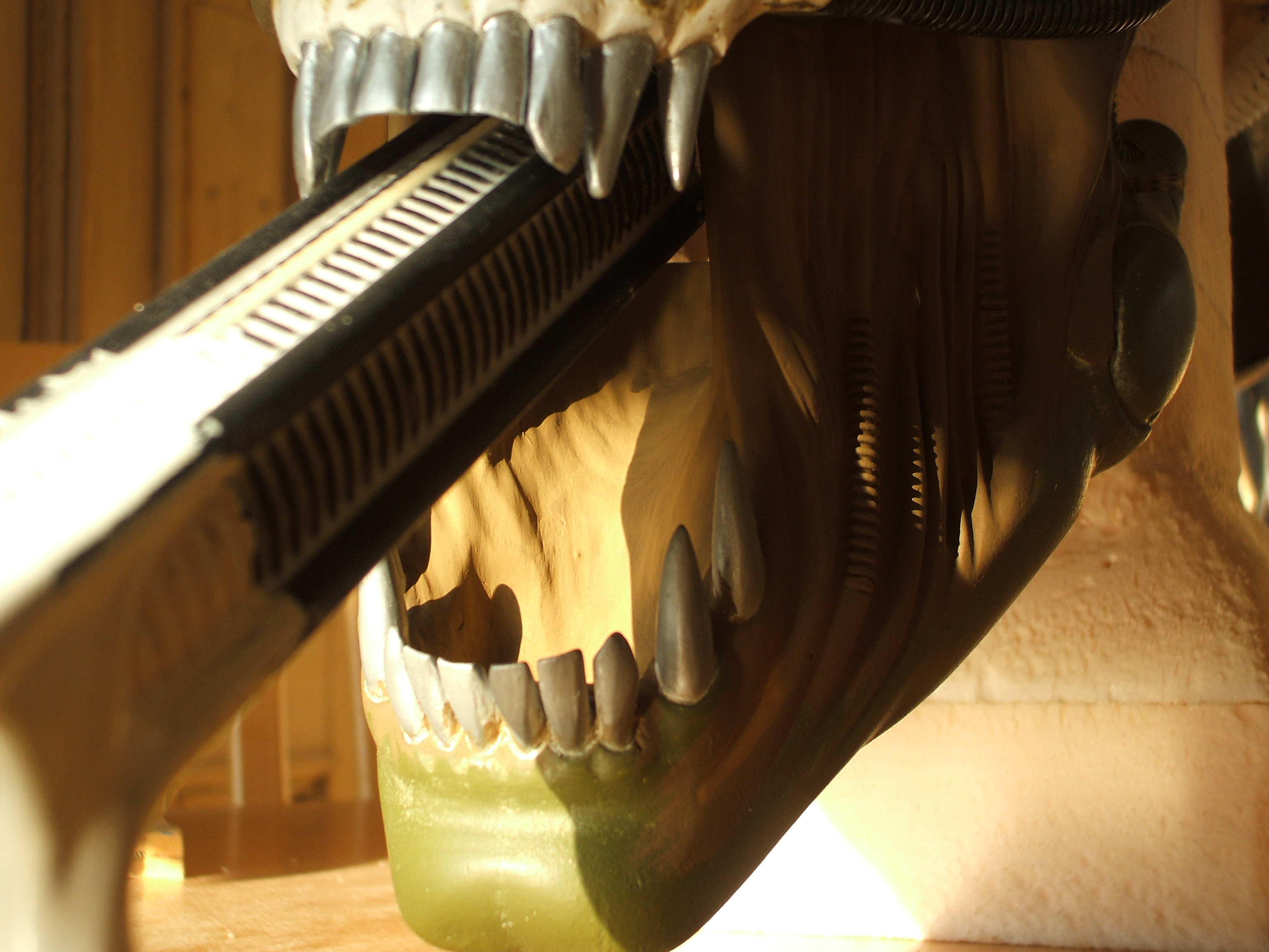

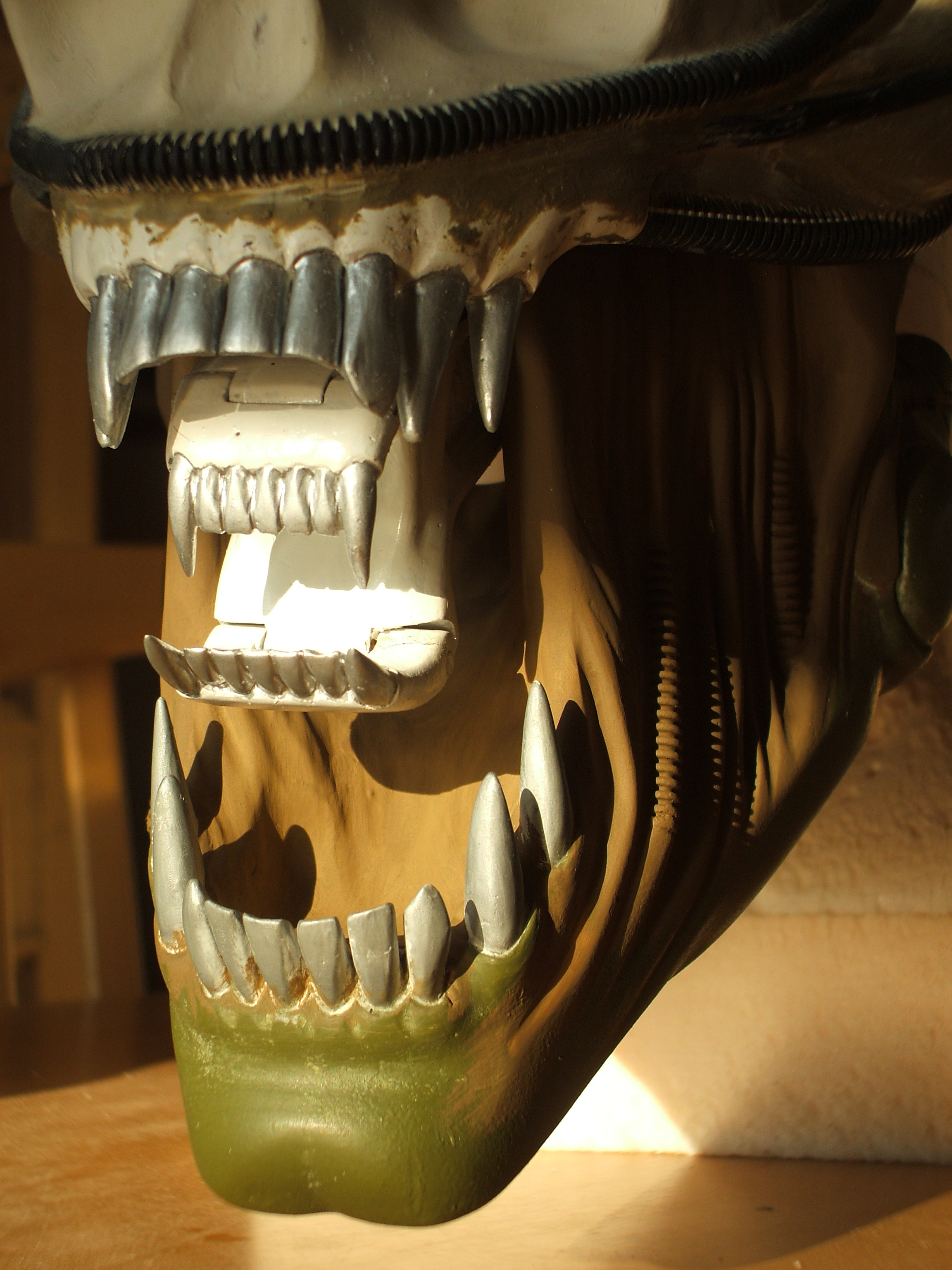

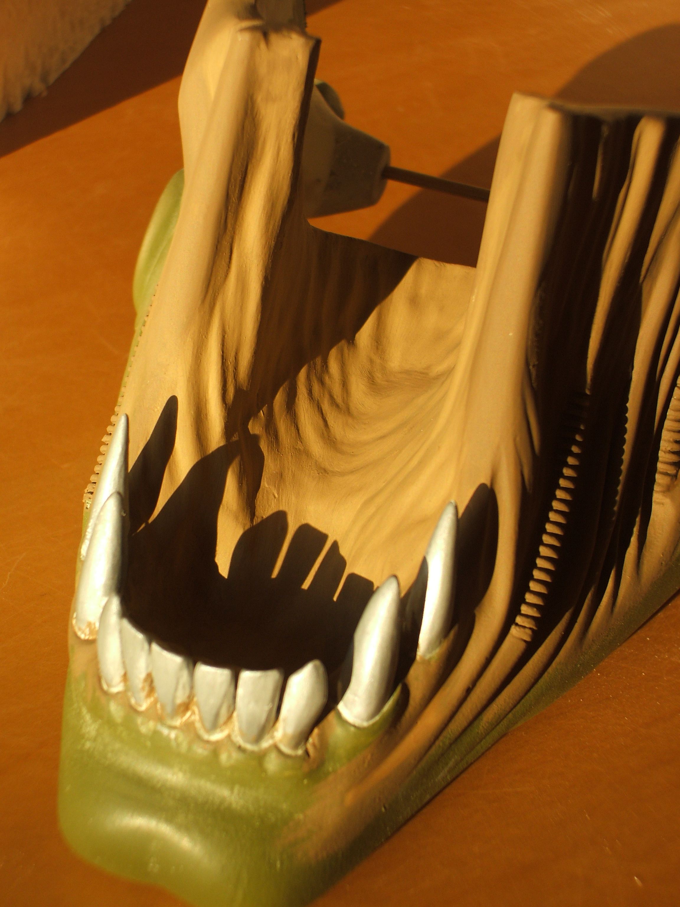

He now has an inside to his mouth.
I thought I'd better do it as I made his jaw open further & you can see right in there:
Edit:
Heres a couple of better pic's:

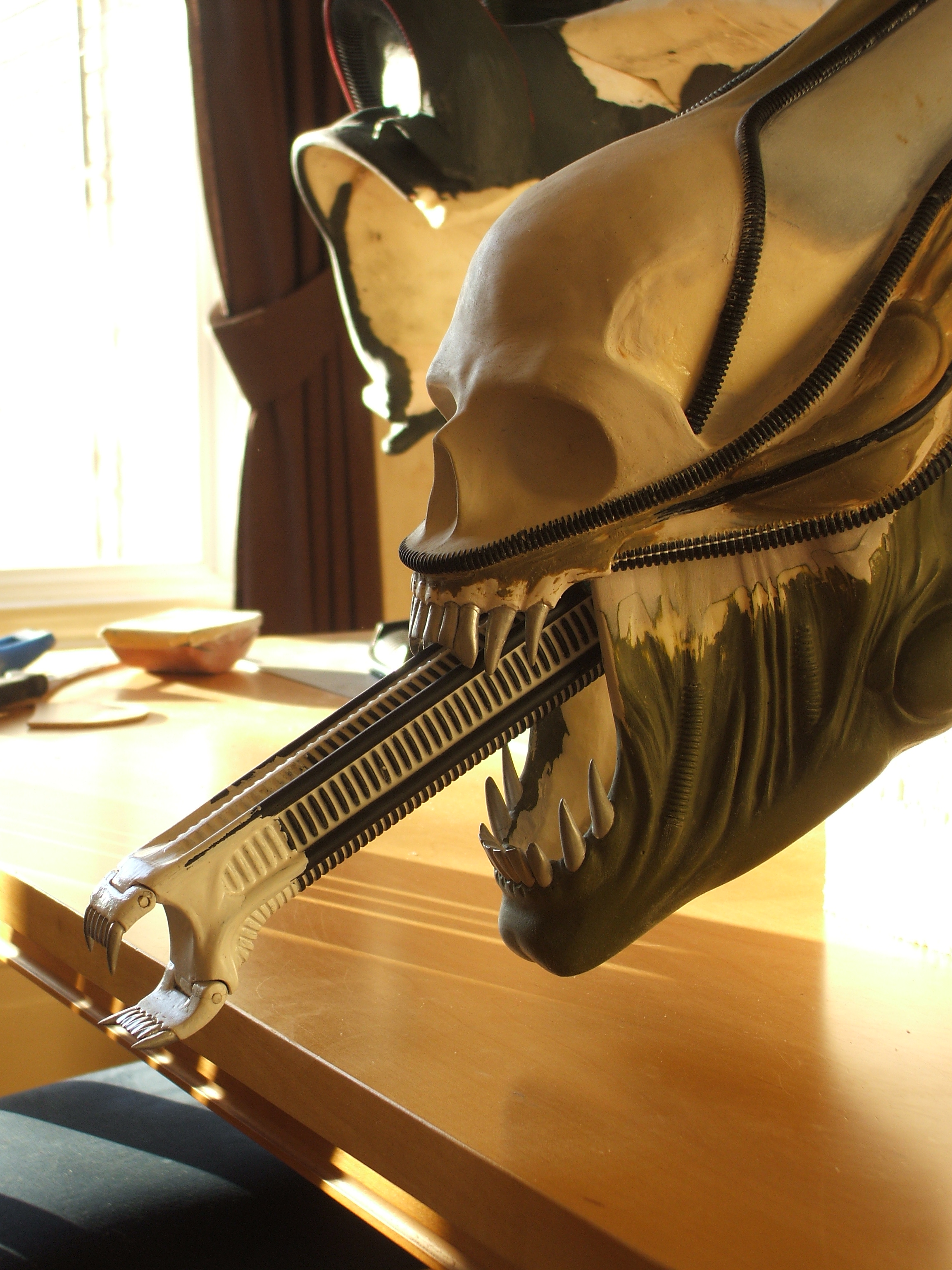

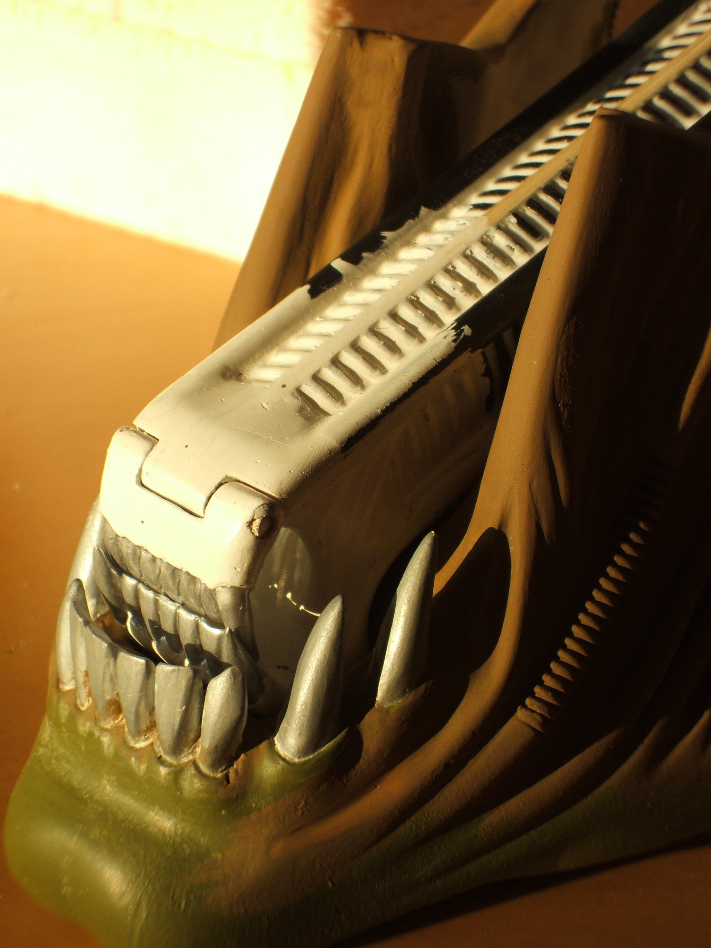

& the tongue fits in there like a glove :)
Very nice indeed! I guess there will be no way to hide the seam/hinge on the inner tongue.
Here's a thought. Ever considered making the teeth separate like dentures? That way they could be chromed and then inserted.
With the tongue, I'm planning on using clay to cover the hinge seams for the main mould then cast a rubber skin. Then remove about 1mm all over the tonge & make another mould with the separate hinged peices to make the plastic body & slip the rubber skin over the top & glue in place with the plastic teeth poking through. I hope that makes sense :lol
Well, that is an ingenious way to fix that problem! It's essentially a condom for Bob's tongue. I think the edges of the rubber against the teeth will really give it a realistic look.
