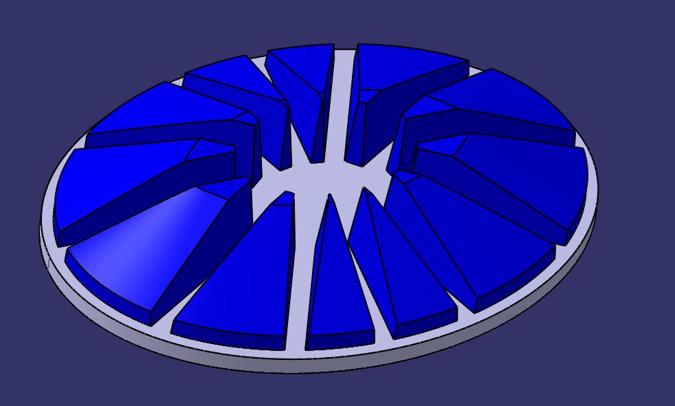

you could make a rigid wall with mold release wax, without using silicone rubber. With moving parts and dowels with very draft angle, which can be detached from the assembly with threaded fasteners.
