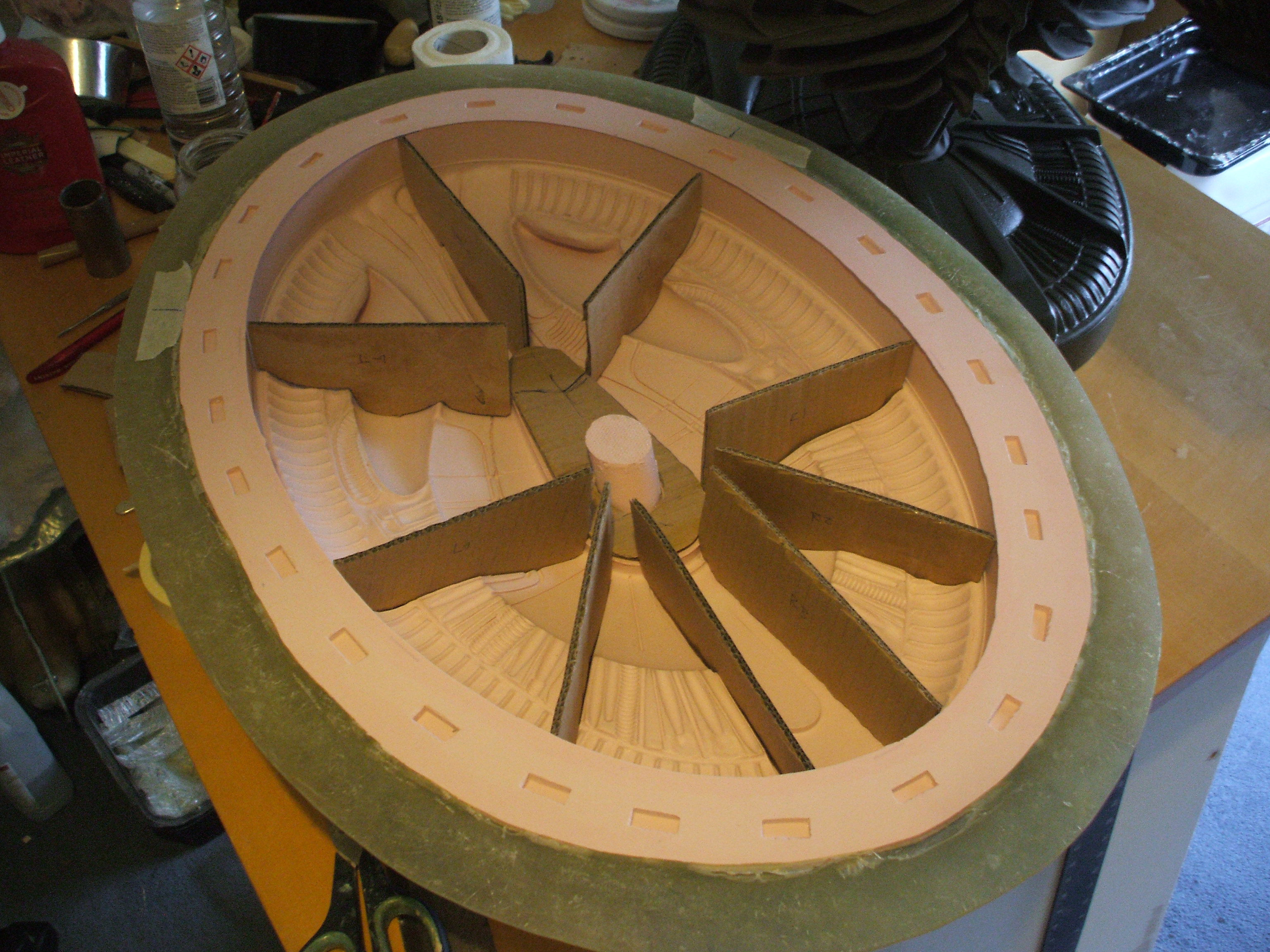

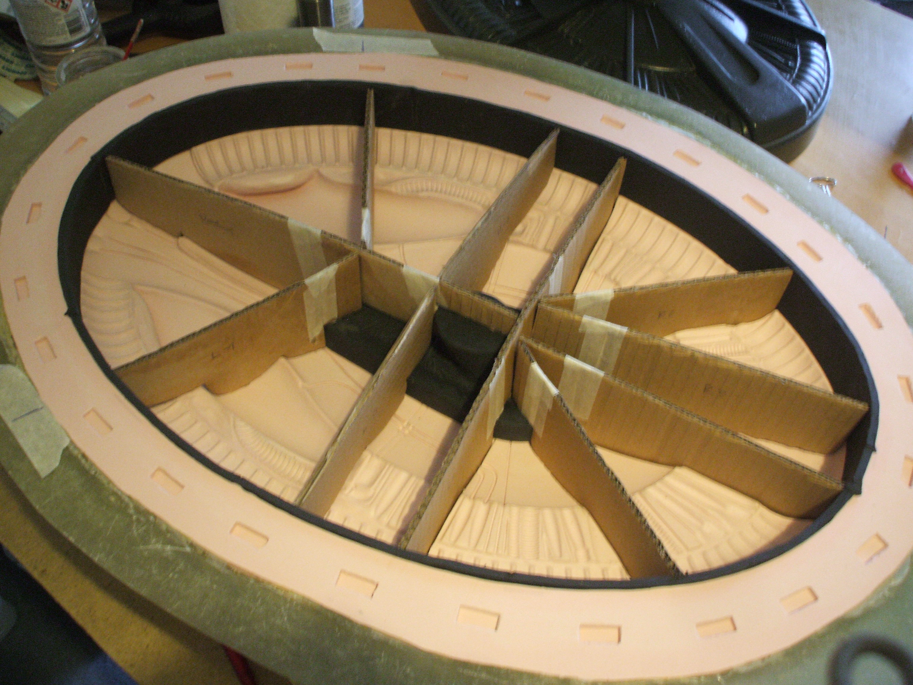

These are just some cardboard templates I'm knocking up but this should give you a clue as to my intentions with this :)

:confused:unsure:facepalm:wacko For me it is too difficult to understand. I will understand in progress. :)

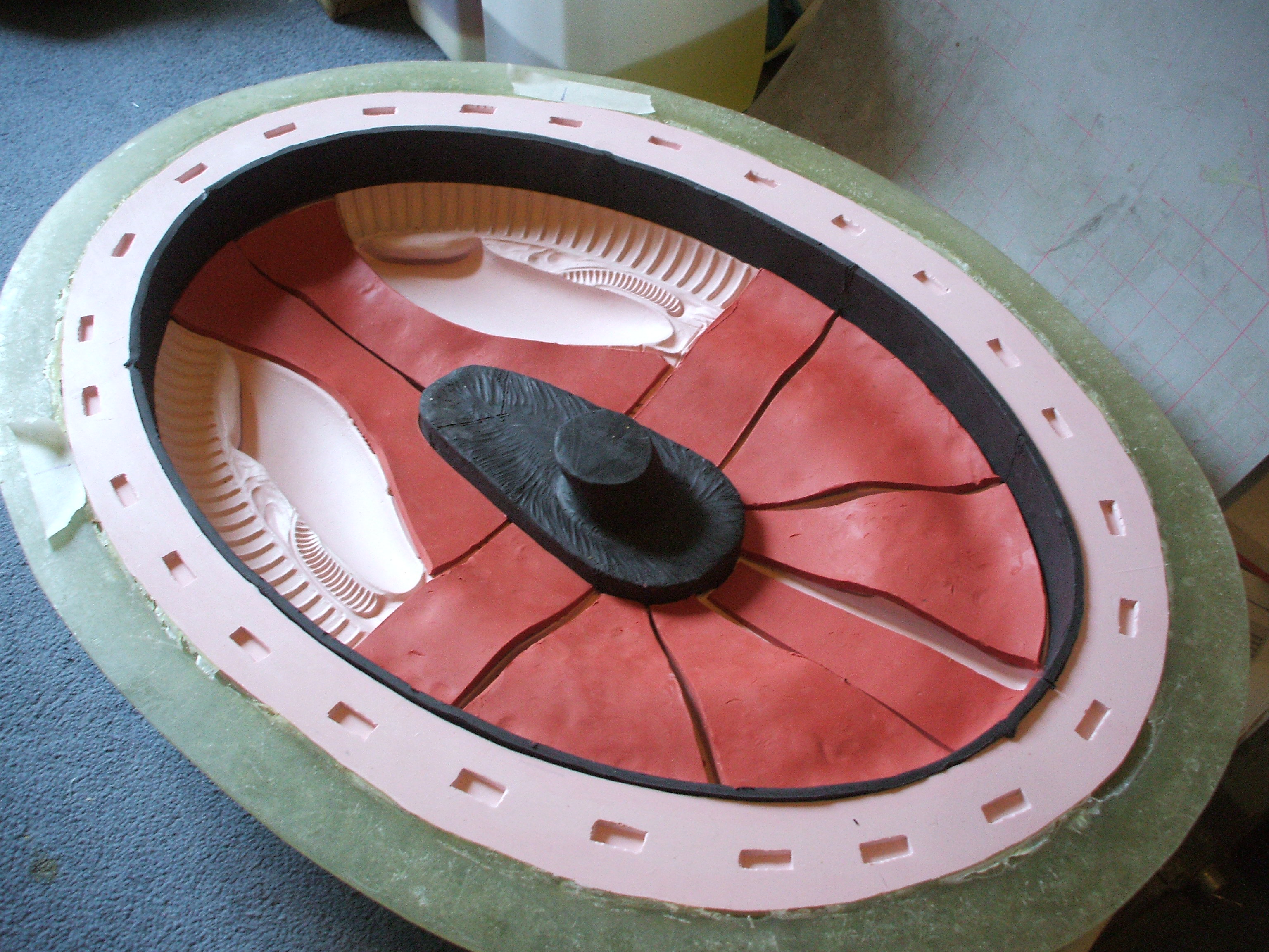

Here's another pic:
In this pic you can see I've started adding clay (the black stuff). the clay is 3/16" thick (5mm) around the sides & 5/16" thick (8mm) covering the middle part.

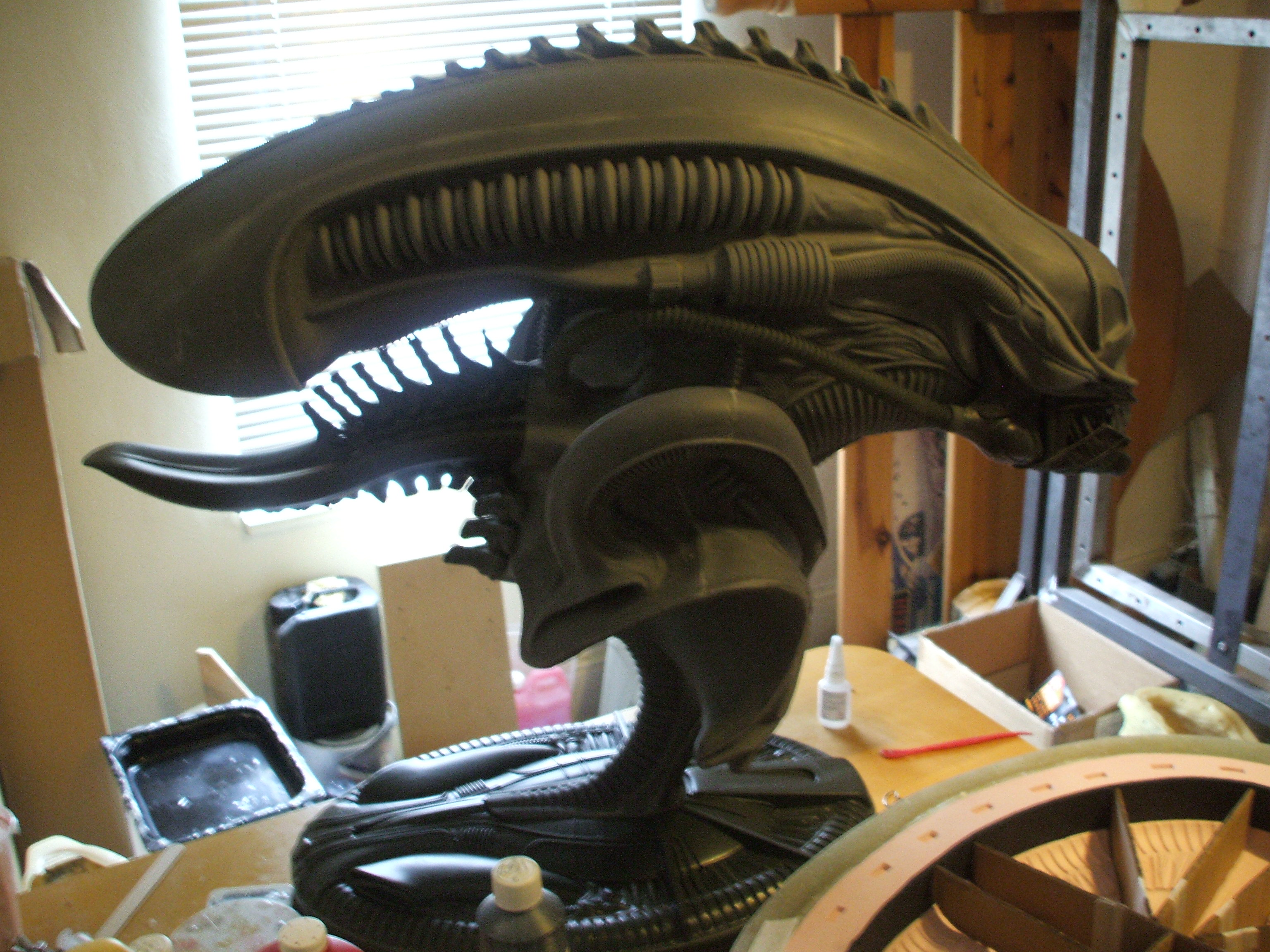

Here's a pic of Bob for no particular reason :D
He's overseeing progress ;)

Now that you've put the clay strip along the outer perimeter, I think I understand. You're creating a series of gaps to create a thickness instead of a full volume. So it is?:)

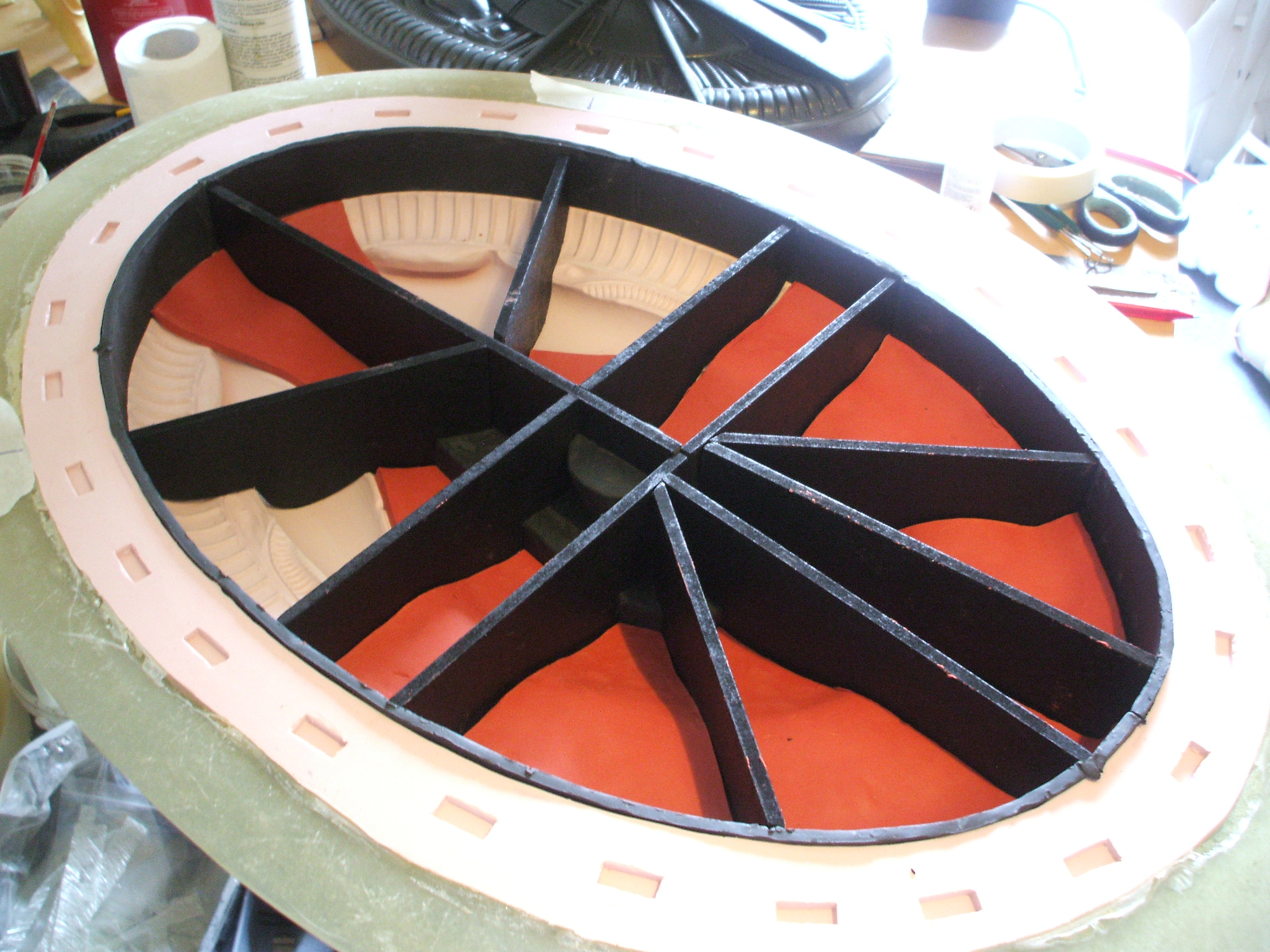

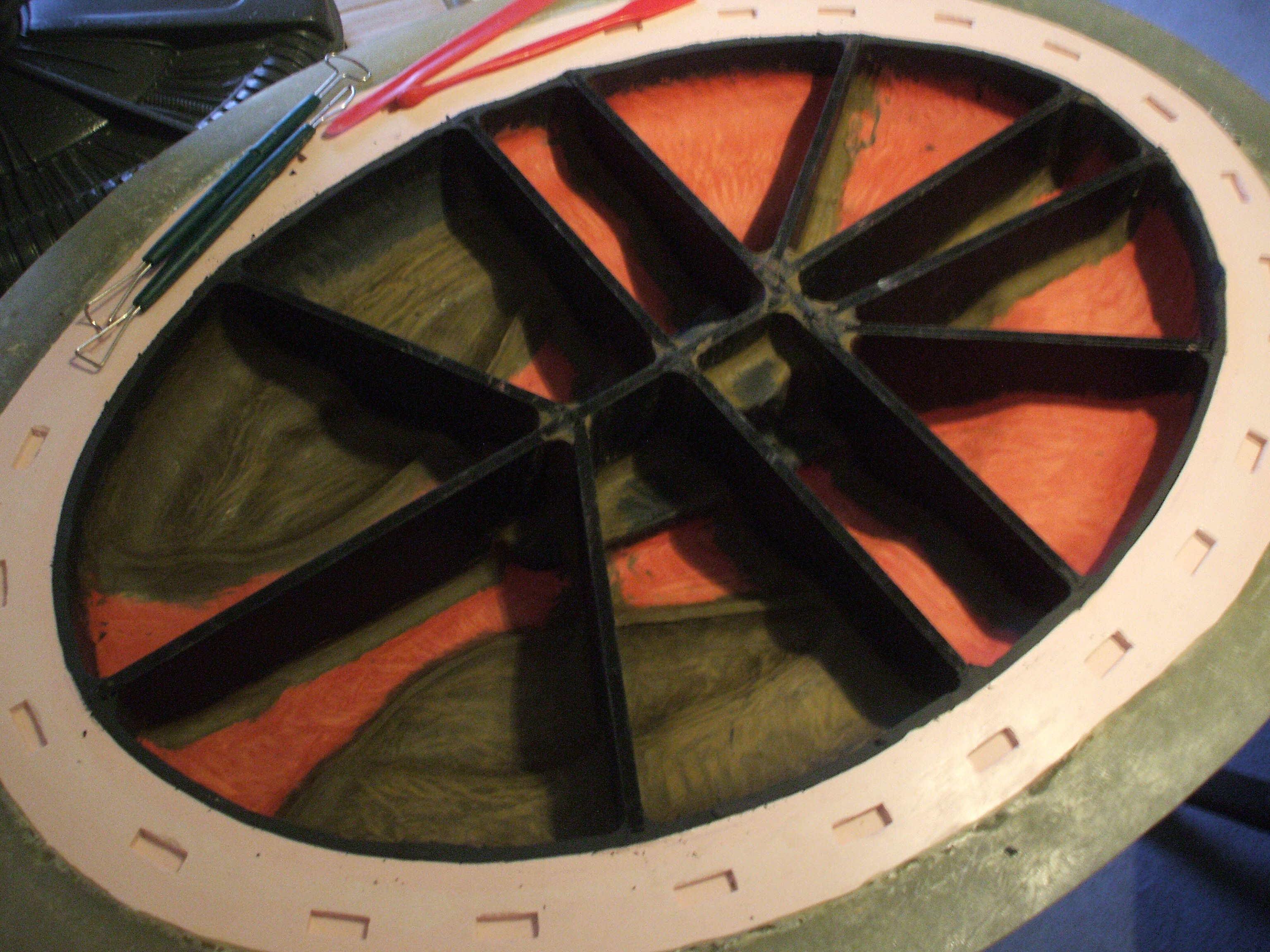

You got it :)
Yes with this cast it will be a one piece solid cast but hollow underneath with reinforcing struts cast into it. The reasoning is simply to save material while retaining the strength needed to support Bob.
If I just cast this as solid with a flat bottom it would consume about 5 ltrs (a gallon) of plastic which would cost a small fortune. If I rotocast it, it wont be strong enough to support Bob since he weighs about 18lbs (8kg) without the base. He may well end up weighing more like 20 without the base as I still need to add foam to the fin, his tongue isn't fitted yet & he's a little front heavy so I may add a little weight to the back to even things out a bit.
The cardboard pieces you can see will be 1/4" thick (6mm) MDF, there will be more smaller struts & cross braces made out of clay & blended in. The main skin or top surface will average something like 1/4" thick (6mm) & there will be some thicker sections where the struts meet.
I still don't have a full plan in my mind as to exactly how this will be but I have a rough idea :D I'm working it out as I go along :)

My plan for the pour will be to position the mould upside down (as it is in the above pic).
There will be vent holes in the up facing part of the mould at various points, these will be straight up & around 4-6mm in diameter & probably 2" (50mm) high. The pour spout will be a little higher & positioned in the centre of the mould.
The theory being that the pour spout will act a bit like a reservoir & force air out through the vents by the weight of the plastic & gravity. the pour will stop when the vents are filled with plastic. I expect I'll need to persuade some of the air out via some shaking & tapping of the mould & there will be a little wastage.
Fingers crossed it'll work :D
looks like a good plan. its a little bit similar to the moulds that are used for bronze casting. of course the metal is a little but heavier and the mould material normally is air permeable itself a little bit. but I think it could work pretty well. the bigger the pour spout will be, the more pressure you get, but the more material you waste unfortunately. good luck with the first cast
