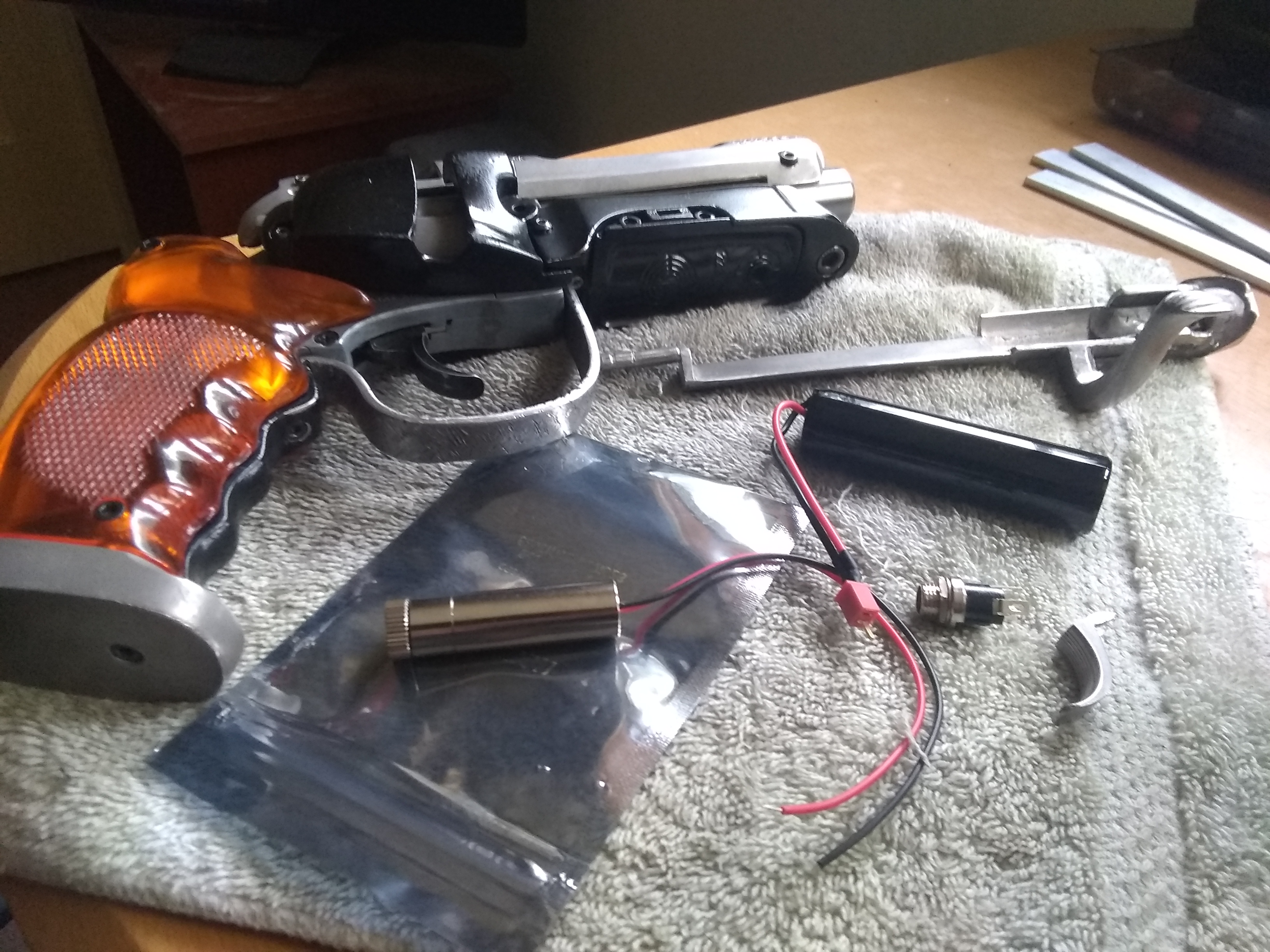

For the second trigger I'm weighing options for functionality. Now I always imagined the Steyer receiver as being a bolt-action launcher similar to the new BSG. I don't see anything like that possible but they do have lasers that can burst balloons from across the room. Totally doable with a 5.7v battery and a recharge port either in the fifth LED or the grip frame dimple. There are flashlights (meh), laser sights (useless)... any ideas?
Theoretically... you could calibrate the laser to a set effective distance and use the bolt handle to focus the laser lens for a determinable range.... hmmm...

"You'll put your eye out, Kid!" heh, heh. But yeah, that's actually very much a thing. Burning lasers will indeed put your eye out. Phhhpbt, you think the fx-saber forums are full of engineering nerds. Dip a toe in the laser forums... Jiminy.. :/
Turns out the entry-level balloon-popping laser is 405nm 100mW, blue-violet. <$20 shipped on eBay.
Can run off an 18650 battery from Solo's Hold (support our brethren) and the grip dimple is the perfect size for a 2.1mm recharge port (Custom Saber Shop). The solution is deceptively easy... I ain't buying it... and yes I will be VERY careful...(Jeez):

Sweet BR12819! How did you handle the 2nd trigger? Got a write up or pics of yours?
Incorporating the 2nd trigger is still vexing me due to how the main trigger is designed. You'll notice the plate for getting at the inner workings goes all the way under the cylinder. There's springs in there for the trigger return or cylinder advance if memory serves me correct. I was hesitant to start cutting out material there to make room for the forward trigger lest I muck up the inner workings. I started flattening out the frame right where the front of the trigger guard is in hopes i could put something static in there.
