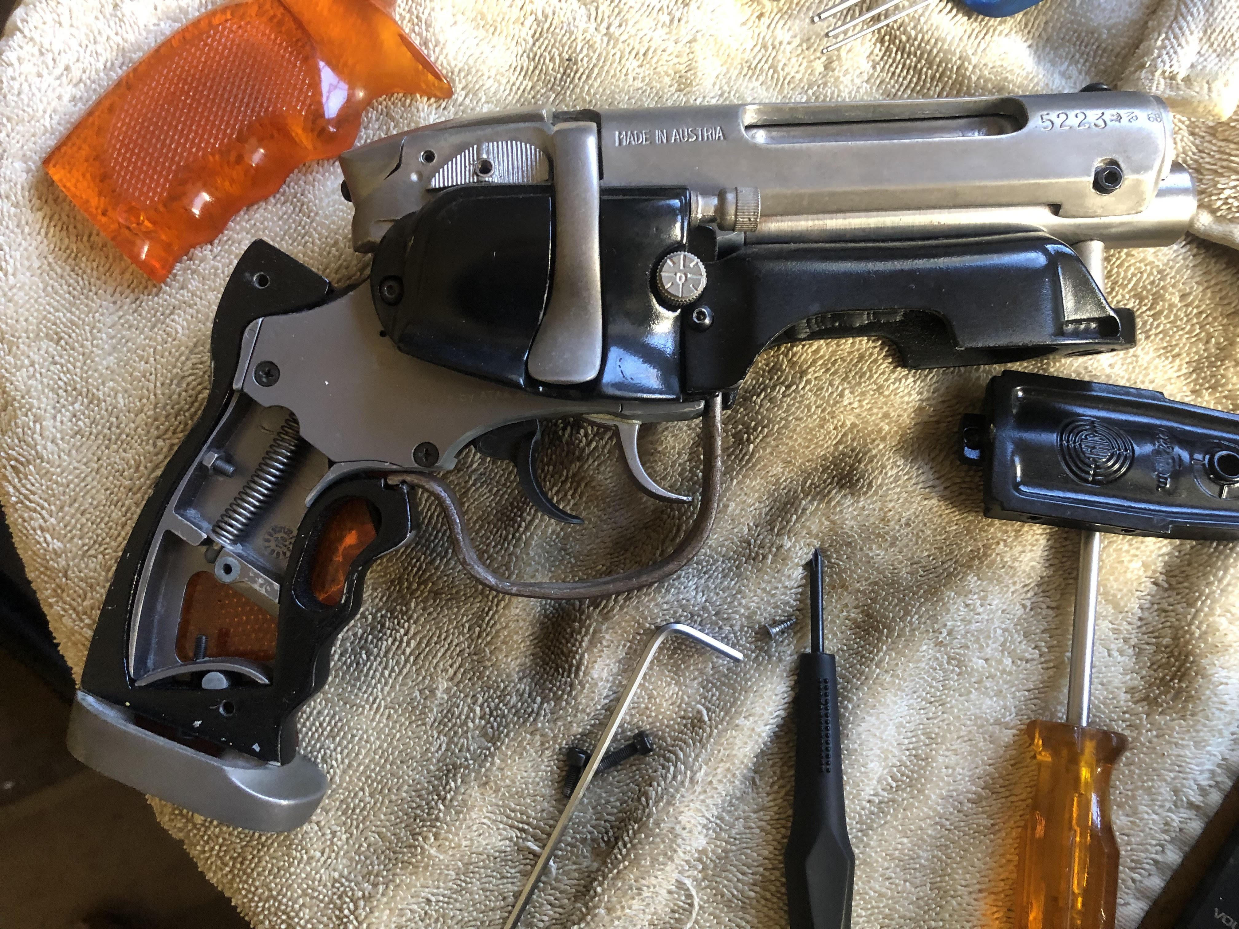

Incorporating the 2nd trigger is still vexing me due to how the main trigger is designed. You'll notice the plate for getting at the inner workings goes all the way under the cylinder. There's springs in there for the trigger return or cylinder advance if memory serves me correct. I was hesitant to start cutting out material there to make room for the forward trigger lest I muck up the inner workings. I started flattening out the frame right where the front of the trigger guard is in hopes i could put something static in there.

Unfortunately I just don't think there's enough room in the Zoraki design for adding anything like a micro switch in the frame. I'll be happy with mine if I'm able to pin a second trigger in there. Make me wish I had a proper mill!

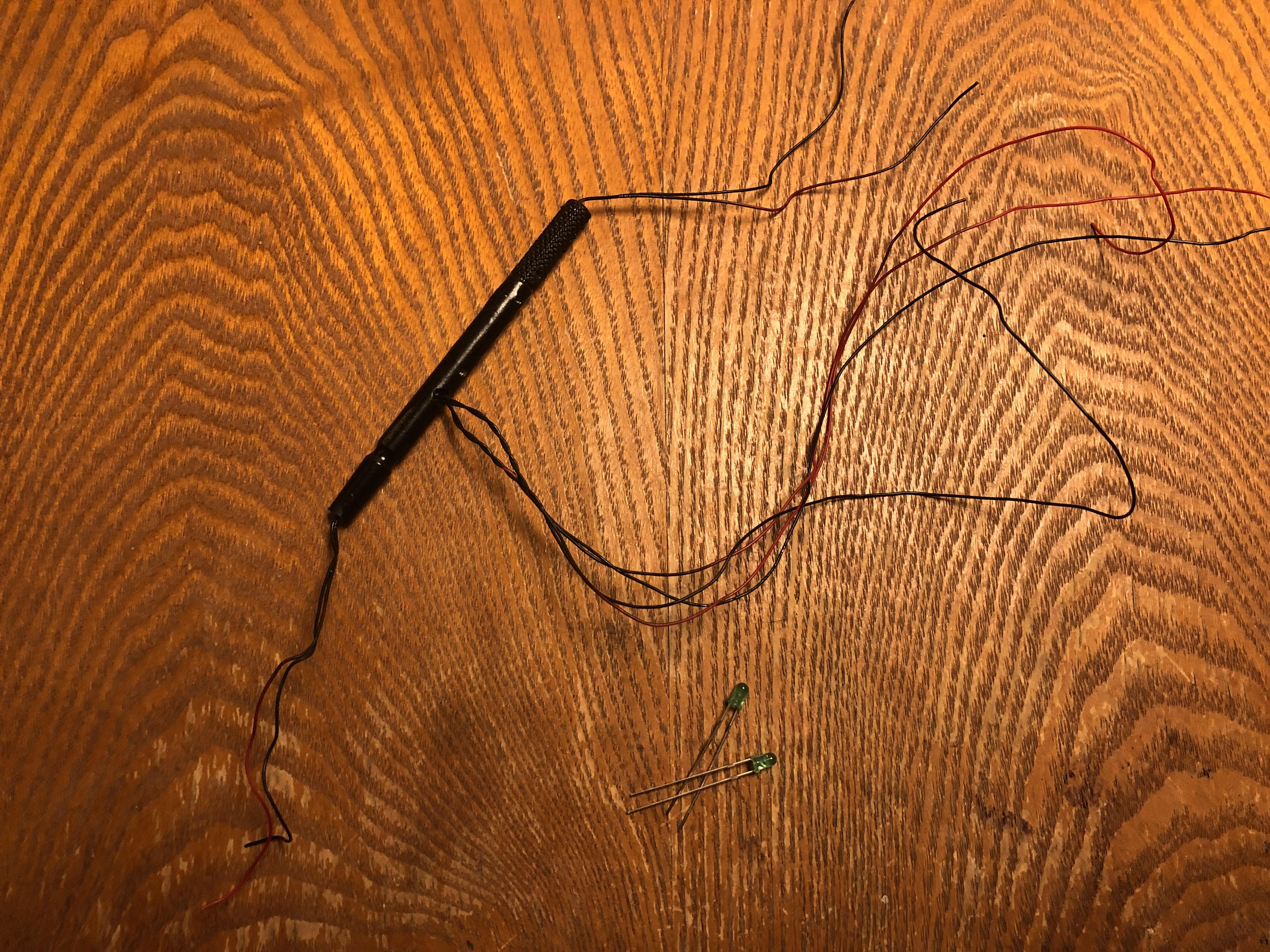

Well dang, that didn't take long to screw up. :/ The Sidkit comes with everything to wire up the LEDs except instructions:

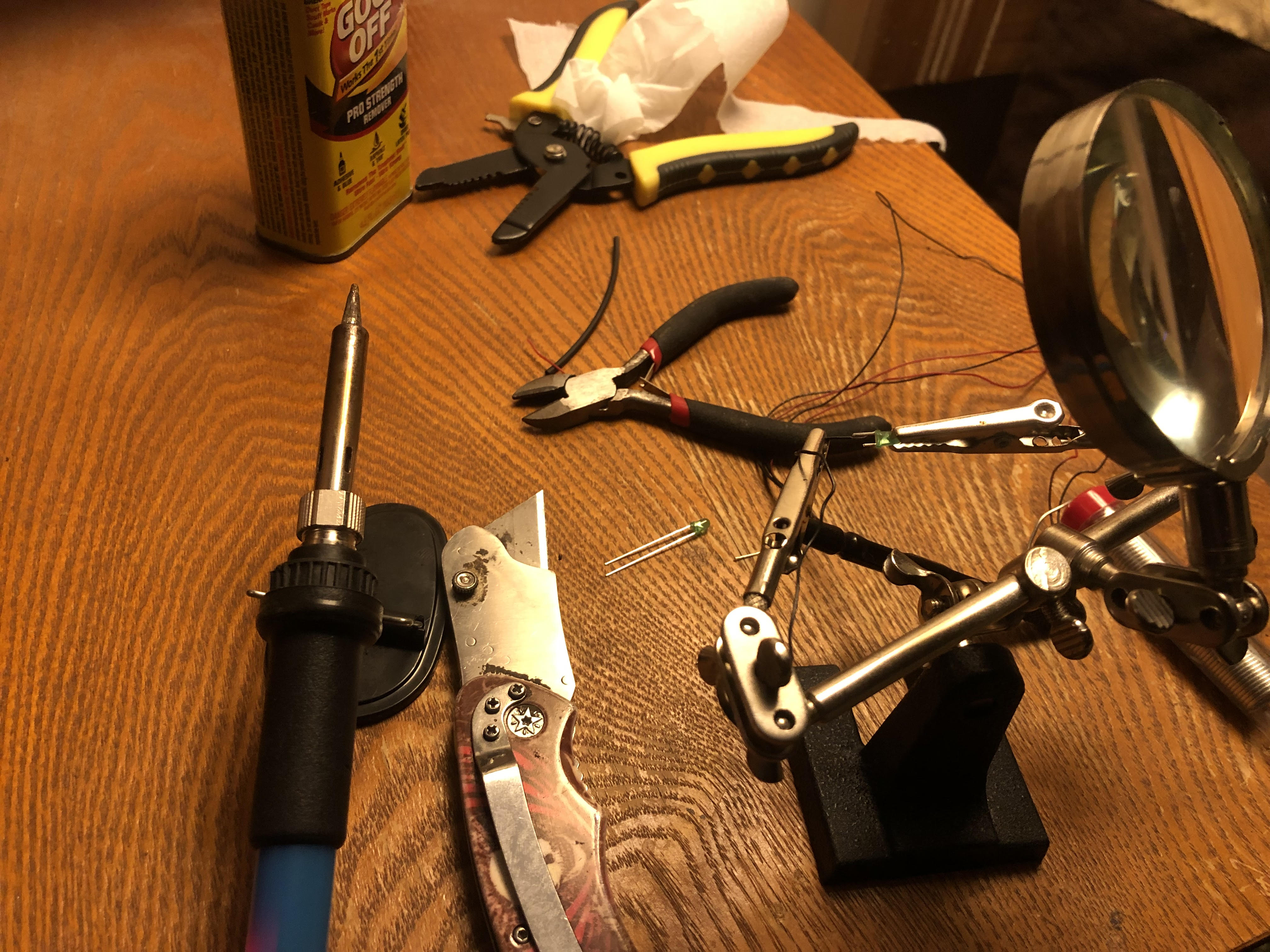

These are all the little pieces left over after the build (including a recharge port and momentary switch from when I had delusions of grandeur) and we will start with the dental tool/laser pointer thingy:

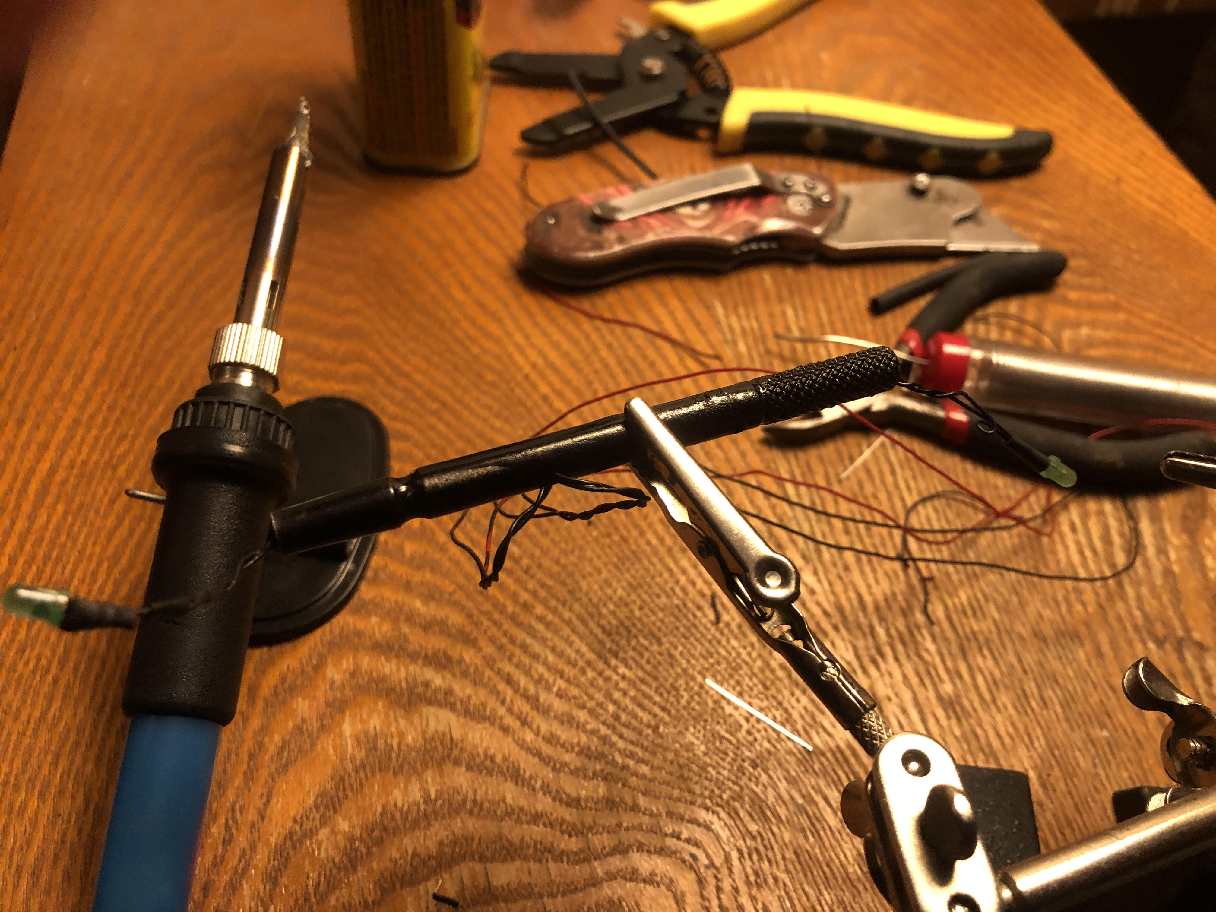

It comes prewired through the doohicky so after paint you just attach the LEDs:
Please excuse the bad pics, I just snap them as I'm going along and if they suck they suck :/ After the LEDs are all attached time to test them:

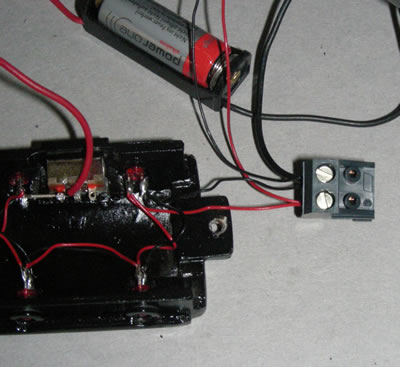

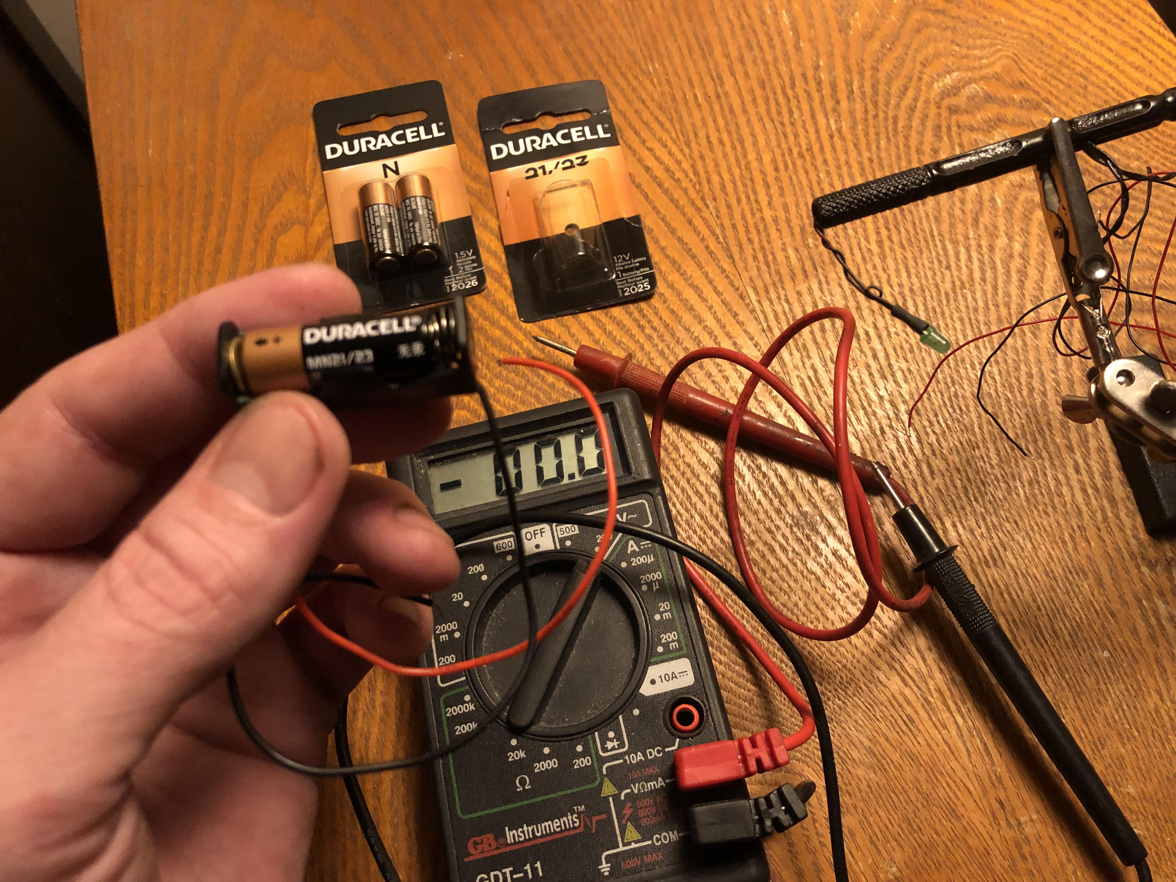

And this is where **** goes south, by the size of the included battery holder I'm thinking these must be for the 12v 21/23 battery. Wrong!!! It fries the LEDs with aplomb:
The N-sized battery is too big and only 1.5v to boot, the only existing instructions for the kit describes a pre-wired unit the kit used to come with and I can't tell what this battery is supposed to be:
I've been looking at battery size charts thinking maybe a 3.6v 1/2AA but it looks too fat and specialized for a kit this old, 123 and CR2 are only 3v. Jeez! Anybody have an idea what battery we're looking at here?
Ah, so I see, the 5 red LEDs are run in series with a forward voltage of 1.8v each and the 2 green LEDs in parallel with 3.2v to total approximately 12v. You have to test the individual connections with a 3.6v max power source and then power the completed setup with 12v. NOT intuitive. :/
Hi, I confirm.. :) it's a 23A 12v battery..

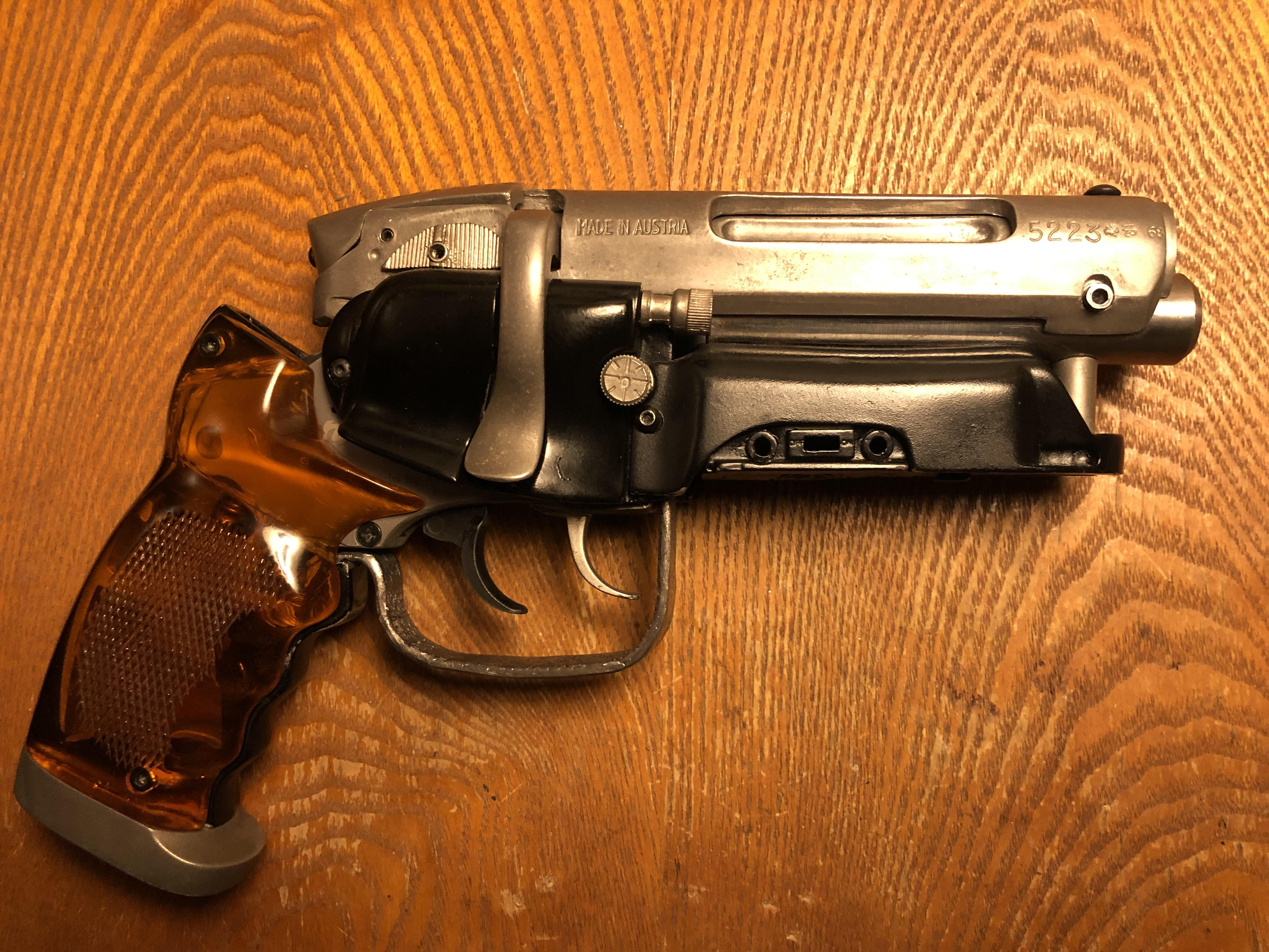

Well (surprise), Gorilla Glue does not work for the long-term. It appears to dry out and crumble. The 2nd trigger started letting loose so JB Weld it is. With the little feet the 2nd trigger on the Sidkit leaves when you cut it down, I'm hoping the pewter trigger will let go before the base does.
Yeah, I don't use gorilla glue for any of my builds. I stick to 2 part epoxy putties mostly. JB weld makes a few good ones, one has steel powder in it I think they call them qwik stick,and steel stick, something like that. Milliput is also one of my favorites, and it has never let me down.
If you want to wet sand, and cold blue (then distress) that trigger guard I'd stick with birchwood casey perma blue. Wet sanding will definitely remove those tool marks, but it will take some elbow grease.

Stupid "careful what you wish for" cliché. When Gorilla Glue is improperly cured ( :/ ) it swells up and JB Weld does not. JB Weld claims, and I can affirm, that it can be drilled and tapped. When cured it's slightly softer than the pewter itself. When I affixed the forward trigger it is now 1-2mm too short and stuck for good. :( How quickly we go from hoping it won't fall off to hoping it will. Grrr... :
If by some miracle it does fall off I'll put a 1-2mm coat of JB Weld on the trigger aperture and life will be as it should be.
