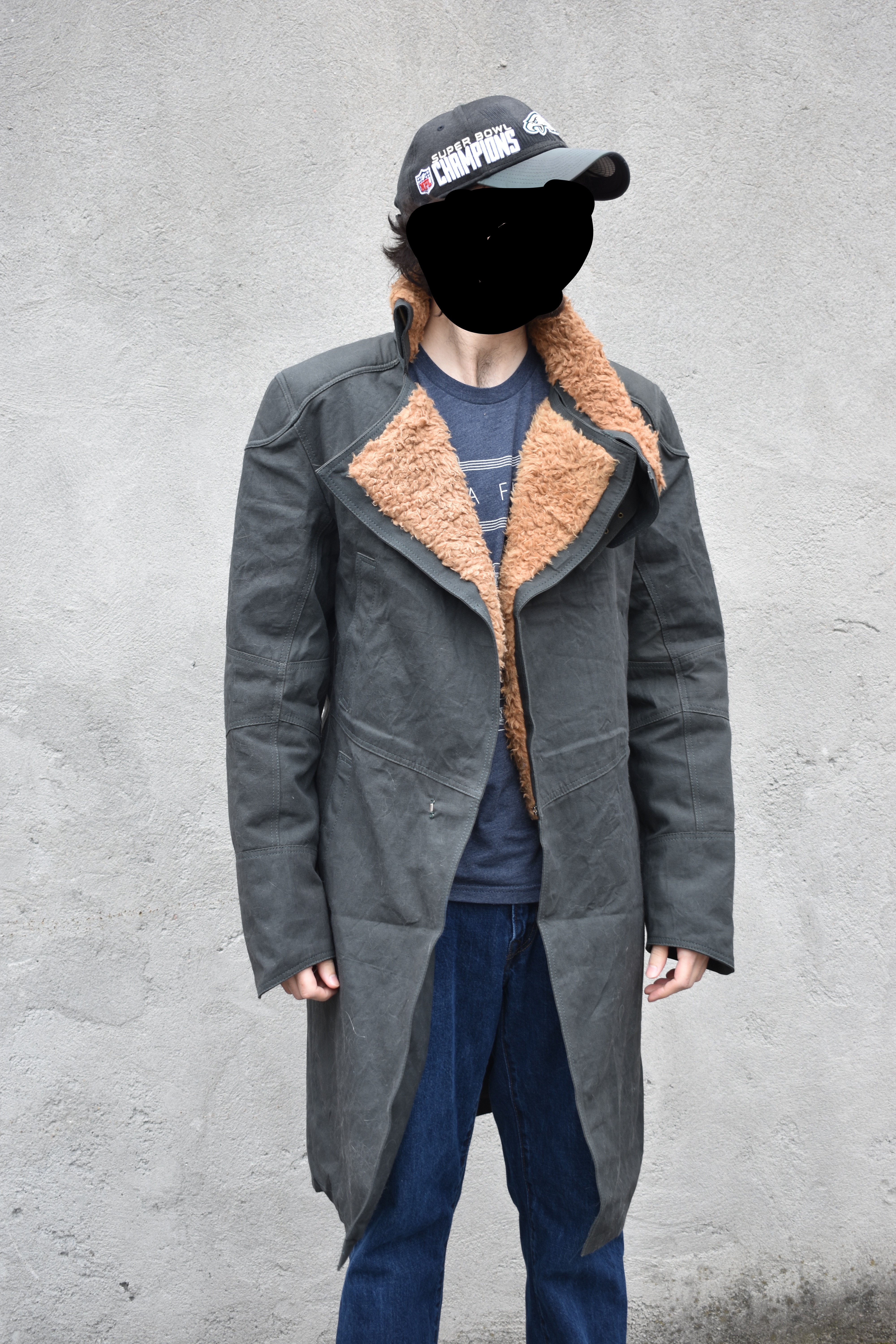

Hmm. My little piece of fabric that I used the otter wax on does have a shine too it - not quite to the extent of those barbour jackets, obviously - those are probably a different material (like Smith said), and properly pre-waxed before jacket construction. still, there is a bit of a shine to how I used the otter wax.
MAJSmith, do you think maybe there's less of a shine because you used the hot Iron? I only used the hand craft heater, which maybe didn't fully melt the wax into the fabric so there's a slight glaze on the surface of the material. That's the only difference I can think of but probably a big difference in terms of application.
You know, I never thought of that. It's definitely possible. I thought the hair dryer method was drying the wax too quickly before it had time to even out, so I switched to the iron. There are some websites that claim you can press waxed canvas with a dry iron on a medium setting to get out wrinkles, but it doesn't mention anything about dulling the luster. Now I'm curious. I'll pick up a craft heater or heat gun today and do some testing. I would like it to have more of a shine to it.
From Red Rabbit Mercantile:
2) Pressing Waxed Canvas: Generally, we do not recommend ironing waxed canvas because the wax and oil will melt onto other fabrics as well as your work surface. Instead, use a bone folder or the edge of your scissors to create a nice, sharp crease. If you must iron waxed canvas, use a medium setting and a protective pressing cloth. You can use the heat of your iron to remove unwanted creases, wrinkles or (gulp!) mistakes.
So… After another ½ a bar of Otter Wax and a heat gun, I’m no closer to the luster of the movie. Using the heat gun, I heated the coat and the wax and lathered on a good soft layer before drying it with the heat gun again. There is some shine on the areas with a bit too much wax buildup, but to achieve that over the whole coat would take an immense amount of wax and probably not hold up that well over time. Right now my coat has 1 ½ XL bars of Otter Wax on it and is very dark and extremely stiff (It’s close to standing up on its own.) I ran the whole thing under the heat gun again this morning to even out the white spots and I’ll let it cure tonight. It still looks great, just lacks the overall shine.
