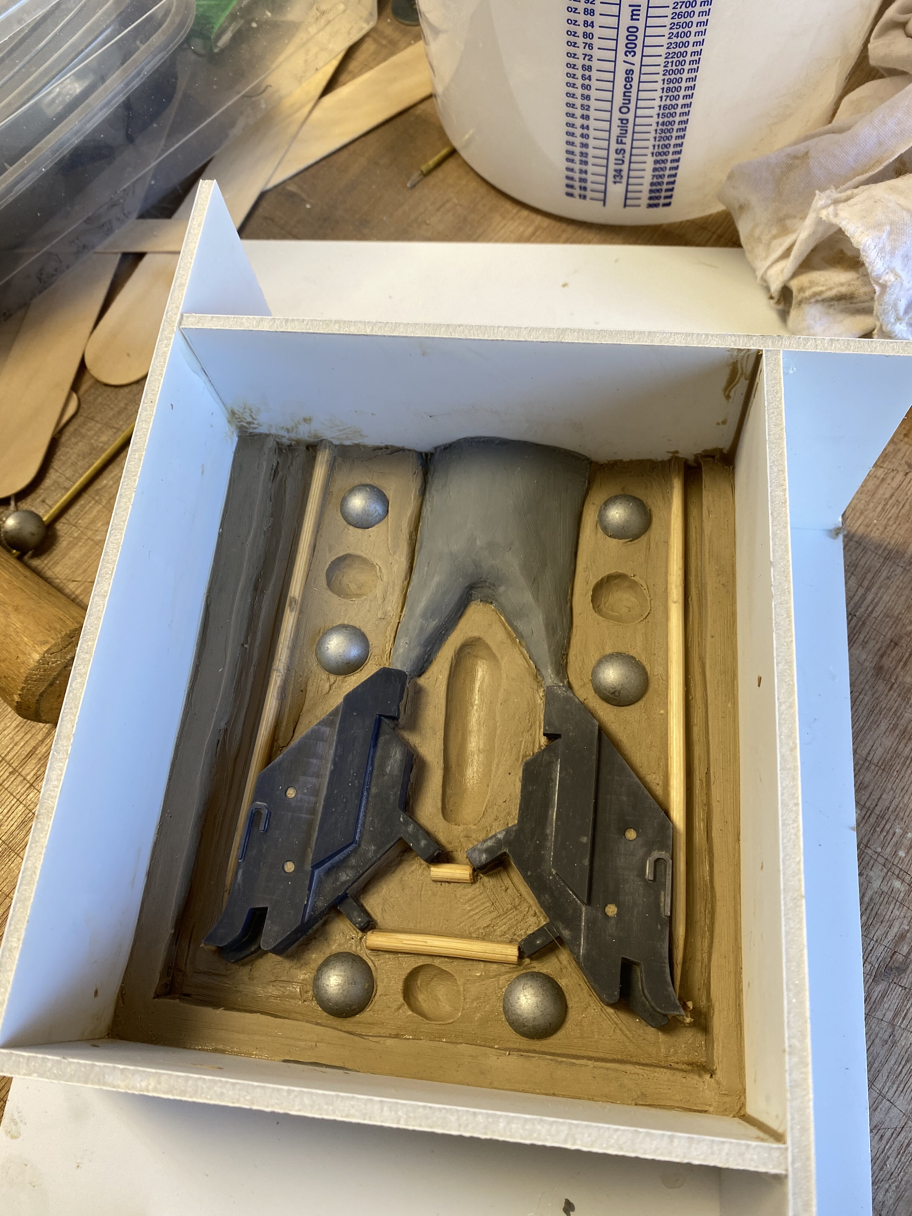

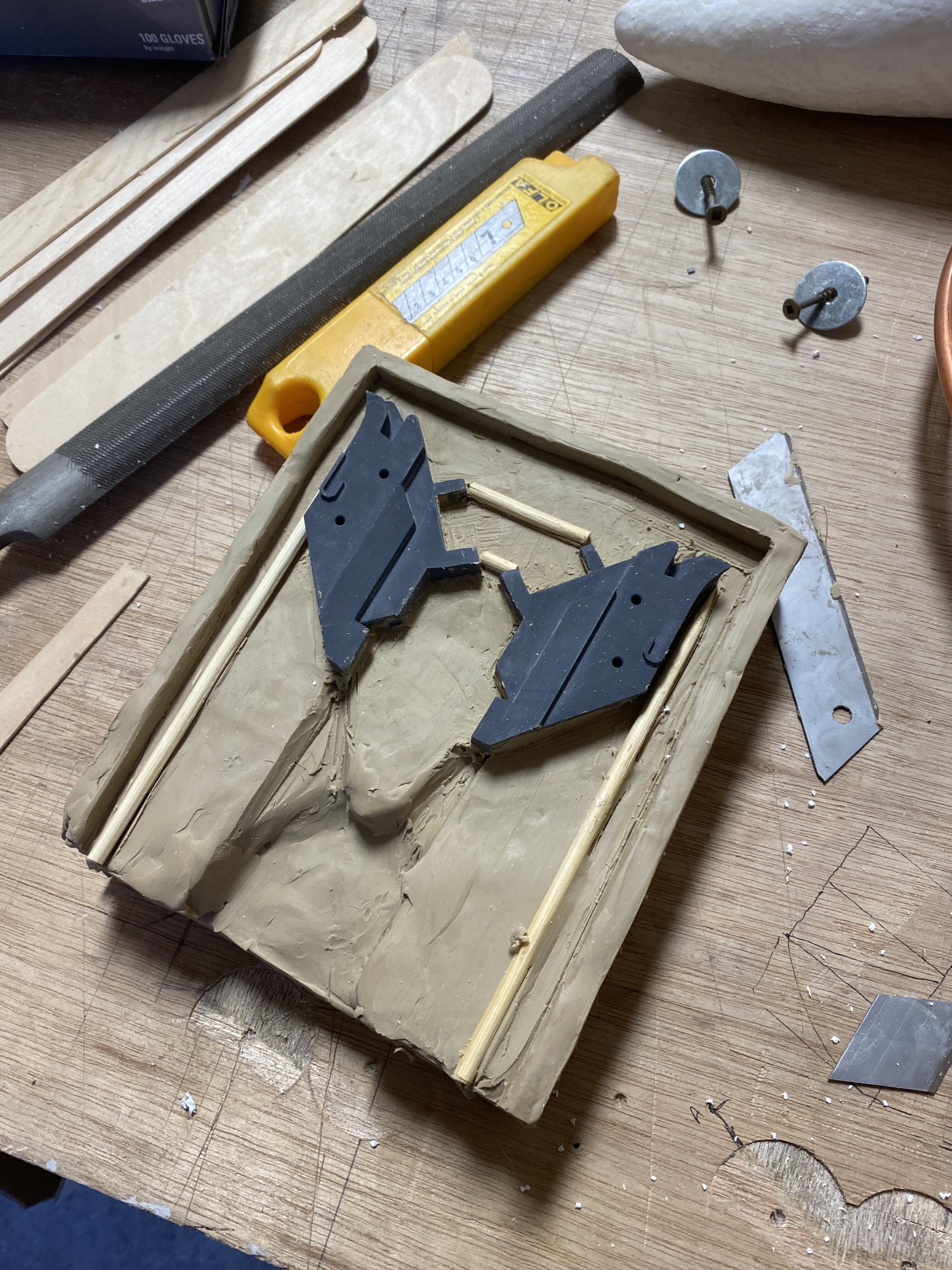

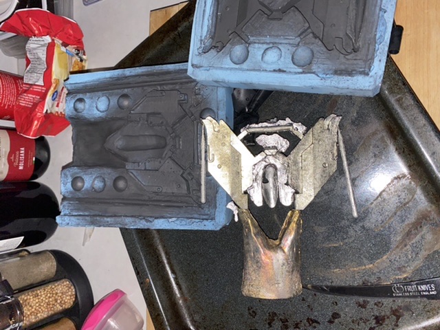

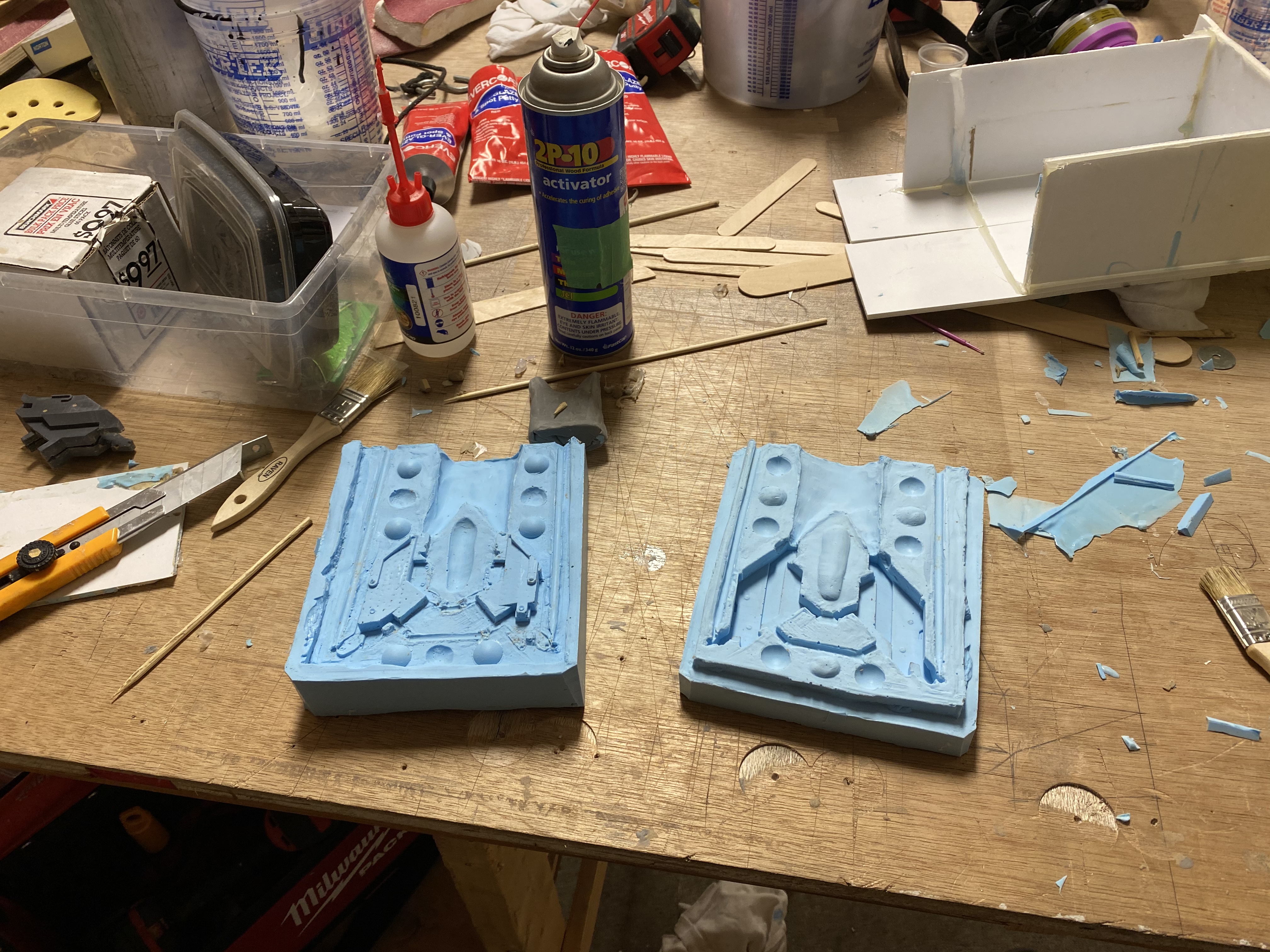

All of the components i handed off have come back prepped, and sprayed with etching primer. All of these will be fit to the action component once they have been assembled.
Molding the action as we speak
