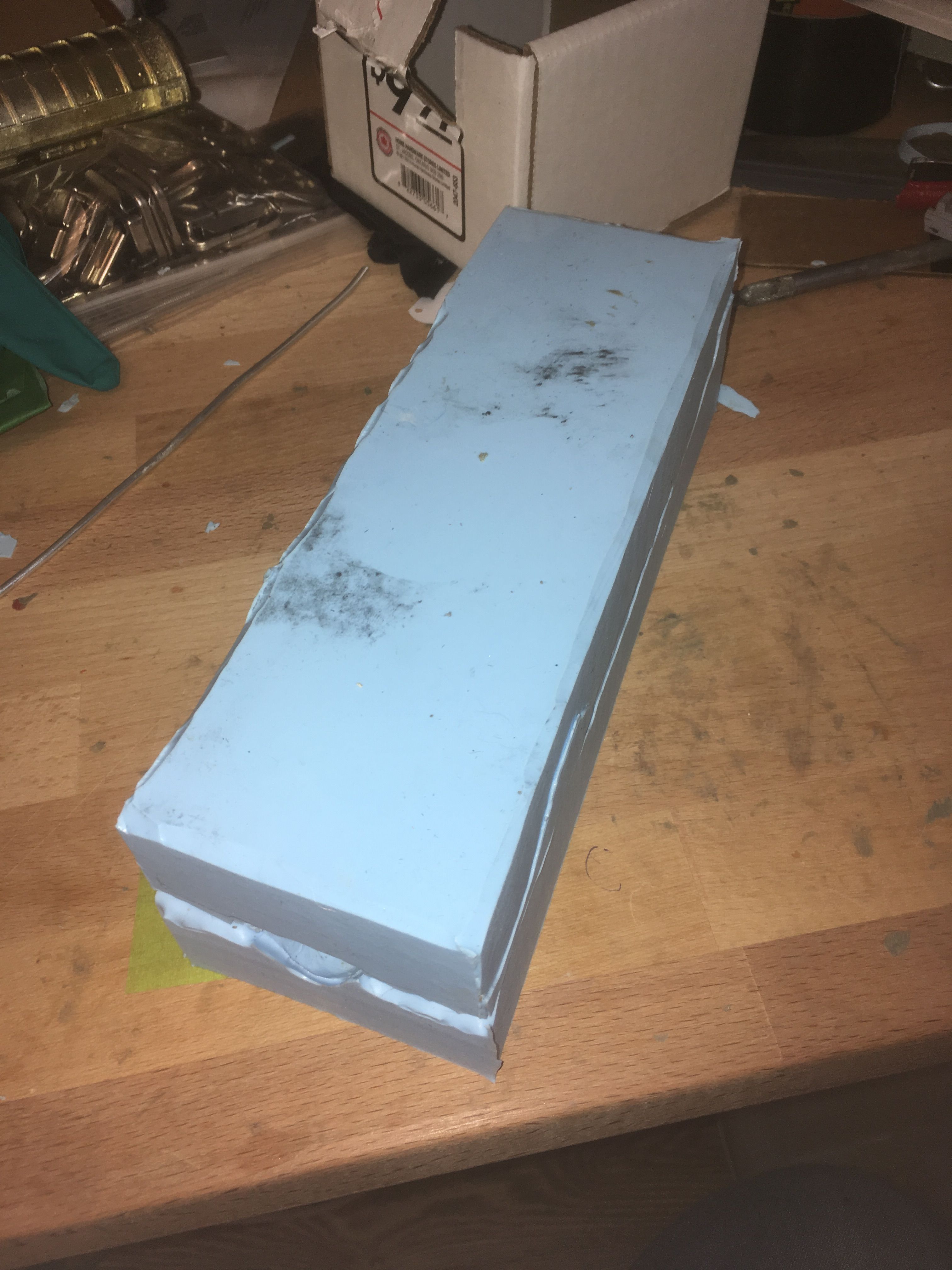

How is the new casting technique working out? I'm referring heating the metal to a higher temp so that it flows more easily into the mold. What temp are you heating your casting alloy (Rotometals R98 is it?) too? How is the Silpak holding up? Things look great by the way.
The Silpak is amazing. I plan on breaking out the burner this weekend if its fair weather. As for the casting temperature, i’ll be shooting for around 625-650

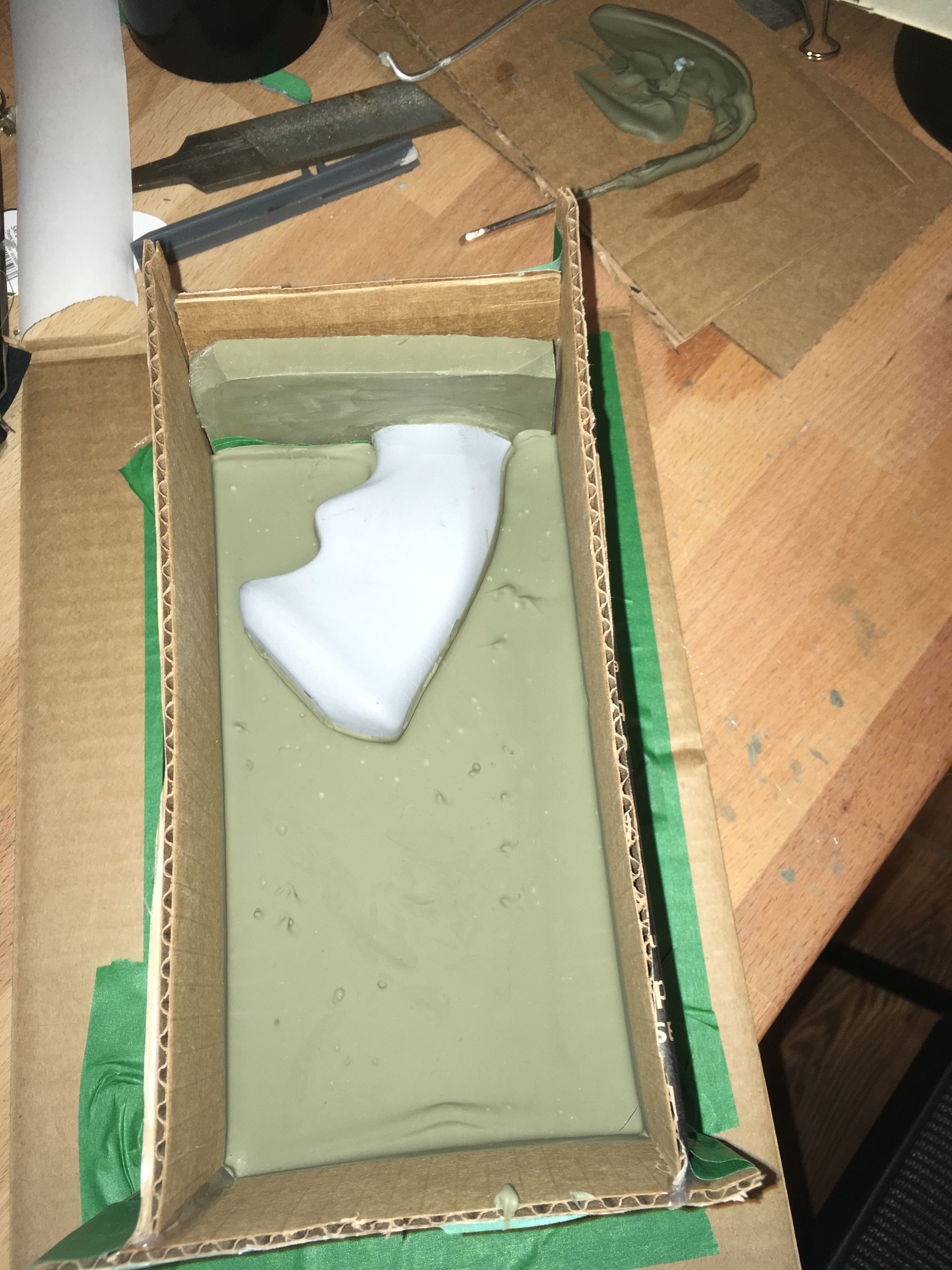

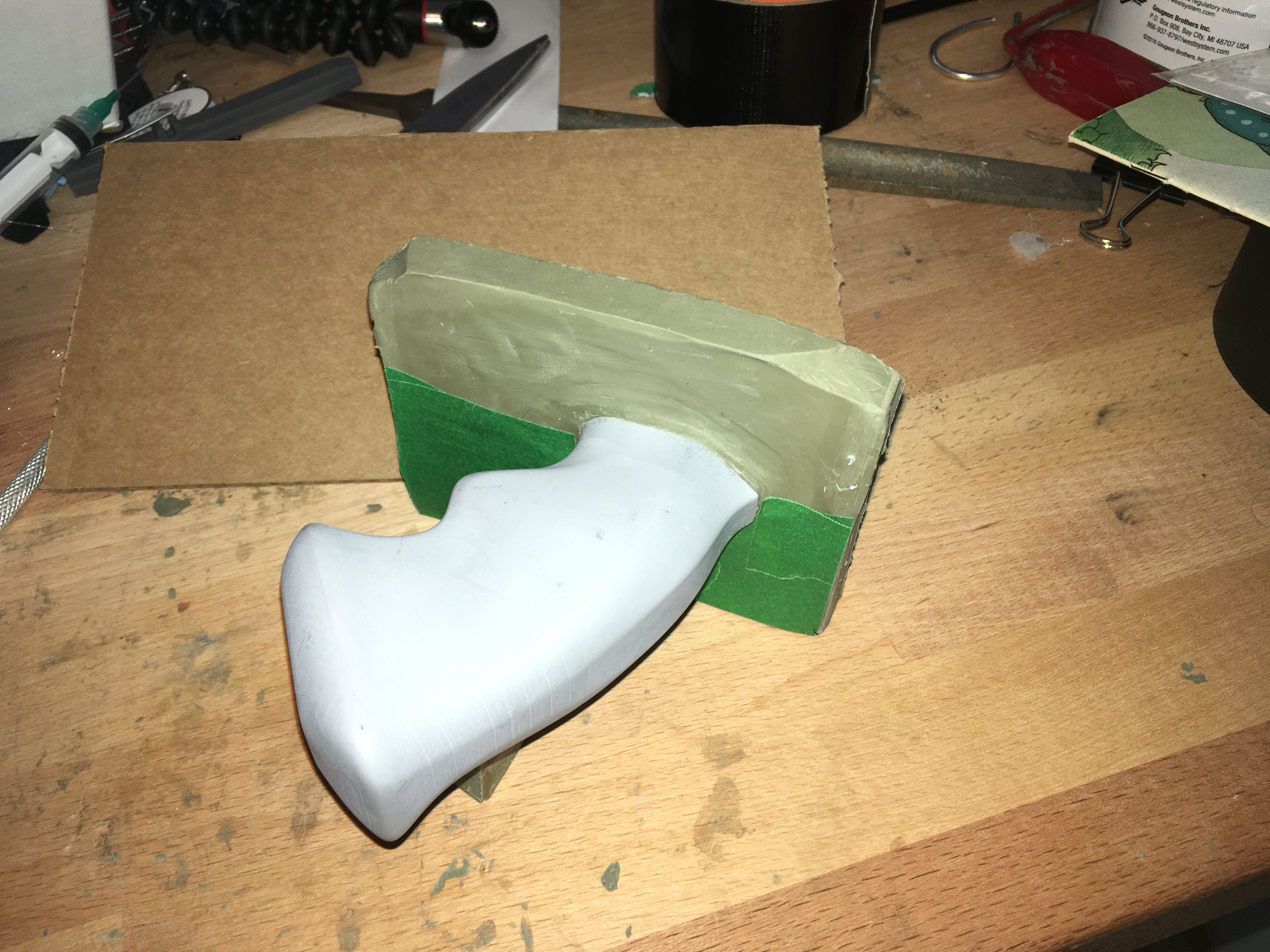

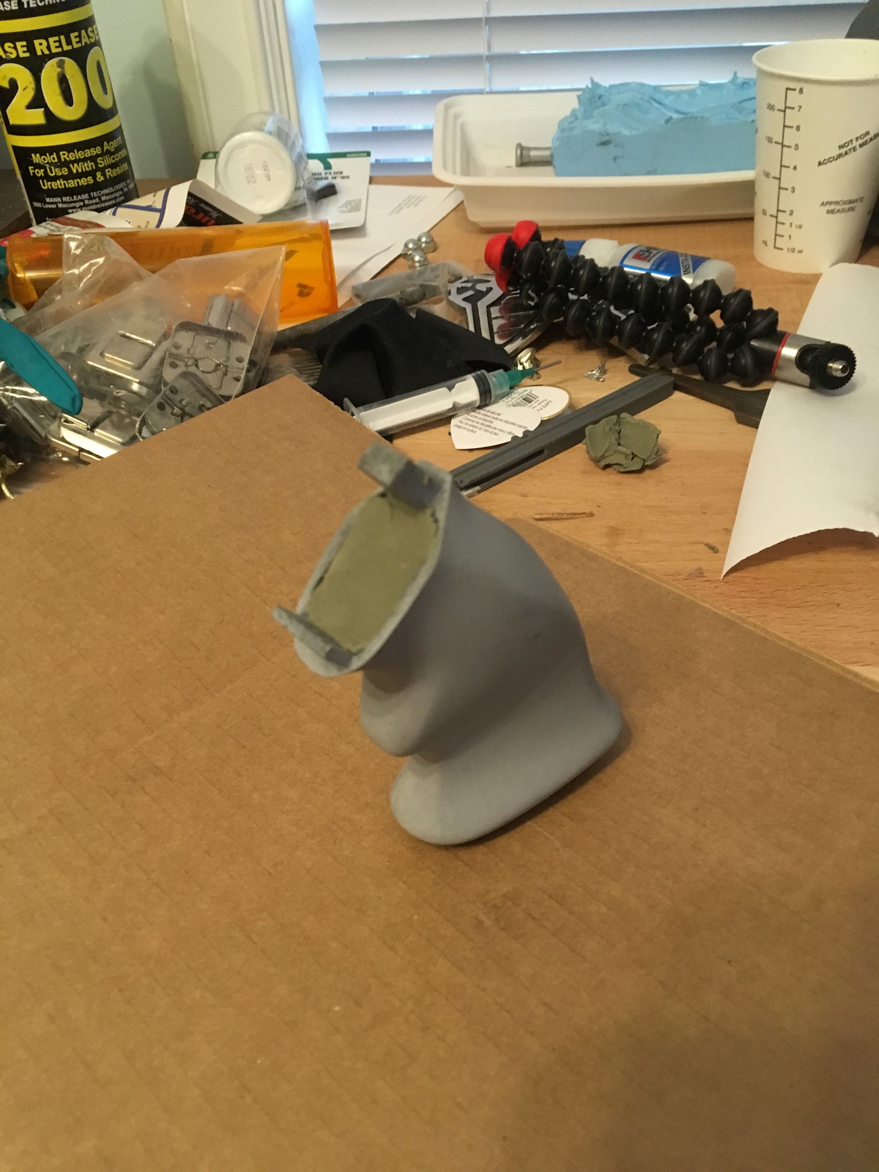

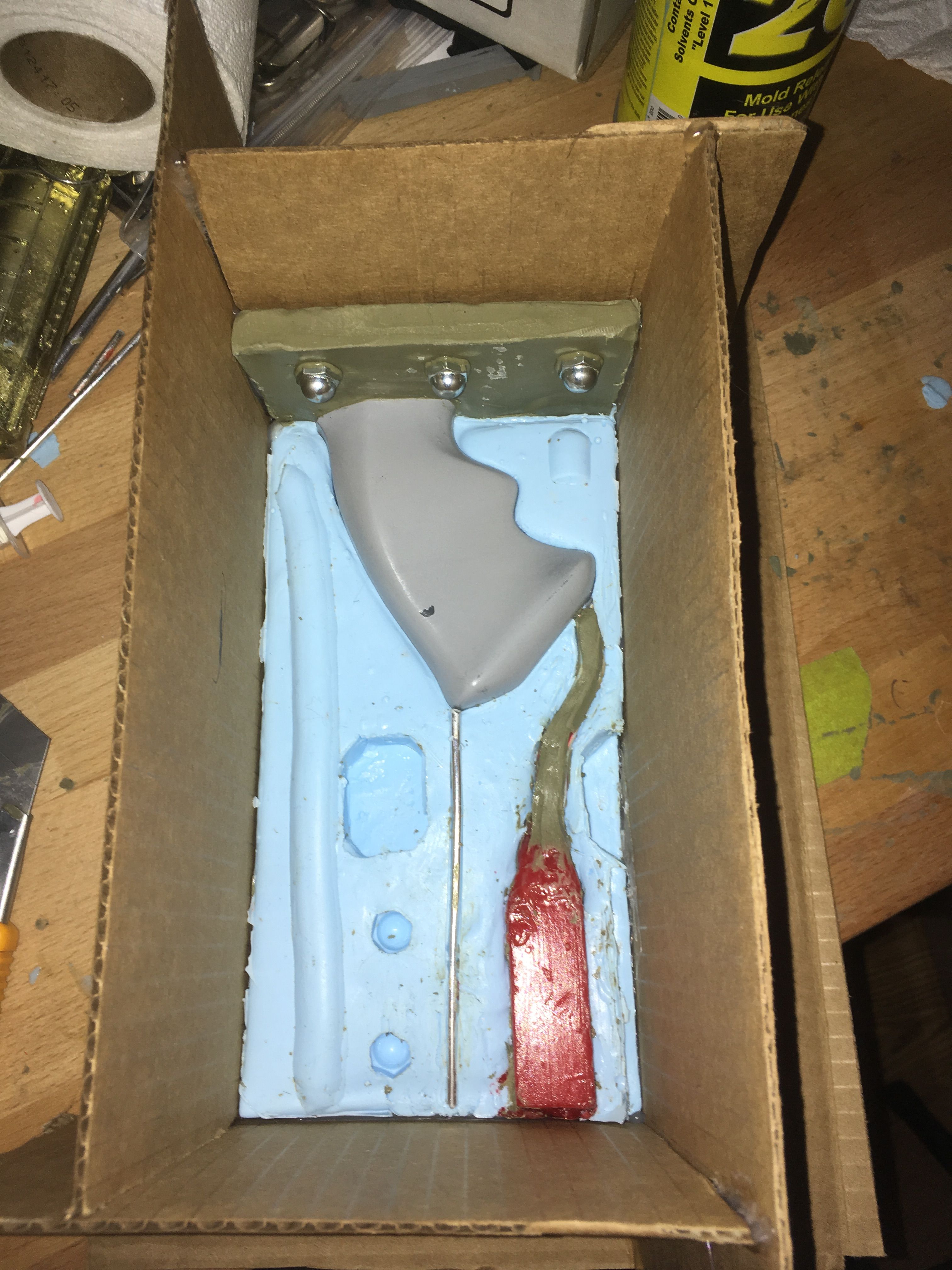

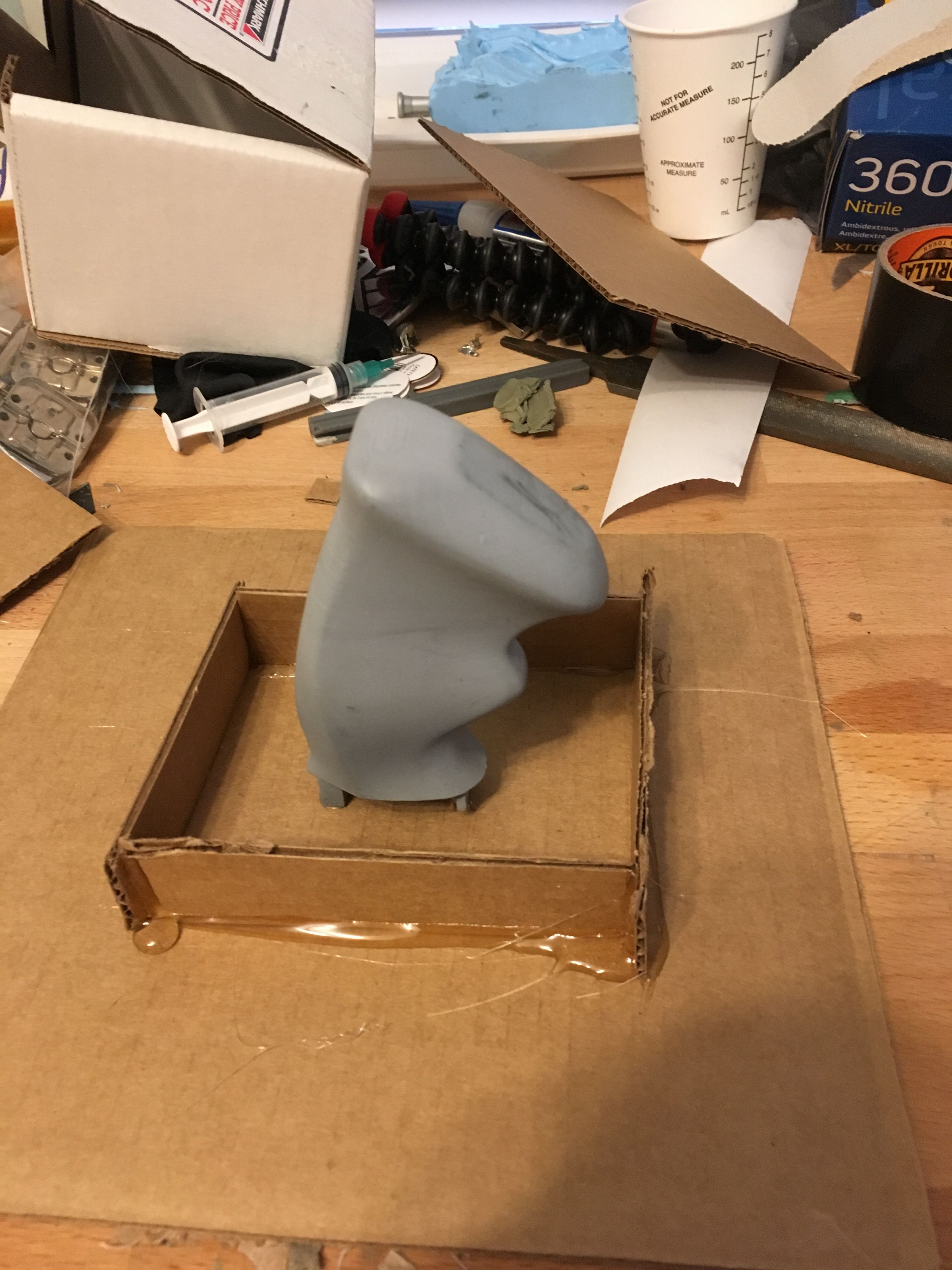

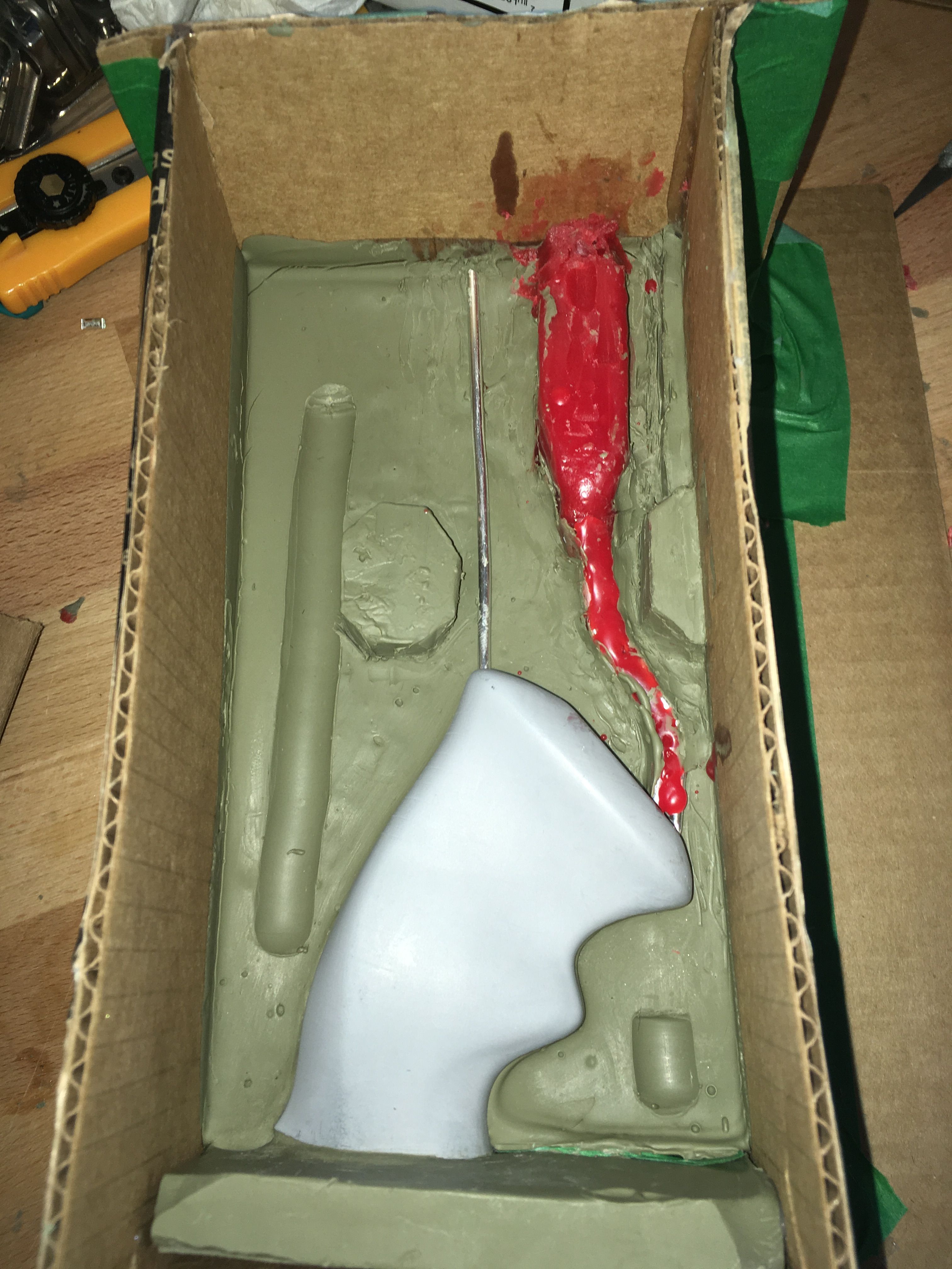

So the grip will be made from pewter, too?

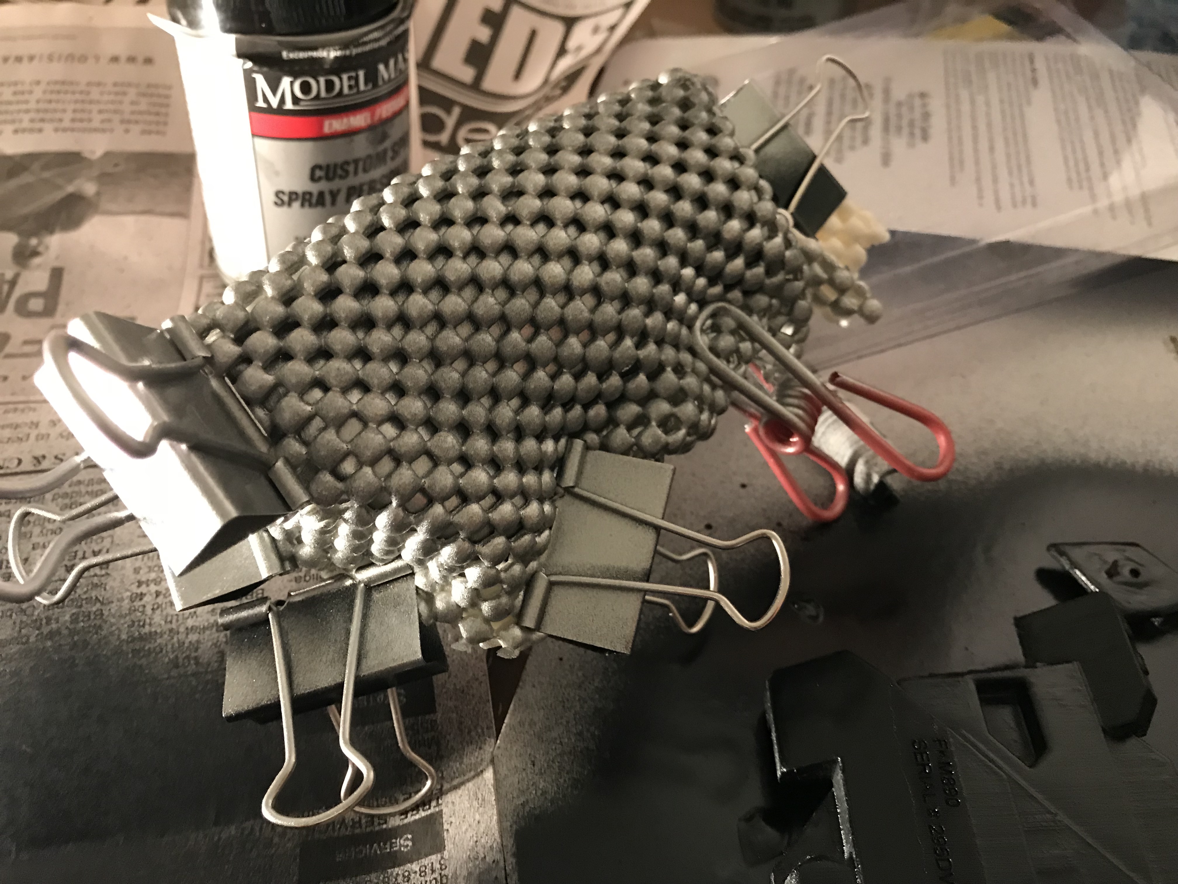

How does the carbon fiber go onto the handle, will it be like a mesh wrap with lacquer or something?

Yes, the grip needs to be pewter to balance the barrel, as well as have strength in the posts that tie everything together. I estimate the weight will be around 4 pounds.
