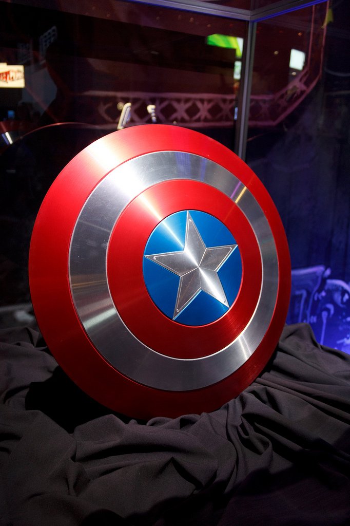

also found this image of an auctioned off screen used shield... doesnt seem like the blue metal is perfectly flush with the rest of the shield which is interesting.

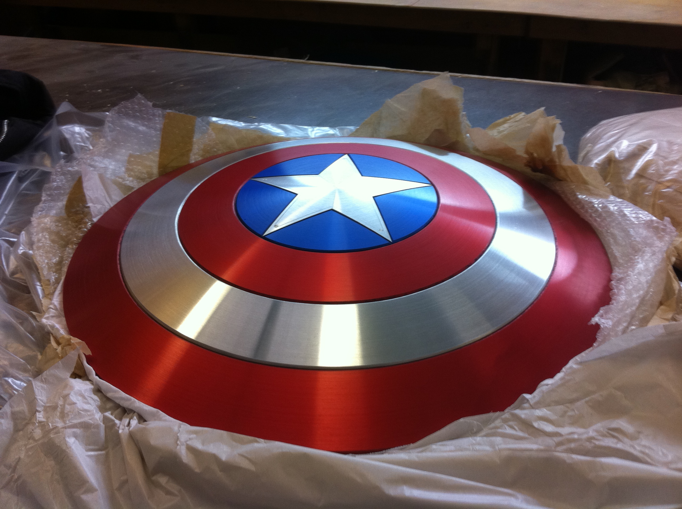

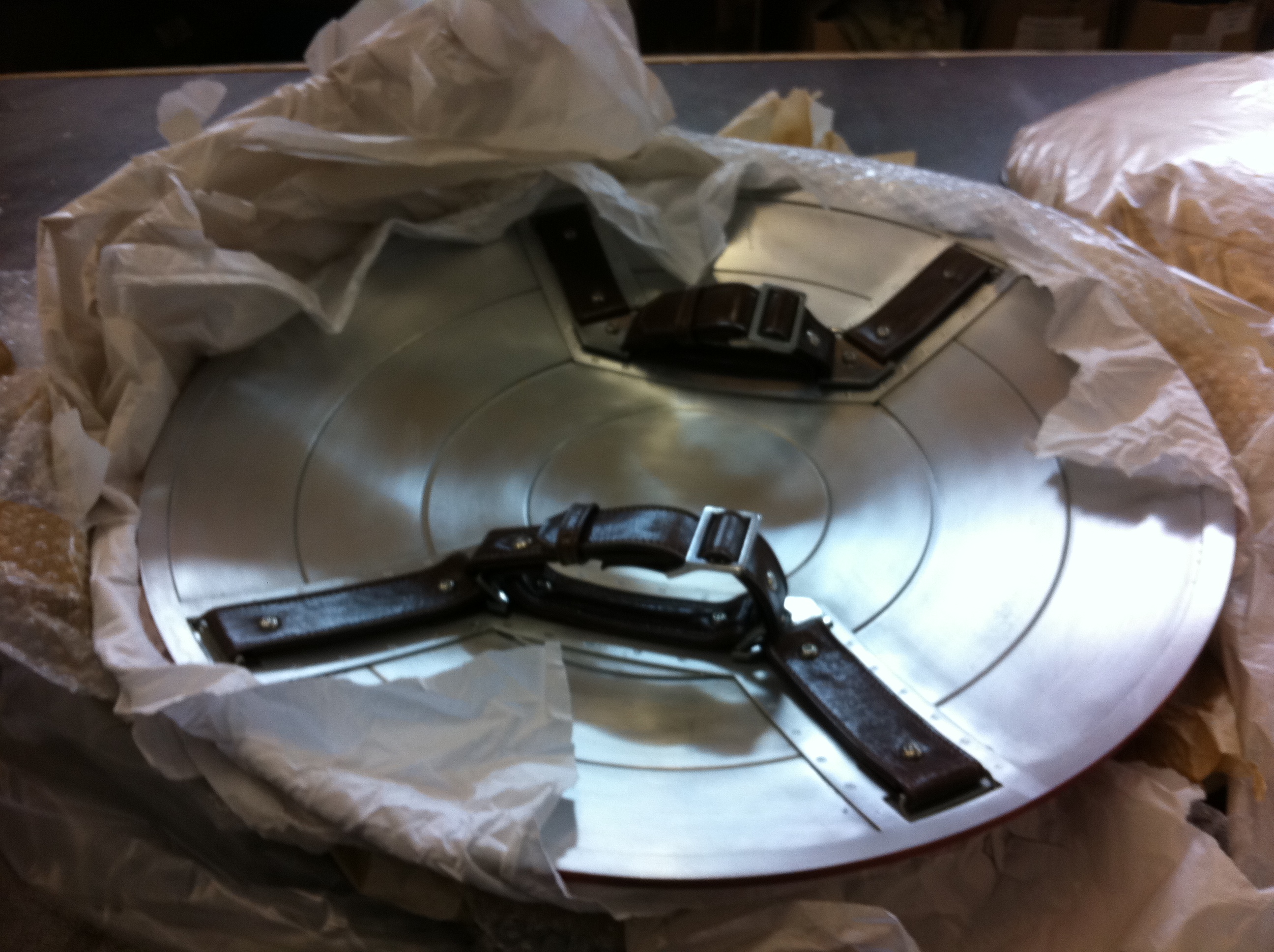

Yes. I can confirm that one is 100% the real deal. I packed it during production. I have many items pass through my work, and had the shields come through my work during the first avenger. There was 6 in total. 2 perfect ones, two battle damaged ones. That being one of them. Then a plain unpainted one. Then a plain one with a couple of bullet marks. The lower pic wasnt one. They were never set in like that. They were also not PAINTED. They were anodised. Fully anodised red. Then the silver diamond cut back. Then the blue triangles were anodised too. To me it looking like it was made of two pieces the shield was span and grooved on the outside.The inside grooves were placed in different places. The centre circle on the insode looked like a cap up close ( I assume to hide the hole where the shield is span on a lathe. Then the inner frame which goes round the outside and holds the handles are bonded. The inside is also painted a matt silver.....
They looked very very nice in person. Most props look poor up close.
This is what the perfect ones looked like not sank in.

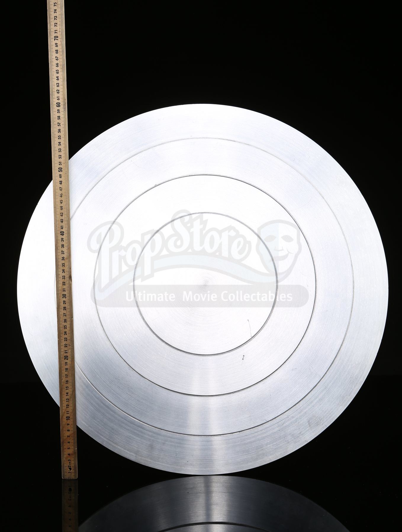

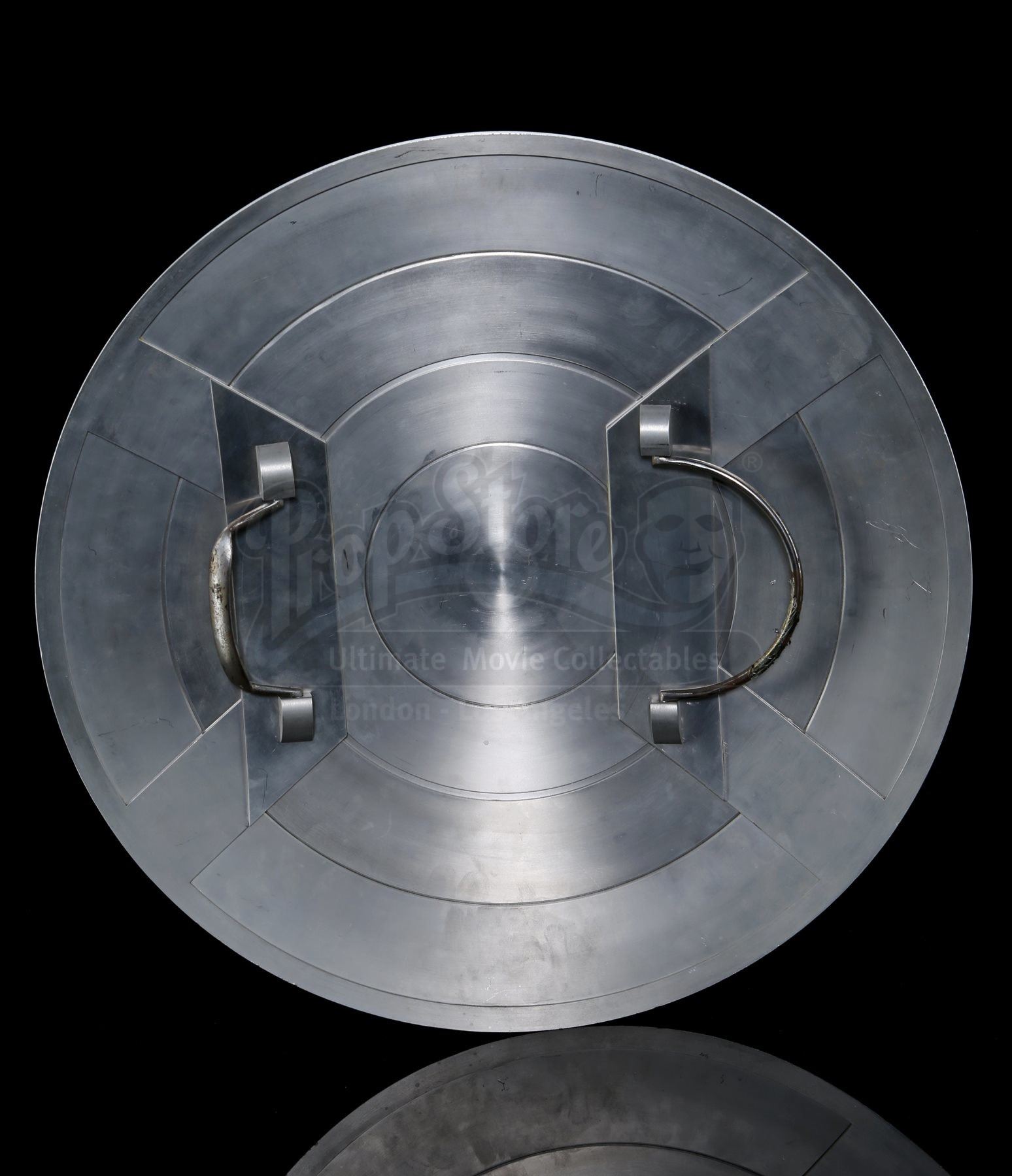

Any idea how thick this shield is? Or how thick each piece of metal that was assembled together is?
I'm talking to a local metal guy now about making one and it seems like he has the tools and skillsets to take this on however it's not going to be in the realm of cheap.
Trying to give him as much info as possible to get an accurate quote. I did request a 25" inch shield with the 9" star diameter.

So, if we're talking about making this the most accurate replica, why are we discussing a 25" shield? I was under the impression the shields were 24" or 26", correct?
Hmm I thought throughout the thread there was a concensus was 25"?
But that doesn't matter because I've actually asked him to revise to 24" as the prototype one that sold measured at 24"
I may be incorrect; I'm no expert on this prop. Still, it's my understanding that the TFA shields were either 24" or 26". Either way, I'll be interested if you can keep the cost in the ~$1000 range, like the Relicmaker example from a few years ago.
I believe the Hero shield in The First Avenger was 25" (though I may be mistaken) where the stunts were 24". The subsequent ones throughout the sequels were all 24". One of the shields used in TFA was indeed 26" but I don't recall which one specifically. I'm sure someone with better knowledge than me will chime in soon.

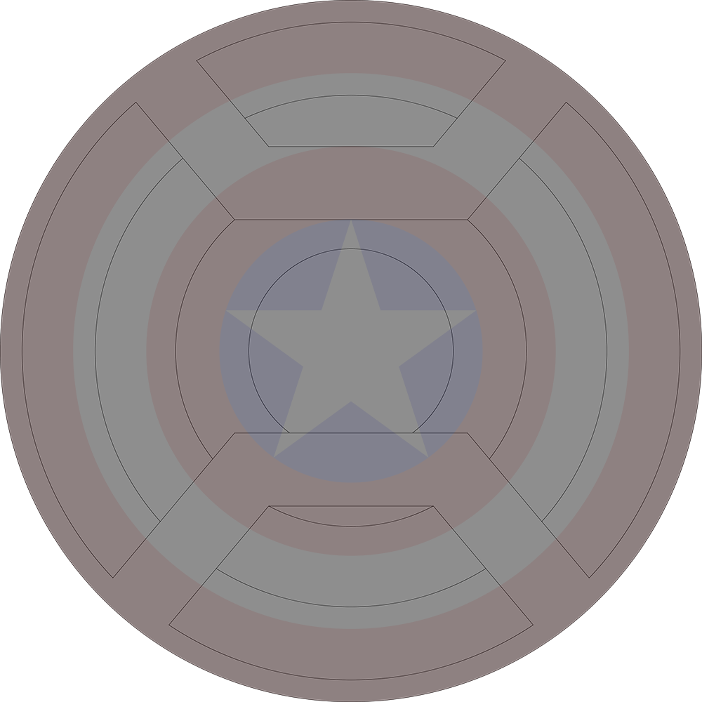

I drew this up years ago but the offset rings look to be so that the rings can stack on each other without falling through, with the center cap probably JB welded in place or something.
Also I'd like to think the bracket is set such that the star points the same way regardless of what arm is holding the shield, which makes sense from a symmetry standpoint and is something that very few replicas have gotten right except for the King Arts and Masterworks shields (and maybe EFX depending on their casting process).
Ratios correspond with a 24" diameter with 9" blue circle, photos below likely have some distortion from the camera but the numbers make sense
