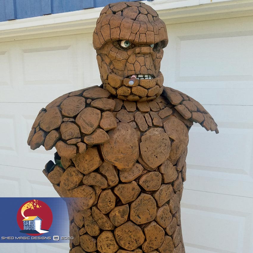

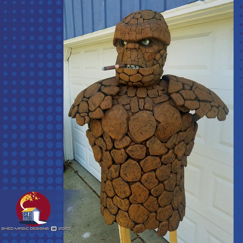

Very little update as work and weather hasn't allowed to make much progress. But I am back at it now...
Today is about painting and working textures on the body...
Enjoy!

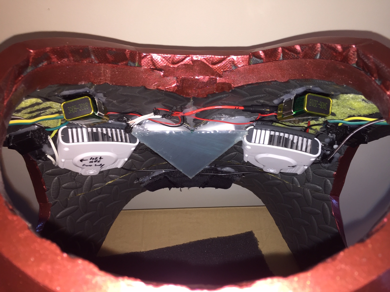

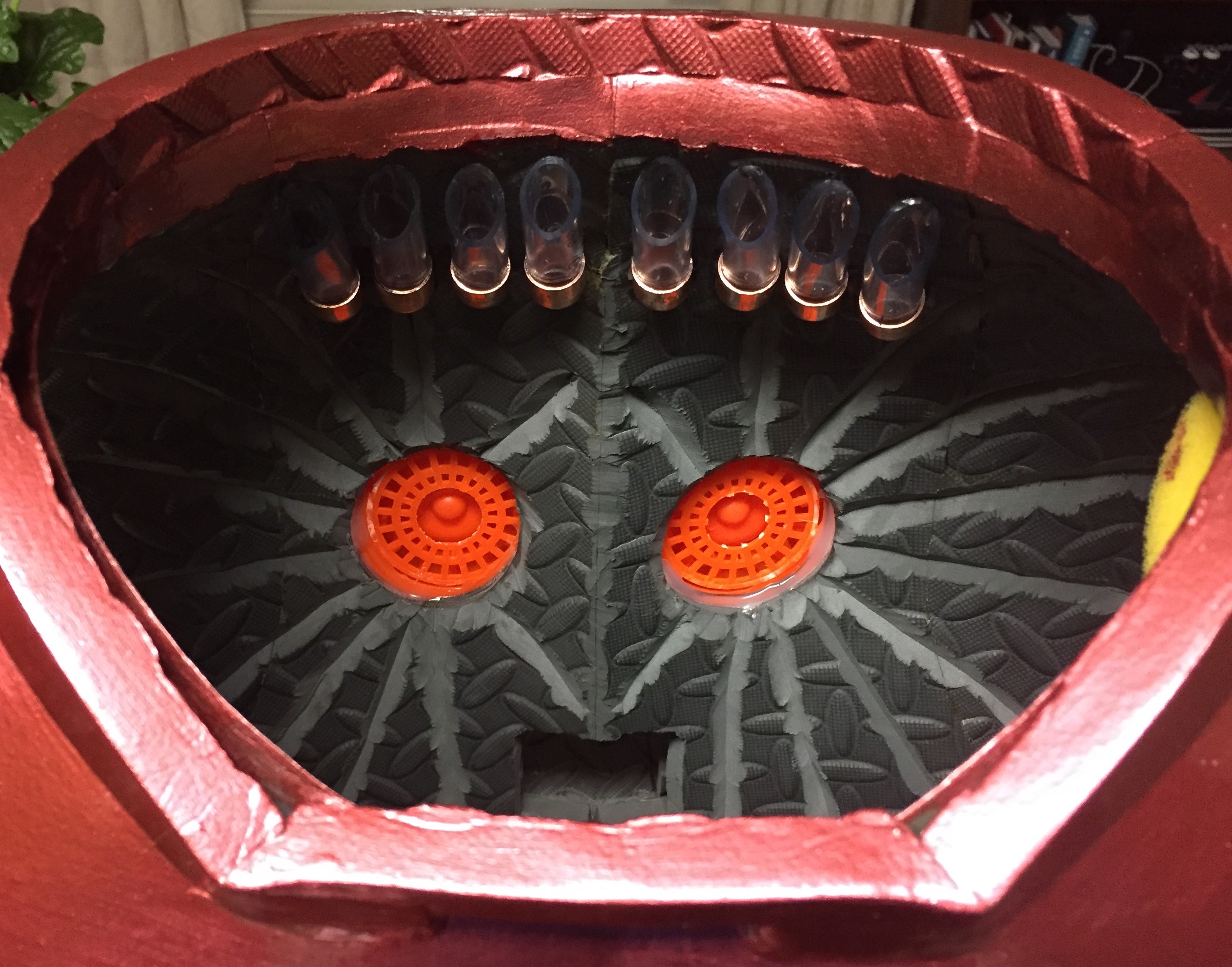

I plan to build a ventilation system for mine, using 4x 6V fans sending air through tubes with air being released from 1/8" holes along the lengths. Long story short, it will be a variation on what I just used to great effect on my comics Silver Centurion Iron Man. The tubing will run under a water-wicking base layer.
On top of the base layer I plan to add upholstery foam muscle shapes & bulk, for my first time.
Thanks for any tips you can provide!
