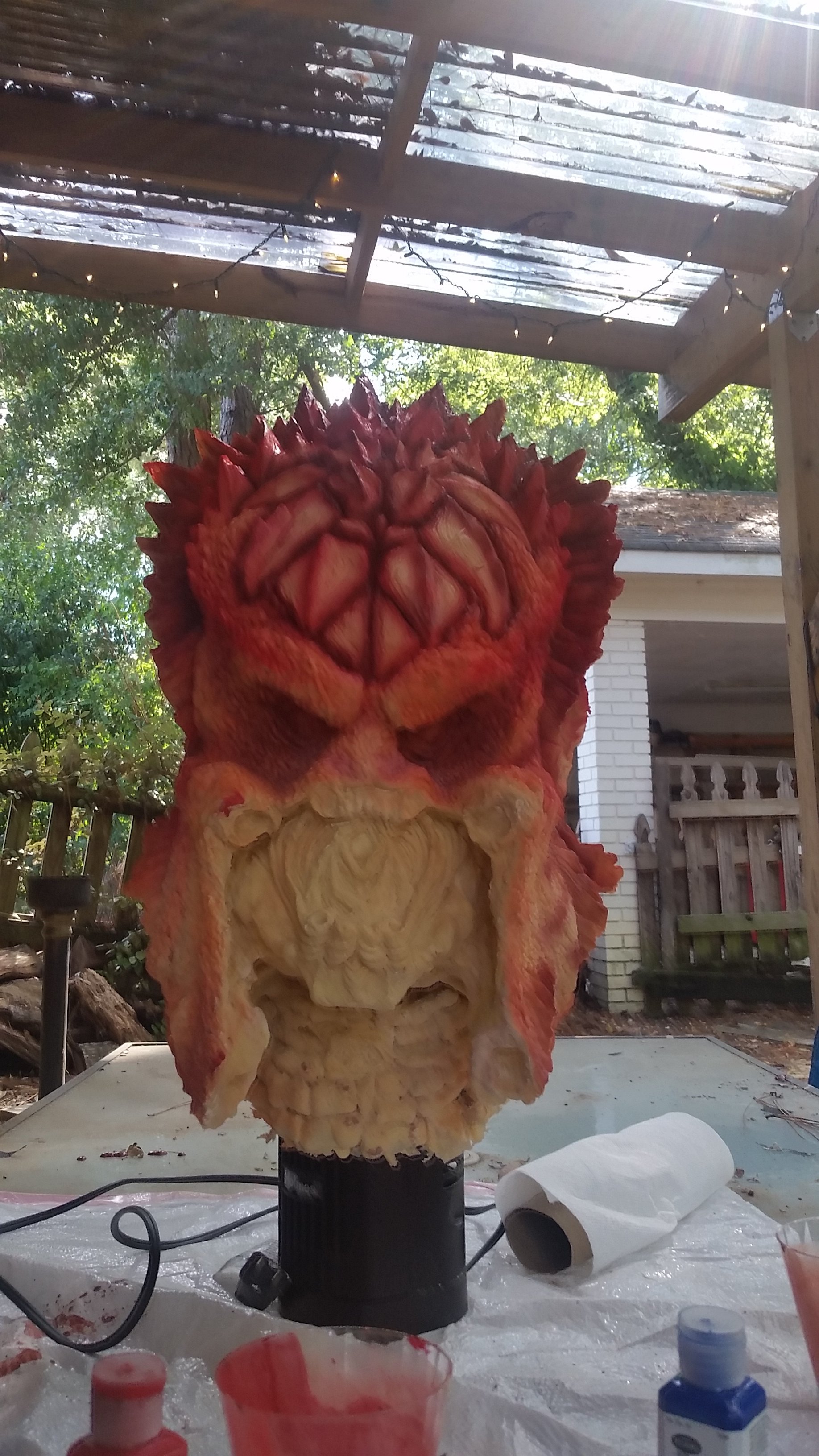

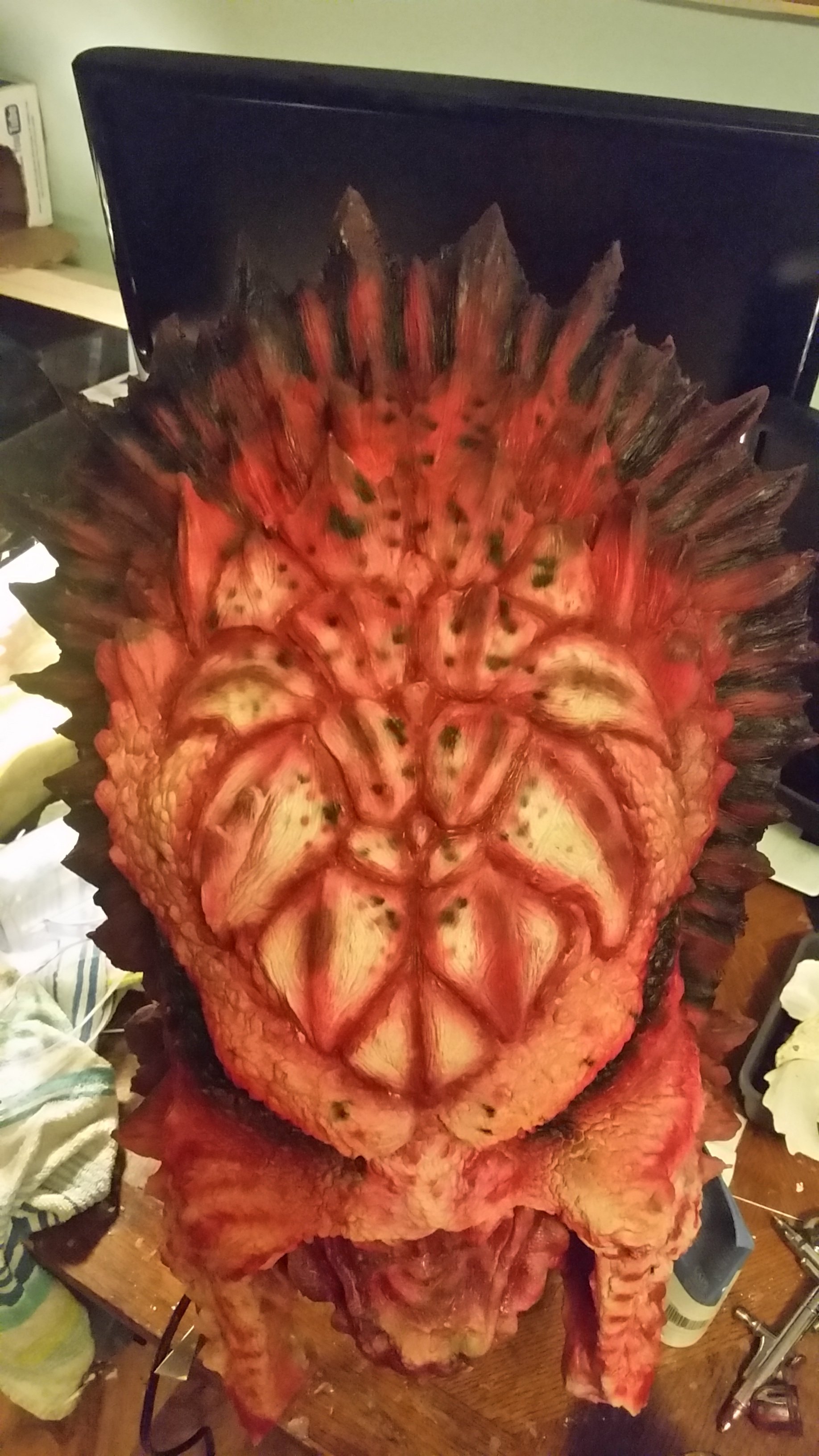

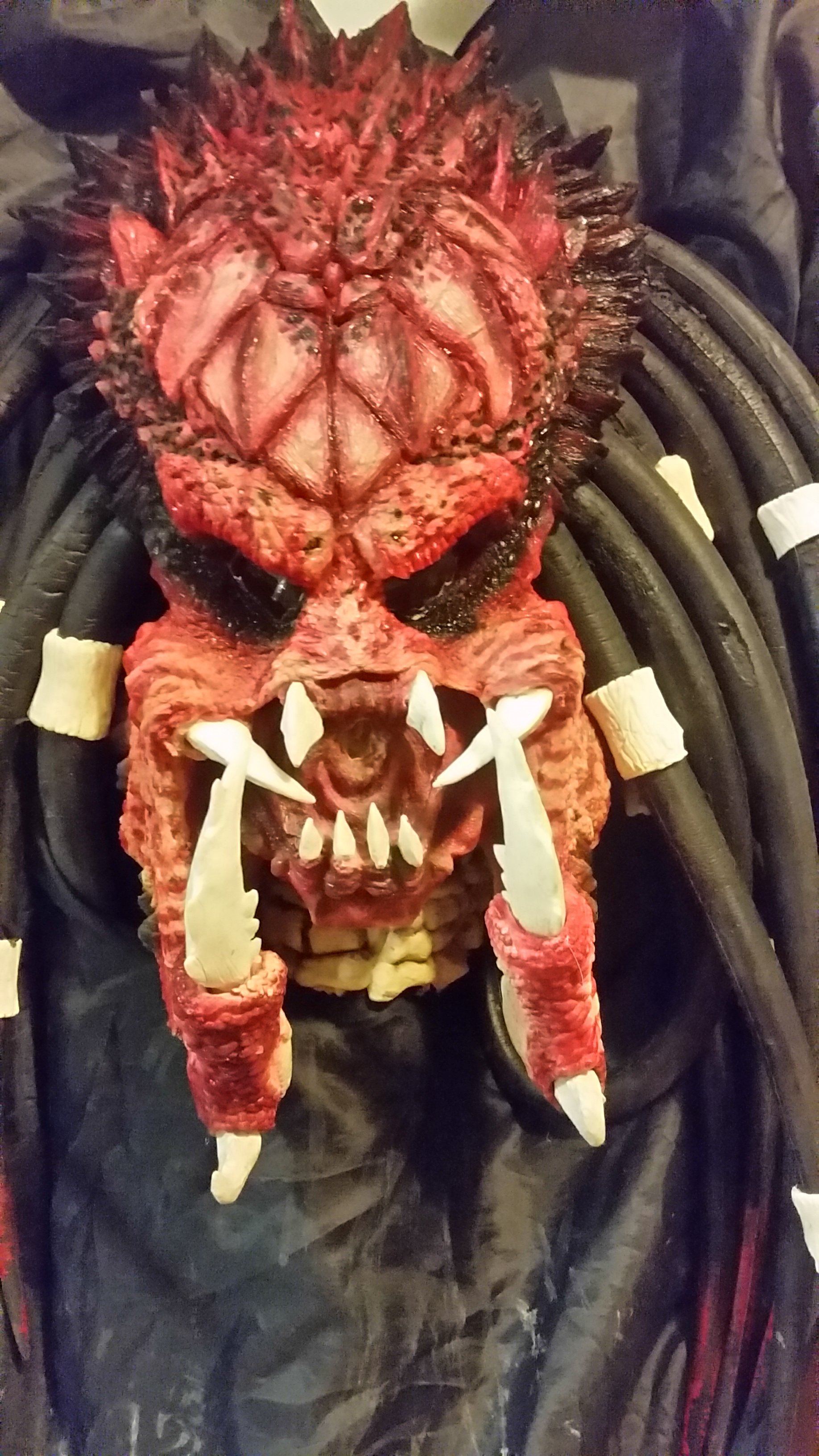

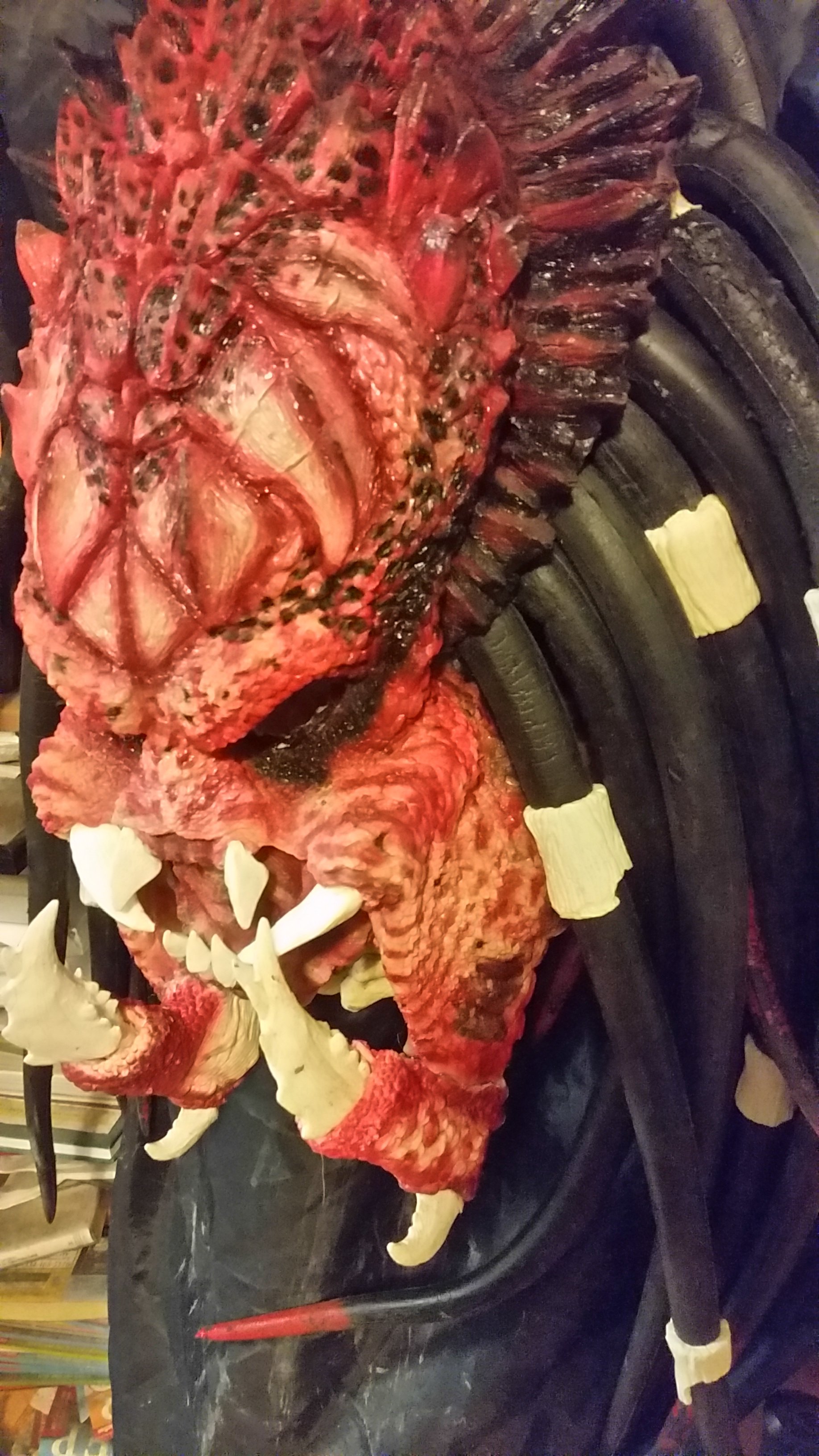

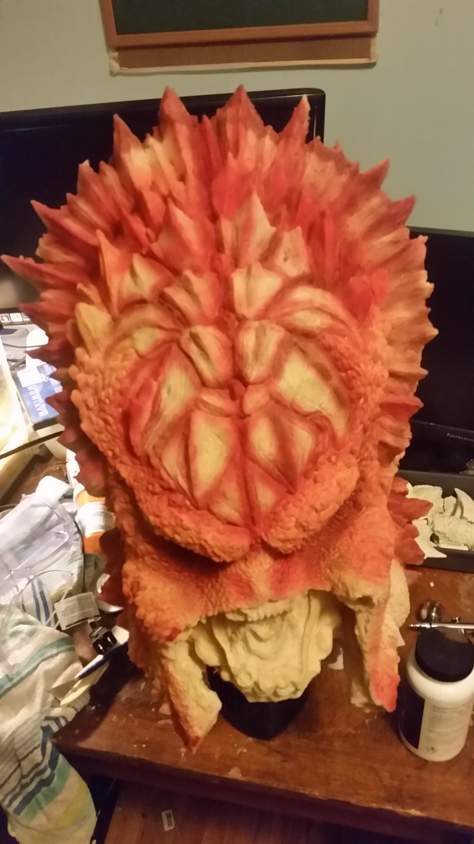

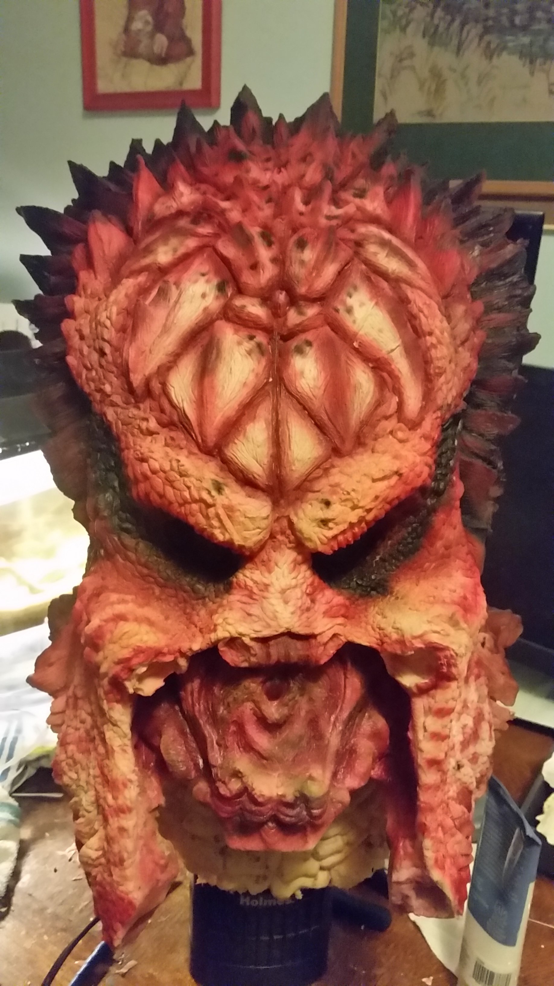

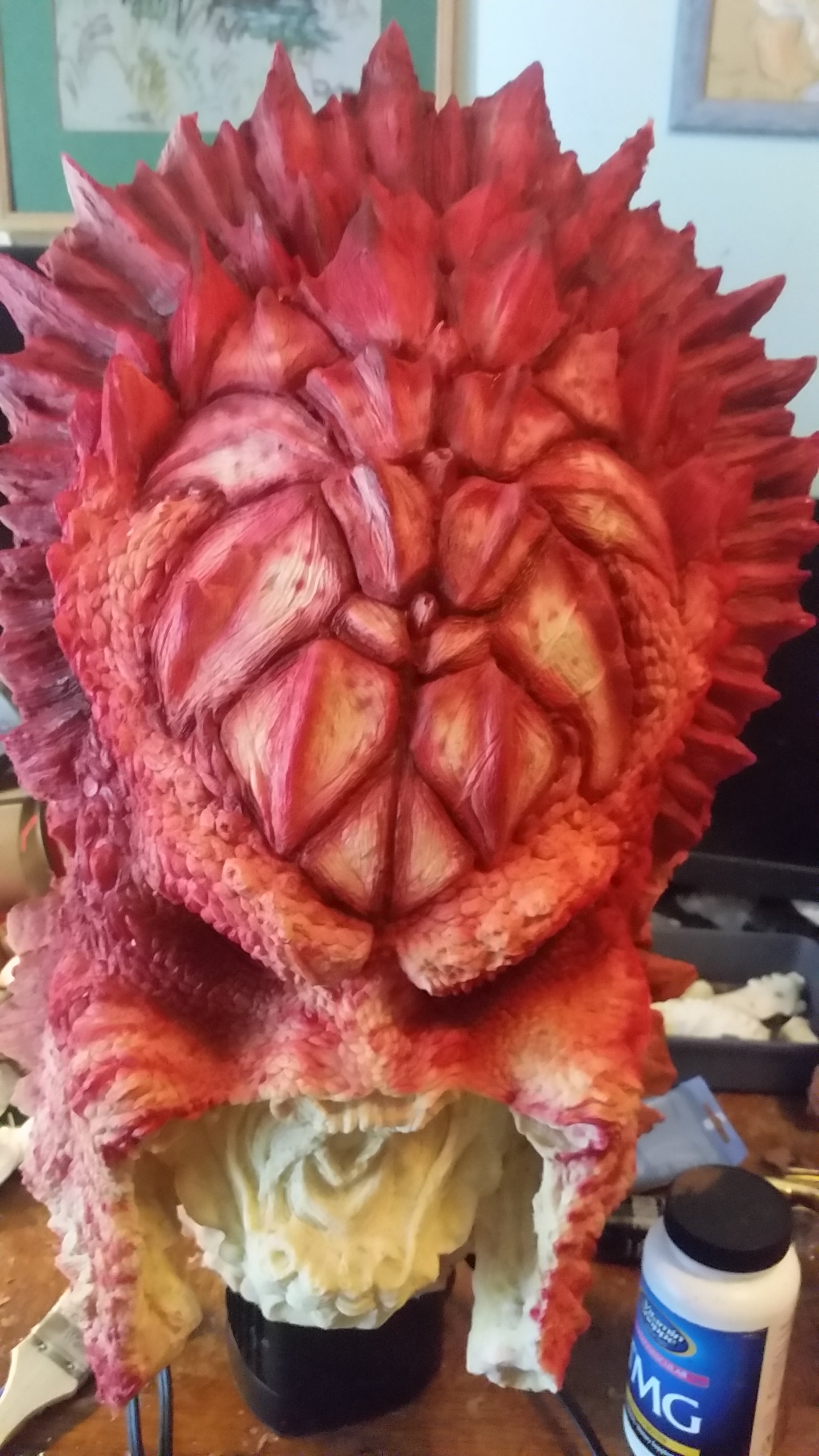

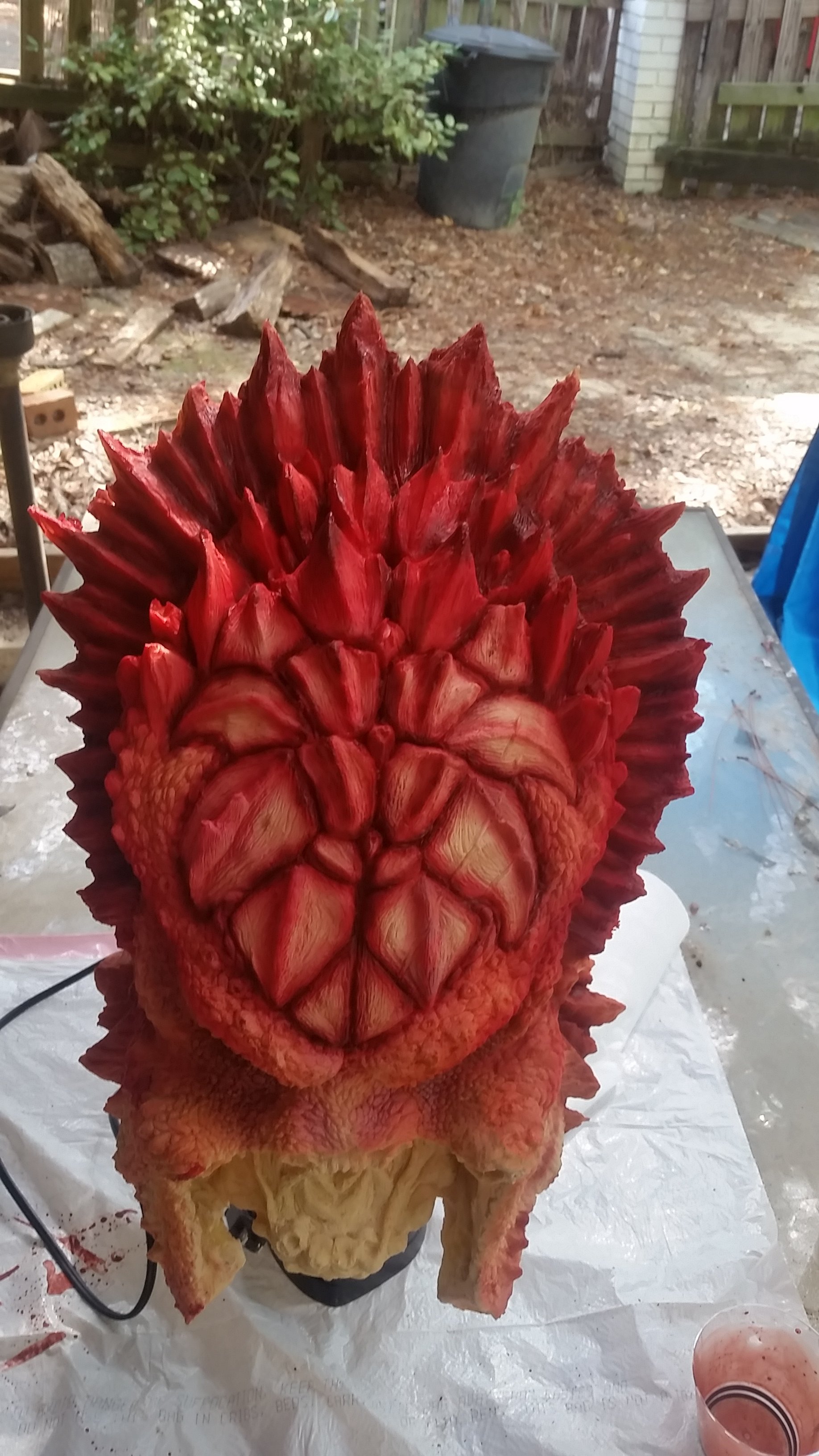

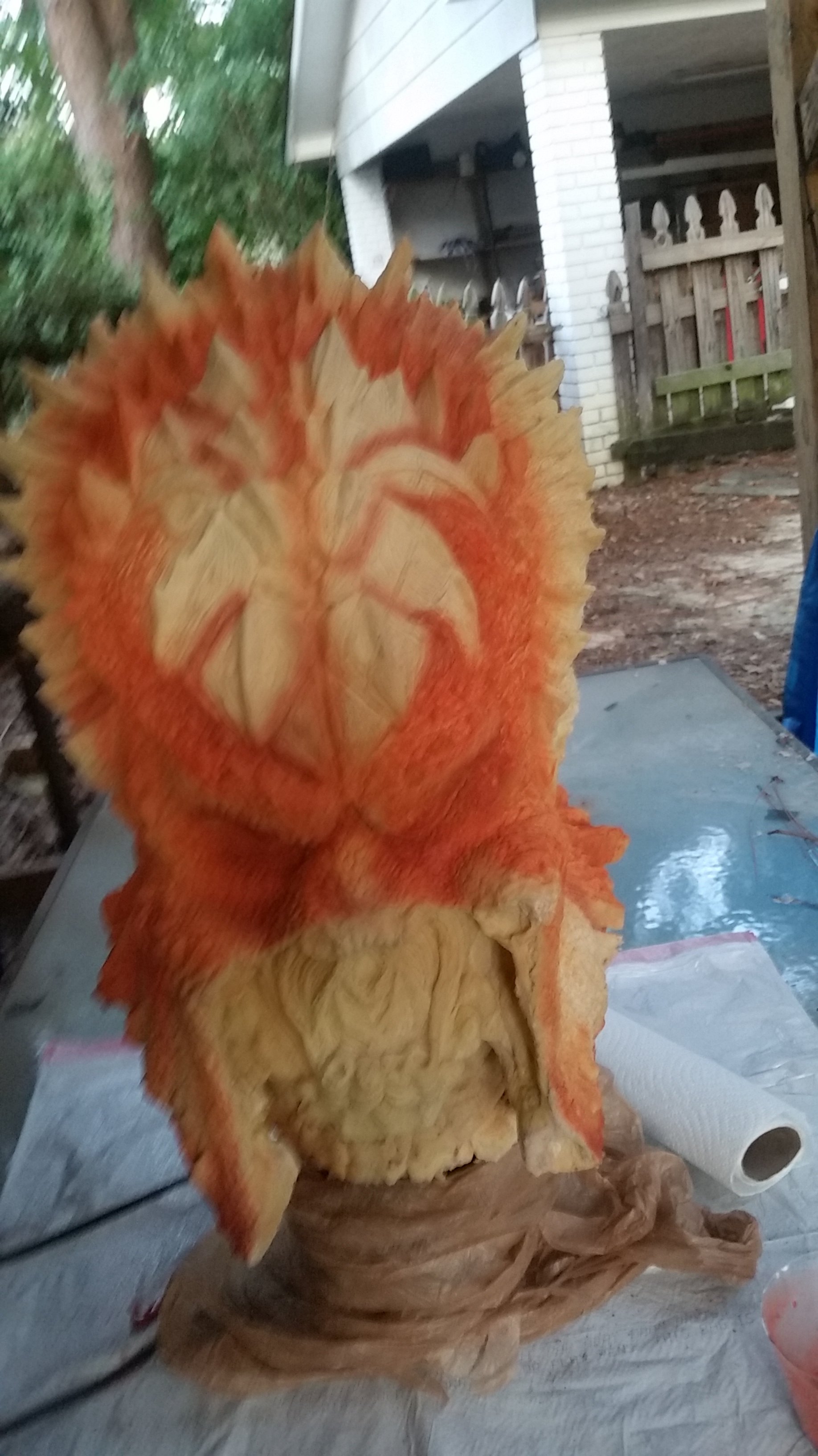

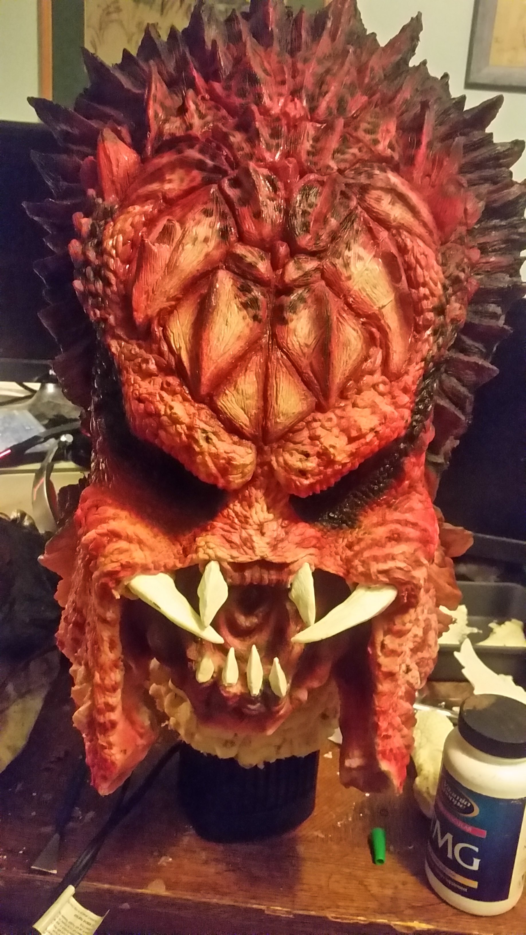

Anyway, let me drop some progress XD
This is it for the most part. Will be doing more work on the spots, unfortunately it got too dark for me to see well enough to continue for today
Thanks !!
To me molding was infinitely more scary lol airbrushing is rather forgiving while you are working with the light tones in the beginning.
That's it..you've left the old man in the dust... >.< Was catalogue season again for the last 2 weeks.. didn't touch Isu at all.. LOL
Love the colours bro!!! (y)(y)(y)
