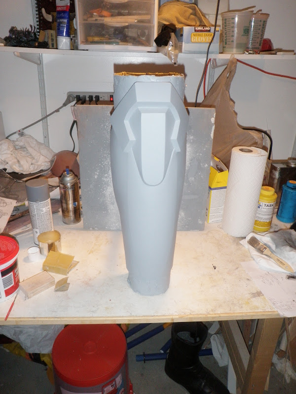

Here's the chest and leg piece ready to be molded. I did a 60/40 split on the mother molds, which seemed to work pretty well.
Due to lack of time and the boot covers already starting to get bulky, I (reluctantly) eliminated the side details. I don't think you're missing much in the final product, though. Especially since it's all flat black.
I used smooth cast 300 and 325 for the shoulders, forearms and boot covers. Task 13 for the chest piece for some added flexibility. I'm very pleased with how well all the pieces fit. My tedious measurements payed off! :)
Everything is attached using suspender elastic and pop rivets. The boot cover was getting too bulky, so I cut off some of the plastic near the bottom and tapered it up. this exposed more of the boot. you can probably see it if you look closely at my previous post with pics.
