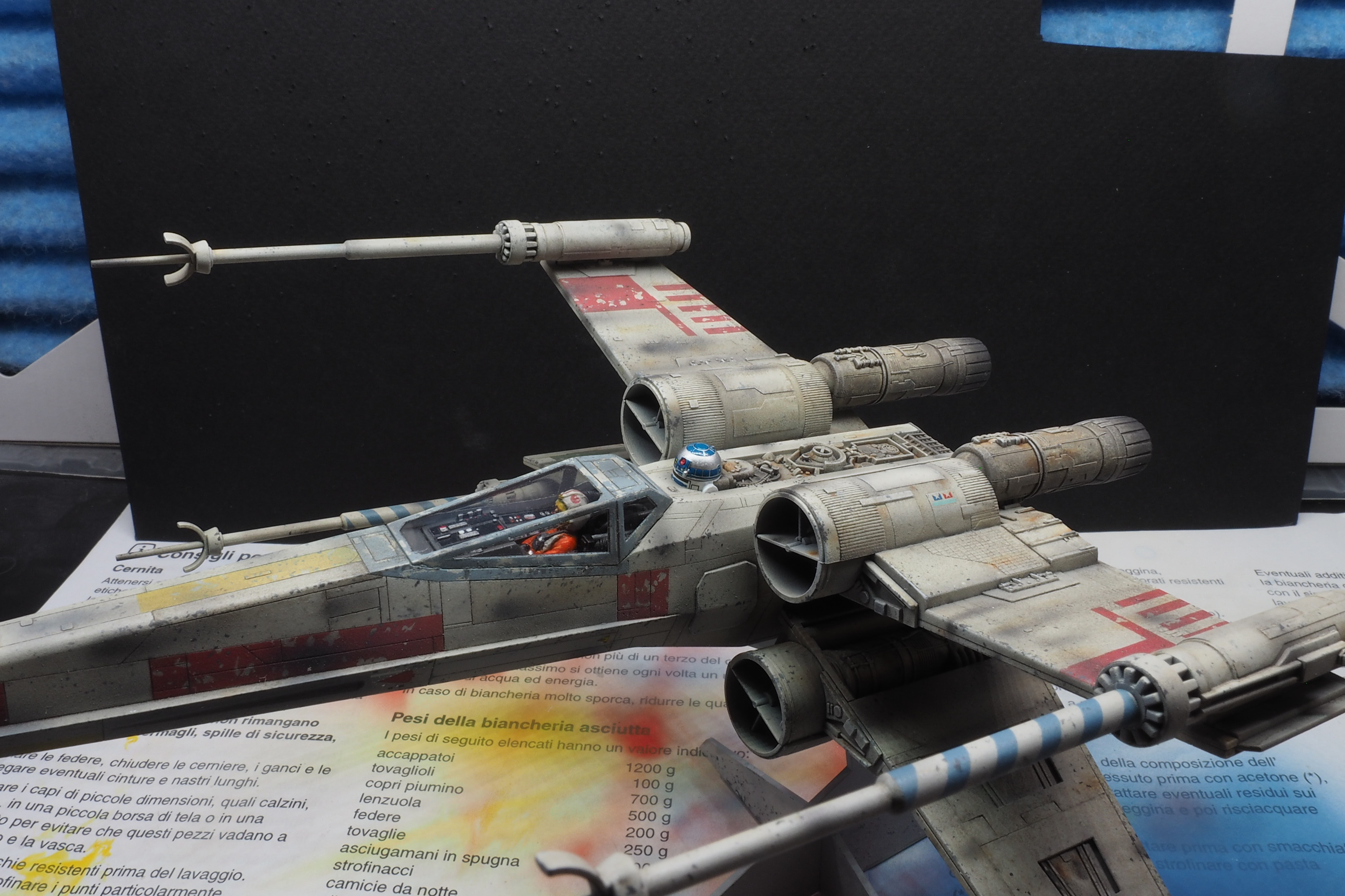

I always use tamiya acrylics and yes, there is a real bluish tinge after you basecoat. However, once you weather it, it's a whole other bird. In fact, I think it helps keep things from looking too brown.

I had Hunk a Junk's same problem after black base and white Tamiya: slightly cold tonality (almost blueish), this thing drove me crazy! But Astroboy is right, after the application of oil filters (discoloration technique) the blue shade has gone.
