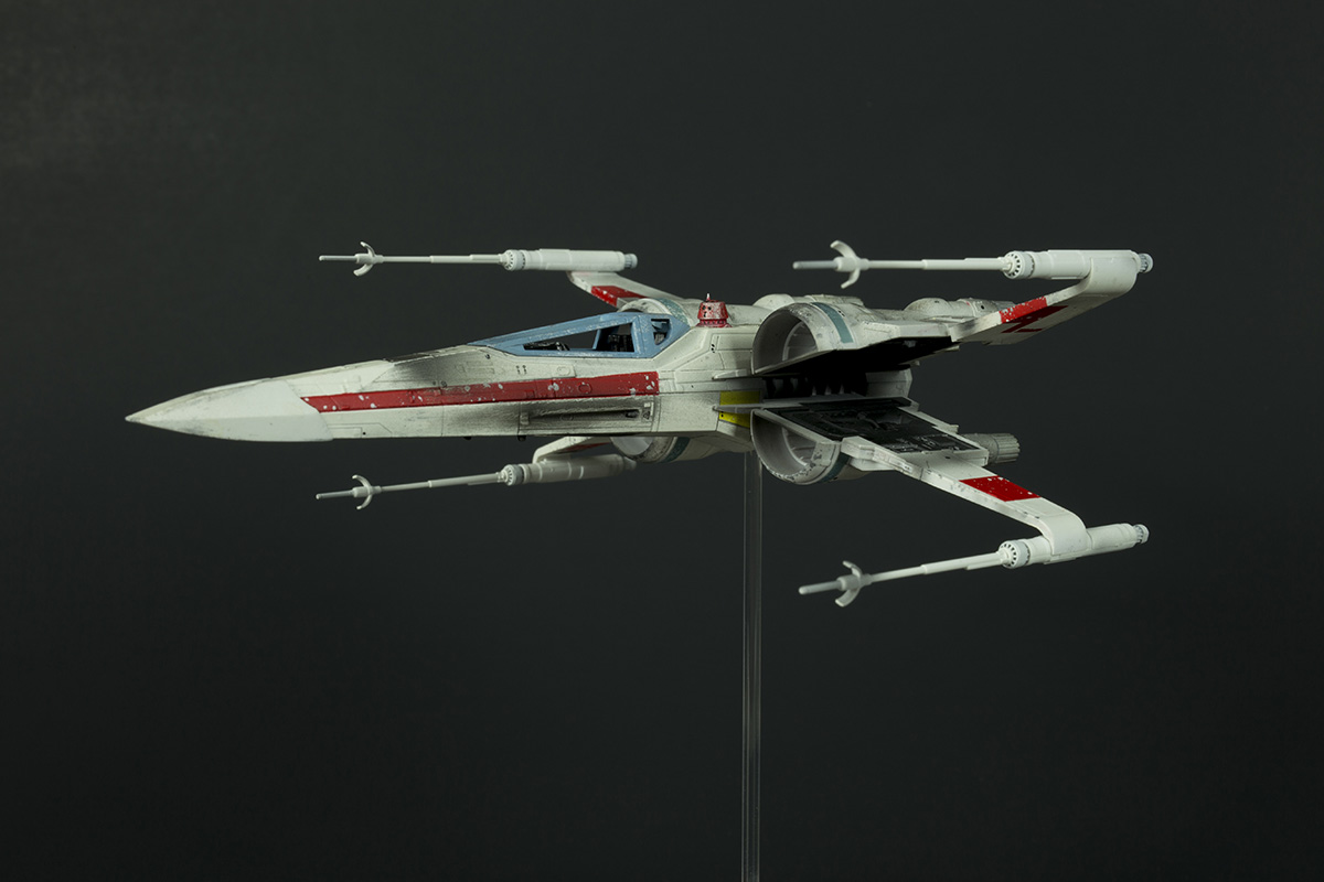

here's my bandai 1/48. you tell me. are they too thick? I can't tell any more. I've looked at it too much
the 1/48 looks better
Bandai's 1/72 x's on the other hand are very noticeable. It's not really the depth, but the thickness of the lines. Also it doesn't help having the different pieces needed so they can mold the plastic in color creating an even larger looking gap. It's the same thing with their 1/72 Yamato fighter kits.
Actually the panel lines and thickness of some other parts gets worse the smaller you go. I know some of is overly exaggerated so you can see the details, but it winds making it look odd, especially if you use a dark wash. Compare the Panels lines for example on the 1/500 Yukikaze vs the 1/1000 one from Bandai. The 1/500 one from Fine Molds actually has finer panel lines and thinner fins than the Bandai 1/1000 one
Its the one knock I have against Bandai's otherwise stellar kits
The panel lines on the 1/48 X-wing aren't too bad at all. They might be slightly thick, but that's just nitpicking at that point. As said above, the 1/72 scale kits are really the ones where the panel lines were too thick. I was able to knock back the panel lines on my T-70, and it looked much better for it.

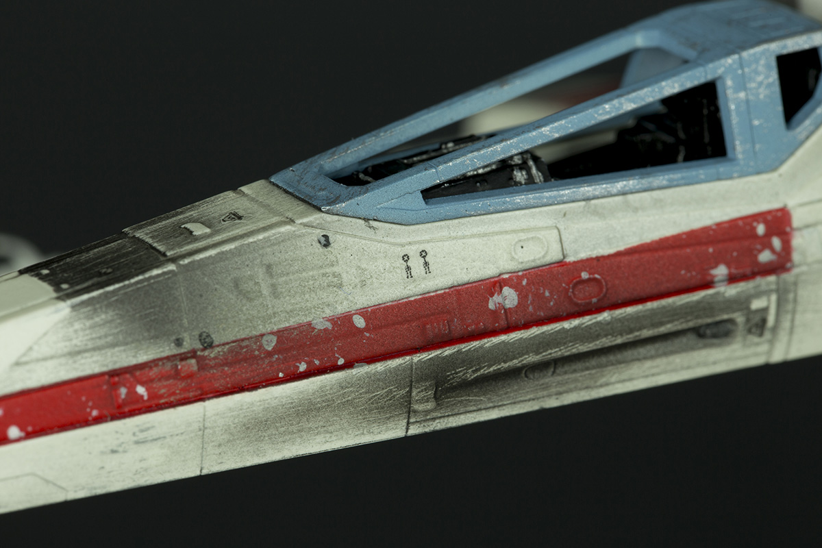

I would love to see a close up pic of that...
These are the best photos I have on hand, so I apologize they're not super close-up. Have you built the 1/72 T-70? If so, you'll have noticed the massive gaps towards the mid/back on either side of the cockpit where the (originally blue) stripe continues towards the back. I filled those gaps, as well as a gap that occurred when you actually snap the fuselage together, just in front of canopy frame. Actually, I think it's the second panel line in front of the canopy frame. Can't really remember now.
