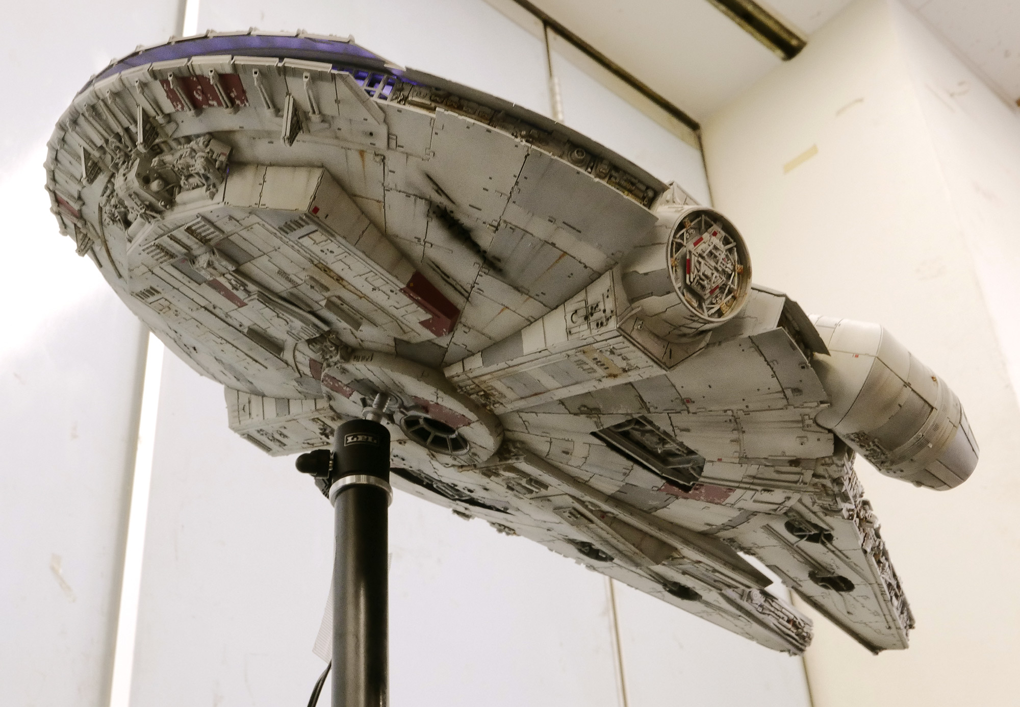

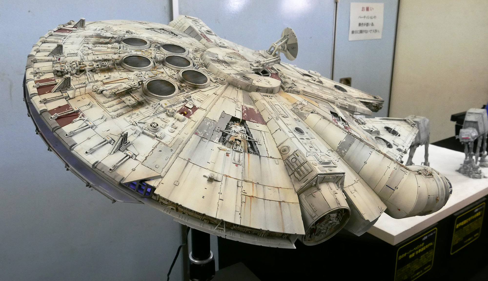

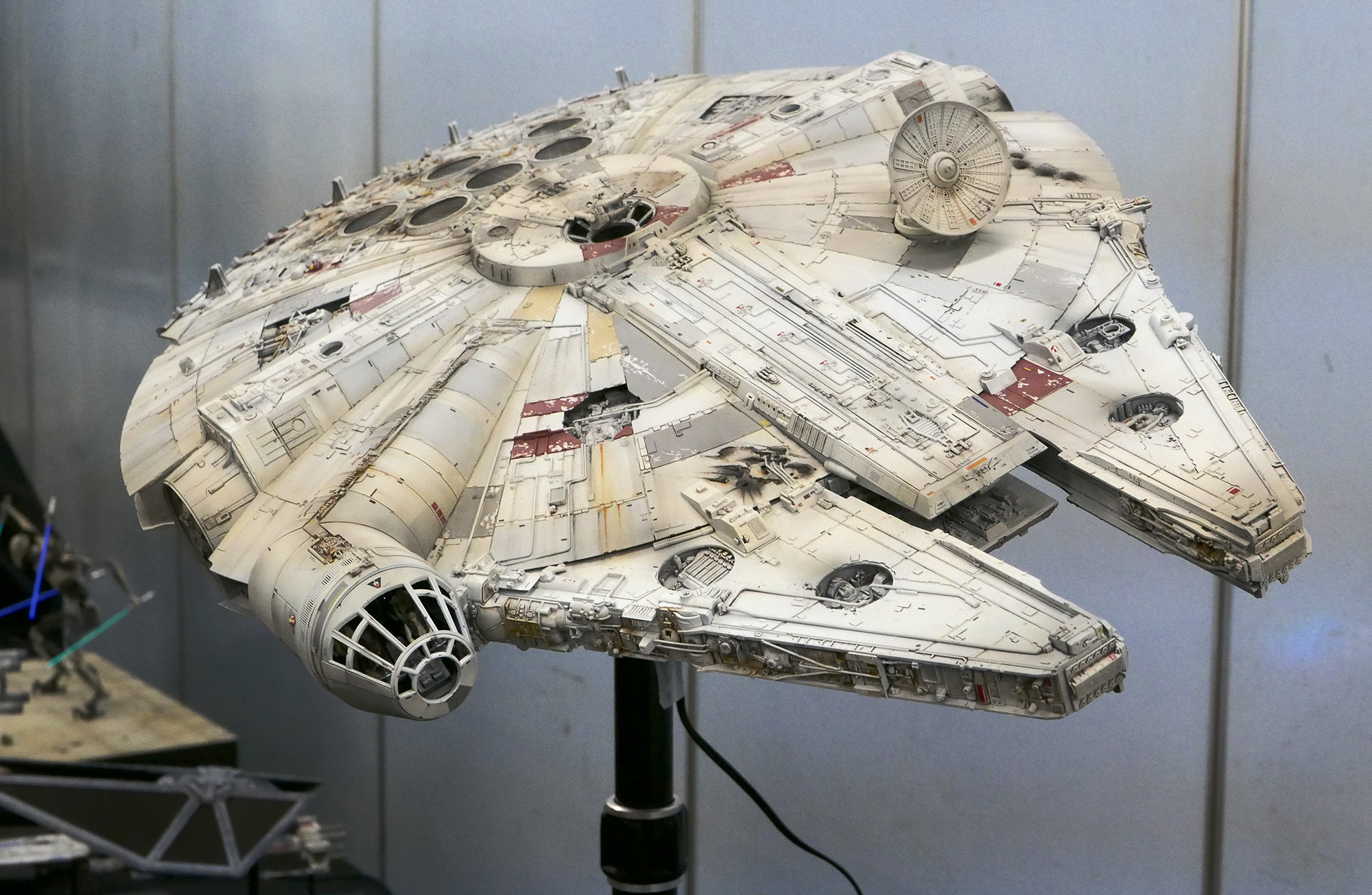

I went to a self-organized exhibition of a group of modelling enthusiasts today, and they had a finished perfect grade Falcon on display.
View attachment 764403View attachment 764404View attachment 764405
Anazing work on that Falcon.
Btw, does anyone where to get those type of stands, or what they are called??

Obviously, whoever set this up is a filmmaker or photographer. It looks like a light stand with a grip swivel on it. I guess they glued a 5/8ths bolt (or a tripod quick change socket) inside the body of the Falcon. With this rig, the model is easy to move into many poses. The downside would be that the light stand legs would take up a lot of room on the floor. I think it would be fairly easy to build tubular mounting points into this kit from the rear quarter or the bottom, so you could have a choice of the mounting rig.

Thanks Sourdoh, ive been thinking if adding this to my 1/72 falcon and my McQuarrie X Wing.
Only trouble is that o know those swivel mounts occasionally get loose. Hate to have it give out.

You should be fine with something as light and small as this Falcon. I use swivel ball mount stands on my much heavier SS Y and X wings with metal armatures with no problem.

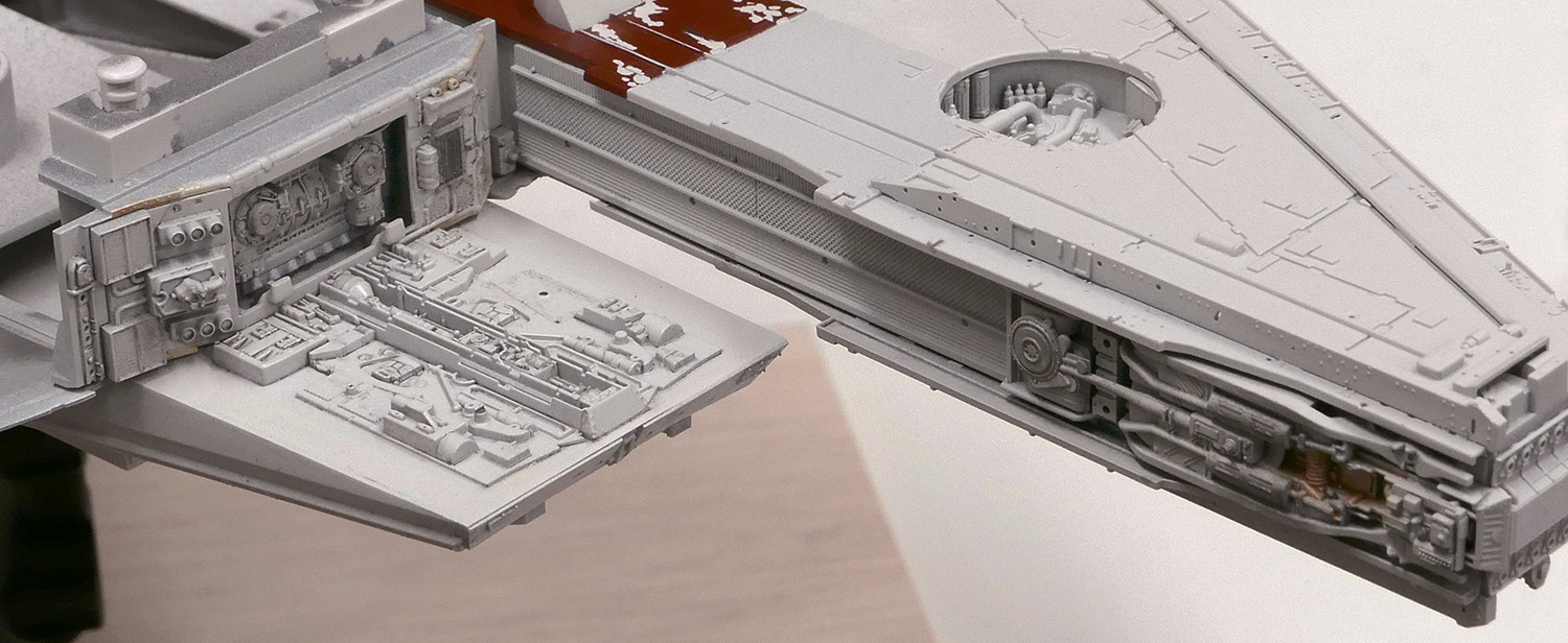

One of the great things about this kit, is that during the assembly, there are tons of instances where you get to gaze the ingenious details of the Falcon from forbidden angles.

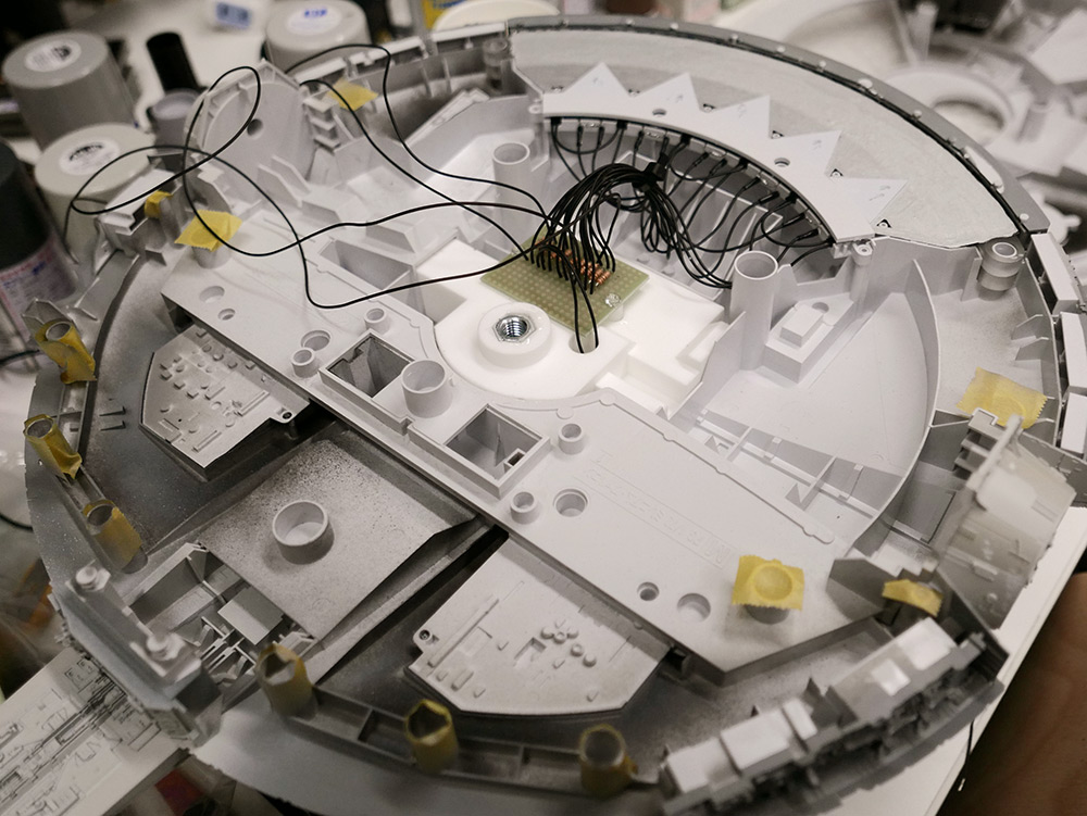

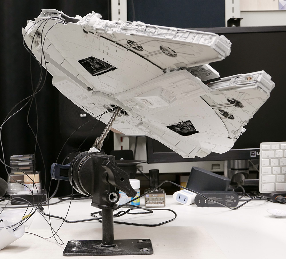

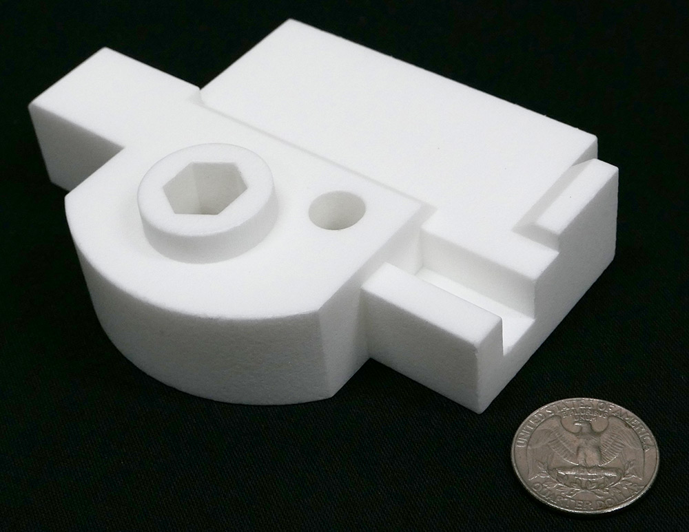

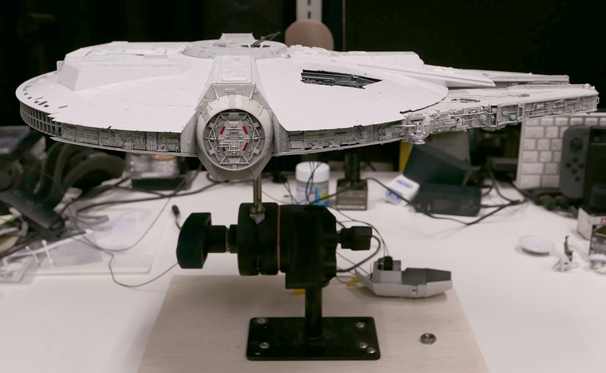

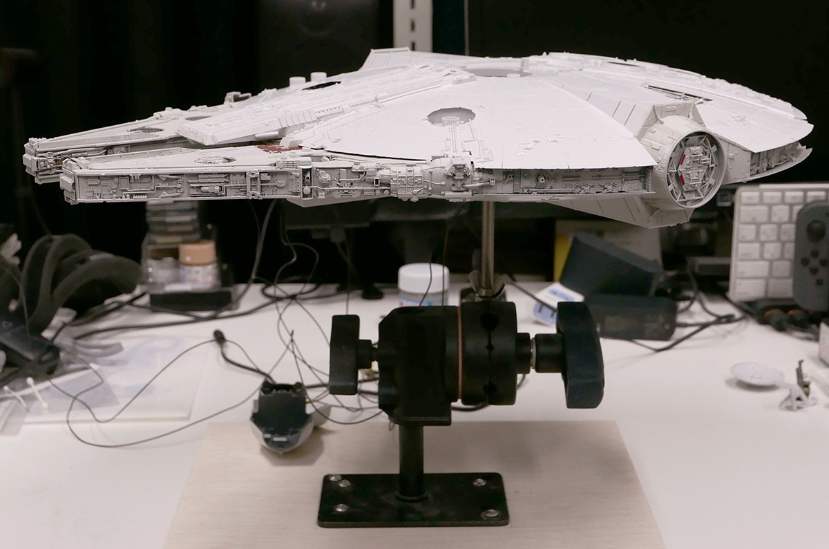

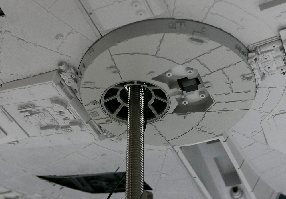

I have added a mount to replace the kit stand.
I did some measurements and 3D-printed this in nylon...
... in which a long-nut was inserted, and simply glued to the lower hull like this:
I have sacrificed the lower gunport interior, but not the window frame (The turret may be placed if the mounting rod is unscrewed).
I know that I could have used a less bulkier mount if it were just for static display purpose, but I wanted something reliable to go through the building and painting process.
The grip head shall be replaced with a much lighter stand when the model is finished.
Once you start assembling this kit, you realize that you need to think of ways to securely hold the body upside-down while you paint the underside.
I have designed the mount so that the rod can be screwed both ways, until the upper gunbay interior is glued for good.
The temporary grip head enables the body to be held in desired angles during the assembly and the painting.

This is fantastic Lab! I like how the structure of your mount interlocks with the given nooks for stability.
