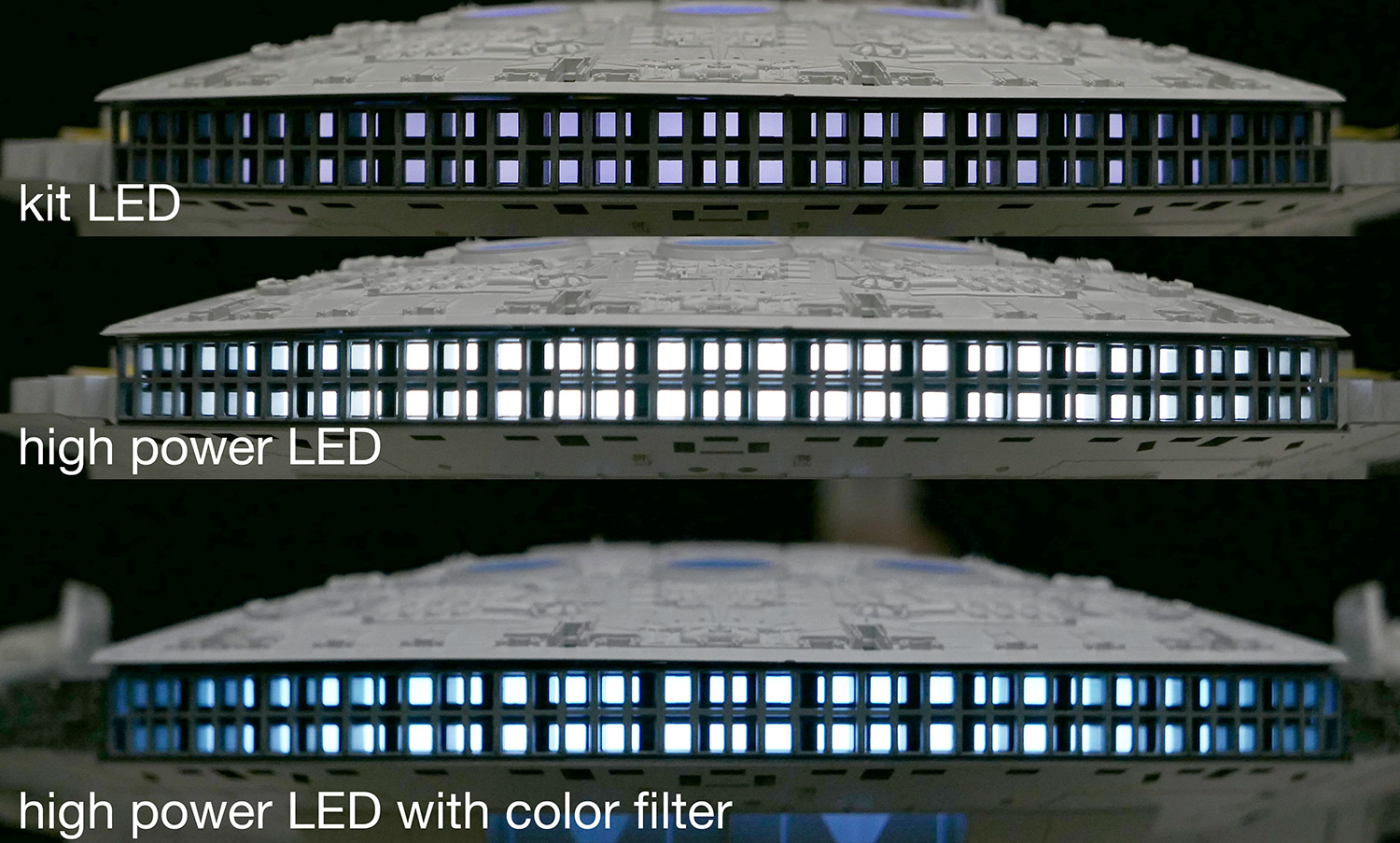

A little update on the engine lighting mod that I have been doing.
Lights emitted by LEDs tend to have a "spiky" spectrum, which is difficult to capture in photographs but makes your eyes feel a noticeable LED-ishness.
White LEDs tend to have a slight violet tint, which is also present in the kit engine LEDs (the kit's landing gear and cockpit light LEDs are whiter).
By replacing and adding the engine LEDs, the tint was virtually washed away by the brightness, but the LED-ishness was still noticeable.
So I experimented with several LED filters that are used in studio lighting, and decided to implement this to several of the LEDs.
https://www.pnta.com/lighting/gels/lee/lee-filters-cl132-cool-led-medium-blue/
This had the effect of reducing the LED-ishness and adding azure-blue tint.
I have always felt that blue LEDs do not give the desirable effect for the Falcon's engine lights (to my taste).
They just seem to look like blue LED lights, not blue emission from a jet exhaust.
Its difficult to convey in photos, but by using filters, I think I have got it close enough to my liking.

I wonder if the lights are picking up the tint of the white plastic. Maybe if you painted the grills a flat white the hue would disappear further?

I don't think the plastic has much to do with the tint of the lights. I painted the inner side of the grills with silver to ensure light sealing and to disperse as much light as possible.

Filters designed for LED spectra - ingenious solution!
