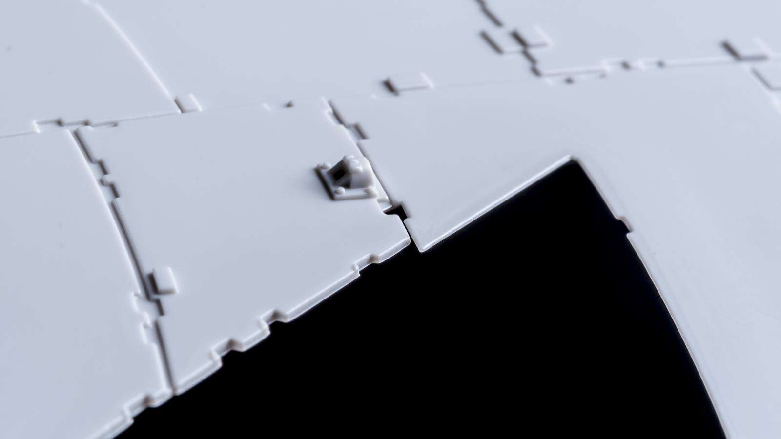

Funny you bring up the hull plating. It is one of my few complaints I have about the Bandai. The edges are somewhat beveled and not very sharp, specifically when looking at the gaps in between the hull plating. I realize you are referring to the thickness, but none the less not too sharp on the Bandai.
I'd categorize fixing the bevel as 'clean-up' more than modification. A file, a little sandpaper, maybe a scrape with the back edge of an X-acto blade should handle that in no time. Some of the plate edges will need warping and distressing anyway, so it's no biggie. We have to put some work into this model! :lol

Are you saying that you feel the edges are "not very sharp" after seeing the actual parts with your own eyes?
Not sure what you mean by my own eyes? If you mean having the kit in hand, I do not. If the actual kit is anything other than the photo I posted please share.
No doubt. Just trying to share an objective view of the model overall. Pros and cons, so the info is out there. I'm not the type that sees something that I really like so much that I am too blinded to point out its faults. I was a little bummed about the sharpness of the plating though. But like was said, must be part of the process of production. The pros far outweigh the cons, I can't wait to get my hands on this kit.

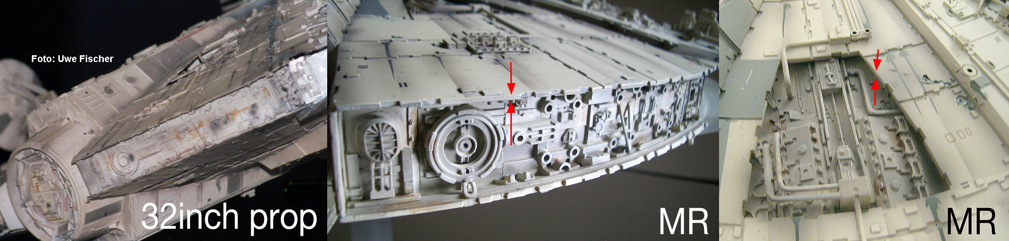

I may have made myself misunderstood when I said "thickness of the hull plates." This is what I was referring to:
It's nothing about the 5 foot model having more detail. It's precisely about how the MR replicates the 32inch.
I am not trying to criticize the MR, but if you call this "accurate," compared to this, the edges of the hull platings of the Bandai are much sharper and true to the original, even without taking into account that the Bandai model is half the size.

What I meant by "with your own eyes" is "not through photos shared on the Web but by seeing the actual parts through your own eyes." Those photos were taken with macro lenses. Any detail which look razor sharp to the eye shall start to look dull when magnified to a certain degree.
The kit does have edges which are beveled due to molding angles, but compared to other Falcon kits, this kit is engineered to make them fewer and far less prominent (to the eye). I think this fact shall also become clear when the kit reaches you.
Also, I am not trying to say the kit is perfect or faultless. That's why I've been posting my mods.
I am just trying to clarify for the sole purpose of me understanding your point, and if I understand why the MR Falcon is in this conversation, it is to say that the 32 inch MR as a 1:1 representation of the studio model has armor plating thickness that is too thick (no argument there), and that the Bandai's armor thickness has been scaled down to the proper thickness on a 1/72 scale based on the 5ft model? I say bring out the calipers. If it's proportionally the same I'll shut up and eat my words. I'm willing to bet that that the Bandai's armor thickness is too thick based on it's scale too. I don't see how you can make a model that scaled down and maintain the proper thickness of it's armor. It would be extremely fragile.

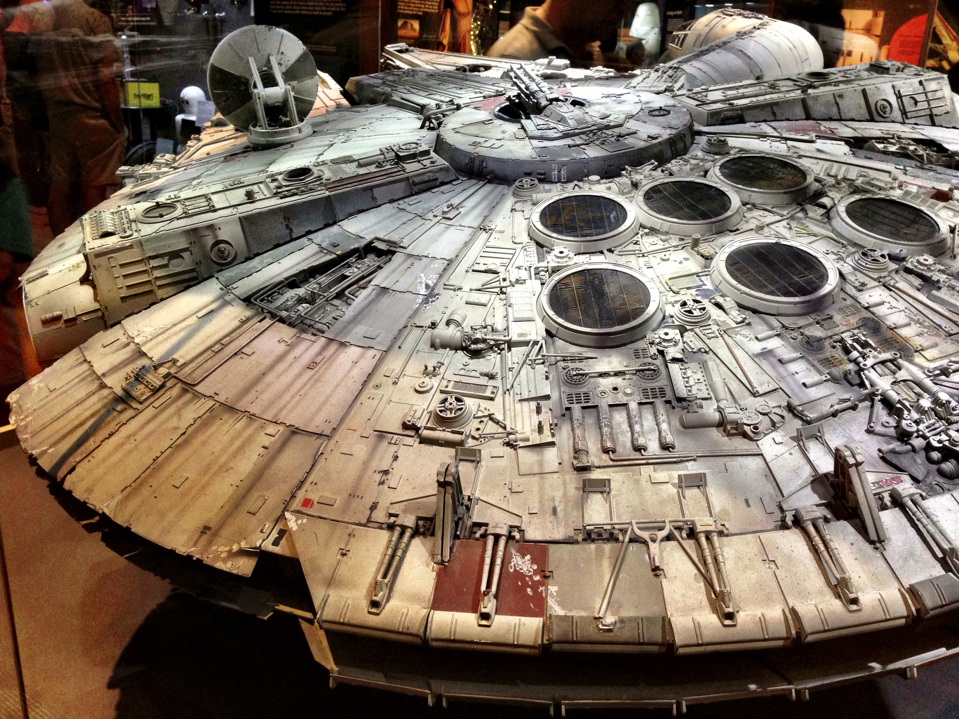

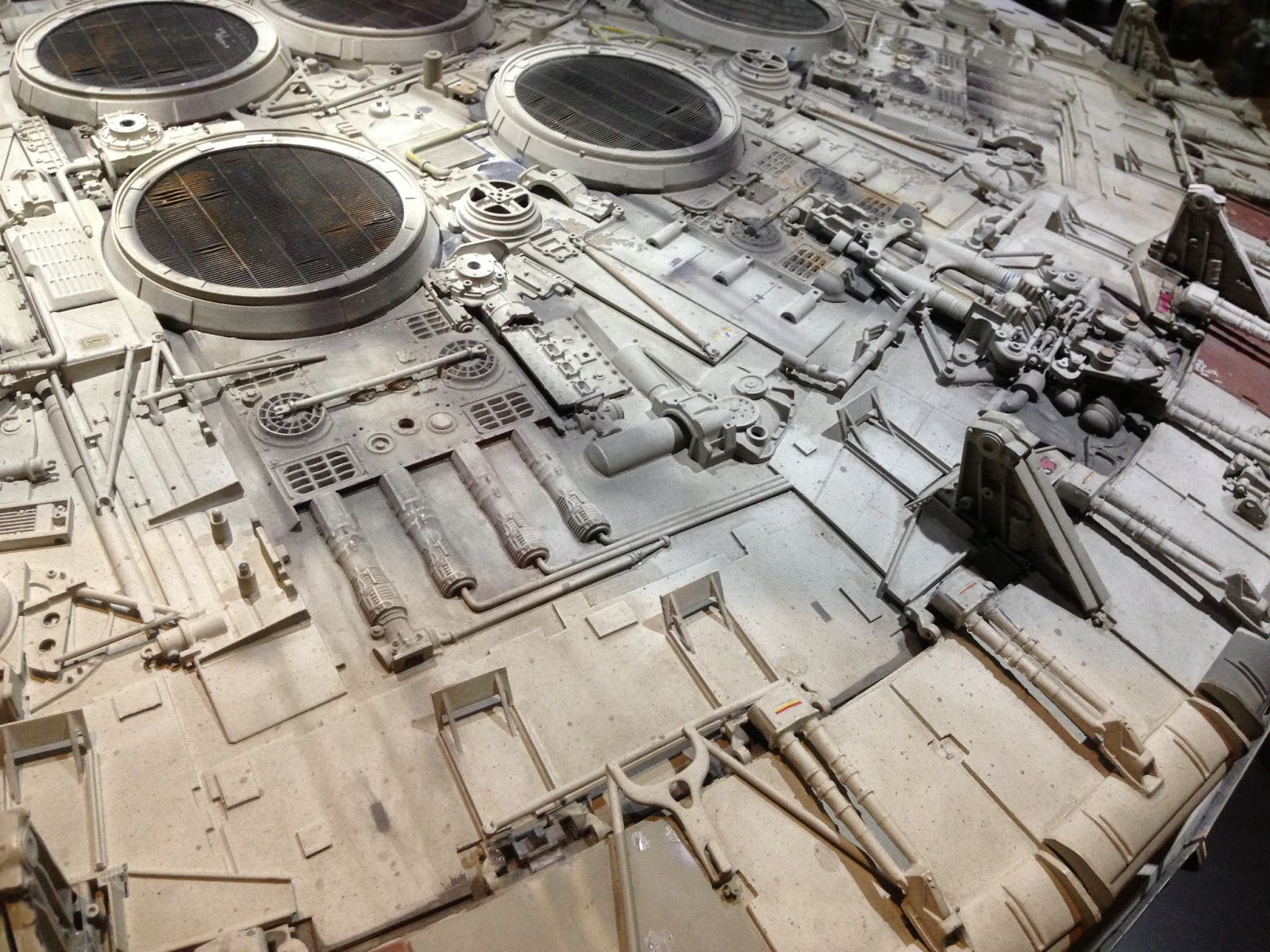

Just my 2 cents worth on a few things.
I don't feel any comparison or even pics to compare certain areas of the 5 footer & 32" model in either MR Falcon or Deagostini are warranted here, they are totally world's apart.
This is a Bandai 1/72 ANH Falcon thread, so the only reference should be the 5 footer, same as what Bandai used funny enough to produce their kit!. And what a kit it is too I might add!. I'm not getting one mind, I have my own 5 foot model under construction, so have my hands full haha.
So in regards to plating & the armor plating in particular...it is a mix of 1mm & 0.75mm thick plating used on the 5 foot miniature. The mandibles for instance, 0.75mm is used here. The underneath jaw box is 0.75mm, but the sides of the front gear box are 1mm. The chipping is all a mix of both sizes, only seen in good close-up reference pics.
The acrylic domes were routed to their edge to 0.75mm, incredibly thin for this edge & the overhanging plating on top of that. Still, the 5 footer is an incredibly fragile model, as all builds will be!. You can't pick it up from the edge of the round hull & you can't really grab anything down the mandible end. Hence the holes in the miniature to insert handles.
If Bandai were to do a true scale edge to the plating...that would be 0.25mm, so thin!.

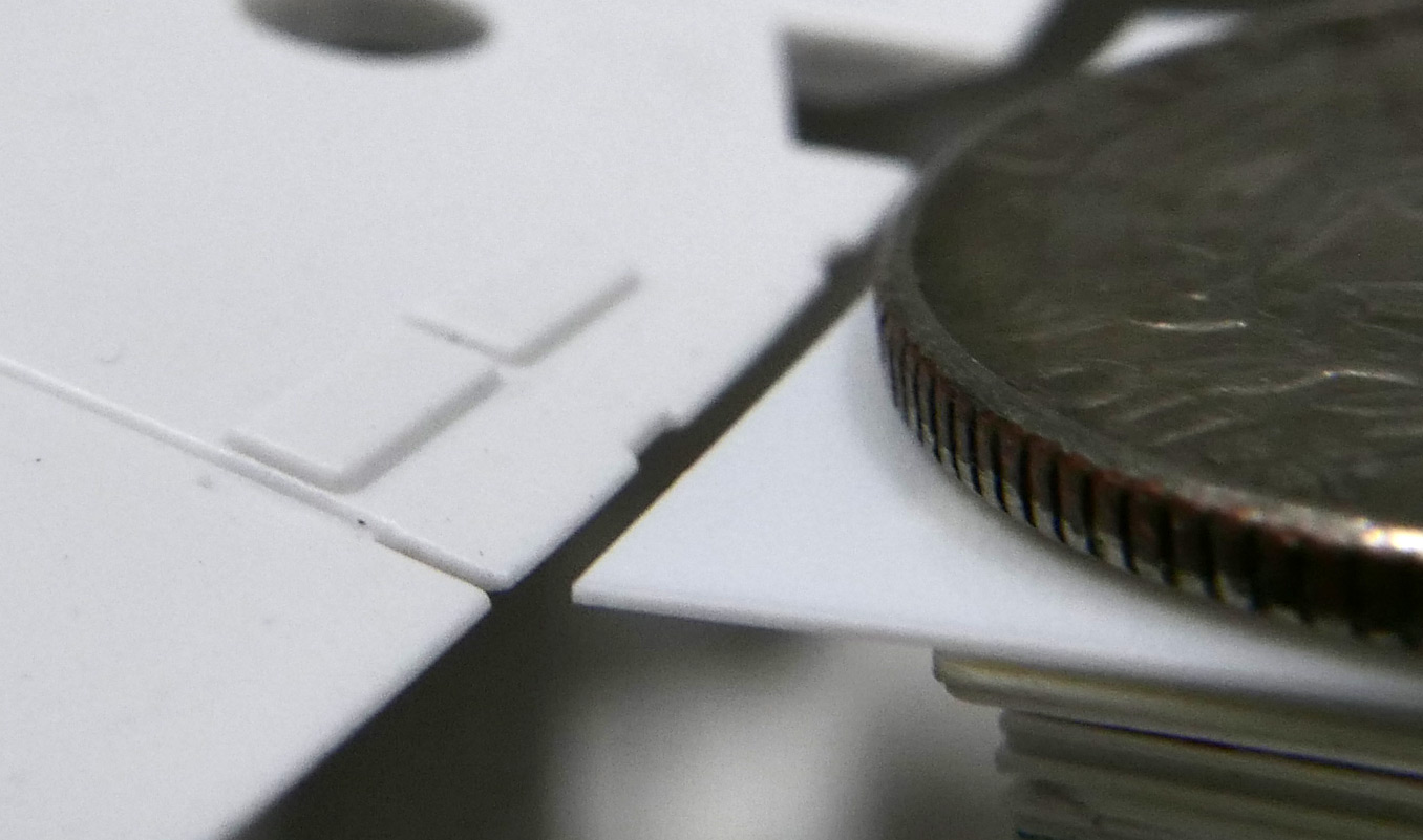

If you have taken note that I had written "compared to this," you would have understood that that was not exactly what I meant.
But I think you have raised an interesting point in questioning if it is indeed proportionally the same.
The closest thing I have to a caliper that could measure 0.25mm is a 0.3mm Tamiya plaplate, so I used that to take the pic below.
The plaplate is on a pack of business cards, and on top of the plaplate is a quarter dollar coin.
If you look at the part which reveals the section of the plating, its certain that the thickness only reaches its accuracy at the very edge (That is how it is achieved).
But the section gets virtually hidden when the model is assembled.
There are parts where the edge thickness becomes in the range of 0.3mm to 0.4mm, but I don't know if that's expressing some thickness articulation of the original model, or if it is due to technical limitations.
