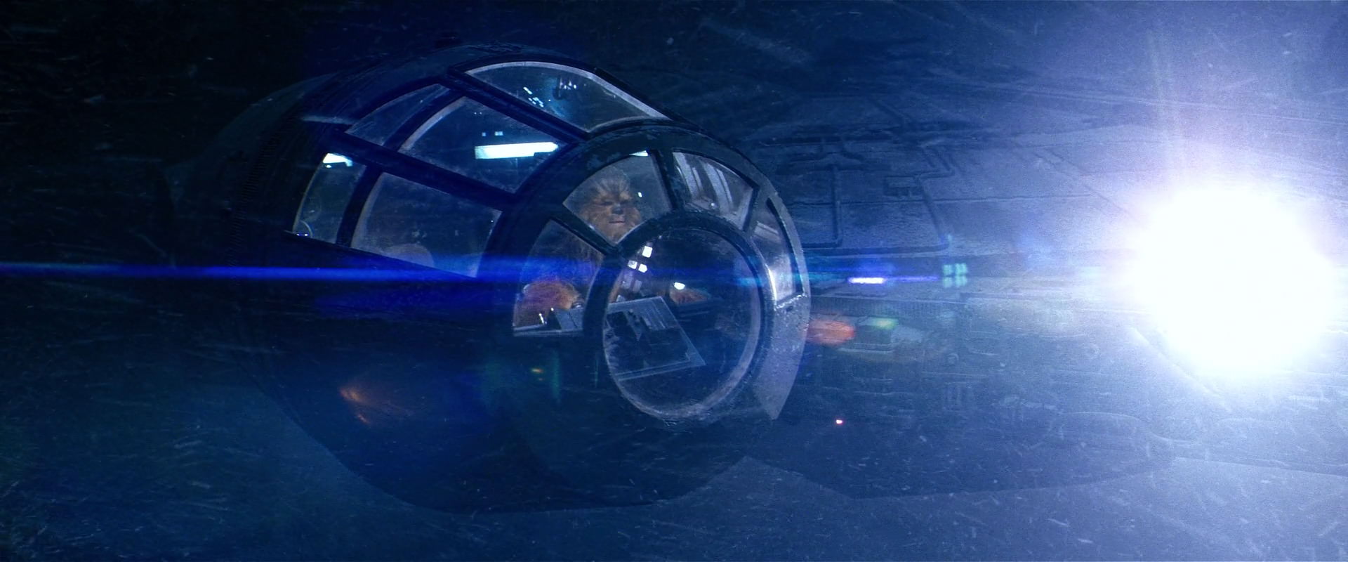

What ILM are doing now with the Falcon is very respectful to the OT,...we are very lucky that they haven't totally gone the wrong direction with The Falcon,.....the only head scratcher that got me was the rotating turrets & upside down quad guns
They have included logic to the lights on the ship,....lights that were introduced in the OT,....the down lighters on the lower hull....that come on when she has landed.....the added red running lights when you see her in space,...but not garishly bright,.....they are very subtle
The spot light in the image above was used for a purpose,...for Chewie to pinpoint Rey & Finn through the forest,....once that task was completed off it went......the same as the headlights that were switched on as the Falcon entered the asteroid cave/slug in ESB,....Han was flying inside something,...& needed to see where he was going,....Lando did exactly the same in ROTJ,...the headlights came on as the ship flew into the Death Star II tunnel,..
This is the way the Falcon was & is portrayed regarding lights
What I'm getting at is the current misunderstanding of that logic by some model makers,....99% of completed DeAgo Falcon models show her with blinding blue LED headlights,....& it doesn't stop there,...to some the more lights the better,....flashing,....the Falcon looks more like the Mother ship from CE3K
These models are modded to the model builders tastes,...so they can do what they want....but it is like a virus,....once one has been modded to the max,...then another pops up with more, distancing its representation further & further from the studio models or the fictional craft from the films

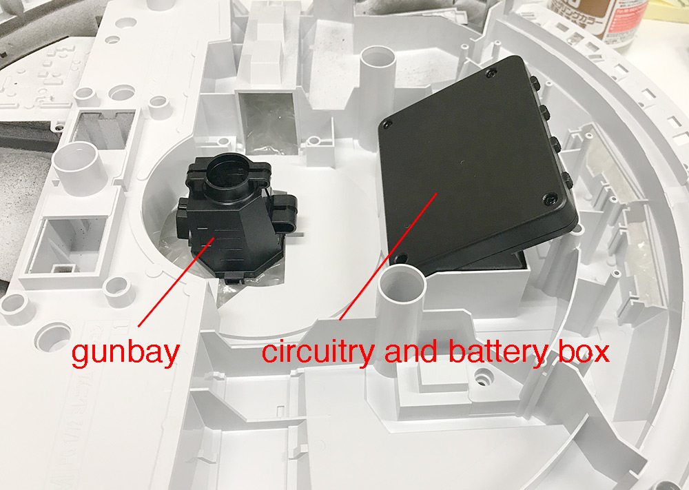

This picture seems to imply you can have either the pre-built light kit or the lower gunner turret interior but not both (not without major surgery)
Re: Bandai 1/72 Millennium Falcon
Personally I don't mind if i don't have the lower turret interior. I've never once looked inside the bottom of my Deagostini turret.
No.
This is where the circuitry box ultimately goes, and it does not interfere with the gunner turret interior.
In fact, there is plenty of space between them.
As with the filming miniature, the engine deck (the upper quarter back) opens, and this is were the circuitry box with the switches and the batteries are accessed.
And yes, I think it is a good idea to add wiring for external power supply, as well as switches.
