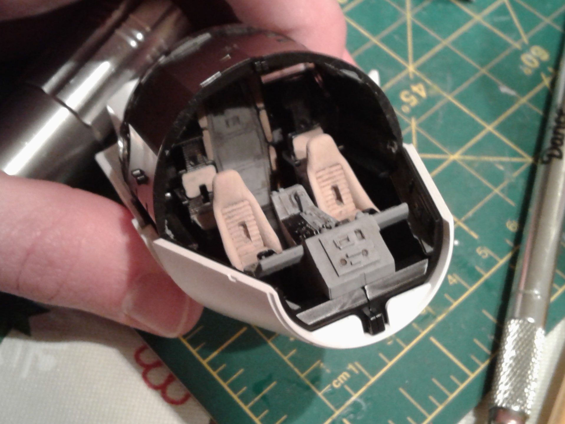

I filed off the front of the set cockpit and replaced it with something that resembles the ANH front console. Not as detailed as 3D printing could make it, but I don't think it looks out of place.

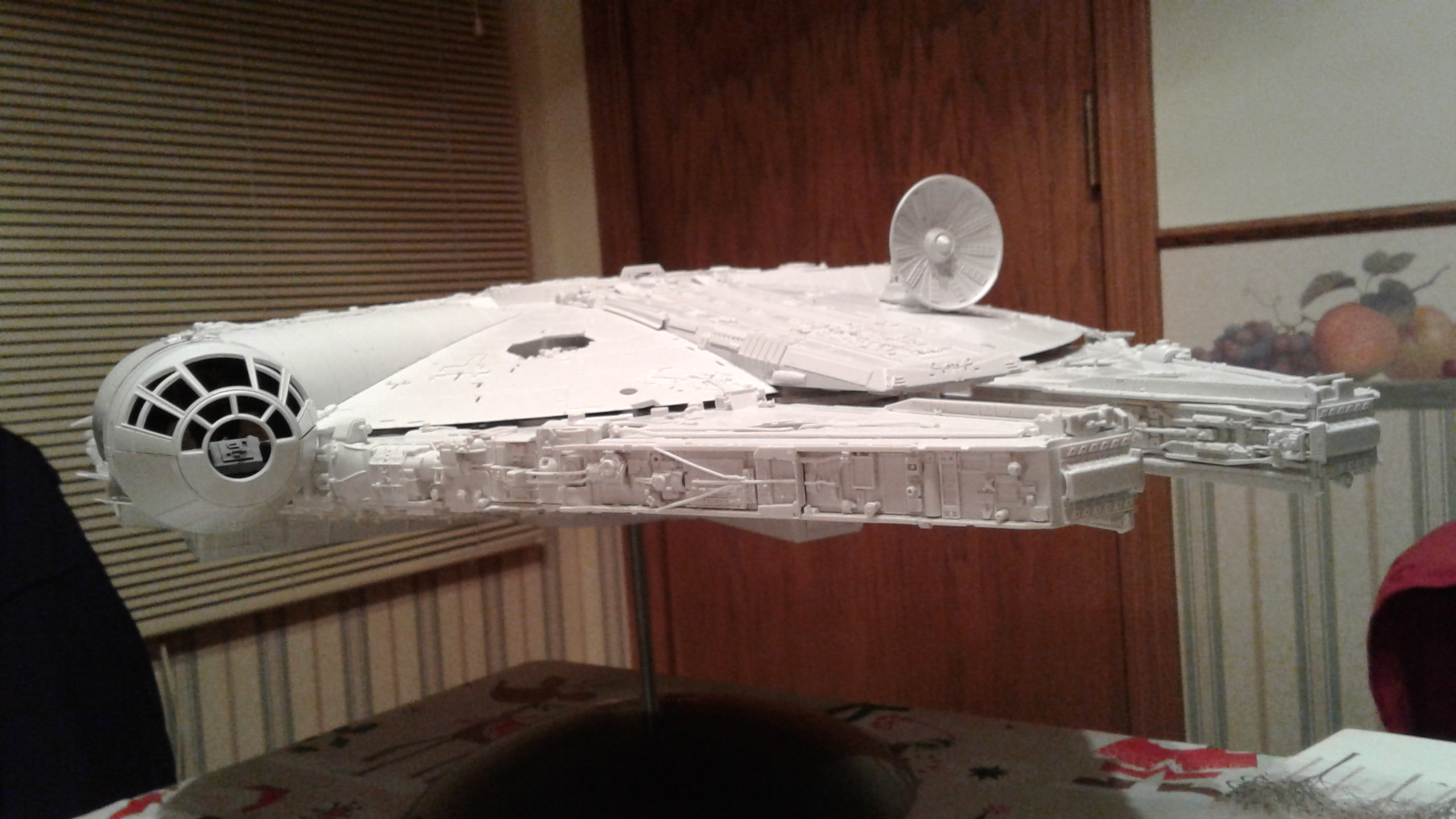

I'm also almost done with my modifications. I added magnets to the rear engine deck so that it never falls off, made a studio model cockpit interior that can be swapped out with the set interior, did lots of dremeling to add the damage Bandai left off, and added custom mounting. I will say that (in my opinion) a single rod holding up the falcon looks a lot better than the stand Bandai provides . . . and it's way sturdier! The base is courtesy the AMT Enterprise

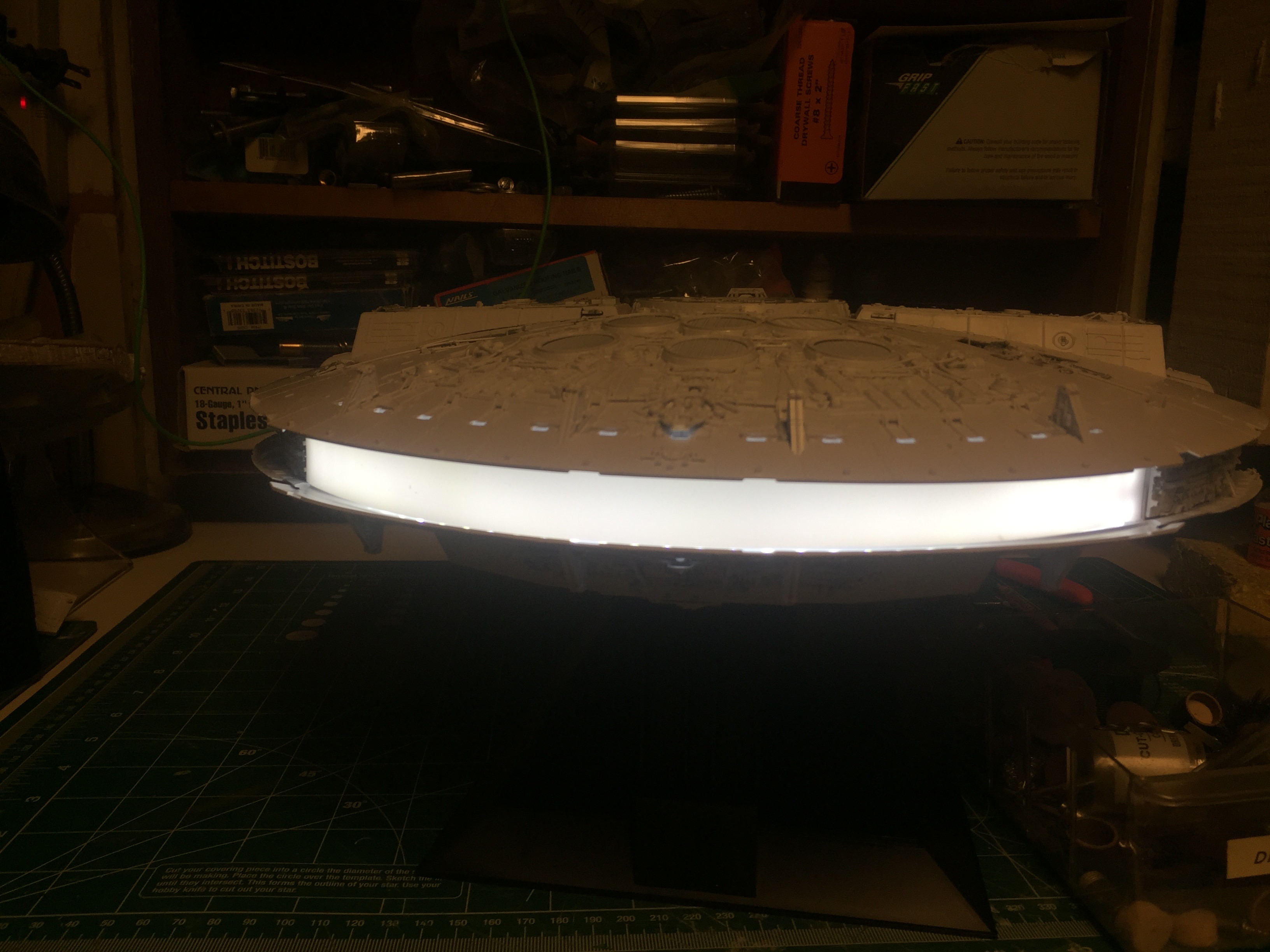

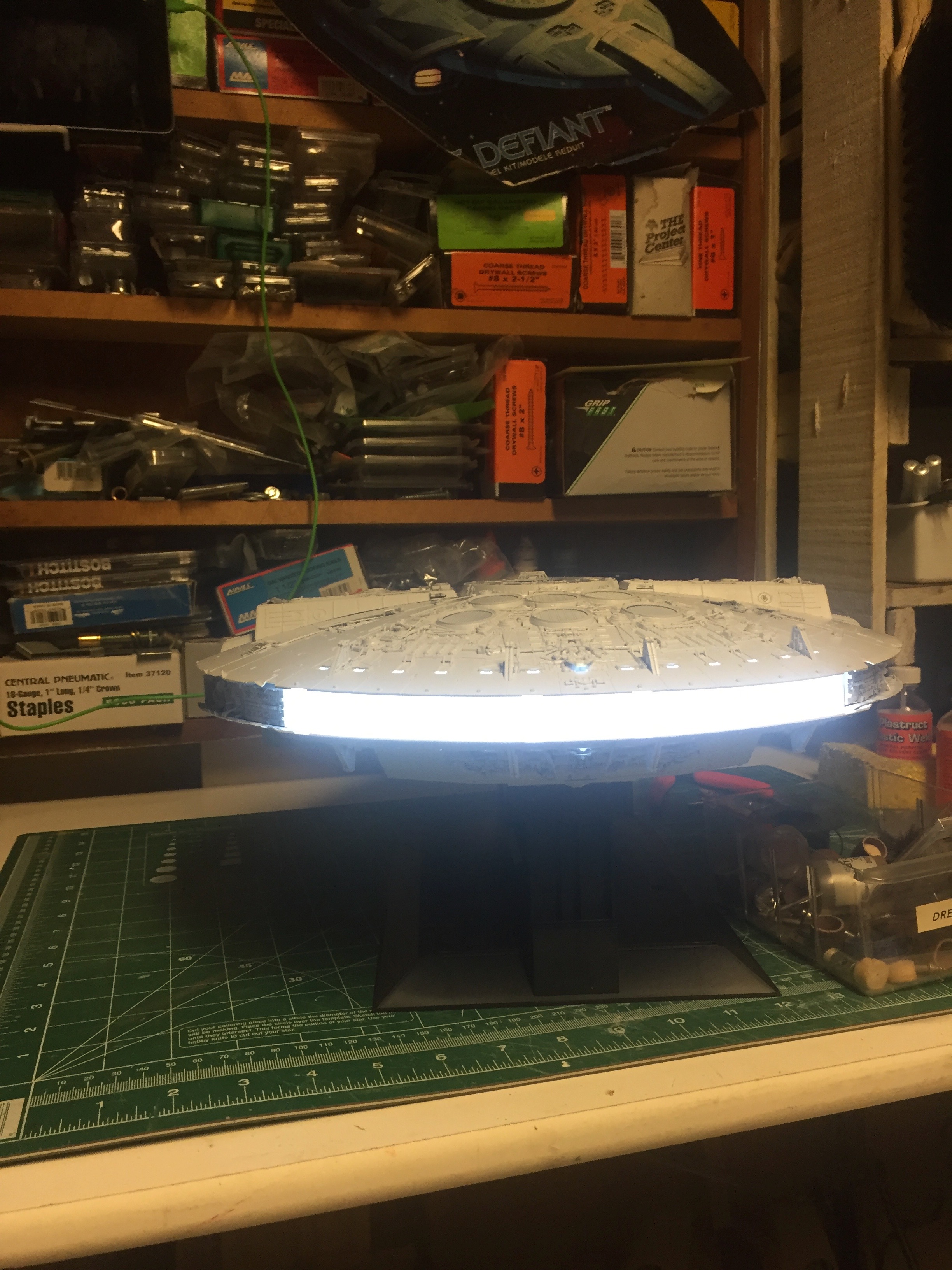

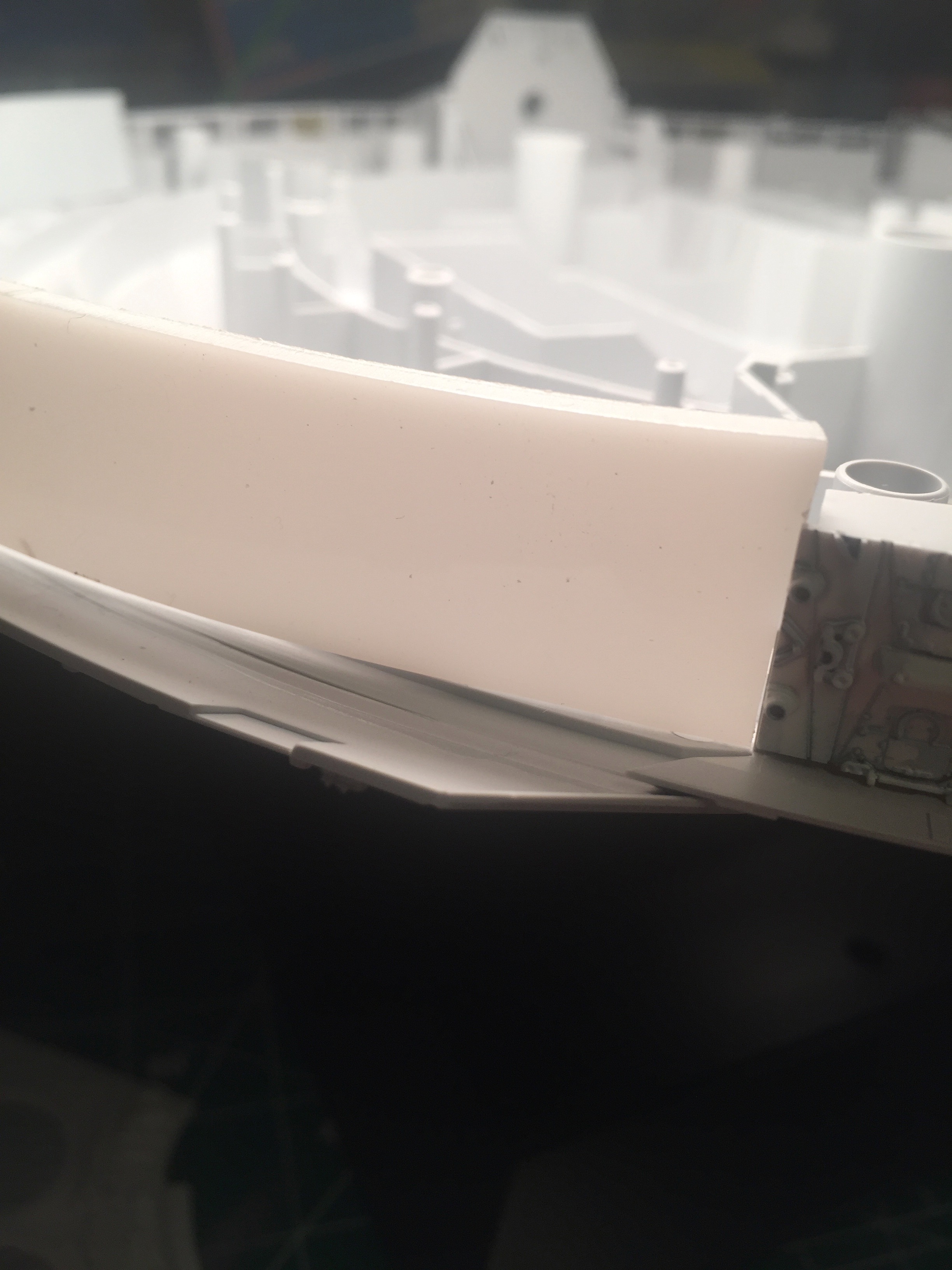

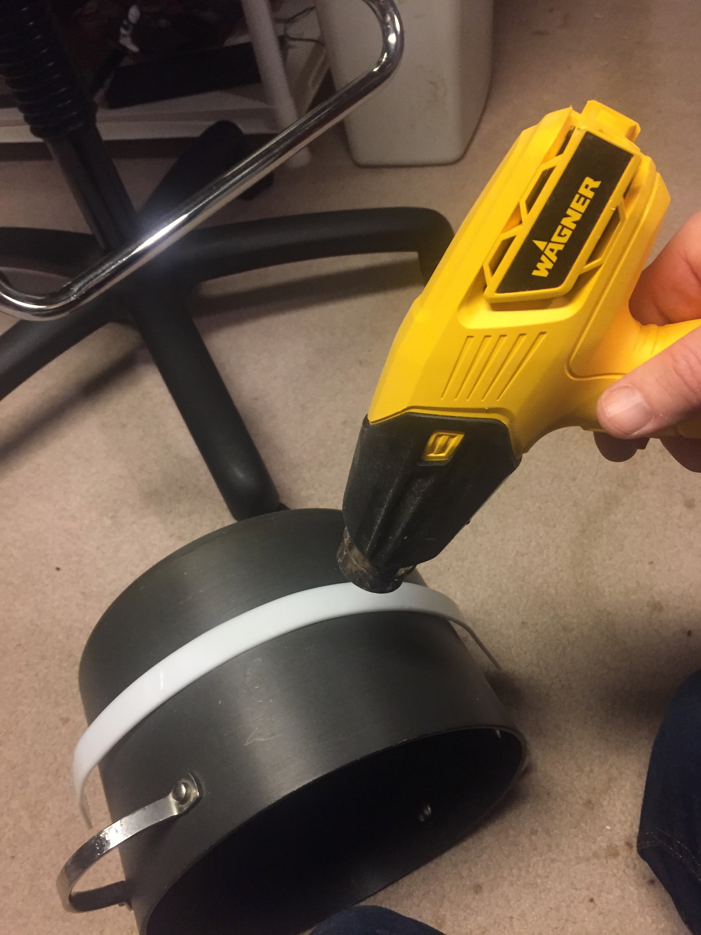

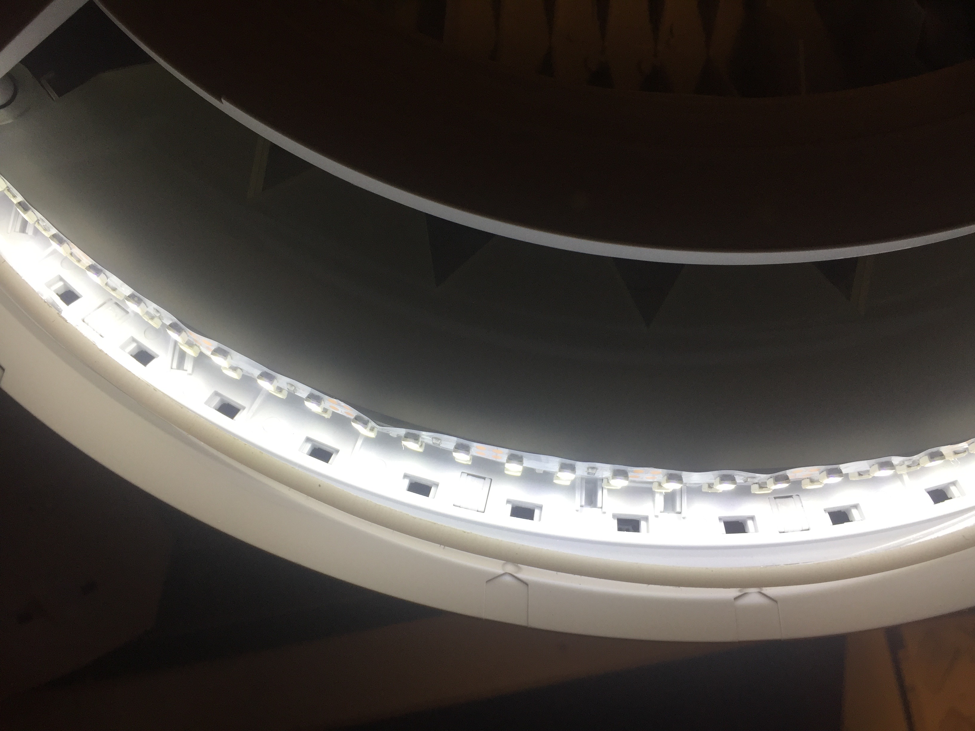

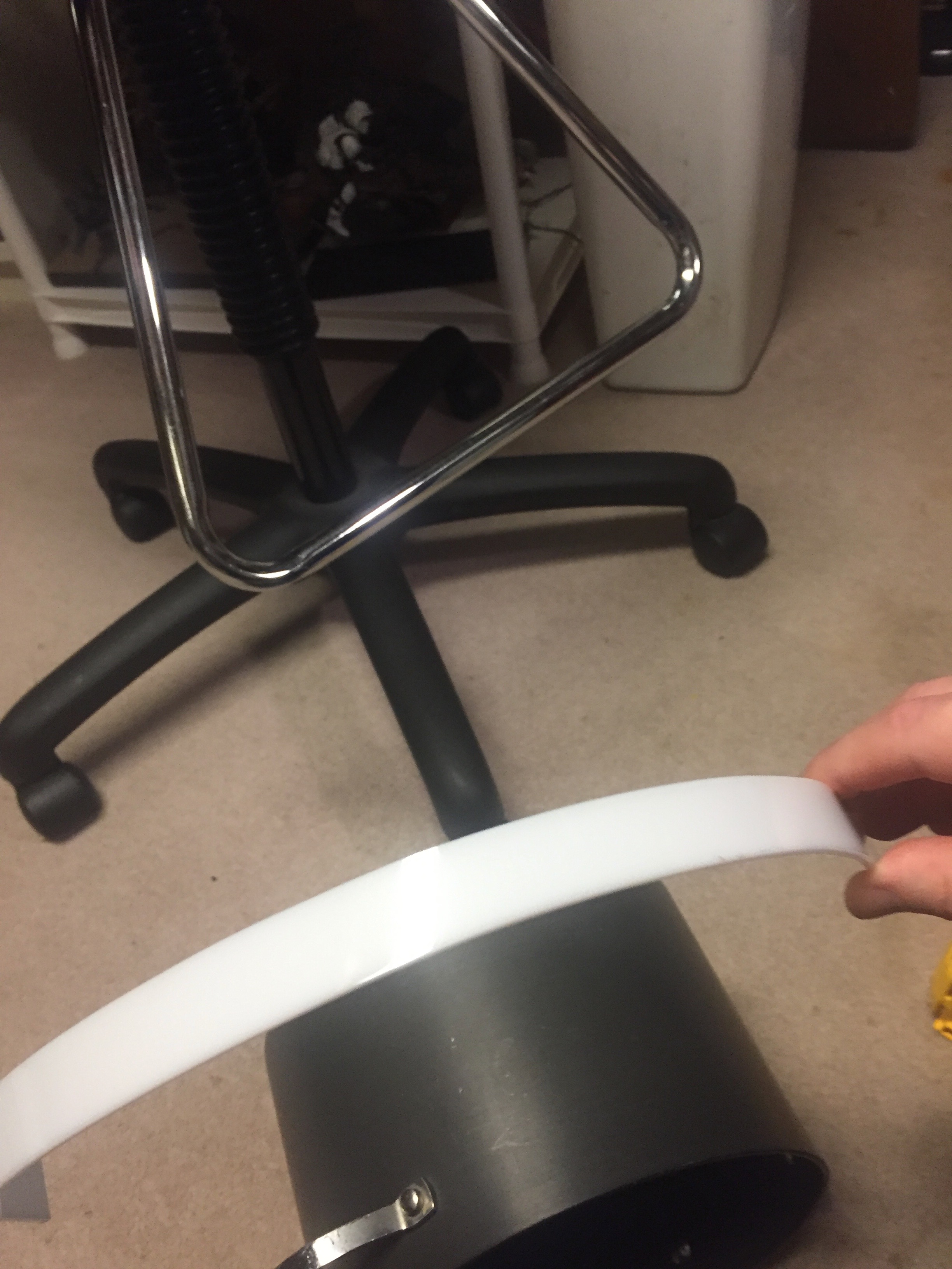

Okay, so I think I'm closer to finding my studio model lighting solution. Here's what I'm going for:

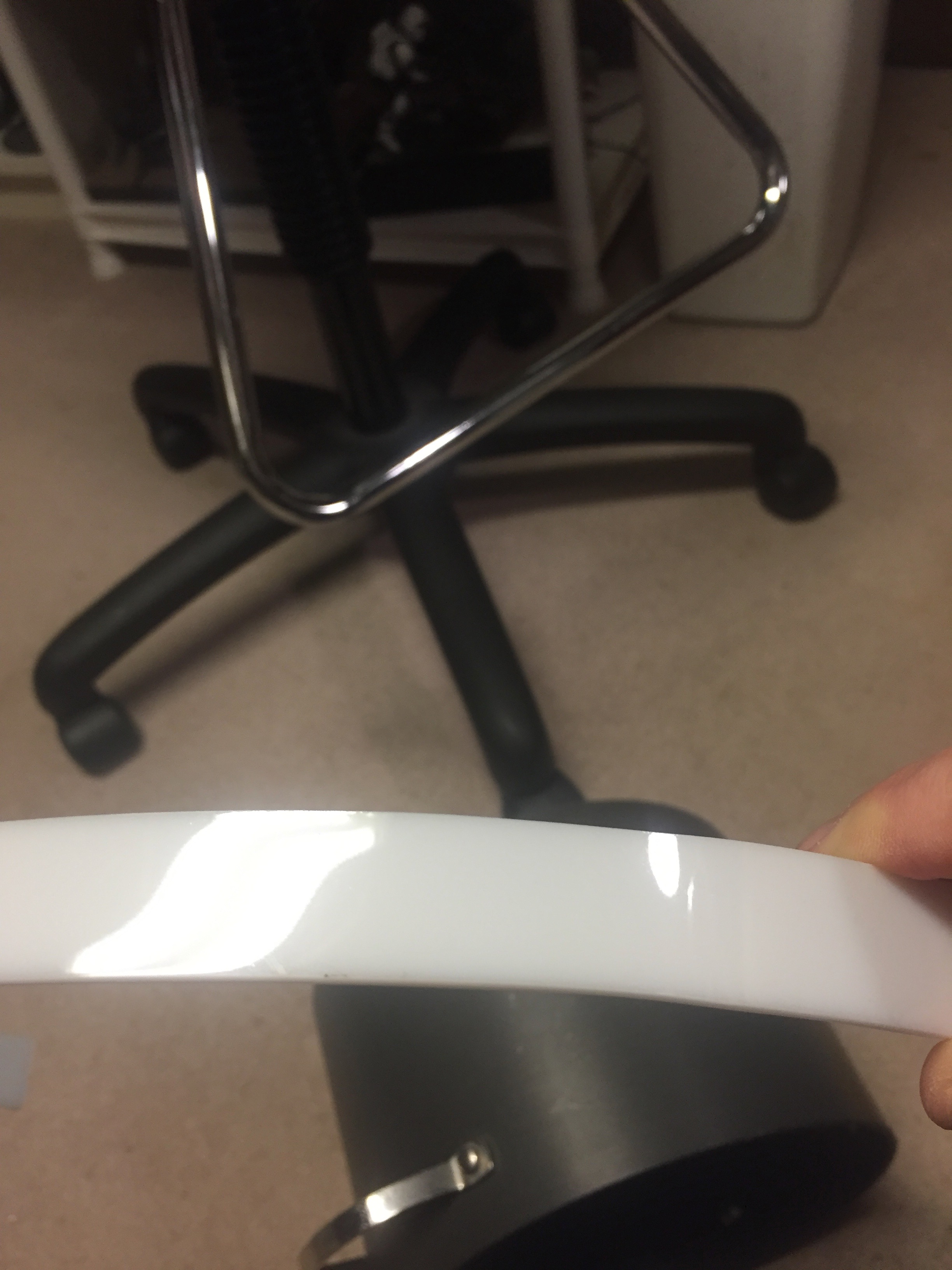

I went to the home improvement store (Menards) and found a 18x24 sheet of glossy white translucent acrylic for $14. I cut a strip roughly the right width and length for the Falcon's engine on my band saw and then used a heat gun and a kitchen pot close to the same circumference to slowly bend the acrylic around the pot.
This is a test strip, so I wasn't too careful to make the bend perfectly consistent. The acrylic is thick enough that I decided to see how it would look with two rows of strip tape LEDs behind it. I installed the Bandai defuser into the model and taped the LED strips directly onto it. With the new acrylic strip in place, there's about a 1/4"-1/2" gap between the LEDs and the strip.
So this is what I ended up with...
In real life, it's not quite as bright as the pictures show and I'd like it to be slightly brighter, but I think I'm close. The individual LED points blend together fairly well, giving a pretty even engine glow. I think on or off, this should give me to a look that's pretty close to the 5-footer.

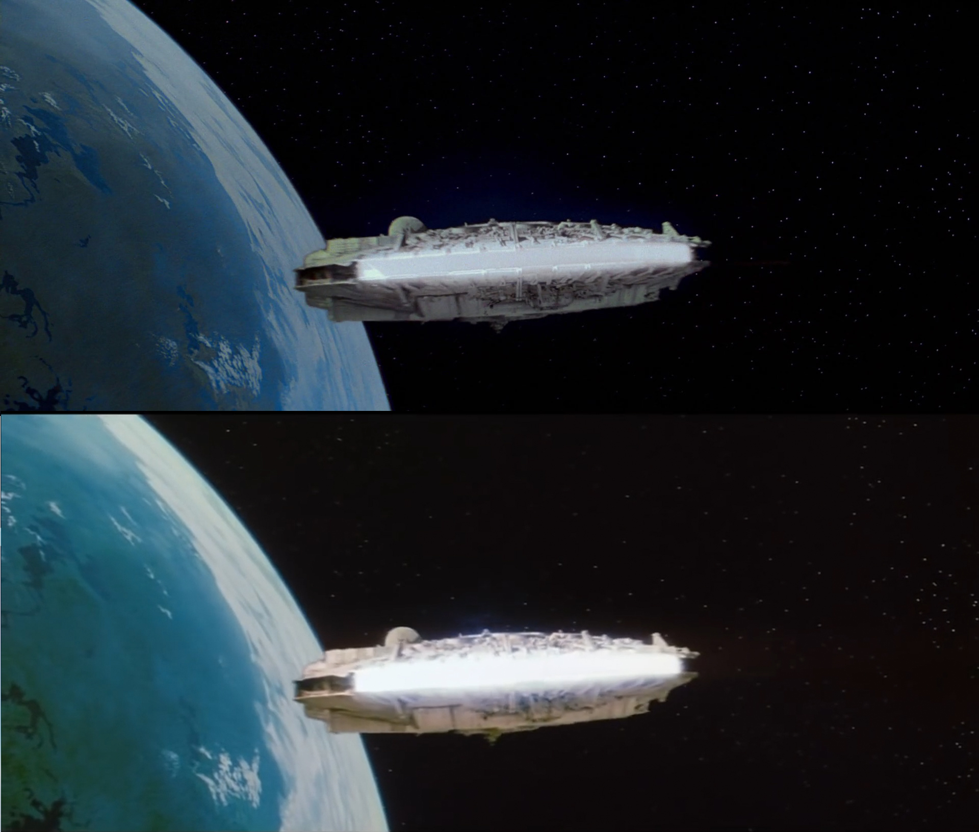

Beautiful work mate.....it really does look gorgeous

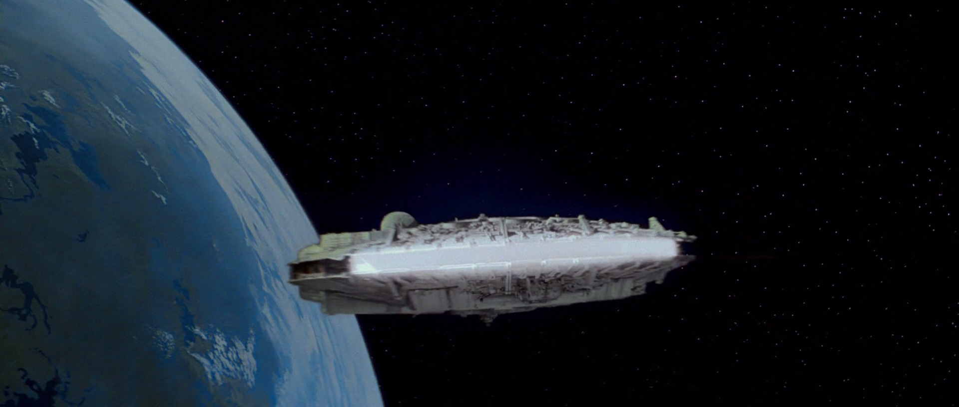

Here's that same frame from the Team Negative One 35mm scan
J

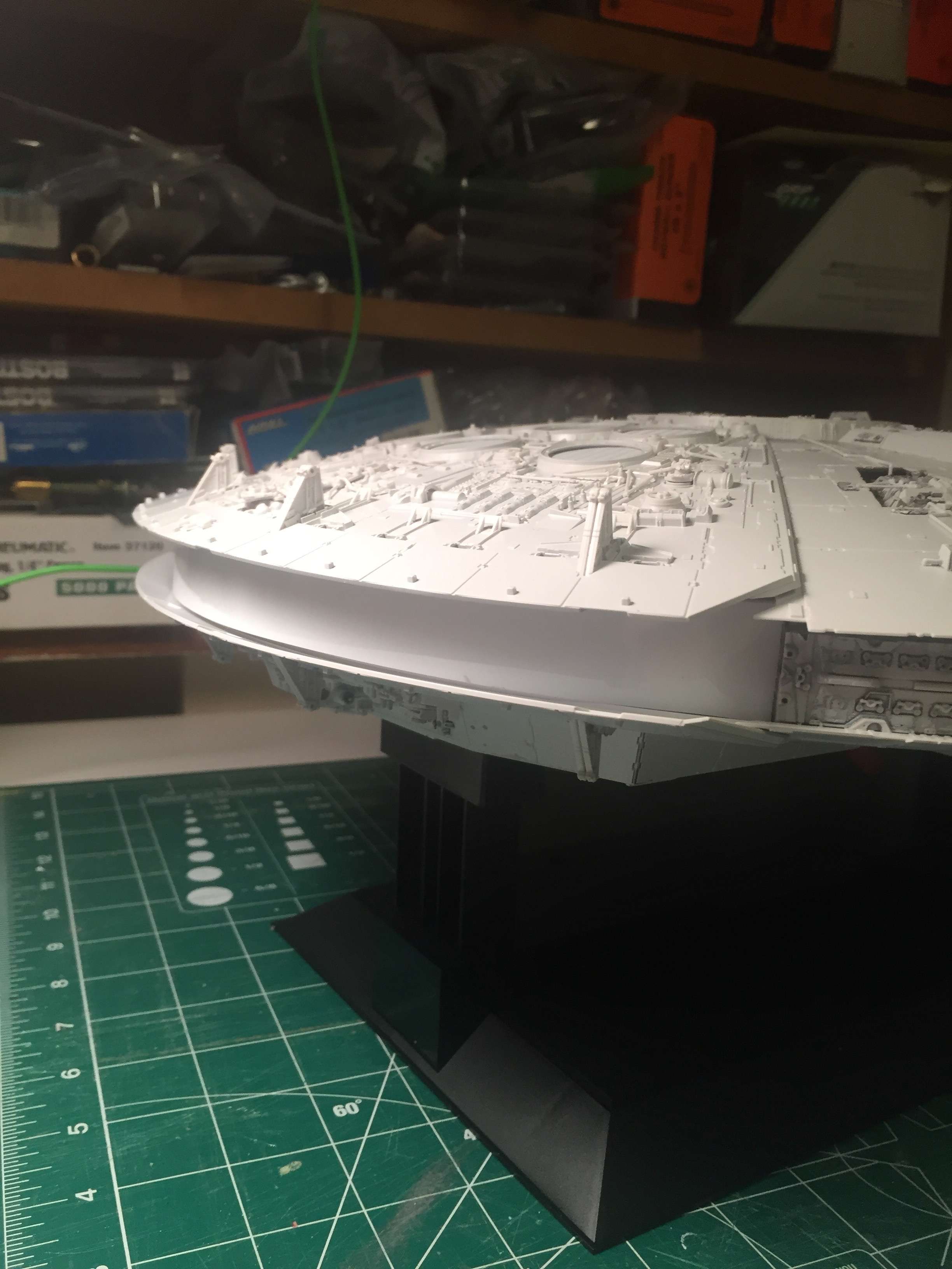

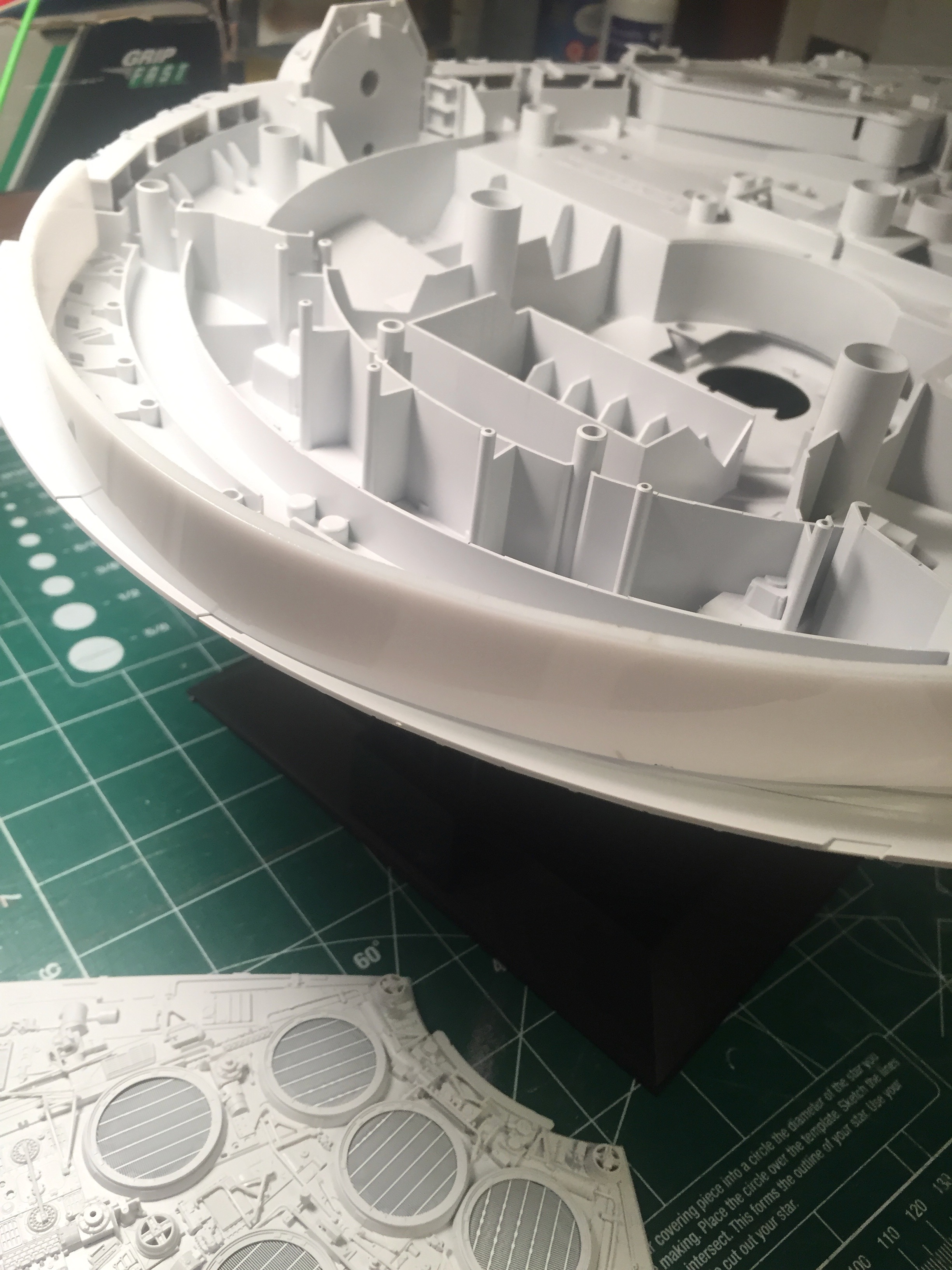

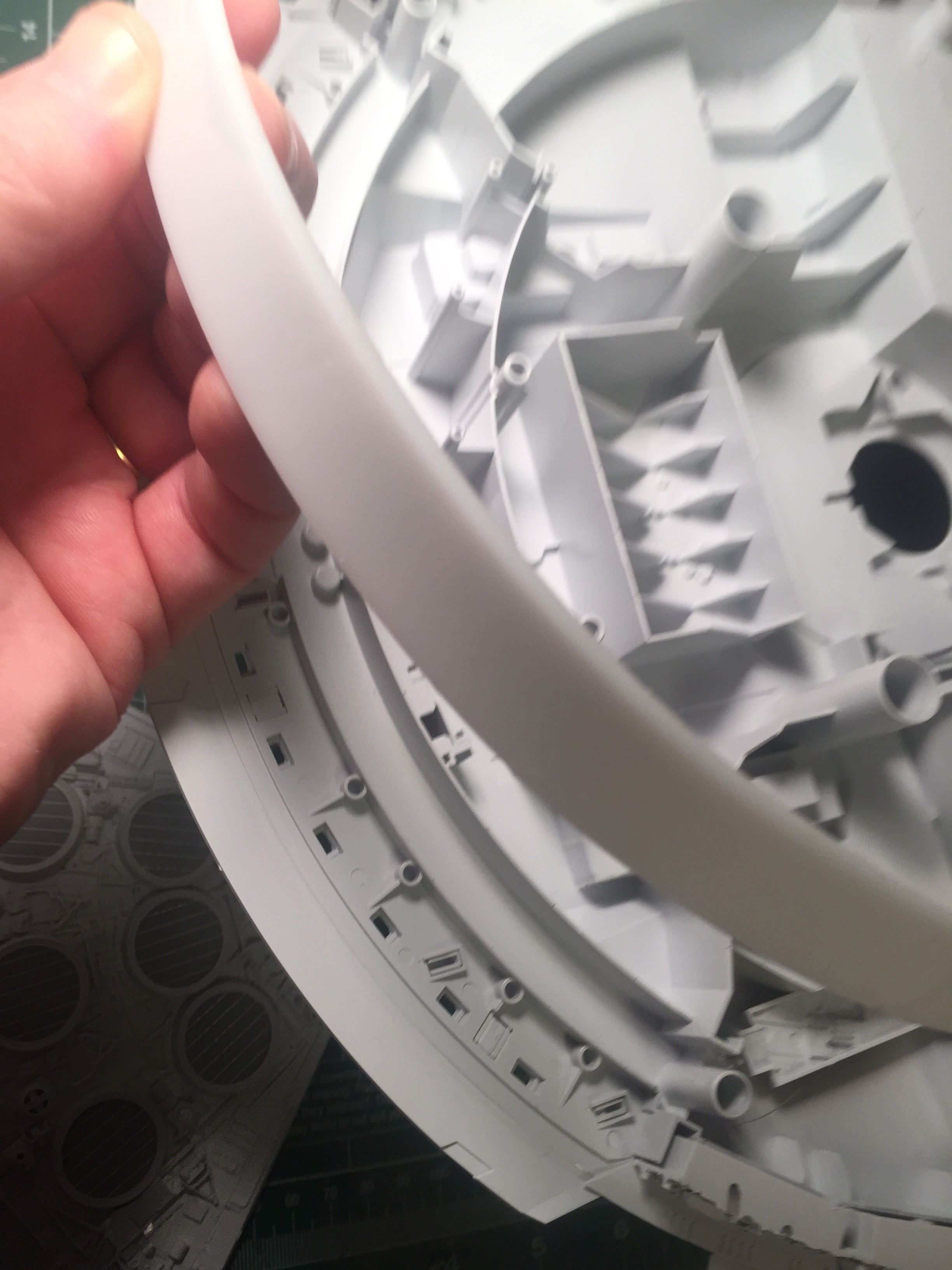

I'm trying to fit this well underneath. Is there supposed to be this much of a gap? I've pressed as hard as I dare. I even cut a pin.
Re: Bandai 1/72 Millennium Falcon
Mine did that too! I noticed it a few days after I connected the pieces. I've been kicking myself ever since thinking I didn't push it far enough. Unfortunately, I ran some thin cement in there so it's that way for good. I'm not losing sleep over it, but yeah, annoying.
Same on mine - I want to say it's a flaw in the model but it hasn't caused a problem yet. I'm nervous about joining the top and bottom saucers though. I hope it's not going to get hung up because of that part not fitting all the way in.
It shouldn't cause a problem joining the saucers. I'm nervous about that stage too, but more so about any potential gaps between the mandibles and the saucer.

I didn't have any major trouble getting the saucer halves together. Take your time, wiggle them into place.
There should be a small gap between the mandibles and saucer halves.
