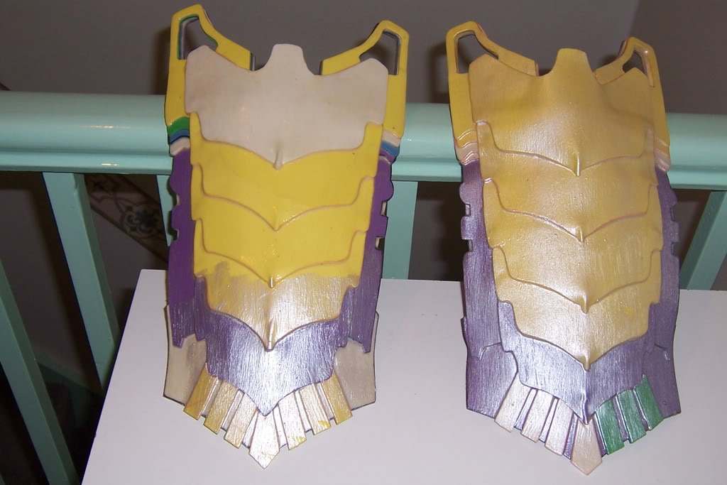

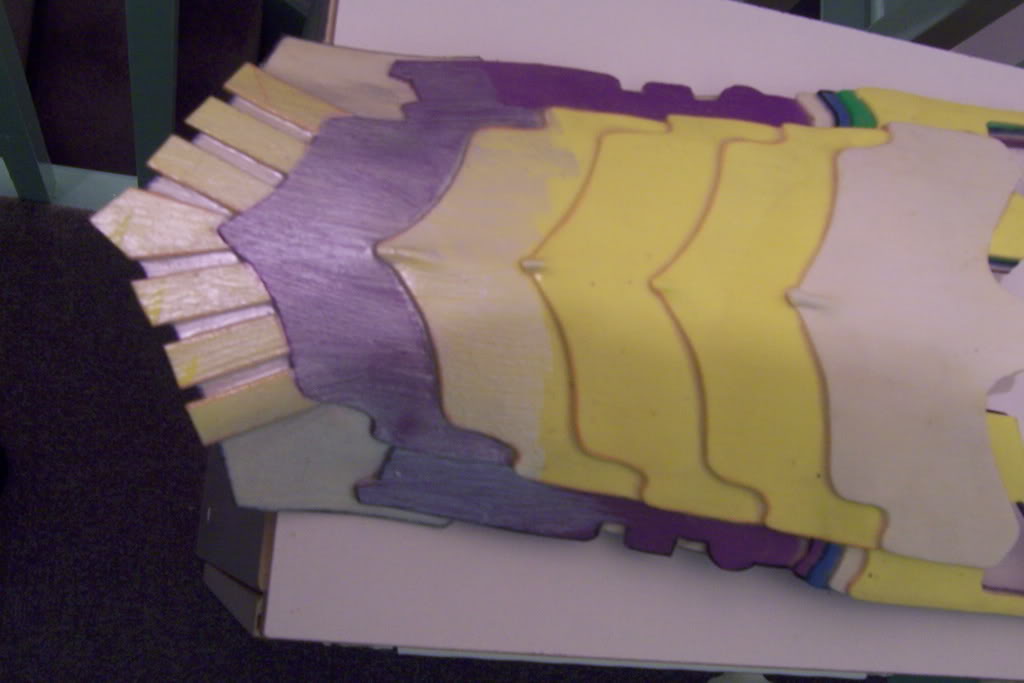

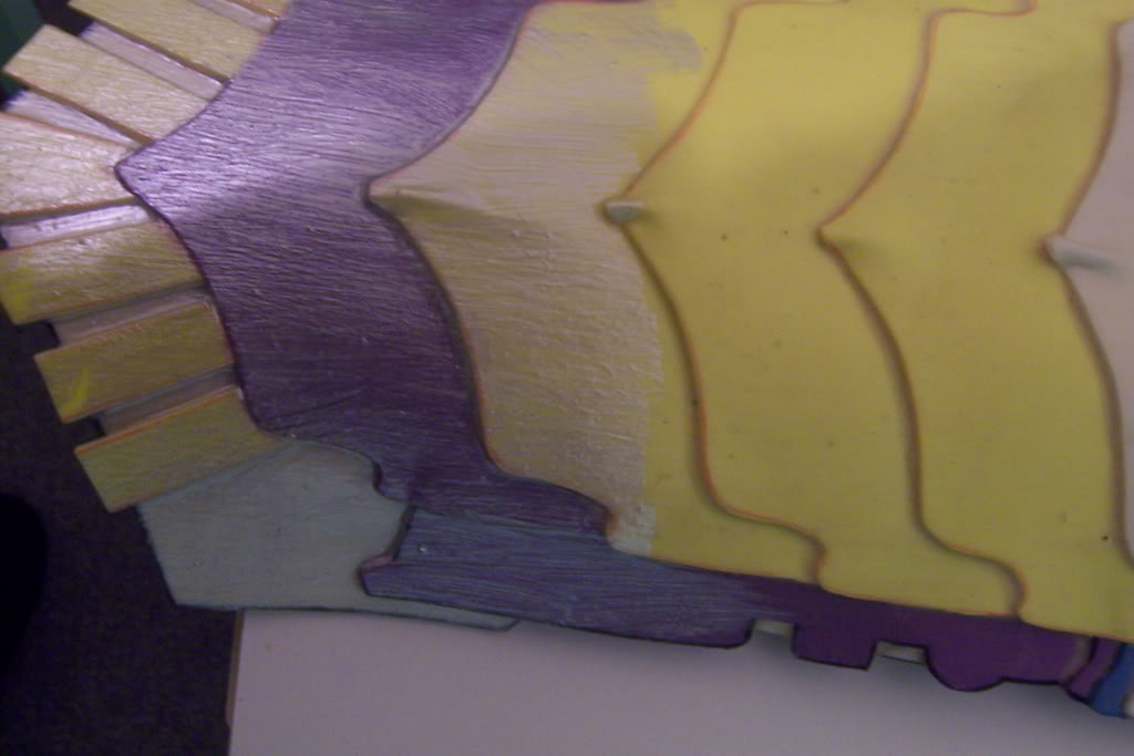

Hi all thought you all might like to see some finished armour using foam and the templates above
here is some thigh armour using the same templates any queries on how it was done will be gladly answered
Enjoy
