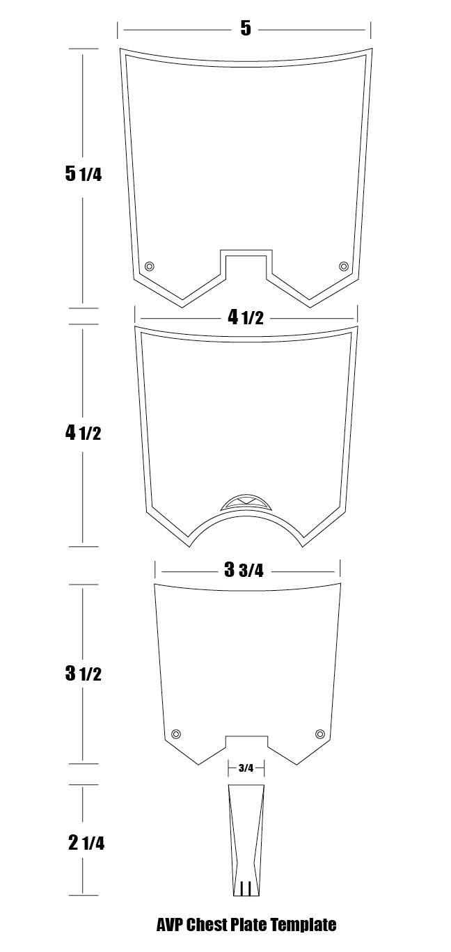

I am working on a series of templates for AVP armor pieces.
Since I am doing the work, might as well make it available to all.
Please take note measurements are only approximate and will vary from person to person.
a dude 5'8" will not want to adjust down a tad. a dude 6'2" will want to adjust up a tad.
Use common sense and try them on to fit.
Here is the first in the series. As I continue the series I will make the others available as well.
Vin Man

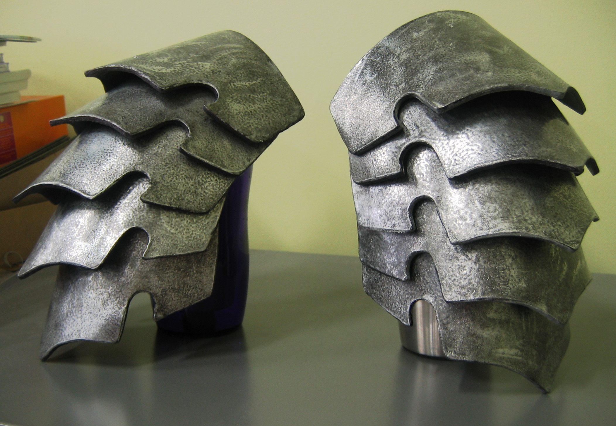

here are finished photos of the Shoulder Bells cut with a Dremel from Sintra sign plastic
• primered in black Plastiidip
• painted in silver Rustoleum Hammered Metal spray paint
• washed with gloss latex paint and blotted with a paper towel to age
• lightly rubbed with silver Rub and Buff paste to add dimension to the pitted texture
Hope you like the results!

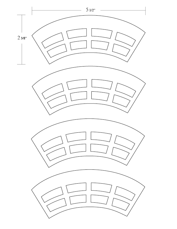

Shoulder Bell Vent Trim
Gauntlet Blades and Toe Dusters

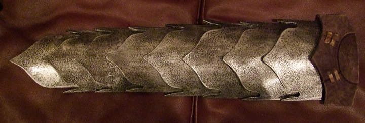

here is another
Front Groin Flap
Here is the next one
But Flap

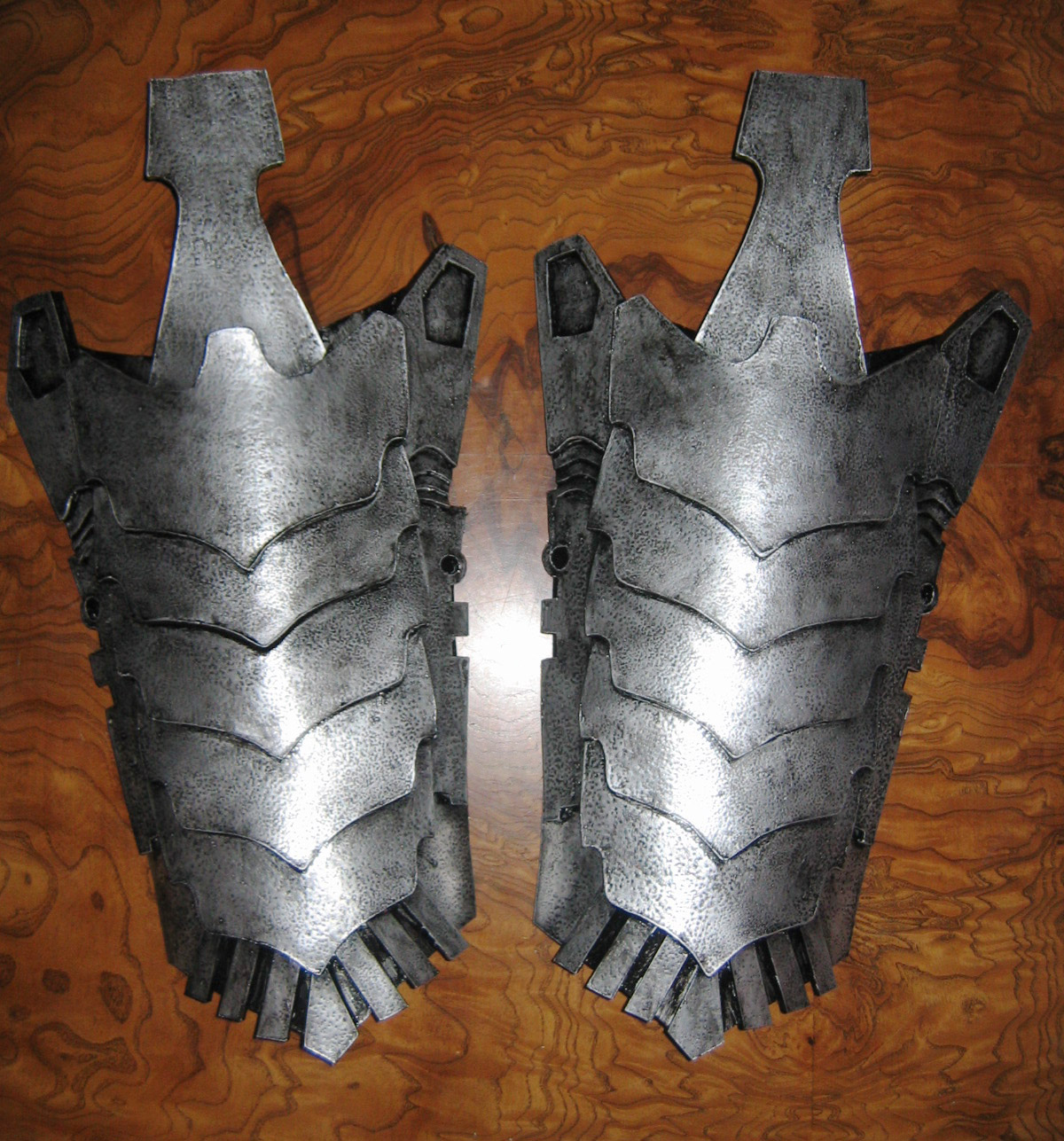

Here is another
I do not claim to be the end all be all in this matter.
These are so subject to a particular set of screen grabs and any other resource material out there.
I only attempt to the best I can in interpolating these into realistically working templates.
This one was the most difficult yet
Thigh Armor
