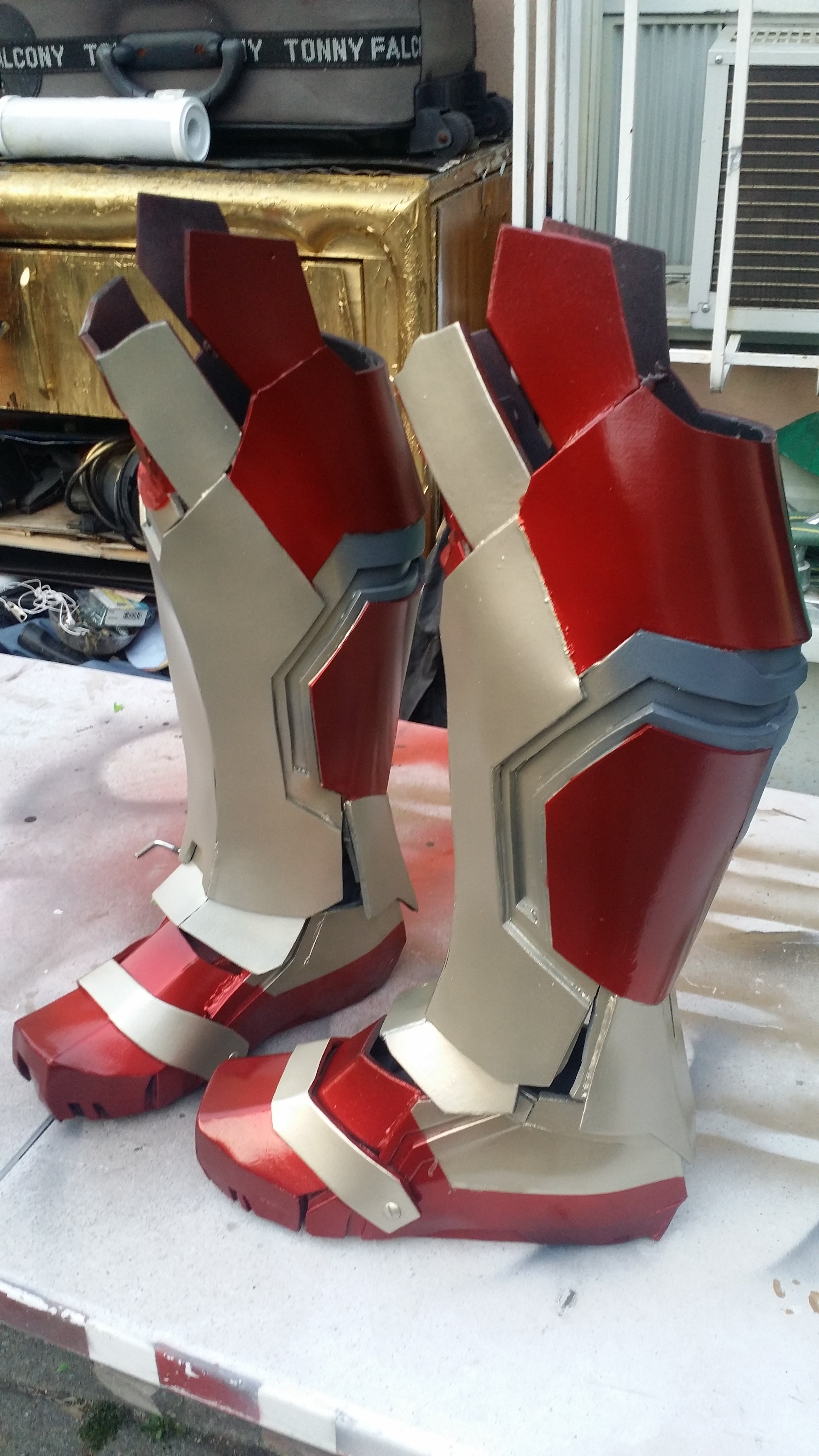

Hey hello to all, ive been usin all your tips from this build but I have a question, How do you connect the thigh the shins? Thank you

uploadfromtaptalk1436782362807.jpg this is what I got painted so far, I build the thighs not painted yet but I cant figure out how to connect to the shins.

I used the same method as I did for the elbows. I used a set of snap magnets attached to nylon strapping. If you want a sturdier, less bendy, joint just use a thin piece of plastic instead of the nylon strapping. The joints have worked great and have never come apart at a troop. I just unsnap them for travel to save space. Good luck and your build looks great so far! keep up the good work!

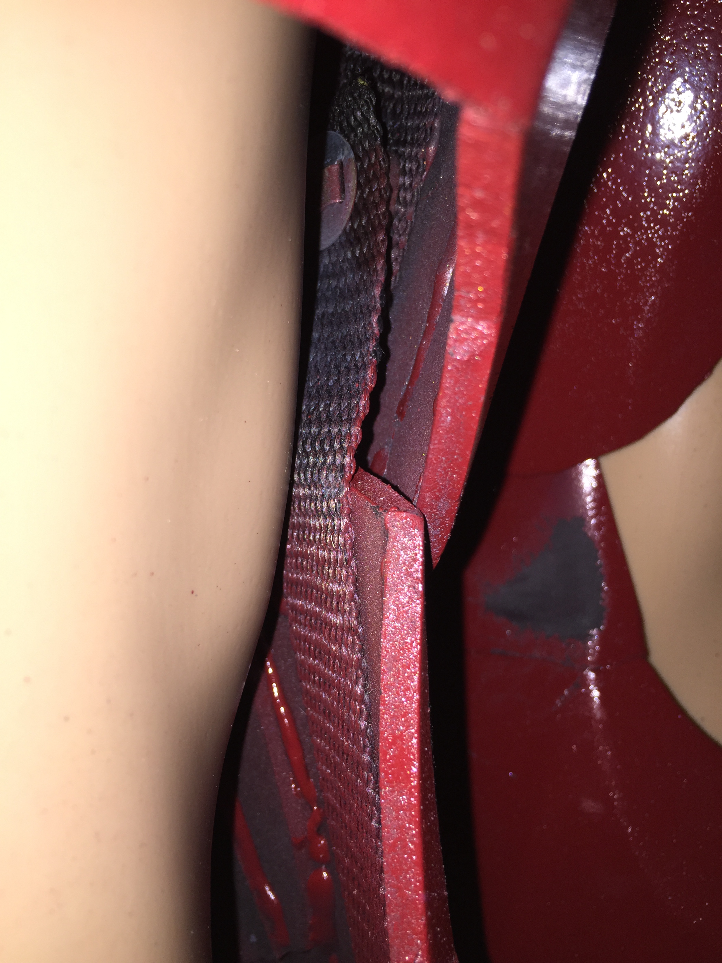

Do you mind sharing a pic of the inside of it? To see how it looks, thank you
Sent from my SM-N900P using Tapatalk
Re: Avengers: AOU - Iron Man Mark 43 - Speed build for Opening/FCBD - Finished Pics p
The armor is on a dummy now so it was hard to get a shot but this should show the basic setup. The first snap magnet tabs are pushed through two slits in the nylon webbing and then crimped on the back side. This section of nylon and snap is then hot glued to the thigh piece. The other snap magnet is attached to the end of another nylon strap. The other end is hot glued to the shin armor. My knee and shin armor are permanently attached together so they move together. Hope that helps!
